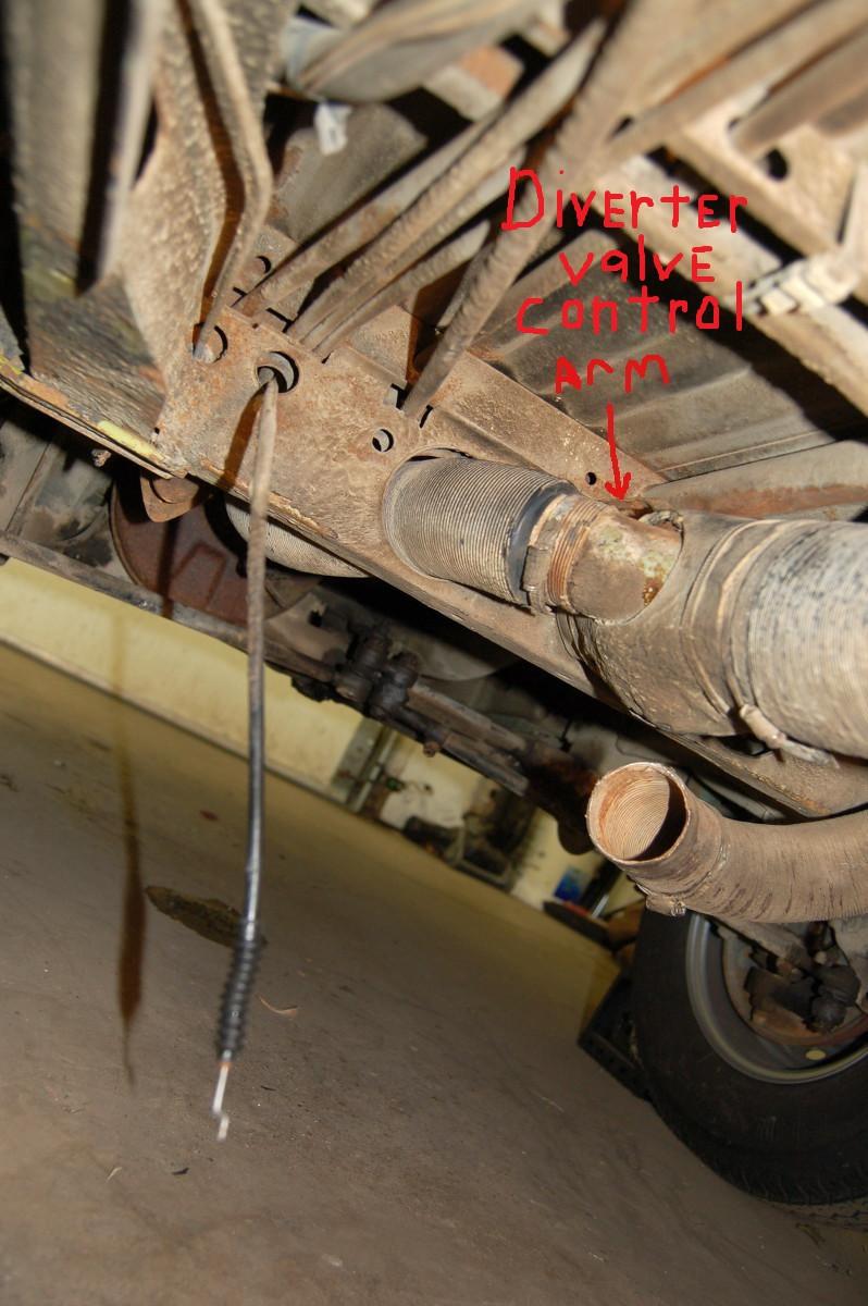

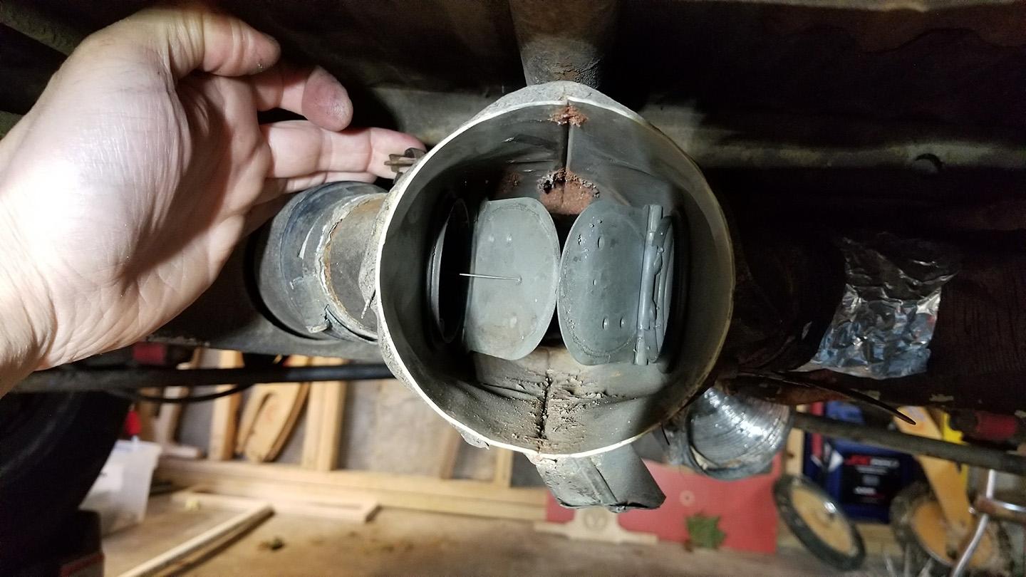

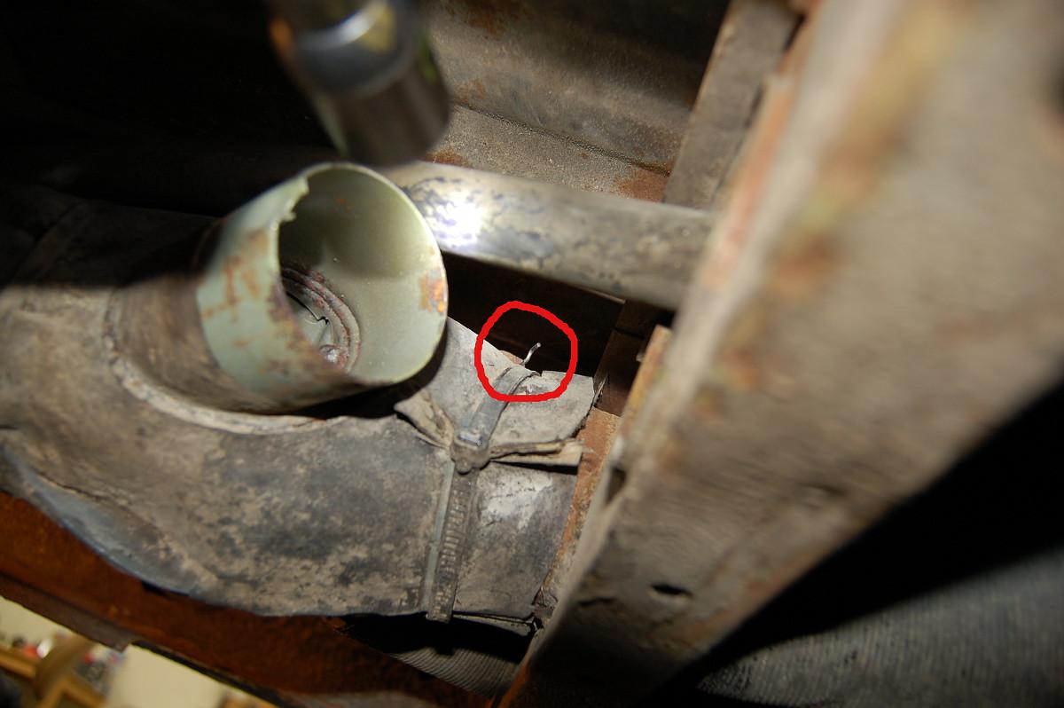

The Valve
Here is a photo showing the heat diverter valve. The cable has been detached from the valve's control arm and is shown dangling. A red arrow points to the valve control arm. The flex tube that runs to the rear heat vent has been removed from the right side of the valve and is shown hanging down.

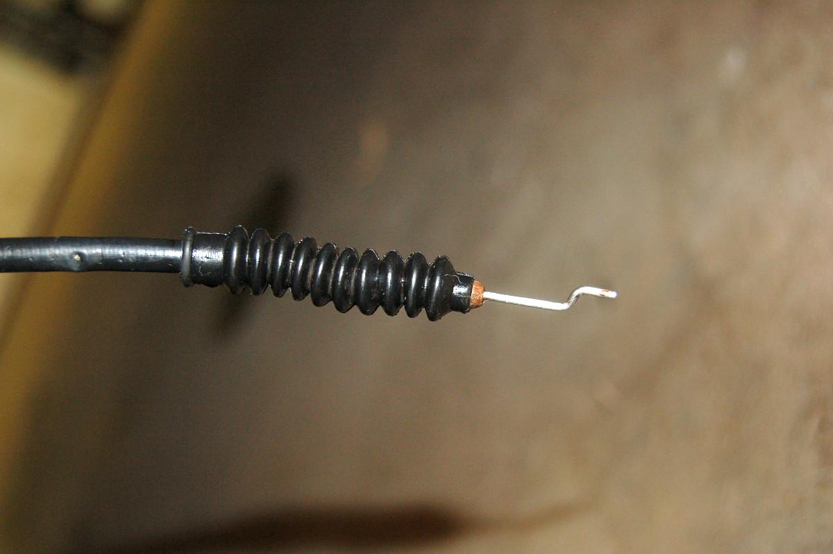

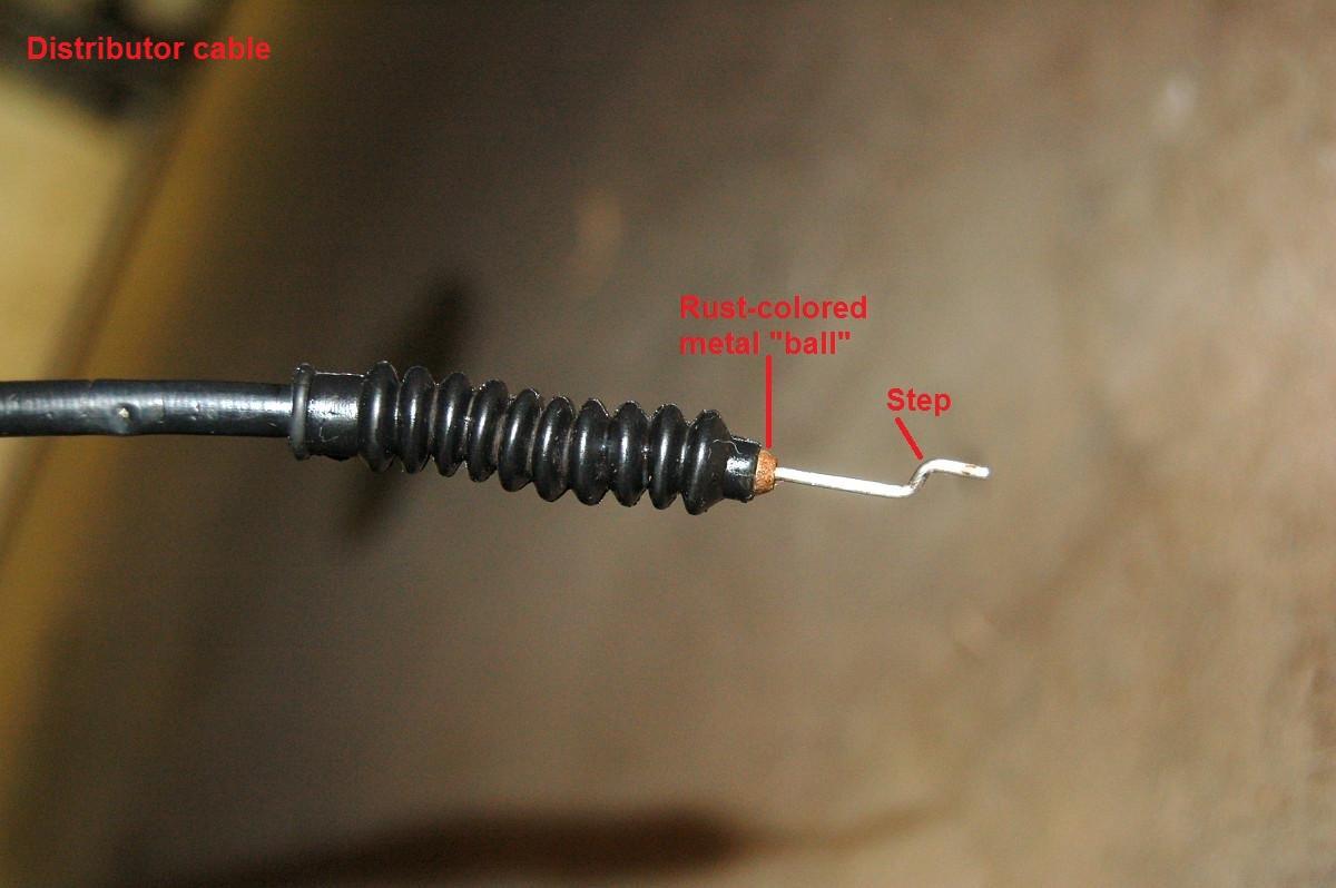

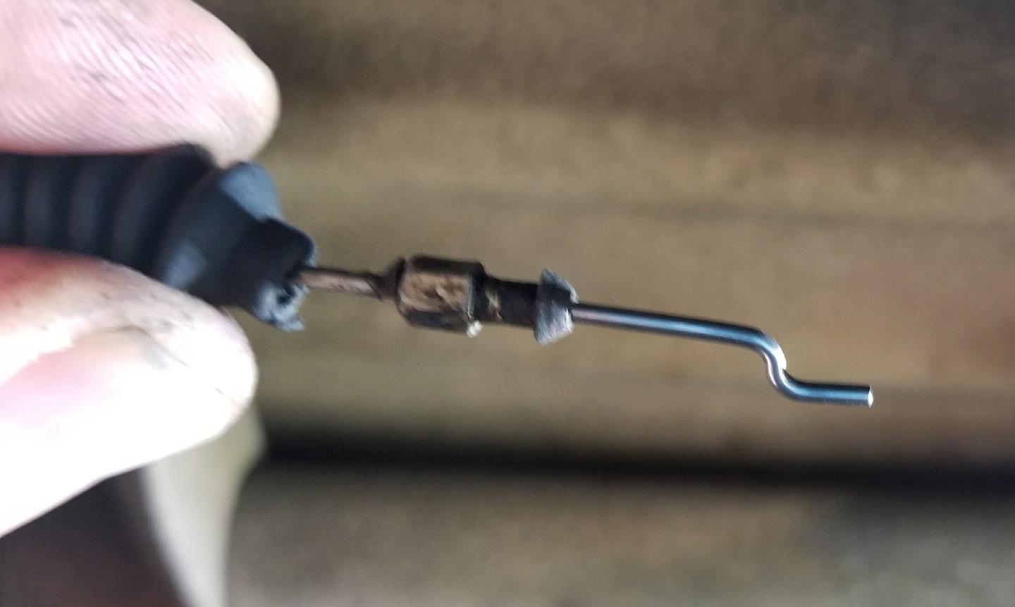

The Cable
The end of the control cable has a "step" formed in it. Note also the rust-colored metal "ball" that is at the tip of the rubber boot. This is more important than I ever imagined. I refer to this later as a "ball stop".

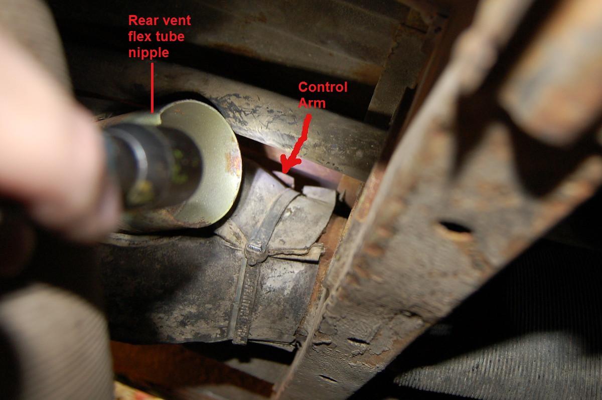

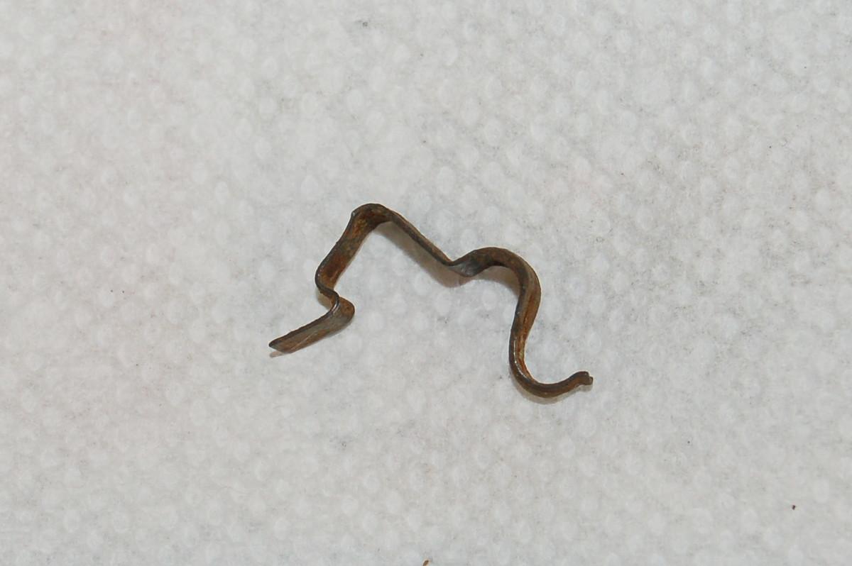

The Cable Jacket Retaining Clip
This is the clip that holds the cable housing/jacket to the valve control arm. The curved tip goes into a slot/hole in the arm, and the flat end snaps into a cutout in the end of the arm, locking the housing in place.

2. Insert the cable jacket retaining clip into the hole in the diverter valve control arm, placing the cable under it, but don't snap it down.
3. Pull the valve control arm toward the rear of the bus, pulling against the spring tension, all the way to the travel limit.
4. Push on the cable jacket so the ball stop at the tip of the boot sits right up against that hidden metal flange/tab the cable wire goes through at the top of the valve.

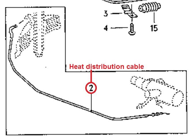

PostPosted: Tue Jan 26, 2016 12:05 pm    Post subject: 73-79 Heat Distribution Cable Adjustment Reply with quote
Thank you for posting.

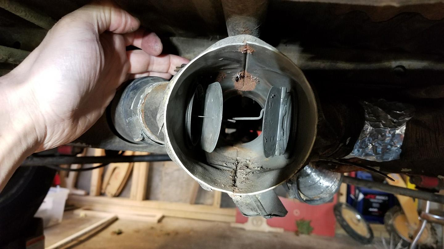

Anyone have the cargo floor cut out so they can post a pic of the Distribution distributor and cable. Can you please pull the boot on the end of the cable back so we can get a look at it.
So am I understanding this correctly?
The rust colored ball is crimped onto the cable?
The rust colored ball pushes on the diverter control lever?
When the rust colored ball is retracted. The diverter control lever returns to rest under spring tension?

Q1: Can you please pull the boot on the end of the cable back so we can get a look at it.
Q2: The rust colored ball is crimped onto the cable?
Q3: The rust colored ball pushes on the diverter control lever?
Q4: When the rust colored ball is retracted. The diverter control lever returns to rest under spring tension?
Thanks for adding those images to better illustrate the system. Darn difficult thing to photograph to be sure.
I'm going to continue to call the control valve lever, the "arm" to keep from confusion with the dash lever.
A1: If you're referring to pulling the boot back from the ball stop, I'm sorry but I tried and with reasonable force it wouldn't go. I didn't want to risk damaging the boot, and seeing what was under it wasn't material to the problem I was trying to solve. Under the boot is just bare cable wire and this ball feature, I can say that for sure.
A2:The ball is crimped onto the cable. It doesn't move independently.
The ball sits against the fixed flange/tab at the top of the diverter valve so long as the dash lever is within the "heat zone" portion of its travel. As the lever is moved downward into the "defrost zone", it retracts away from the flange as the cable continues to retract.
A3: The cable housing/jacket is clamped onto the diverter control arm. As the dash lever is moved upward, the cable lengthens, and with the ball sitting against the fixed flange/tab, the jacket moves away from the ball, and thus pushes the arm.
A4: As the cable wire and thus ball are retracted by moving the dash lever downward, this allows the diverter control arm's spring tension to move the lever towards its resting position (rear heat off). Further dash lever travel downward continues to retract the wire and ball, but there is no force applied to the control lever, as the cable wire isn't attached to anything.

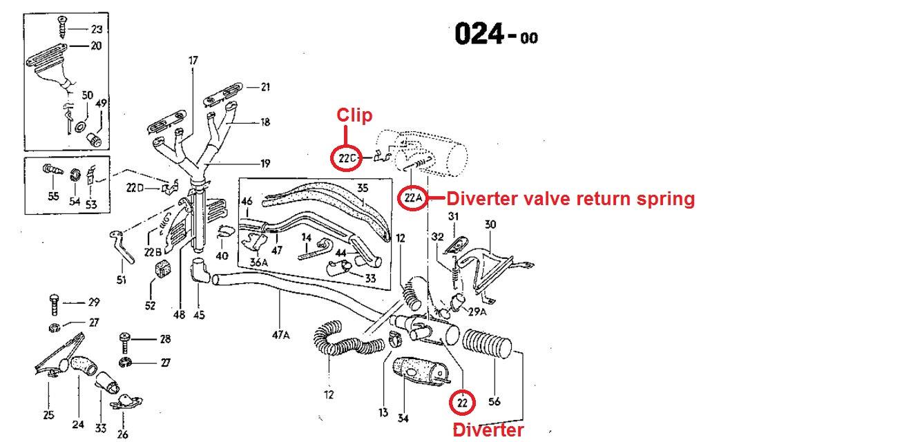

Take a look at this eche-bus, and let me know what your thoughts are? I searched for probably an hour and cannot find a pic of the Diverter valve. It would really help.
eche_bus wrote:
I couldn't find anywhere that documents how to adjust the control cable that attaches to the heat diverter or distribution valve, so I spent the afternoon figuring it out for myself, and now I'm going to document it. I'm referring to the valve and end of cable located beneath the bus just below and in back of the front seats. It controls whether heat goes to the front or the rear of the bus. The vehicle is a 1976 Westy.
The (Diverter) Valve
The Cable
The end of the control cable has a "step" formed in it. Note also the rust-colored metal "ball" (crimped onto the cable) that is at the tip of the rubber boot. This is more important than I ever imagined. I refer to this later as a "ball stop".
[b]The Cable Jacket Retaining Clip
This is the clip that holds the cable housing/jacket to the (diverter) valve control arm. The curved tip (end) goes into a slot/hole in the (control) arm, and the flat end snaps into a cutout in the end of the (control) arm, locking the housing (/jacket) in place.
Cable Installation
The (stepped) end of the cable wire is inserted through a small hole in a (fixed) metal flange/tab that sits atop the diverter valve. You can't really see this flange from the left side of the valve. The only way I could see it (just barely) was to remove the rightmost heat tube from the valve. The arrow shows what you can reasonably see of the flange. Trust me, that little hole is there.
You've got to wiggle the cable a bit to get that step on the tip of the cable wire to pass all the way through the (fixed) hole, so it's sitting on the right hand side of the flange. I found this completely non-intuitive, as the cable wire is then free to travel back and forth through the (fixed) hole in the flange, like it couldn't possibly do anything ... until I discovered just how everything is supposed to work. Here's a view with the cable end properly through the (fixed) flange/tab hole.

I sort of see how this thing should work - but am unable to achieve it. I just posted those pics to help others.
The cable on my '78 was not in place, but I put one in. Hopefully routed it correctly. I attached it at the dashboard - not too hard.
Now attaching it to the arm on the distribution box is not working for me.
Is the retaining clip supposed to grab the hard plastic sheathing, or the ball at the end of the wire, or is it supposed to go over that rubbery bellows where it goes over the plastic sheathing of the wire.
Lastly - or maybe I should have asked this first - when I thread the wire through the frame it is very long. So when I am attaching it to the distribution box lever the whole cable goes past the box, then has a loop, and is pointing towards the front of the bus. Is that correct?
-Kevin

Ok - this is how I think it works. In the absence of any cable - 95-99% of the heat goes to the front of the bus (think footwell or defroster). You lose 1 to 5% because these things don't seal perfectly, and a little goes to the rear of the bus.
By the way those percentages are totally made up.
When you connect the cable - and shift the left lever all the way to the top - half the heat should go to the front and half to the back of the bus. (not exactly half, but that is the general idea).
When you shift the left lever to the middle the heat goes to the footwell, when you shift the left lever to the bottom - the heat all goes to the defroster. At least in theory.
Hope that helps. I'm just trying to figure the correct way to attach that cable - I keep reading the explanation over and over.
I finally stuck my cell phone above the dist. box, and took a photo. Now I understand a LOT more.
Now I see a tiny hole, that I think the end of the cable goes in. I'll give it a shot, and see what happens.

I have been in all the connection places so I understand a little. I have never been inside a diverter box on an early or late bay.
The late bay and early bay are quite different as to heat. On an early bay there are two levers for heat. Each lever controls a heater box in the back. There is a lever on the footwell that determines how much heat goes up or down. There is a lever just under and a head of the driver seat that controls the diverter to the back. In addition there are levers on many of the back seat heat risers that turn them on or off.
On a late bay there is one lever that pulls both cables to the heat boxes. If it is hard to pull you can use a motorcycle cable sprayer to lubricate the cables which makes them work smoothly.
There is a lever that controls where the heat goes and the boost fan in the back. The sheath on the cable from that lever to the relay on the footwell is broken on purpose. It allows that lever to float in between front and divert so the defrost also works. Getting it right is a PITA and I have yet to get mine right. Then there is the diverter under the bus. Getting the cable on, and I believe a return spring along with the bellows is a PITA also. It is mostly by feel. I always though that the diverter was an on or off thing but seeing that photo now makes me wonder how it is designed to work. I may be judging how my 1977 works in heater flow compared to how my 1971 worked. Looking at the photo it is almost like the defrost and rear facing vents are designed to flow something all the time, unlike the 1971 which flowed all or none depending on lever settings. The thought process is kinda funky looking at that diverter photo. It is like turning the faucet on to brush your teeth and the shower comes on a little too expecting you will take a shower next.

PostPosted: Wed Nov 29, 2017 7:33 pm    Post subject: Re: How to adjust heat diverter / heat distribution valve cable Reply with quote
I think I've got it all working now...man it was a bear.
That little tiny hole in the steel, that I would have never found without my cellphone camera - was the missing piece for my brain.
The way it works - with left lever fully up - diverter is fully open, so half the air goes to the back, and 1/2 to the front. With the lever half way down - half goes to the front defrost, and half to your feet, with it all the way down - it all goes to defrosting.
That lever basically has two wires on it. One wire connected to the diverter box - in the up position the air is diverted. in the middle or bottom position the air goes to the front of the bus.
The second wire connects to the diverter under the dash. In the up and middle position - the air goes to the defroster and the foot heater. With the lever all the way down, the air all goes to the defroster.
At least that is how I think it works.
