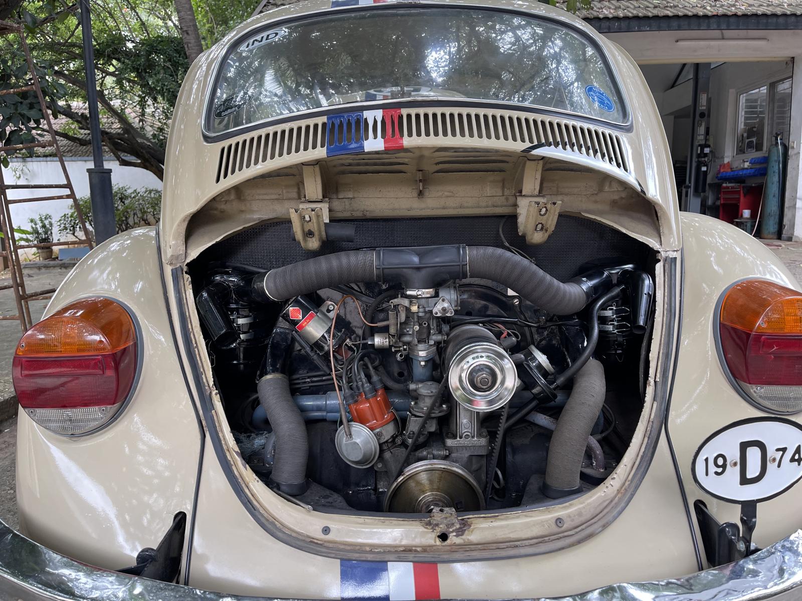

My first post in the Thing forum. Great post on these airfilters. There are at least a couple of Beetles here with option m153 “double oil bath air filter with serial cyclone filter”. One belongs to a friend and is parked in my garage. He’s missing the left side filter which he is trying to track down.
To your question, India is one of the countries which were considered dusty. Other specs for counties like India include m240 - “engine with dished pistons for low octane fuel”, m103 - “heavy duty shock absorbers”, m105 - “harder rubber bonded metal mount for gearbox suspension”, and m006 - “frame supported on front axle with heavy duty rear torsion bars”

SilverThing Premium Member
Joined: July 19, 2004
Posts: 850
Location: Everett
SilverThing is offline
PostPosted: Tue Oct 01, 2024 6:41 pm    Post subject: Re: Factory Air Cleaners Reply with quote
Thanks for your post bnam and welcome to the Thing forum!
That is good to know that India is one of the countries where the M153 option is commonly seen (at least on beetles). I assume that the 181/182 is rare in India, but maybe I am mistaken.
The heavy duty suspension parts is interesting. M105 exists in the 181 option code list as well, but appears to have only been used up until the end of the 1972 model year. I have thought that it was a strange option for the 181 because I would have assumed the 181 would have come with heavier duty rubber mounts as standard given that it is an off-road intended vehicle. I'm not aware of M006 or M103 as being 181 options.
What octane fuels were available in India back in the day? The M240 engines typically were rated for 83 research octane (ROZ or RON) vs the 91 research octane of "normal" engines. Unfortunately, I haven't seen any published motor octane (MOZ or MON) ratings for VW engines. I've been curious if lower octane rated engines was actually necessary or not back in the day.

bnam
Joined: July 02, 2006
Posts: 3544
bnam is offline
PostPosted: Wed Oct 02, 2024 9:15 pm    Post subject: Re: Factory Air Cleaners Reply with quote
Thanks!
Yes, Typ 18s are rarer in India. Not sure what the octane ratings were back in the day - they were not published. But a factor may also have been adultrated fuels - probably mixed with kerosene (?).
I've wondered whether M105 referred to the front transmission mount or the 2 rear mounts. Do you know?
I'm surprised that m006 was not a Typ 18 option as it reinforces the front beam and I would have expected the Typ 18 to benefit from that.

Are there any sites where we could find the stock left airfilter that is missing on the car we have?

A few weeks after I posted about looking for the left air filter, I happened to go to Bangkok for golf with some buddies. While there, I came across a VW event at a mall. In the swap meet, I came across the exact left air filter we needed. What incredible luck!
The next search was for the hose that connects the two filters to the carb. That was a hard fruitless search. Luckily we were lent a damaged one by another owner with similar set up. I took some measurements and modeled the center section in Fusion 360. I designed it to work with the standard paper hoses. a friend printed it for us in a rubbery material. Here is the end result

Congratulations on finding the missing air cleaner, bnam! The set up looks very good. I will have to look up the rubber material for 3d printing. That looks like a very good solution for parts like that. Do you recall what the material is called? I’m also interested yo hear how it holds up, if you don’t mind updating us in the future.

Sure. Will ask my friend what he used. And update on longer term results.
