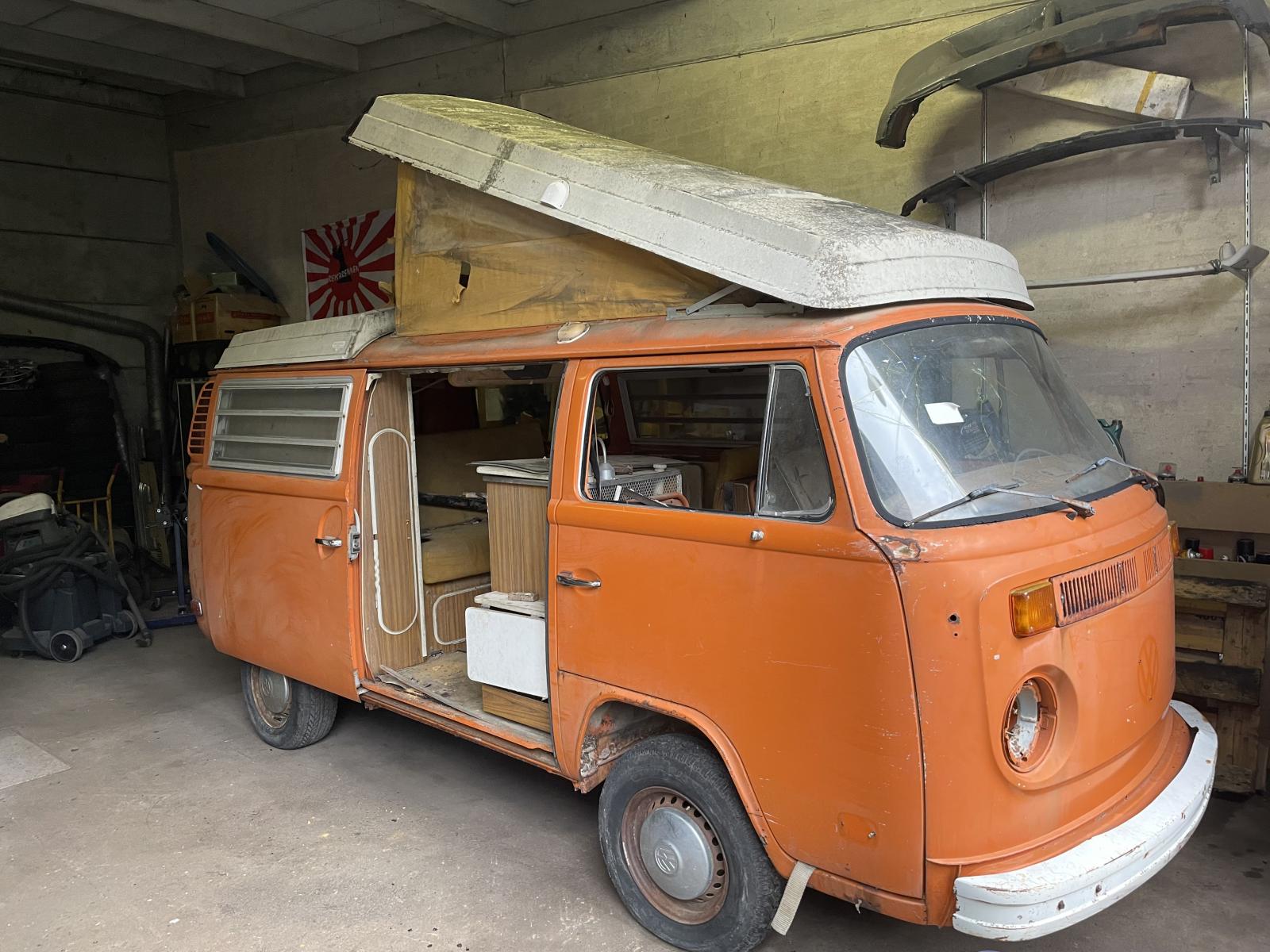

Here are some initial pictures of my '73 Westfalia project. Bought it some weeks back, and it's a 'US import 1700 TYPE 4.
I've just pulled the engine, and torn it apart to find, that one piston was totally destroyed, So the engine needs a complete rebuild.
Luckily there isn't a lot of rust, considering the age. I will post some more pics, as the project get along

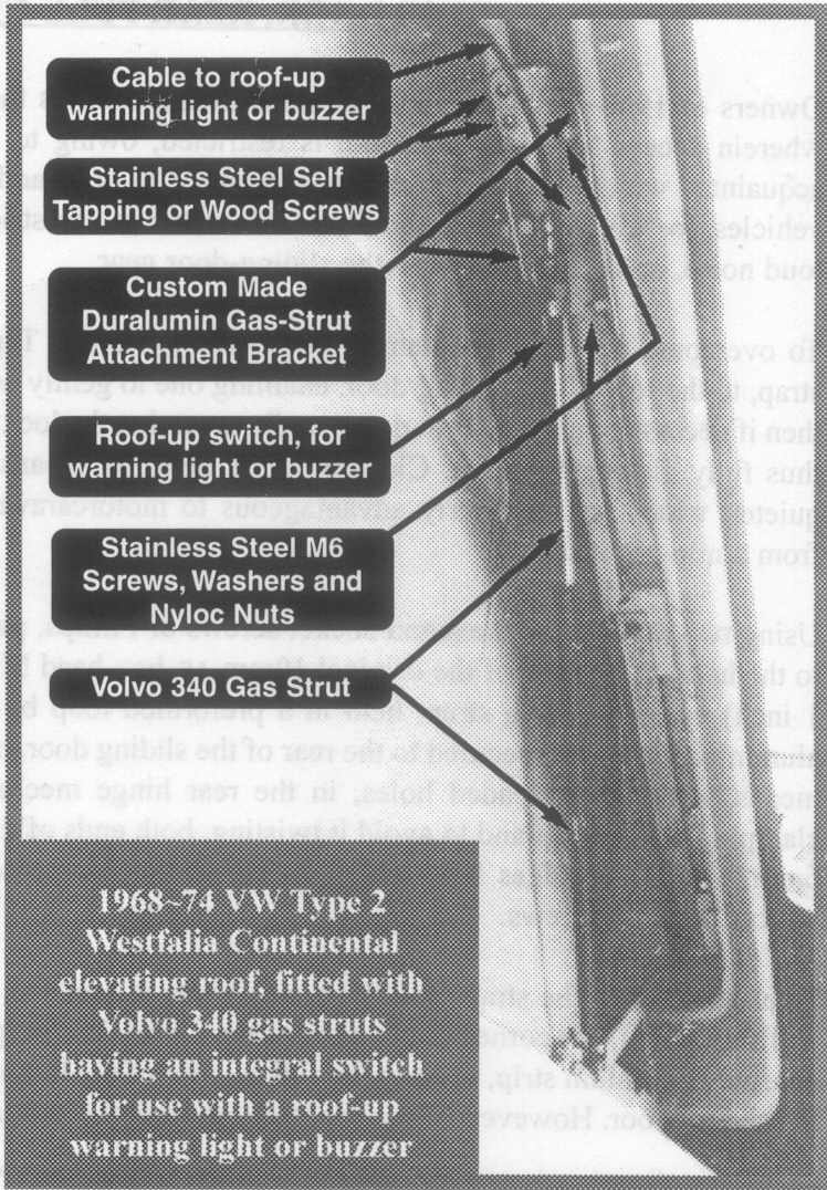

Depending upon how easy you and your family find it to raise the elevating roof, you might wish to consider retro-fitting a pair of gas struts (i.e. gas springs), which is discussed on the forum.
The standard Westfalia cutlery drawer is rather small, with no sub-divisions and wastes a lot of space above it. I fabricated & retro-fitted a larger one with five 2/3 depth sub-divisions in June 1975.
I later incorporated an electric water pump for the sink unit.

Got a bit further with the project this weekend.
Disassembly the engine bay to fix the rust, change the right batterytray - Including the rust which also appeared and welded a new right rear corner in place. The rust on the right rear side is new fixed. Time for the left side, which luckily isn't as bad.

Since my last update, i've done some more work.
Engine bay is now rust free, and has been painted Niagara Blue L53D, so once the engine has been rebuild, it can be fitted in the newly painted bay.
Today i've emptied out the whole cabin, to get an overview of all the rust.
So far so good Smile
