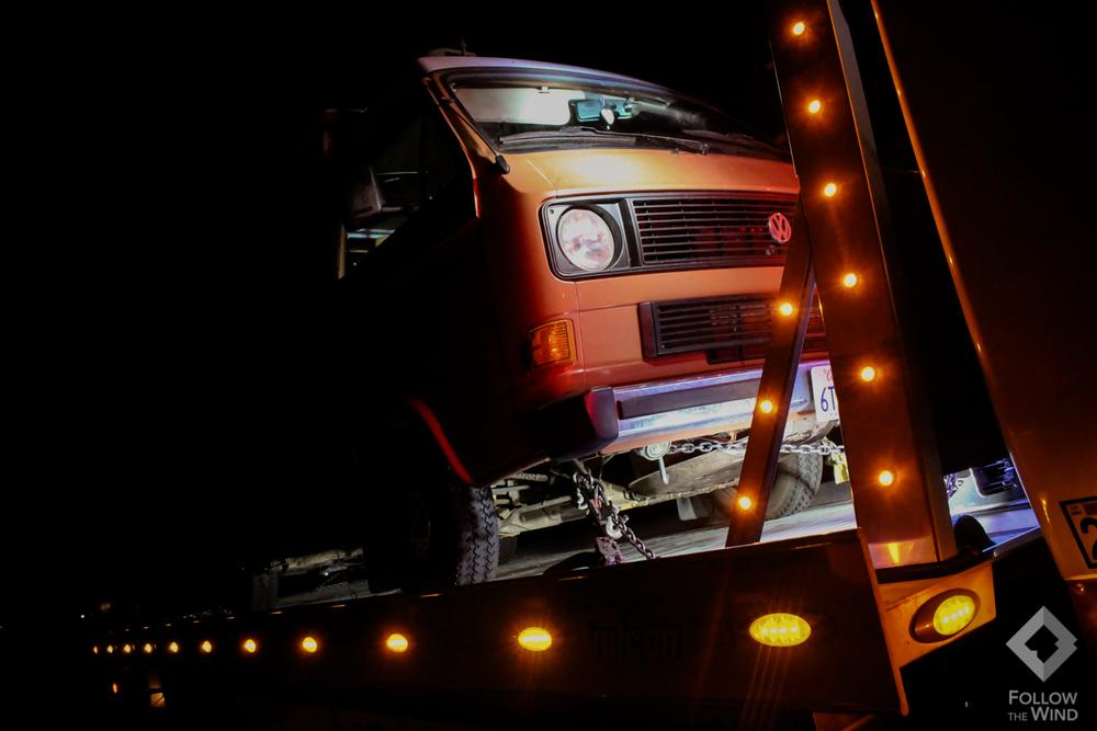

Well...part 3 is crazier than I could have ever thought. 3 tow trucks and nearly burning our van to the ground later, we still don't have our van. Here's the epic tale.
http://www.followthewind.com/blog/2015/8/22/aircooled-vanagon-to-m-tdi-swap-part-3-the-curse

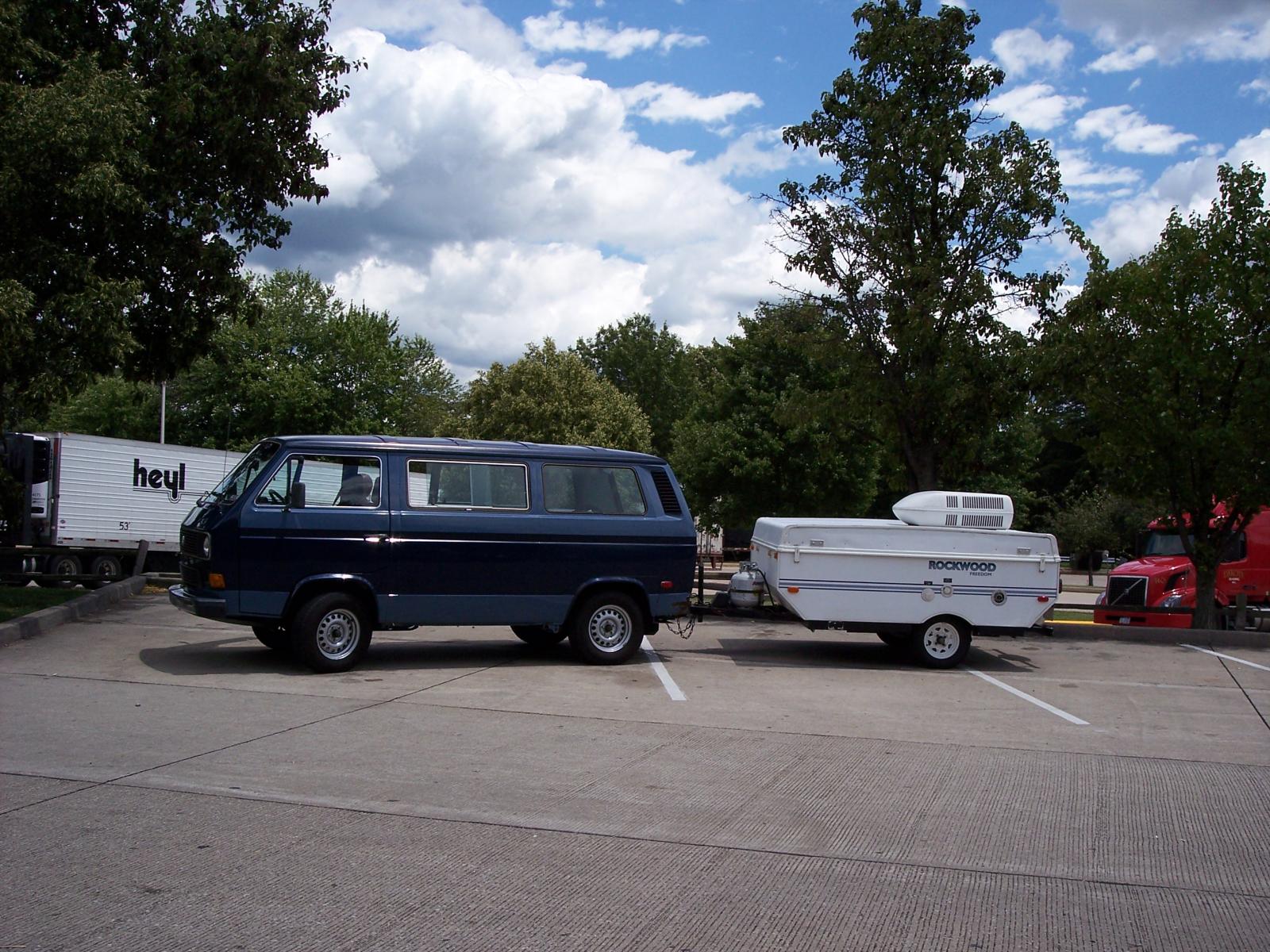

Lastly, below is a pic of the rig at a rest stop somewhere in Minnesota on the way to Alaska.

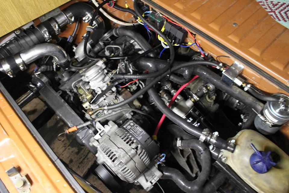

The swap is finally complete!!! Just passed a Semi-truck while driving up a steep hill doing 60mph!!! Woohooo! Only in a vanagon is that even bragging rights! I'm hoping I'll have the next post about the build in a week or so. Here's some preview photos!!
