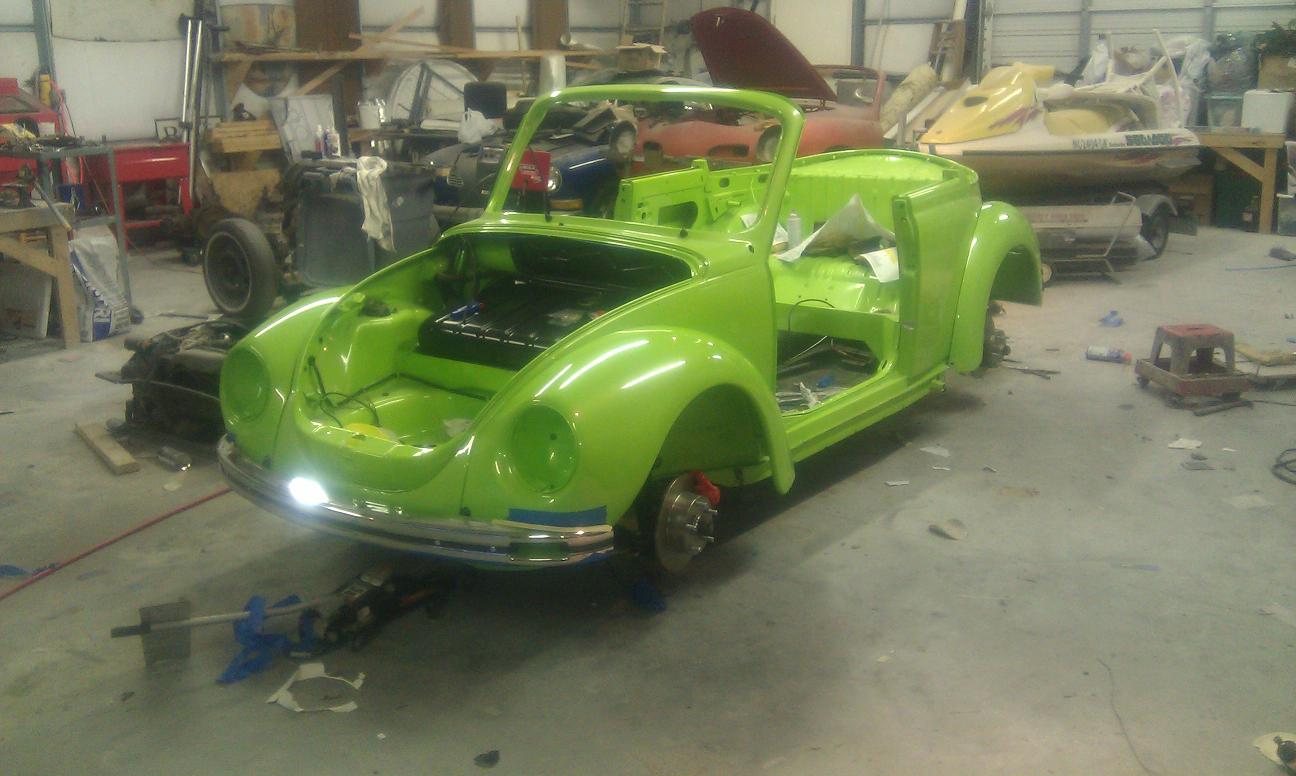

http://www.adjustflexsand.com/products.html This is by far the best block I have ever used. I do this for a living. What I sand is 30-40 feet long with many compound curves.
Also, if the area is not too large, a paint paddle wrapped in sand paper works great
Here is my latest paint project
79 super Vert
62 Ragtop Bug
66 tintop Westy
Porsche 914
09 Z06 Vette track car
