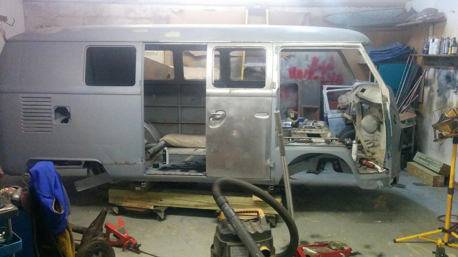

I've never done a thread on a bus so here it goes...
Heard about this one via the grapevine back in December and felt it worth my time.
A 67' sea blue standard. The PO had purchased it about a year or so ago as a running/driving original paint bus but stripped all the paint off it, took all the parts off it ( including running gear ) and put it inside the bus. He then proceeded to leave it outside and overdose and die Sad. His name was Pedro, so I call it Pedro's bus.
Built the same day (Jan 2 67' ) as my so42 ( 20 serial numbers apart ). This was the unseasonably warm December day I went to get it..
Installing the front end..
Fortunately, all the hardware was to be found inside the bus.. I think a VW bus is one of the only vehicles that you can take ALL the parts off of and put them inside the vehicle.
Rolls nice, comes with most parts which are (mostly) useable.
Took it home and mechanically removed the surface rust and put rust mort on it.
Installed some missing sheet metal:
Now its this :
Which some of you might recognize from Crukab's threads Smile
Next step is to sand blast some areas and epoxy prime it.

Passenger side rocker panels and close out pieces are done, floor is in, plug welds are next...

on the body everything but the nose is sand blasted and epoxy primed.
here is the roof

next up is to clean up and blast the underside

been busy on pedro's bus,
the body is epoxy primed now,
the underneath has also been cleaned up Smile

still plugging along,
the underside has been painted with masterseries .
the front cross member is almost done, I'm getting closer to finishing the 'bottom bus' stuff.

a little progress to report.
the underside is done the bus is now on a homemade dolly. lower nose area is next.

the last major rust repair is well underway, both sides lower doglegs and front floor as well as the bottom A pillar are in. Finishing up the nose is next. Then some general cleanup and touch up on all the welded areas and another coat of epoxy primer.

PostPosted: Mon Mar 27, 2017 5:24 pm    Post subject: Re: Pedro's bus - 67' sea blue standard Reply with quote
nose is almost done, ran out of welding gas.
All metal work is almost done!
Stay tuned for primer, the plan is to put another coat of epoxy, followed by build primer coat.
One downside to the epoxy is that once it dries, re coating it will be a pain as it doesn't sand well.
