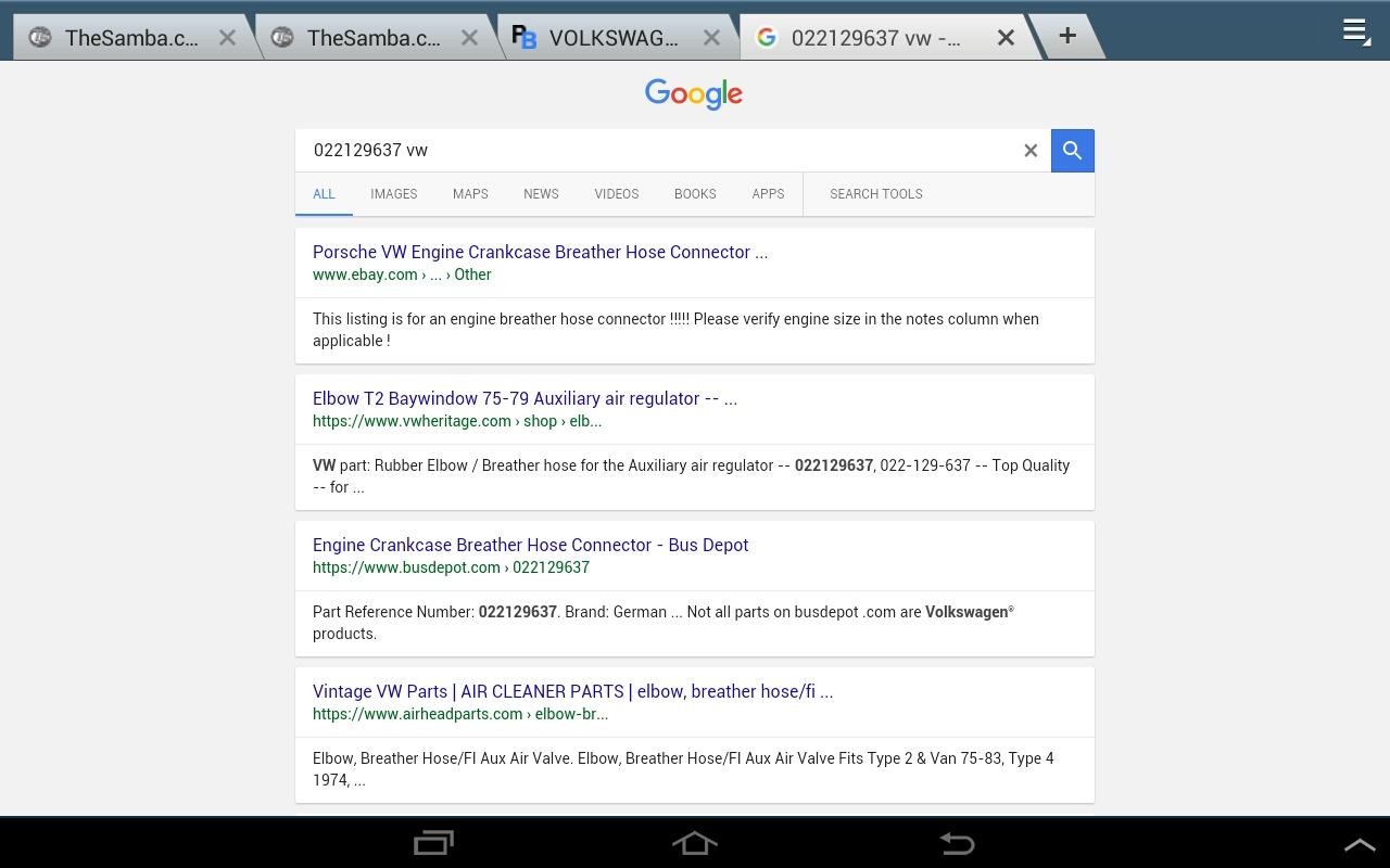

For the kind of questions you have. I like to use exploded views. For instance , your first question, in this view, we can see that there is a elbow in there. Says NLA, not to many infos, but gives the part number. Ohhh so sweet
With that part number. Have more info , even some reseller for those :
VW part: Rubber Elbow / Breather hose for the Auxiliary air regulator -- 022129637,
Voilà!
Many web site for exploded views. Here's where I took that picture. I read in the faq or in the technical part of this forum, about VAG site (but I think one have to register, which I'm too lazy to do).
http://www.partsbase.org/vw/vanagon-va-us-1983-27-overrun-air-system/ _________________ 1982 AC P27 - 2.0 FI FED - 091 - BA6

The elbow at arrow #1 is part number 022-129-637 (or 022129637), available from most suppliers.

Elbow for Aux Air Regulator
http://www.busdepot.com/022129637
