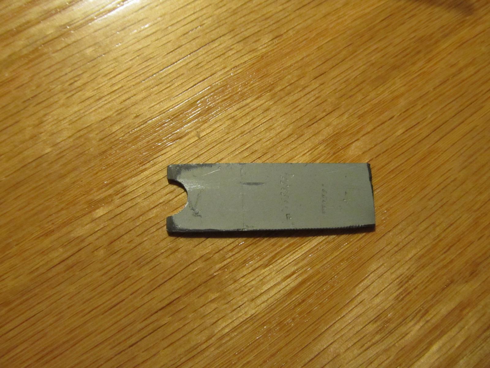

PostPosted: Tue Mar 08, 2016 12:03 am    Post subject: Re: Brake spring tool Reply with quote
Whipped this up a number of years ago from some scrap steel. Works great - can see the pin to line it up. I use it with a pair of vice grips normally. Total width is around 9/16", cutout is around 1/4" wide by 1/8" deep.
