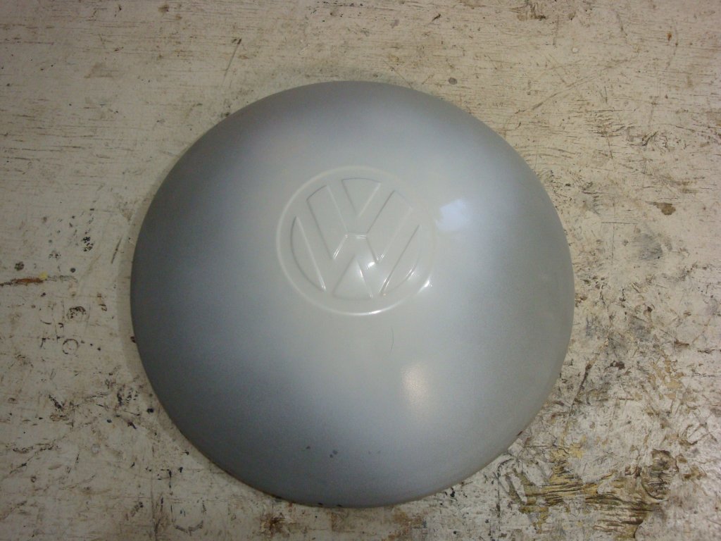

I just did some grey hubcaps and and have used the following method on chrome hubcaps in the past. Chrome caps are easier to clean-up afterward.
Supplies needed:
Hubcaps
Spray paint in appropriate color. I used Krylon Dover White below.
Lacquer Thinner. Can also use Paint thinner (weaker, may be more difficult) or Acetone (stronger, may damage painted cap finish but worked fine on chrome caps)
Small block of wood, I cut a strip from a 2x2 piece I had.
Clean rags cut into little squares to wrap around block of wood
Protective gloves
Steps:
1. Scuff up center emblem area, I used 220 grit sandpaper.
2. Wash caps with soap and water or a degreaser. Let dry.
3. Spray centers with spray paint. You can also tape off most of the cap to prevent overspray. I did not in this case. I let the paint dry for at least 1 hour in the shade or inside my garage before continuing. Exterior temperature was in the 80s so your dry time may vary.
http://www.thesamba.com/vw/forum/album_page.php?pic_id=492883
Close up of one cap:
http://www.thesamba.com/vw/forum/album_page.php?pic_id=492882
4. Wrap block of wood in a single layer of fabric and lightly run it across the center emblem to remove paint. Sunken emblem area remains painted. This will take several passes. I believe I did 15-20 passes from various angles and rotating the emblem around. Rotate block of wood when rag gets loaded up with paint or switch to a fresh rag.
Overview:
http://www.thesamba.com/vw/forum/album_page.php?pic_id=492881
Detail:
http://www.thesamba.com/vw/forum/album_page.php?pic_id=492880
5. Wiper off remaining overspray with clean rag or paper towels:
http://www.thesamba.com/vw/forum/album_page.php?pic_id=492879
6. Done:
http://www.thesamba.com/vw/forum/album_page.php?pic_id=492878
The caps above are reproduction hubcaps so the edges of the stamping were not as clean or deep as originals. This can require more care to get a clean edge.
If you have an old or extra cap, you may want to practice first.

Yes, I have done chrome hubcaps when they are still a bit wet.
On these grey ones, I let it dry for an hour. I also did 2-3 light coats a few minutes apart as the Krylon laid down better for me that way. If I remember right, I did one thick layer of black for my chrome caps but it wasn't Krylon paint.
I used very little lacquer thinner on the rag, just enough to dampen it. I hold the rag tight up to the can and tip the can against it. Then sort of spread the thinner out across the rag by dabbing it with another rag.
I did a bunch of testing on a 5th hubcap before I did my 4 for the truck. I ended up using the test hubcap in the end as it came out better than 2 of the others.
