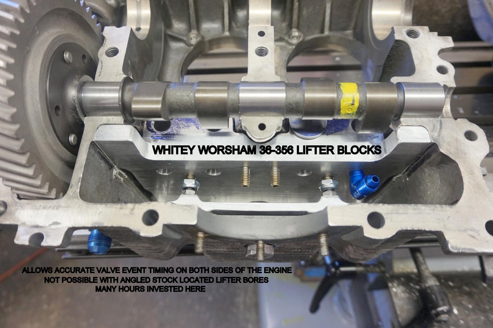

Porsche 356 lifters in a 36 case set up for racing

What are the benefits of installing 356 style lifters anyway?
Wider selection of cams?
The lifter will last longer?

A lot.
More aggressive cams can be used, and harder springs.
The valve timing operation get even instead of being advanced on the 3/4 side and retarded on the 1/2 side.
