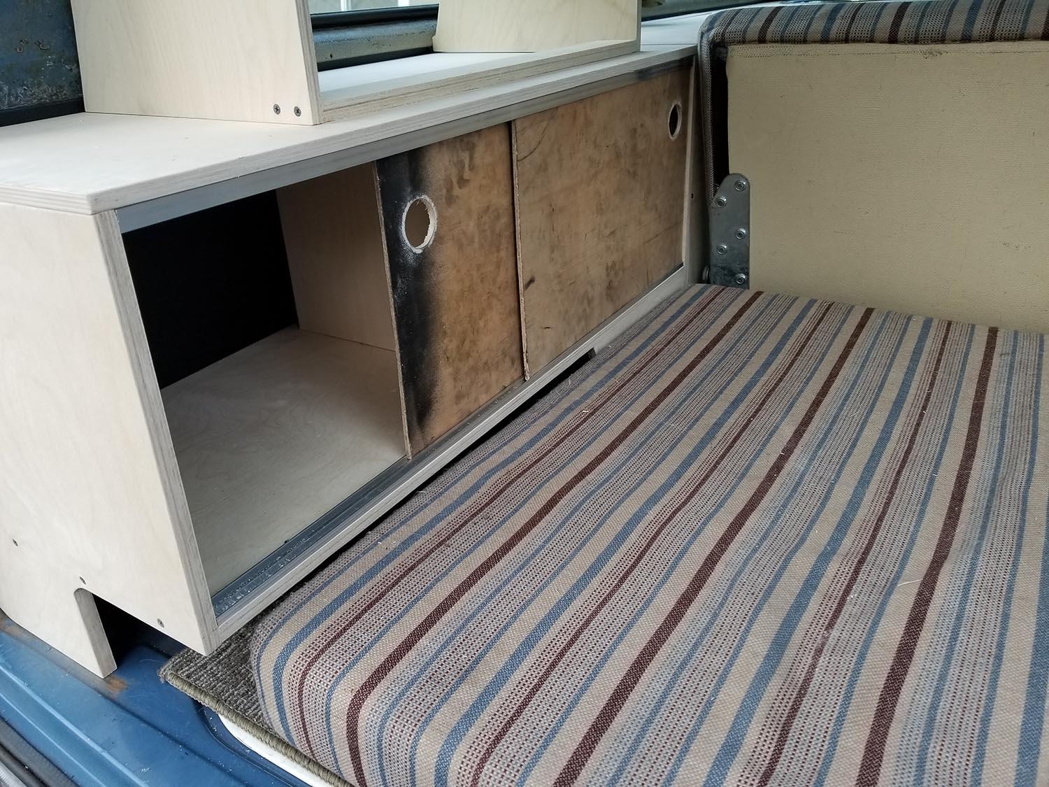

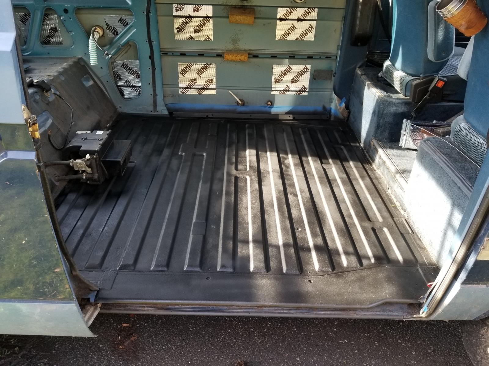

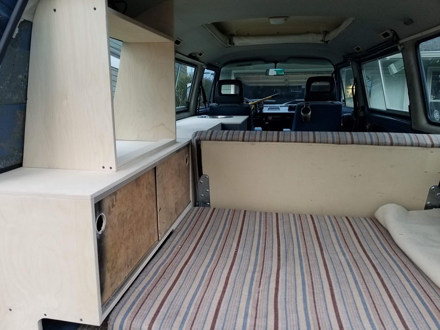

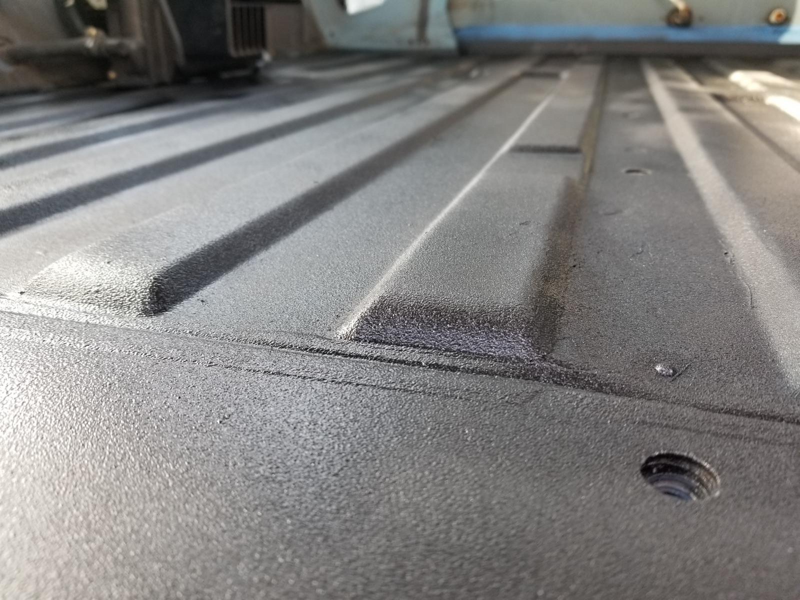

Third van, third time making cabinets. After pulling up the piece of linoleum laid down by the PO, my father, I found that there was a fair bit of mold and water damage to the original cabinets. The leak was coming in sliding middle window, above the kitchenette, and was running inside the wall and under the flooring. At that point I knew it was time for a full renovation. Gutted the interior, had the holes welded up, insulated the walls, and began cabinet build 3.0.
My last van had a somewhat similar design, but different construction method, and was written about here: https://www.thesamba.com/vw/forum/viewtopic.php?t=...highlight= The last set were one width fron to back, where as the new set juts out in front of the bed to accommodate the Engel 45. This is the final outcome of that cabinet build:
Here are some photos of the most recent build. All of which is built out of 5/8", 1/2", and 3/8" European spec Birch plywood. I used thinner where I could get away with in order to shave weight here and there.
Original cabinets being removed
Image of the carpet condition

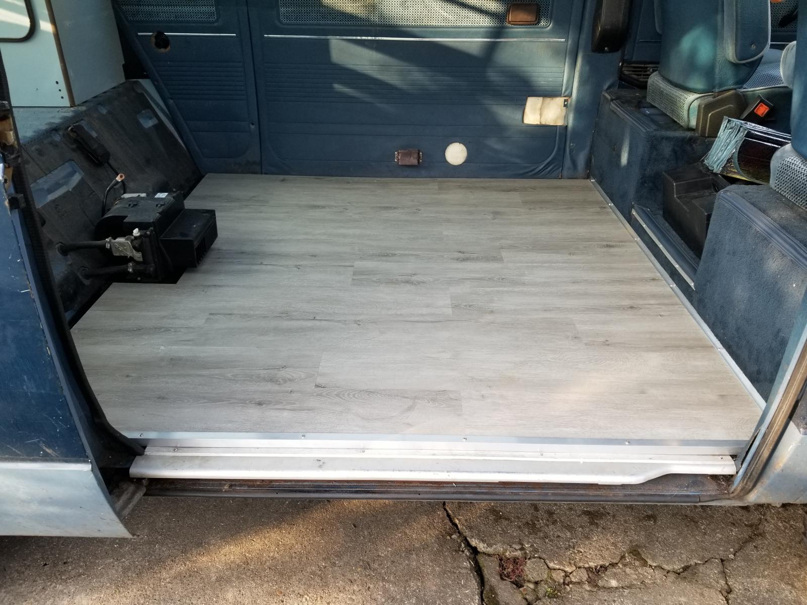

Floor trimmed in aluminum to protect the edges.
The first box to be made was a replacement for the westy bed.

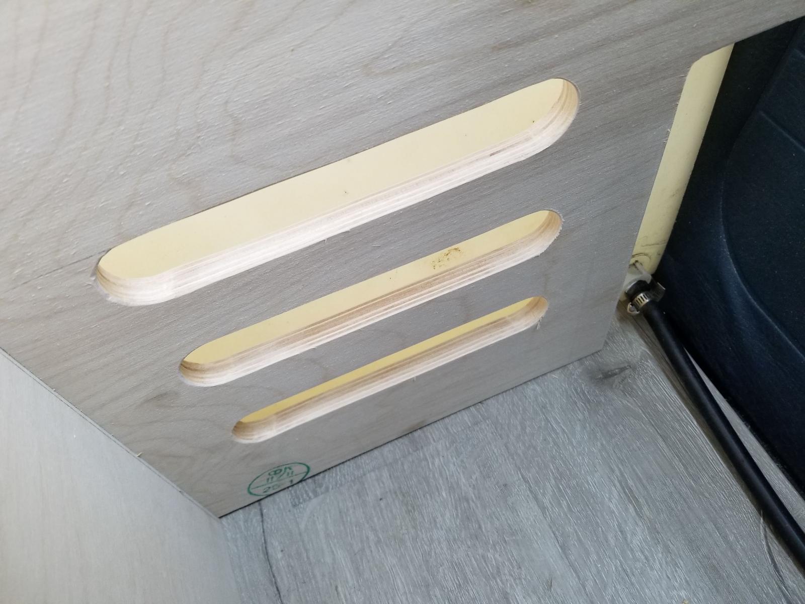

The European Baltic Birch has a more veneers per sheet, less voids, and nice thick veneers for the faces, as opposed to a thin sheet.
Building the kitchenette box.

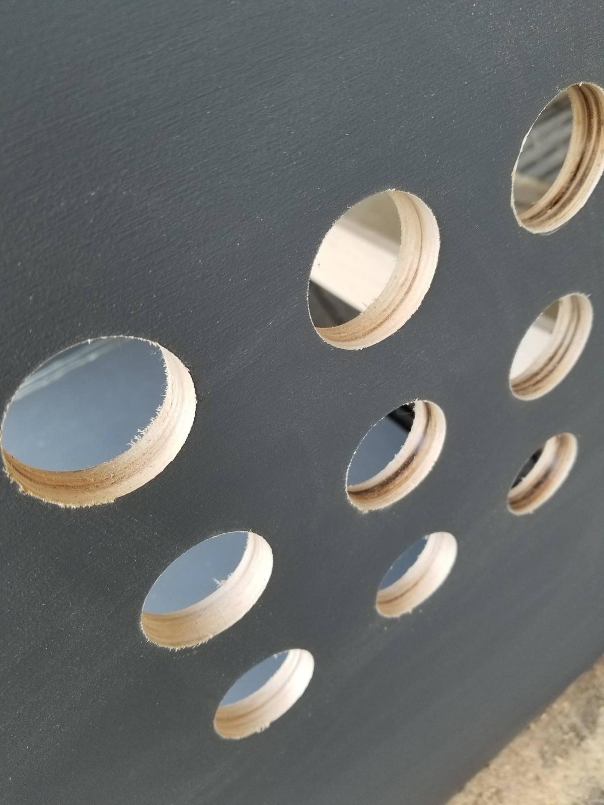

Drilling holes for fridge ventilation as well as a little weight reduction.
Particularly proud of this little joint that runs along the top of the middle cabinet.
More cutouts for weight cuts, plus these allow me to see into the water tank.

WOW! Impressive! I'd love to see more pictures of the build. I have some cabinet ideas that involve similar elements to your frig set up. What brand/weight capacity of drawer slides did you use and what kind of locking mechanism will keep yours from sliding out while driving?
Hans
Thank you! The slides are just the ball bearing slides from Home Depot, so rated at 100lbs. Fridge with food should be less than that, but may opt to purchase some heavier duty slides with the locking mechanism built in. These are just what I had handy.
Currently, I have a slide latch in place that goes into the platform to keep it from moving.

Beautiful! I love seeing good ideas executed well. It also looks like you kept things fairly simple and effective.
Was the water tank a custom build or did you find one that fit perfectly? Where did it come from, a marine tank provider?
Thank you for the kind words. Definitely trying to keep things simple and light as possible.
The van was originally an ASI Riviera, so the water tank that I used is the one that it was originally built with, so is custom shaped to fit the contours of the firewall.

Really nice work! I've been following along on IG but it's nice to see the detail and pics here. Thanks for sharing.
How is the cabinet anchored to the van?
Are you planning to build out more storage at the hatch end?

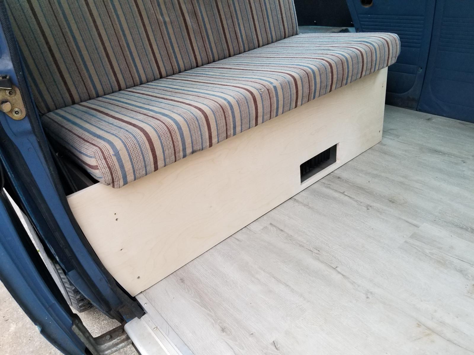

Yeah, building a base cabinet now to take up that rear third, next to the bed. Going to do bypass sliding doors so I can access the contents without having to swing anything outward towards the bed. There is now a divider panel halfway to add support to the countertop. Once this is done, I will begin building a small cabinet that sits on top with cubby holes. The top of that cabinet will also, likely, house my solar charge controller. (it will also hide the ugly torn headliner.)

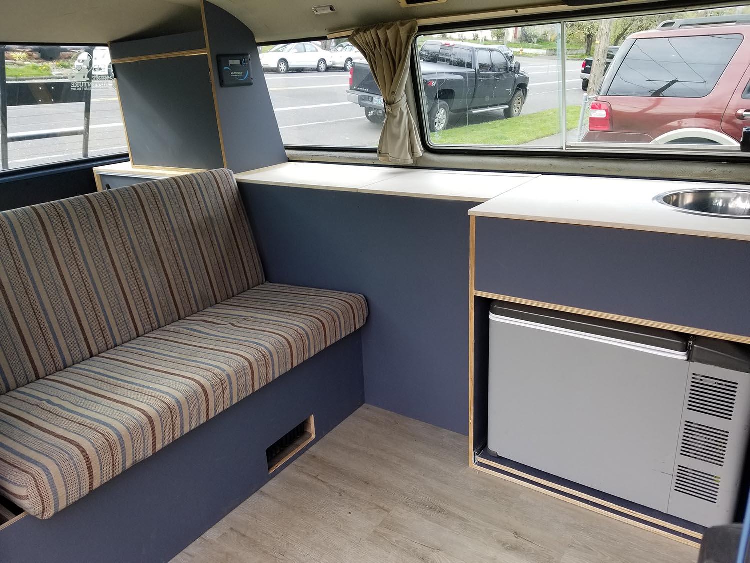

Got around to painting this weekend, as well as building the upper cabinet in the back. I originally had planned, and built, a little cubby, but found it to feel awkward size wise. Went bigger, and am currently happy with that choice. The panel on the upper cabinet will hinge from the bottom, making a small table perfect for watching a movie in the back.
