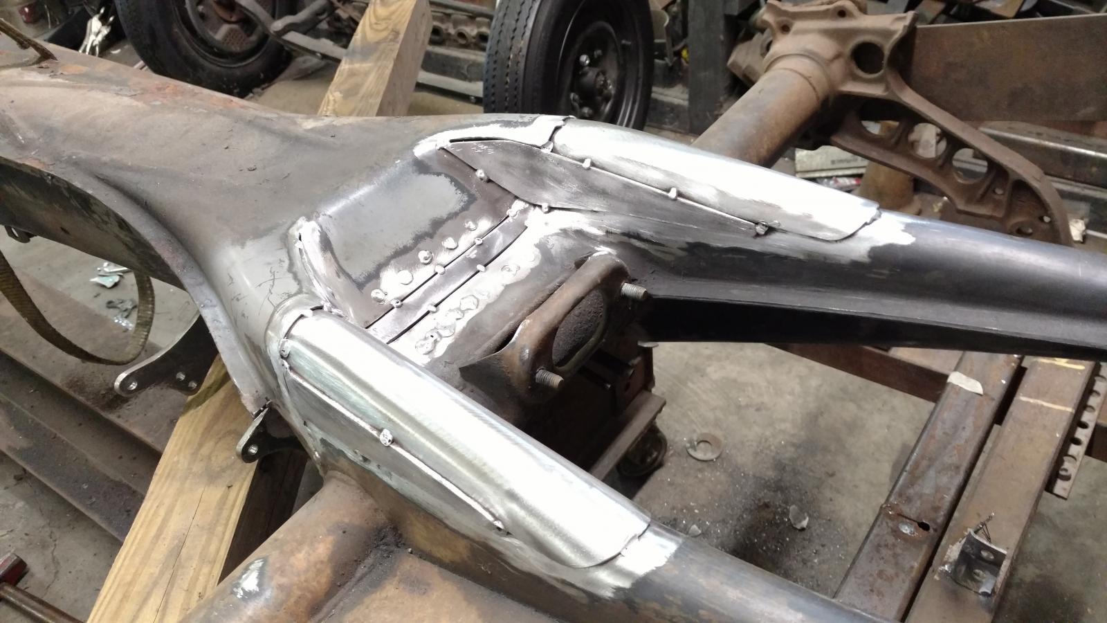

KCW did a few. I did one on my bubble car project. Multiple ways to do it. Most I’ve seen chop off the frame just forward of the torsion tube and weld in a 1/4” plate there. Then weld the rear frame section to the plate however high up they want to go with it. Then gusset both sides of frame with more 1/4” plate. I did it by removing the bottom of the tunnel and pie cutting the tunnel before and after the torsion tube so more of a Z’d frame. But I wasn’t constrained by a typical body so I was able to take more liberties.
Curious what you are trying to build? Depending on what you are trying to accomplish it may be better to just channel the body over the frame. Helping a friend do that on his project right now and it’s fairly easy if your heater channels are already nonexistent.

Kind of the best angle in my gallery for how I Z’d mine. There’s a few others. Looks like you could either Z or do the plate method and it would look fine. Nice project.

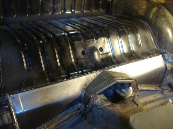

I am assuming this is the body you are using for your project?If so,you could use the same method I did-I am building one similar.I used a torsion bar housing from a wreck and lifted it 3 inches and went back 61/2 inches.I used some 6mm plate as a template to line it all up.If you check my post on here there are pics."Hot Rod Beetle Ute"
