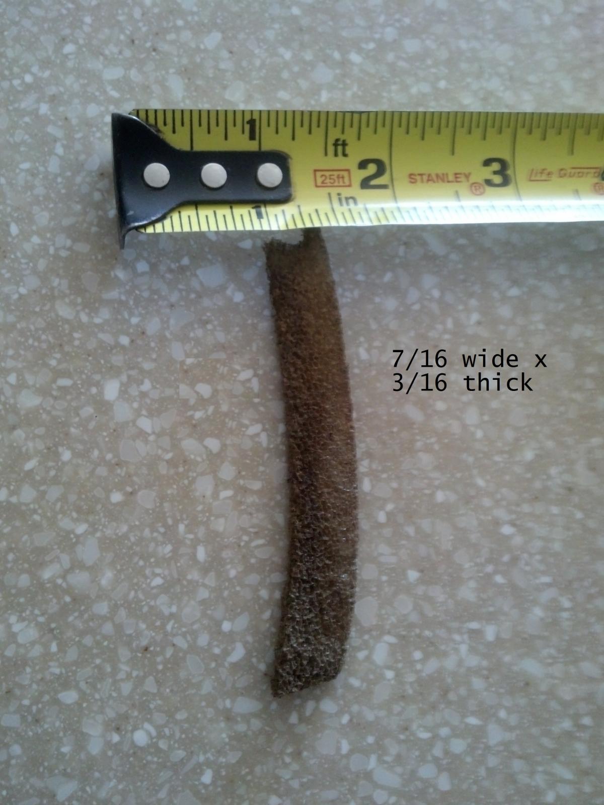

Hello all,
I pulled the firewall on my 74 westy with an eye to replacing the fuel hoses. In the process, a thin piece of foam fell off the bottom of the firewall. It looks like it is made of simple open cell foam. It is a little brittle but still somewhat squishy. Here are some pics.
Foam still intact and attached:
Foam missing from bottom of firewall
The missing piece of foam. Looks to be 7/16 wide x 3/16 thick
I found this at the local HD. Size seems right but not sure if heat is a concern.
Anyone else replace your firewall seal and what did you use?
Thanks!

PostPosted: Fri Jun 10, 2016 12:12 pm    Post subject: Re: Engine firewall seal Reply with quote
I would use a bead of plumber's putty. I never liked the idea of foam, since it would be inflammable (what folks call "flammable" these days) and not really airtight anyways, and certainly not gasoline tight.

PostPosted: Fri Jun 10, 2016 12:37 pm    Post subject: Re: Engine firewall seal Reply with quote
But, now that I think of it, I have never tested the plumber's putty with gasoline... Think
msds indicates it is 30% petroleum products.
