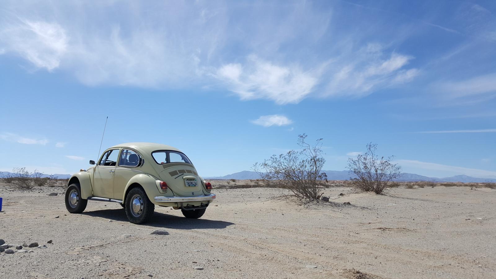

So I have been away from my beetle for a while, and have been looking at options for its future. I have seriously considered turning it into a baja bug because it is already banged up. Should I work on a class 11 look alike or buy a fiberglass kit and turn it into a baja bug.

I am working on a class 11 type of bug, although I prefer to think of it as just a trail, or explorer bug. I guess in my mind, that is what guides your decision. If I am building a baja bug, it means bus trannie, 3 x 3 arms, full roll cage, relocated shock mounts, and all that goes with that. If you dont need all that for your purpose, and prefer just a tough bug, why not class 11? Besides, its a cool look, and a smaller budget. Of course its just my opinion.

The things i like about my class 11 Style
I like the look
my spare tire fits and i have trunk space
My engine is covered from the elements and random hoodlums
The car is heavy...i feel this helps the stability and ride quality.
The extra metal and body parts keeps things quieter and less air blows through
A little more metal may help in an accident
I have decent suspension travel , I dont have any rubbing on fenders but i also have a body lift. I think my existing travel would have my tires hitting the fenders on occasion if i didnt have the body lift.
If you like to do high speed off road and jumps or use strictly as a play toy a baja kit style might be better. A lighter baja style may feel a little faster because there's less weight to push
I use mine as a "get me there and back" vehicle not as a toy to just rip around crazy , although i have done a little of that

I myself went the baja route and dont regret it but a class 11 is just as good. I also like the look of your paint and with a baja kit youd have to paint it. So my opinion is leave it stock body go class 11 and beat the hell out of it.

Class 11! When you damage the body bad enough, Baja it. Most of the Baja kits fit like crap.

I voted 11 just because that car looks pretty straight... it actually looks awesome as is! That being said, it kind of depends on how you plan to use it. I loved my 11, but probably had more fun with my Baja. It's really a personal choice, both are good options.

Class 11s are far more capable ( spare tires and gear under hood) than a baja with stock suspension. My friends went the baja route and regret it now.
The only reason to baja a bug is for more suspension travel. At that point you may as well buy a baja already built. Much cheaper to buy someone else's Money pit.
