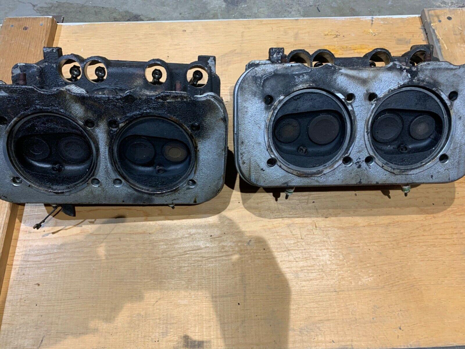

I want to buy a pair of used Type 4 2.0 heads. I have a spare motor that dropped a valve and don't want to put a lot into it to asses the rest of the condition of the engine. I found a pair for a reasonable price, and the seller insists they came of a good running motor. I don't believe he is an air cooled guy however and may not realize a valve has dropped. I am mostly concerned about the left most cylinder. Seems like there is oil build up and the exhaust valve indicates that it may not have been burning fuel.
Whatcha all think? Chance it or run?

imho used stock heads are 25-50 bux each depending on the stud situation.
you can't visually check much...they need to be taken apart. really the best you can do is look for sunk valves, or valves that have started to stretch

the color and texture of the aluminum indicates that they have been rebuilt before. Set aside $1000 to $1500 for a set of heads.
These are the cheapest I know of. They are reworked by AVP which is like a modern GEX. They aren't going to last a long time. https://www.busdepot.com/022101061lx . Notice the lead time.
These are about the next best thing. They are 40,000 mile heads.
If someone wants something good for as long as they own the bus get a set of new heads from Len at HAM. About $1500 a set as I recall.
If you can't afford one of these options then park your bus and rent it out as a small bed and breakfast, or maybe a chicken coup - or maybe both.

add a 0 to those numbers Don for 2L and then $1000 more to rebuild them unless ine goes with a hand job that last 350 miles.

he wants a pair of heads to slap on a mystery engine...I get not wanting to spend the $$ on an experiment.
I don't follow the value of T4 stuff, so perhaps i'm low...either way...I wouldn't spend (gamble) real money on mystery parts that are known for exploding.

If someone is willing to spend 250-500 on type 4 mystery heads....PLEASE PM me.
OP take the heads apart and see what you can see/feel what you can feel.

50 bucks for both. If seller isn’t even willing to clean them up for inspection, they are like scrap value

The condition of used heads must be checked just as you would check the condition of a used transaxle. Install and then drive.

I am aware of all the new options and what is the "right" way to do it. If I was building a motor, I would go all in. My bus is currently on the road and running just fine. I have another (spare) 2.0 that was redone 18K ago by a known shop in Cali. It dropped a valve before I got it so I want to slap a set of heads on it, and see what it will do on the stand. That is all. I am willing to spend a little money on that experiment, just not a lot.

Good luck with where you are going with this. Anything you buy as a core head will cost you more in time than you can get back selling the motor as is. If you "dropped a valve" then the piston and probably rod are trash. If you "dropped a seat" then have the heads reworked by someone like Adrian. He's cheap.

I am not selling the motor at all. It actually didn't drop a valve,it dropped a seat a seat. We suspect the bottom end of the motor is solid. The rods and pistons all look good. My game plan is to simply re-ring, put heads on it and fire it up. If it posts good compression numbers, end play checks out etc, I will just put in on the shelf as spare. It's not about cheaping out. I am just really trying to keep this as simple as possible.

Sorry I misunderstood. Maybe the "Stoned" part gets in the way. Send your heads to Adrian.
