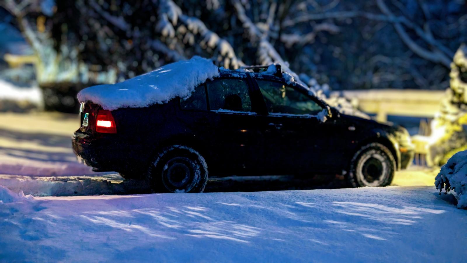

Too bad Wavetrac doesn't make a diff for our vans. I put one in my TDI Jetta and it works great - especially on snow & ice. Really digs in and grabs with proper winter tires. I did a lot of research on this. Peloquin did not have stock (for my Jetta with an 02M trans). Quaife and Kaaz were also options.
https://www.wavetrac.net/technical.htm
It's pretty much a snowcat now...Of course I put a $7000 Bora six speed trans + LSD in a $1500 car Laughing
