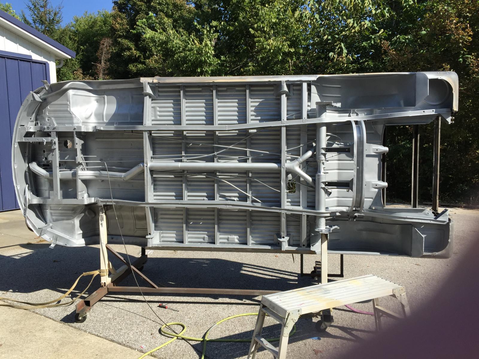

PostPosted: Fri Oct 07, 2016 4:34 pm    Post subject: 60 splitty build Reply with quote
finally got the belly sandblasted and rust treated with rust bullet. any suggestions as to what i should add before i upright and add the beam and tranny?[img]

Seat belt mounts

replace all the shift bushings (front and rear) - probably easier that crawling around under it when the bus is back on its feet

Clean out all the tubes (heat, throttle, clutch, e-brake, fuel reserve, etc. and make sure they are intact with no kinks or holes.
Put final paint on the bottom and install the hard brake lines.
