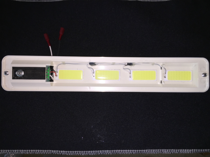

I just upgraded a few of the lights in my 93 EV weekender to LED and I'm very pleased so I thought I'd share.
First I changed the stock incandescent 39mm "Festoon" lamp located in in the threshold of the sliding door at the bottom of the B-Pillar. The stock lamp drew about 380mA, the LED replacement was about 30mA and much brighter. The Lamp was about $4 for a pair on Amazon Prime. This was a direct swap so no guide provided.
Next, I rebuilt the rear cabin lights which are the long Fluorescent lamps, one located over the pop-up table on the driver and the other near there rear on the passenger side. These originally have the florescent Philips 11watt (11W PL-S 11W/827/4P ) lamp. Mine didn't work but 11watts at 12 volts is essentially 915mA (.9amps).
This is more of a share than a DIY thread but... here is a rough guide as you can use many different components so some of my reference of (cut, glue, drill...) may vary depending on what materials you have at hand.
    *Buy some COB (COB= "chip on board") LED boards (I bought some 20mmx50mm 36 emitter 6000k units from Amazon)
    *Buy a PWM variable motor speed control (these work for LED level control too)(I bought the 1803BKW from Amazon)
    *Remove the whole lamp assembly from the Van
    *Remove the fluorescent lamp from the assemble
    *Flip it over and pry the cover off the end where the electronics are
    *Remove the solder from the two large solder dots, these are connected to the switch and holding the board in the housing (I used solder wick)
    *Pry the electronics out
    *Remove the switch
    *Cut a piece of thin black plastic slightly larger than the hole left from the switch you just removed and glue it on from the inside
    *Fix the LED's to the Lamp assembly (Mine came with 3M tape pre attached)
    *Wire the LEDS in parallel
    *Drill a hole in the plastic you glued in for the potentiameter to pass through
    *Hot glue the circuit board in the cavity where the old electronics were
    *Install the potentiometer in the hole you drilled
    *Connect the last LED of the series to the output of the controller board
    *Connect some wire to the input of the variable level PWM controller, route out of the Lamp housing
    *Put a dab of hot glue on the wires to hold them in place and create a strain relief for the wires exiting the lamp housing
    *Connect the wires to the original power/ground wires in the Van
    *Re-install lamp housing in van ceiling
Here are some pictures:

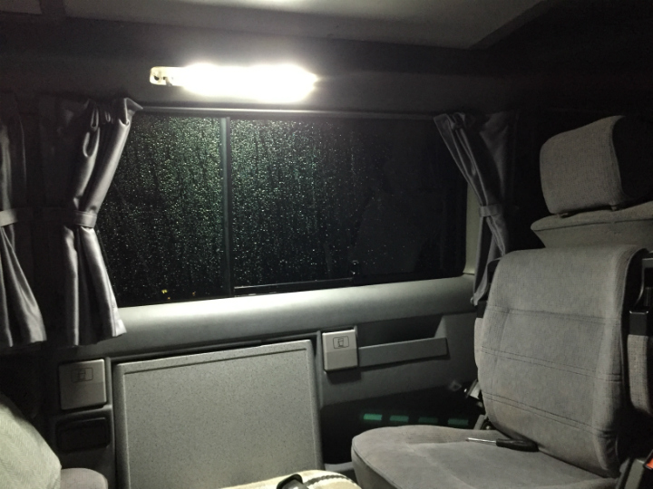

Here is the light on the lowest setting which as I recall was less than 50mA, it is a very soft light, perfect for night time (picture taken at midnight, it was otherwise pitch black out)

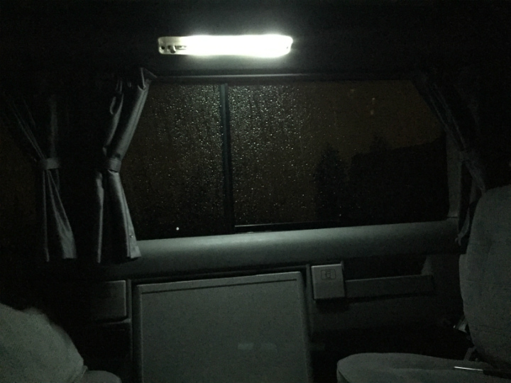

Here is the light on the brightest setting which as I recall was less than 300mA, this is quite bright, it seemed like day time (picture taken at midnight, it was otherwise pitch black out)

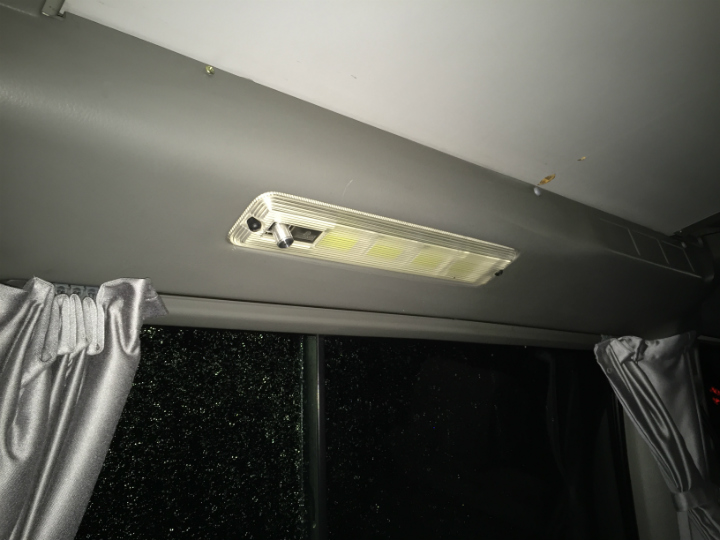

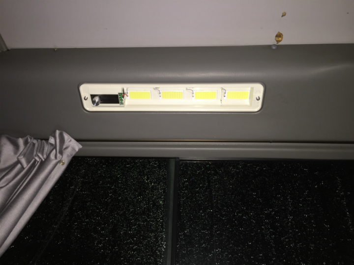

I finally got around to posting some pics of what I did with my lights:
I converted them to the LED's and here's a pic of the further one as stock and the near one LED:
Another Pic:
A pic during the day (you can see the LED's in it):
A pic of the 2 way switch. Position 0 is off. Position 1 is where it operates with the doors. Position 2 is just like it is stock. I tapped into the front light and then ran an extra wire to each light. So when I when I have the front light to where it comes on when I open the doors, the rear lights come on too. When I switch the front light on with the doors closed, the rears come on too. In the end, when the front light is on and the rears are on position 2, the rears are on. It even has that delay to stay on for a bit when you close the doors. I did use a relay because I have no idea how much amperage that front light can handle.

One set of LED I purchased although similar in rating were much to high of current draw and got too hot, even with a metal backing plate for heat sink so I tried another which matched the van's voltage better. I used a dimmer and would not have it any other way.
