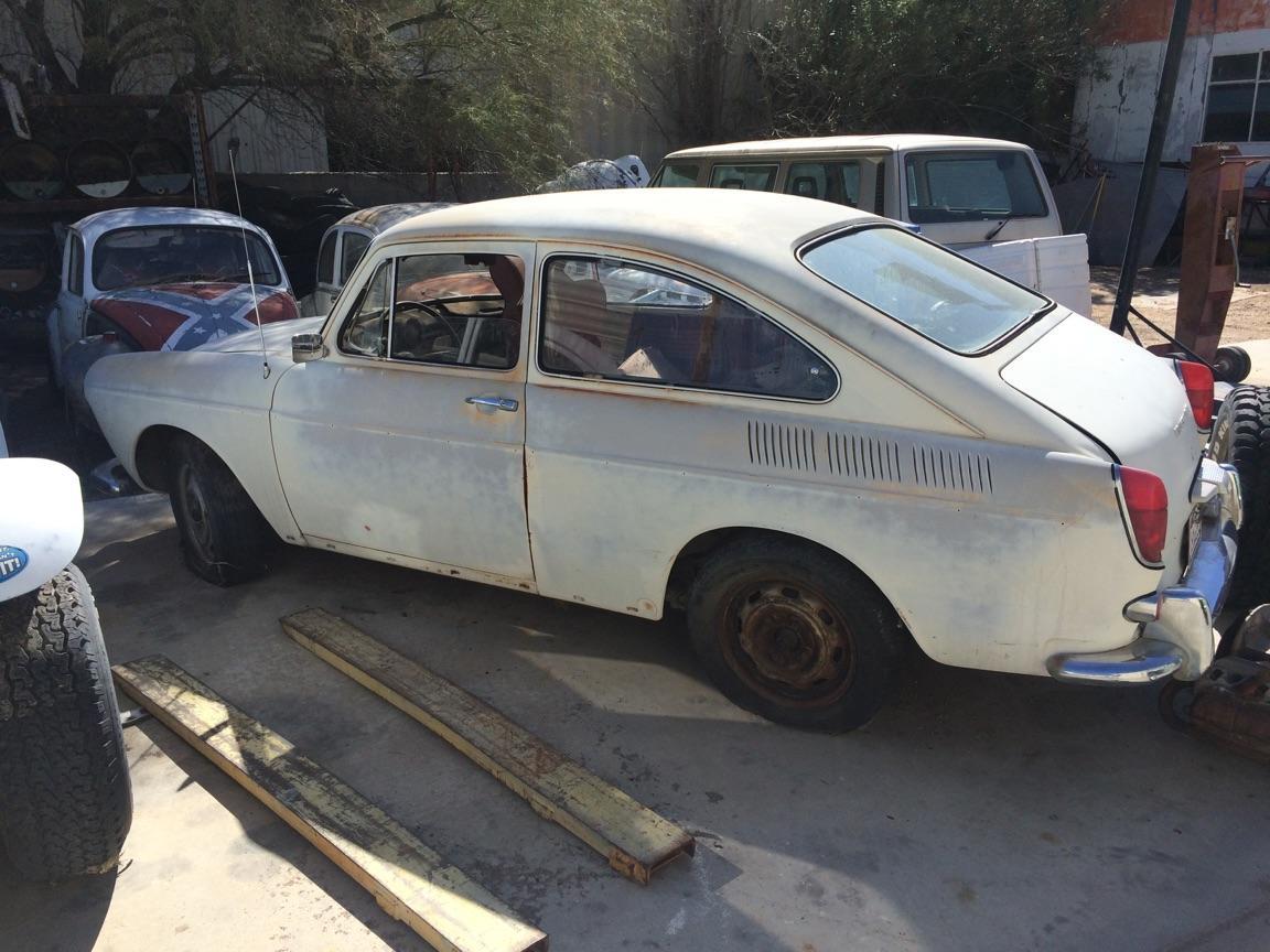

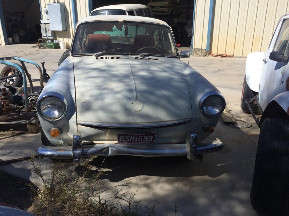

Been wanting one of these for along time. Was talking to my friend one day who lives in Tucson Arizona about it, and he says he knows of one available. Deal was made and car was shipped up to me in Oregon. It's a 68 Manual trans injected.
Now for the fun part, car hasn't ran for who knows how long. Last lic tag was 1990. It has obvious signs that they were trying to make it run, or chasing a problem. Has 1 computer hooked up and another laying there, fuel pump removed and sitting under the front hood, MPS removed and sitting on the floorboards. Fuse block hanging out of dash, relays half disconnected. So yeah I have my work cut out for me in diagnosing whats what. The Arizona sun has completely fried all the soft rubber and interior, but what was really important and valuable to me is that the steel is in great shape with near zero rust cancer. Only two spots on rear parcel shelf. Stay tuned for progress. and questions from me on this early FI system that i have lots to learn about. I have already ordered a Bentley manual since I seen it mentioned several times in this forum and have been told to get.
Arriving in Oregon

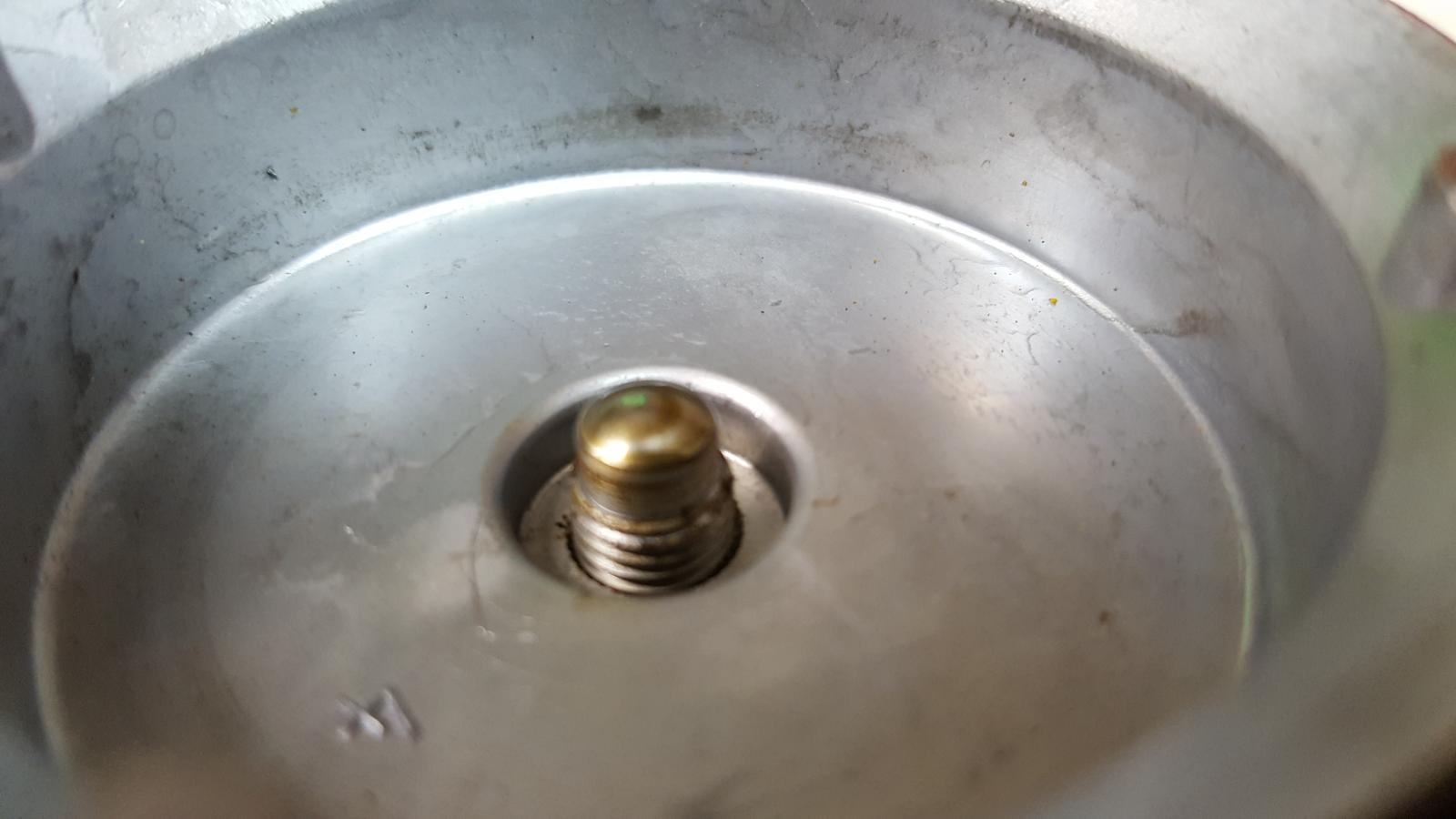

So this item, which I believe is the MPS was laying on the front floorboards. I don't know if or how much its been screwed with literally. I took the cover off and found just a little bit of oil in it, but questions for Tram and other FI guru's is there a "base" start setting for the lean/rich screw adjustment?
Does the slotted screw on the front still have epoxy on it?

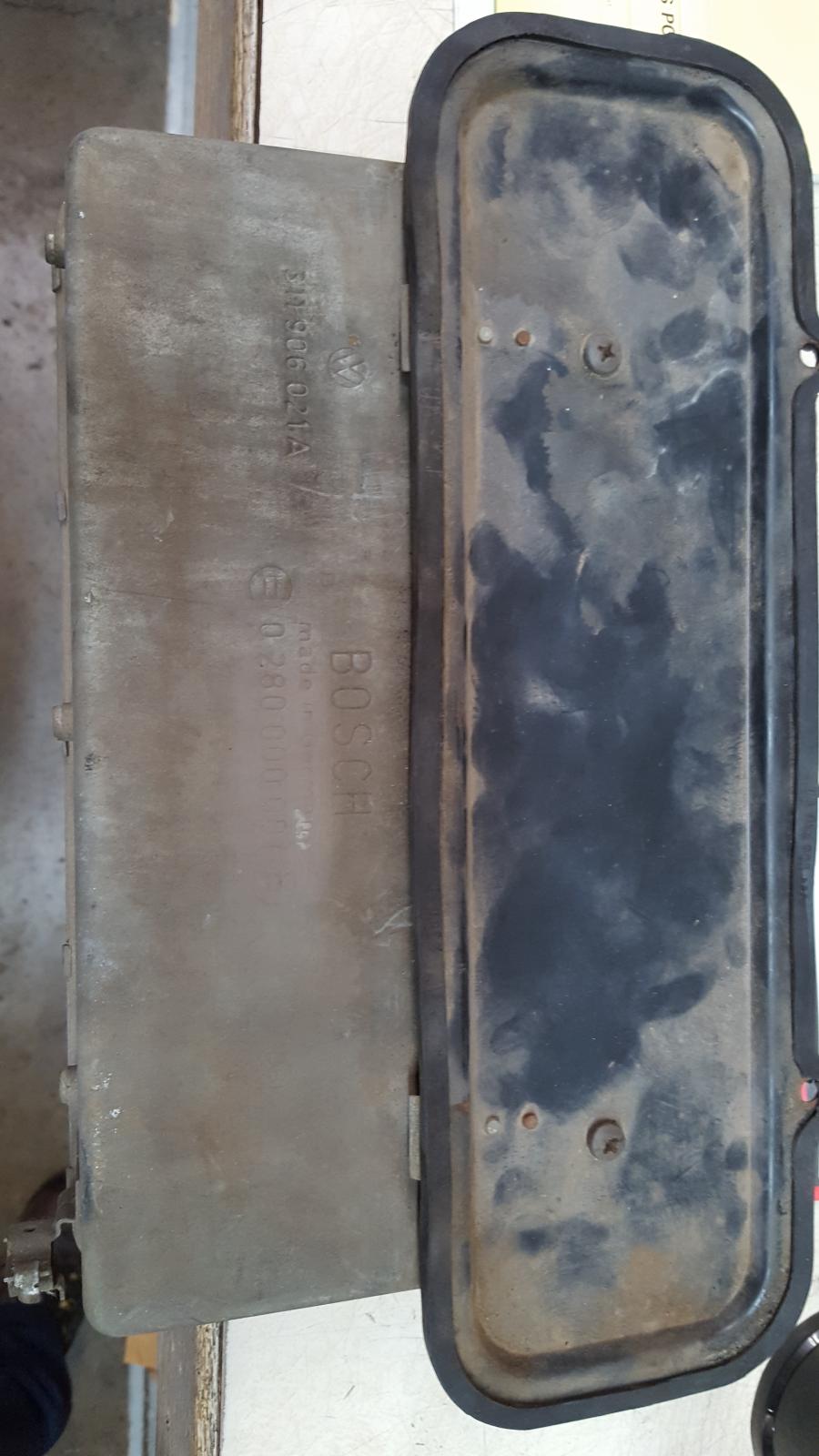

Here is the computer that was loosely laying in the back trunk, I haven't removed the one currently plugged into the car. So I think this is the original to the car since the inspection cover is still attached to it and the other doesn't.
No epoxy, the screw is accessible..

Well, it's been played with, then- looks like it's been adjusted in (rich) likely to compensate for what ultimately wound up being a pump issue would be my guess. We can set it up over here with my exhaust analyzer once the car is running.
