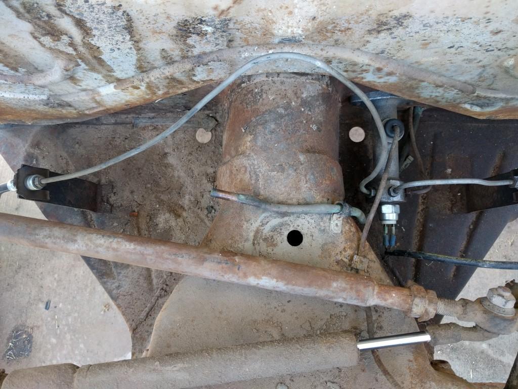

I bought my Baja bug a few years ago, didn't get much use out of it. Now I'm going to start a ground-up rust removal and repainting of the frame and body.
I removed the gas tank today and was able to look down at the frame head, and it definitely appears bent to one side - never noticed it when I bought the thing, it's not apparently by looking at it.
The pan is from a '66 beetle and the front end is a linkpin suspension, so it isn't the original front anyway....but it must've been in an accident after it had the linkpin front end welded in.
My question is.....if I'm going to do it properly....
Is this something that can be 'corrected' by a frame puller? Or do I need to weld on a new frame head. The pics should give a good idea as to the damage.
And what's a good way to make sure the rear end transmission horns and the rest of the pan is straight?

Thanks for the advice. I doubt I will be able to find a donor frame head anywhere nearby, or for a reasonable price.
I haven't pulled the body off yet to see if there is any other damage. The frame head only has surface rust so it is a shame to replace with lighter gauge. Perhaps it can just be straightened with a puller? I have 0 experience with bodywork unfortunately.
Sidenote, what mind of coating did you use on your pan, it's nice!

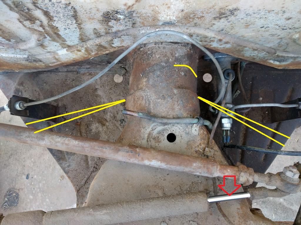

Straightening was no option in my case but certainly viable in yours. Ran it by a buddy familiar with this sort of thing suggested this:
1 - inspect previous welds, OK?
2 - open the web up with 2 pie cuts (width exaggerated on pic)
3 - vertical cut on half the tunnel
4 - twist the head out cold, no heat on tunnel
5 - If its not moving apply heat underside of tunnel (between cuts)
6 - weld back up.
