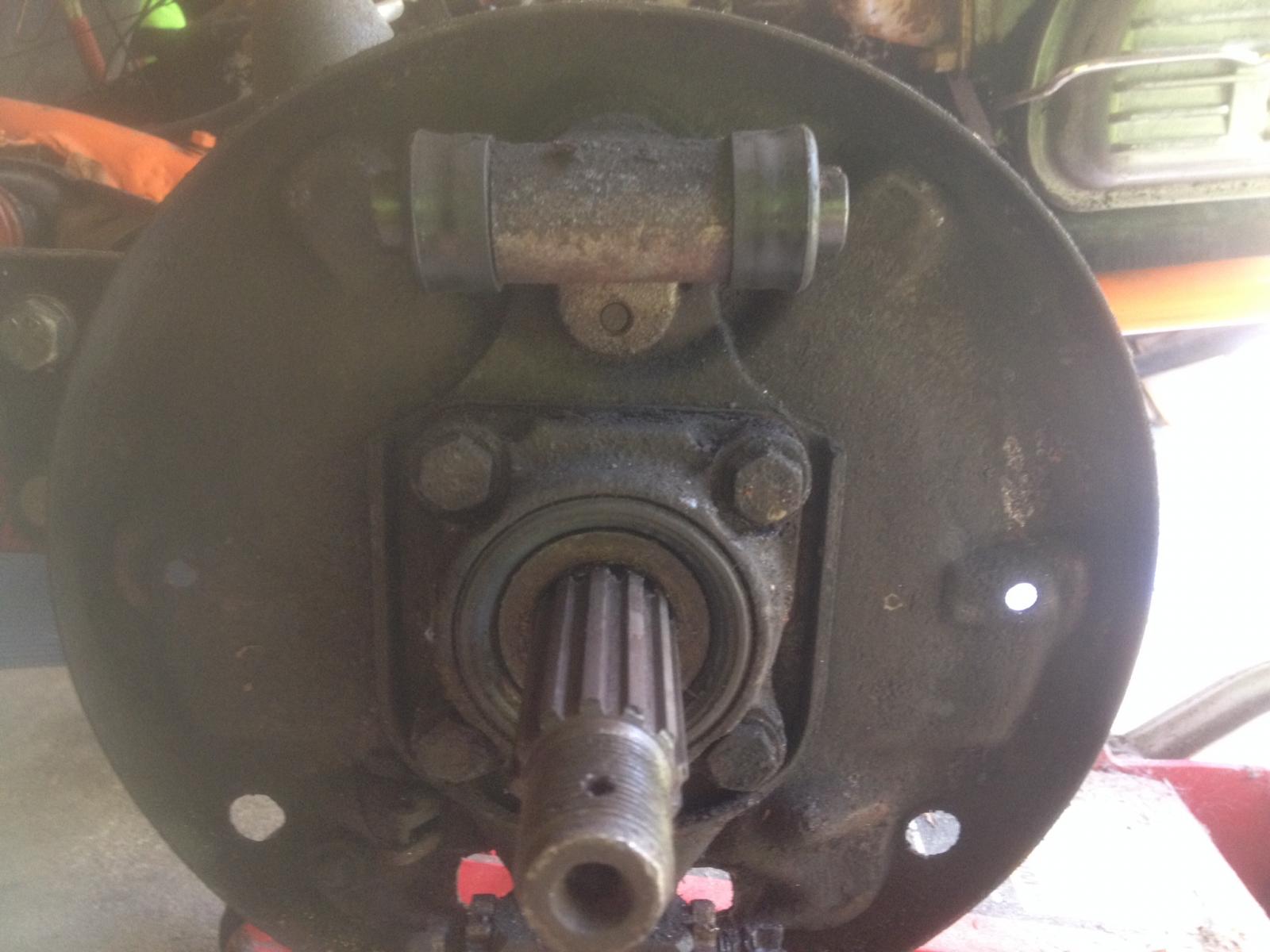

jramer2222
Joined: June 27, 2016
Posts: 3
jramer2222 is offline
PostPosted: Mon Jul 18, 2016 11:38 am    Post subject: Re: Identify this transmission code? Beetle swing-axle Reply with quote
Hey guys,
Sorry it took so long to reply back. Life happens I guess 🤔. I am still working to determine the year of my trans/backing plate. So here is the picture of the backing plate that I was able to get. Also, I was considering just scrapping the drums and getting a disc conversion. Any thoughts on that? What would I need to know to purchase a kit like that? Thanks for all the help so far. You guys are the best!
EVfun Premium Member
Joined: April 01, 2012
Posts: 6121
Location: Seattle
EVfun is offline
PostPosted: Mon Jul 18, 2016 1:29 pm    Post subject: Re: Identify this transmission code? Beetle swing-axle Reply with quote
You need to rebuild your brakes using 1968 to 1979 parts. The holes in the backing plate to inspect and adjust give it away. A quick double check would be to put a front shoe against the backing plate and in the wheel cylinder and adjuster slots. It should easily lay flat against the backing plate with the shoe face parallel to the drum friction face.
