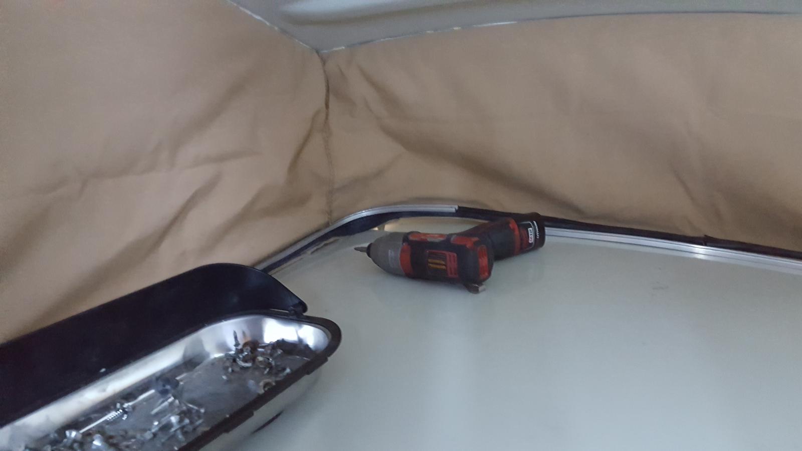

You have to mark the canvas at the 1/2 way point (small mark with a sharpie pen) front and rear, then find the 1/2 way point on the bus F&R and work from the center out equally a foot at a time front then back till you meet in the middle lengthwise and you are done. Prop the top 3/4 of the way up with a 4X4 cut to length. Worked great on my 71, you never say your year.

Well ive just removed all the screws and plan to start over. Waste of 3 hours. Ive read to start from the middle and worn out to the corners and over read to start in the corners and work to the middle. Which is correct??

Think about it, if you work from the center to the corners the canvas will be tight to the roof if you work from corners to the center you cant keep the canvas tight against the roof as there is no where for it to go but be bunched up.

Is that a new canvas from one of the reputable suppliers? If so, that stitching looks really sloppy in my opinion..I'm wondering if you may have got a dud?
I haven't seen that thick black rubber edging at the bottom either, it's usually white with the rounded bead..I see that your top arms are not fully extended,
So I'm assuming you're propping the top up with some other method, It should be more than enough slack to start fastening down..The front can be more of a pain in the ass,
Lining the centers and corners up is very important, But if it's super tight now before you have raised the top fully, I'm guessing it's too short, or you may have the canvas tacked on the top too high on the wood backer

I did my centers first, and worked to the corners, this ensures it wont be crooked, however, I only put in a few screws in the key areas, leaving room for slight adjustments..
PS, please tell me you're not using those shitty phillips screws
It was one of the hand made ones that were being sold in the classifieds. I paid a pretty penny for it because it was supposed to be a good quality based on what I had read. At on point today I had the large end completely secured down and opened it. It took quite a bit of muscle but it did stretch a bit and open all the way. I also do think I may have secured to much of the canvas to the fiber glass. Im not really sure what I want to do at this point because im not taking the top off again, nor do I want to replace this canvas.
Yes im using the shitty phillips screws. I was unaware of an alternative.

You want to head to the hardware store and pick up #4 gauge ( yellow handled driver)robertson screws, 7/16" long, stainless.. I have a box in my garage right now so I can check for you later..
did the corners rip and you repaired them or is that how the stitching was when you got it?

Well I'm not going to piss on The Amish, but that stitching looks pretty bad..but anything handmade is not going to be perfect..maybe excellent, but not perfect..
I wish I could be more positive here, but without another one to compare measurements to, You might be SOL..

Yea, I might jerry rig it the best I can. I DO NOT want to replace the canvas again. in fact I damn near refuse. Ill weld a piece of metal to cover the hole in the roof before I take that son of a bitch off again..

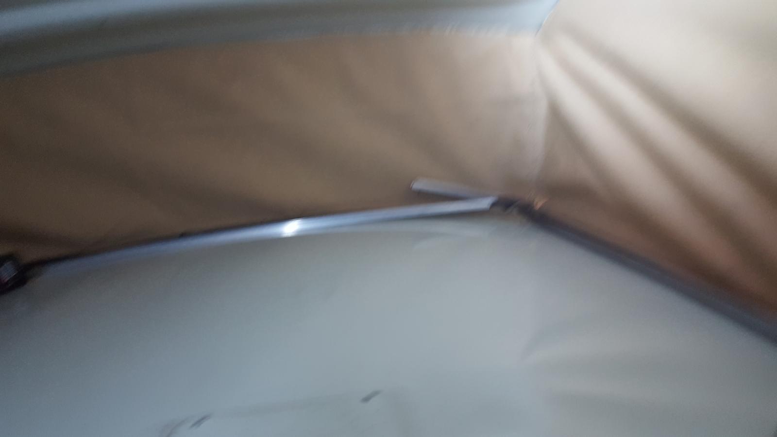

I don't know about anyone else but I never removed the top and it went right on. It's still doing good after 10+ years. A little faded and dis colored and only one little patch from where I pinched it between the hinge.

First time I did the canvas in my '78 I put too much canvas under the strips on the roof and it was way too tight at the bottom. Pissed me off but the only way to fix it right is to pull it back off and do it over. Or weld over the fucking hole, whatever floats your boat. Bitching about it isn't gonna make it go away.

last one I did was a go westy one....fit like shit. the height was way off. ended up doing it "backwards" so the fold at the top was on the inside so it didn't look like hell on the outside...it was so long it hung down 2" from the tack strip....
then , the back was too wide so I had to fold it over itself....hard to explain, but just wasn't right
that said, start from the center and work out. use a sharp pick to poke thru the beading....then screw thru the pre poked hole. you will have to pie cut the corners to make them work...just like the factory did on the beading
it was a miserable job, start to finish. honestly, I would rather do another headliner than a pop top canvas

I did mine with the top on. The canvas was original vintage Westfalia recovered by VDubTech. I left the top on with some slack, worked from the corners towards the centers. Took me parts of two easy days.No beer needed.

When I get back from vacation in a few weeks I am going to take a deep breath put some good music on and try it again.

If you said you did manage to fully raise the top without tearing or pulling out, then that is encouraging..once it's up, spray liberal amounts of water on the taught areas and repeat, leave it up for a day..this will help slightly stretch the canvas and train it for this position

No problem dude I hear ya. At that point walking away is the best thing you can do. Go on to something else for the time being and then go back into it with a clear head. Getting pissed only leads to more destruction, ask me how I know
