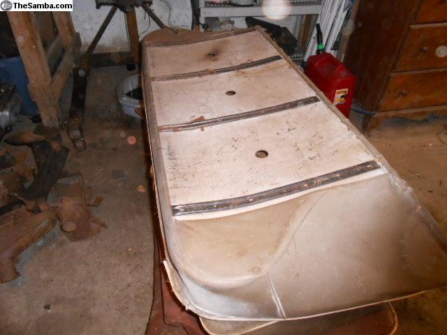

I am having trouble with identifying the correct rear seat back for my 59. Is this picture an example or is it the same as the 60-61? TIA hayden

I would say that the one in the pic is most likely out of an oval due to the color combo.
60/61, won't have the luggage supports like what's in the pic.
Check this thread, there are a lot of good 58/59 interior reference pics there.
http://www.thesamba.com/vw/forum/viewtopic.php?t=418511
