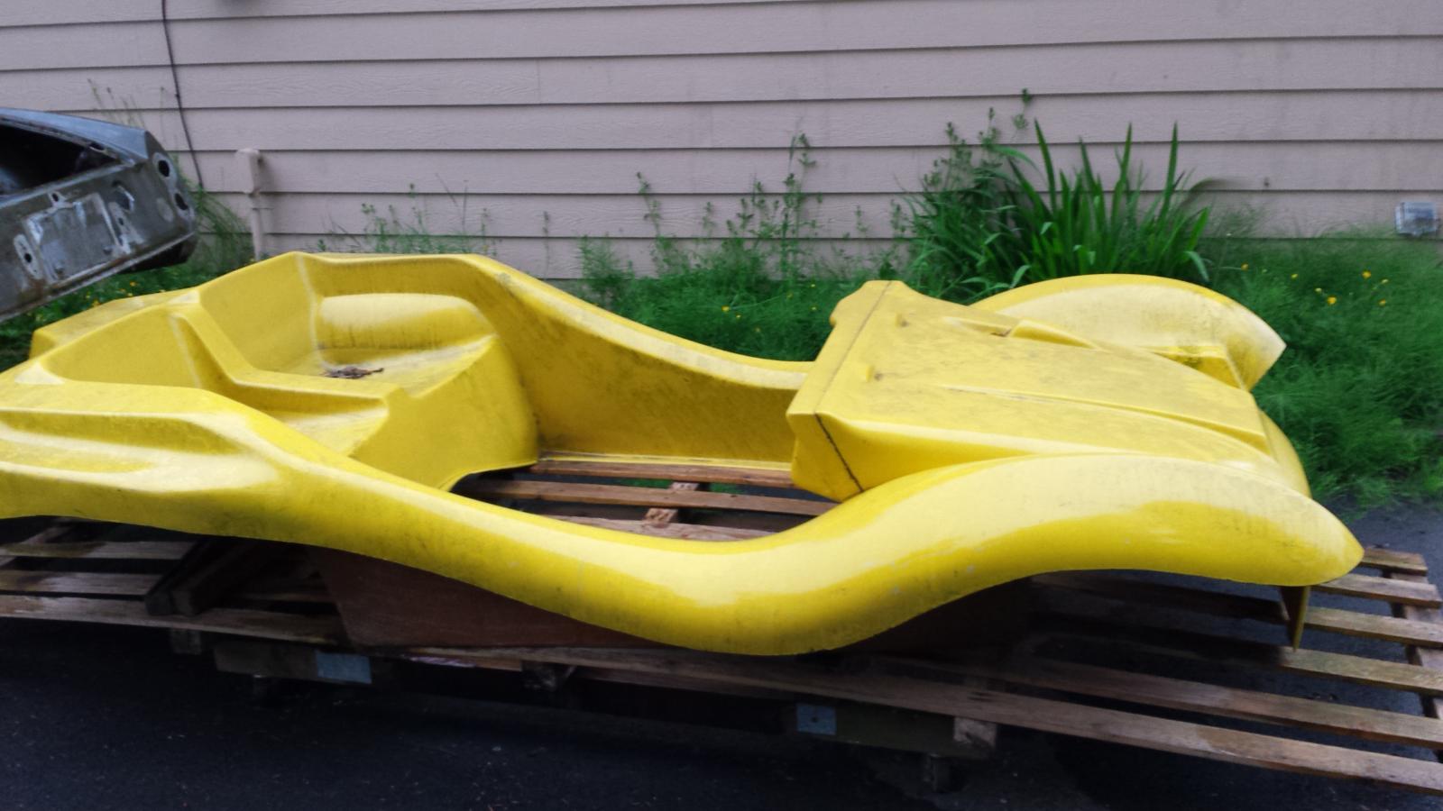

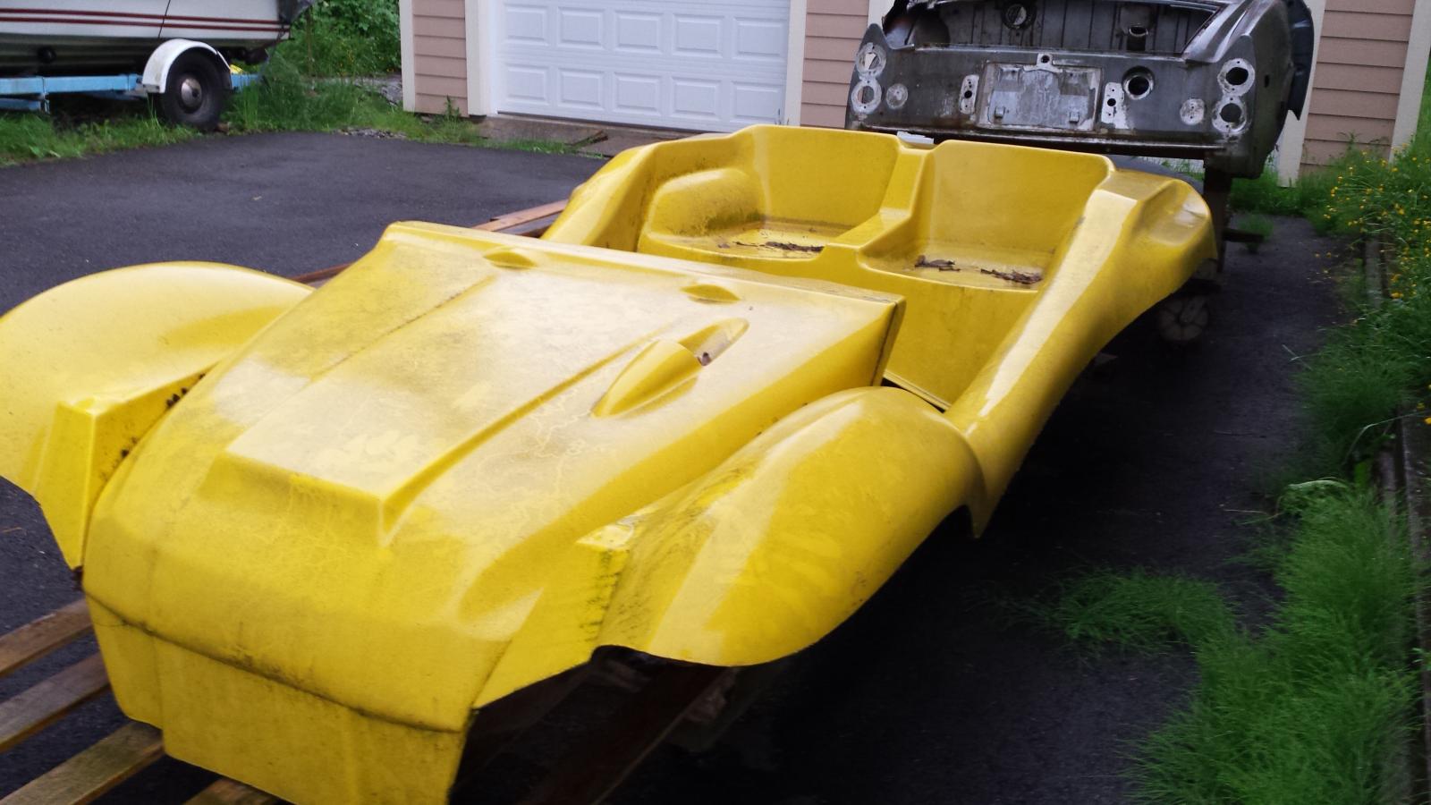

Hello all, a friend owns an uncut 70's vw Empi Imp style buggy. We asked him if we could work out a deal, he told us that the previous owner paid 800 and that we could take the buggy home if my father re-did the covers on couple of seats in his boat! One of my first post was asking if I should turn me and my fathers 67 into a class 11 baja. Well, plans changed and we slammed it to the ground. We planned on using our 1970 irs chassis, vw bus trans, raised thing I-beam, and a 3 body lift kit for the buggy. Plus a 2 liter motor that MIGHT come in later down the road. We still don't know if we can get it but if we do this will be the build thread. It will be awhile until this thread gets updated because we are in the process of building a garage we can put our toys in. Until then, wish us luck.

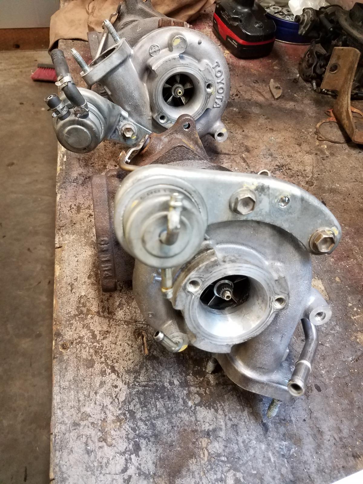

2JZ Supra Turbo. Only using 1 obviously and I am not trying to set any records on hp or boost levels just something to scoot the little buggy around

Finished an intake for the turbo. Also made some supports for it (not pictured). For the carb I'll be gong with a Weber Progressive. Next up is the carb intake. It'll take some creativity since I don't have access to a TIG machine and I don't want it to weigh 1000lbs using lots of steel

I've seen people add a turbo to single port engines before, although not ideal it works. I'd second guess feeding it with a progressive carb though. Those are a huge pain to tune on a stock setup, I can only imagine the hassle of adding a turbo to the mix.

What's the hassle..you just have to make sure the jetting and manifold heat if correct to begin with. 90% of the progressive tuning is getting the idle jet sized and adjusted correctly...after you have sufficient manifold heat so the fuel stays in suspension as it freezes the manifold" The increased temperature of the compressed and heated air from the turbo might be easier than tuning it on a non-heated manifold on a stock 1500 motor. And using a Vac-Advance dizzy.
For instance the heat risers on this 4-1 are the traditionally wrong "pulsing" style. one of the ports needs to be redirected to the collector so one side feeds exhaust into the manifold and the other side sucks it out from the vacuum created in the collector. There is a thread in the engine section on doing it.
