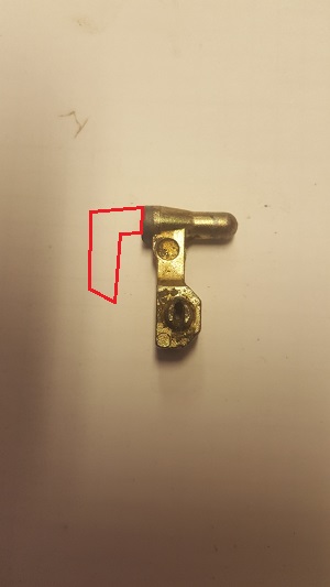

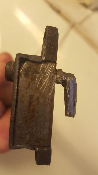

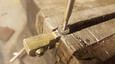

this is what is left of the latch when the finger has broken.
...I suspect the latch is made from some aluminum alloy material
so welding in a new finger would be hard...instead i planned to schrew in

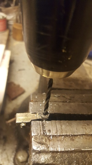

a new finger...drilled a 3.3mm dia hole STRAIGHT in the center of where
the finger hade broke off...
...tapped a 4mm thread in the hole...
...now comes the tricky part; to make the new finger.

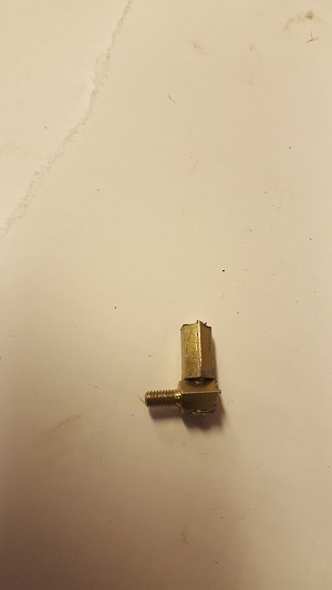

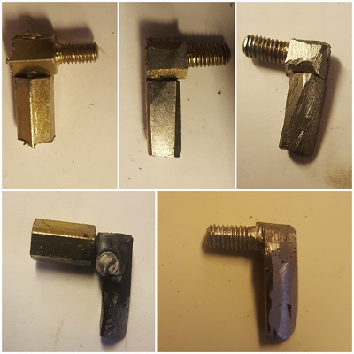

I had luck and found 2 long 4mm steel nuts with 4mm schrews in the
ends which I could screw together at a 90 degree angle...but I could
also have welded something together as a "raw" finger to start with...
...my intention was of course to schrew the new finger into the
tapped 4mm hole in the latch mechanism...
...some careful grinding was needed to make the nuts more
"finger-like"...lots of comparing with another latch finger and more
filing, grinding and also some welding...at last I had it pretty
close to the original...
...finally I put a spacer with the correct hight between the new finger
and the latch so that when I thightened the finger it would point in the
correct angle (wery important to test out the angle!) and it would stay there and not want to twist.
When I was happy with the function, at the final assembly, some LocTite was added to the threads to secure it even more.

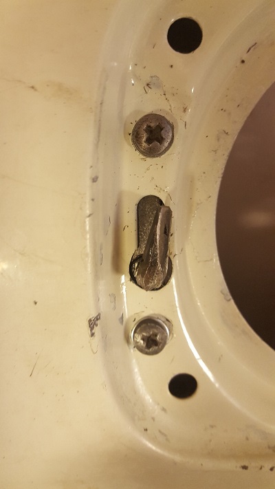

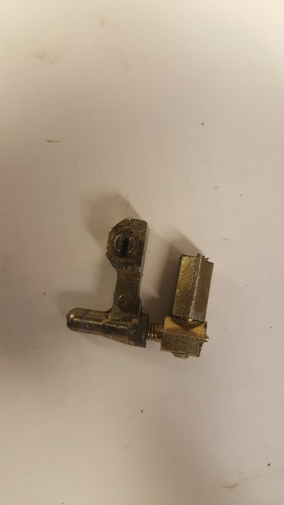

...not to bad looking..

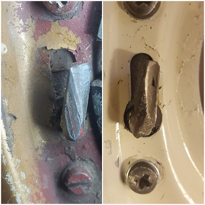

...comparision with an original latch finger.
Works wery well so far and of course, at the same time, I also made all the service to the latch and wire pointed out in Ray's excellent "Gas flap cable rebuild tutorial"
