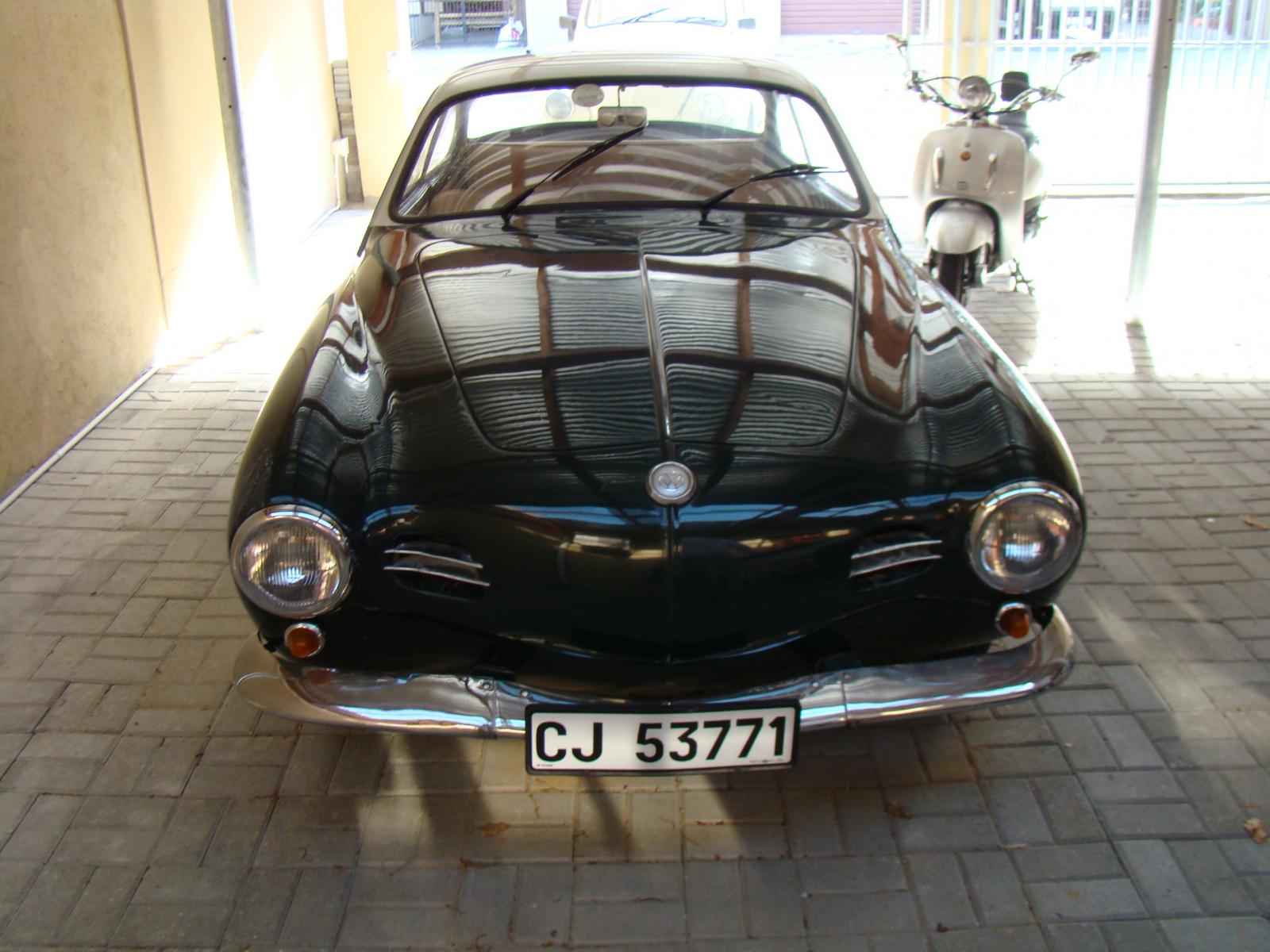

And here it is in its last home in SA. October 2011.
The more observant among you will notice that she is no longer Aerosilver in colour, more a British racing green. She was a road going car when I acquired her and initial poking around by my mate seemed to suggest that she didn't have too many rust issues.

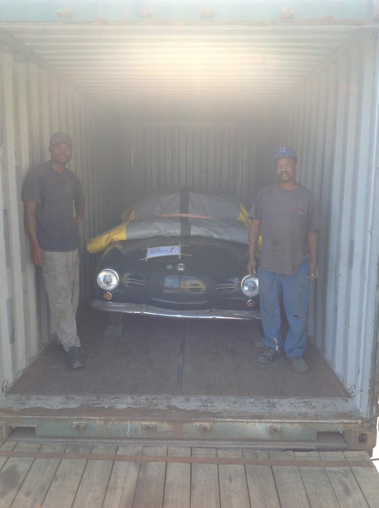

Long story short it took 12 months to get whatever paperwork was needed to allow her to leave the country but by September 2012 I've lost the will to live and have given up any hope of ever seeing this car so I went out and bought a black 1970 coupe instead (The Samba thread entitled "why do we start these things?"). Then would you believe it, a few days after buying the 1970 I get an email giving the go ahead for the shipping to take place! By Christmas 2012 I've suddenly got 2 Ghias!
here she is in November 2012 in a container ready for shipping to the U.K.

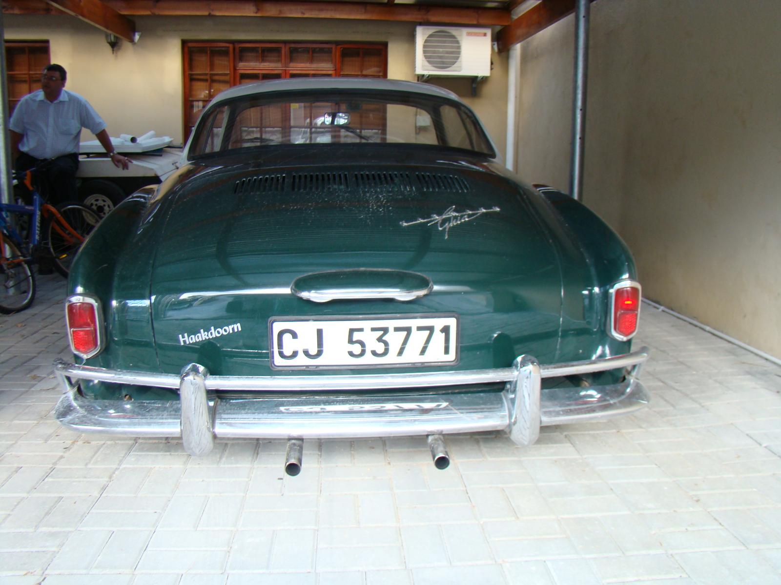

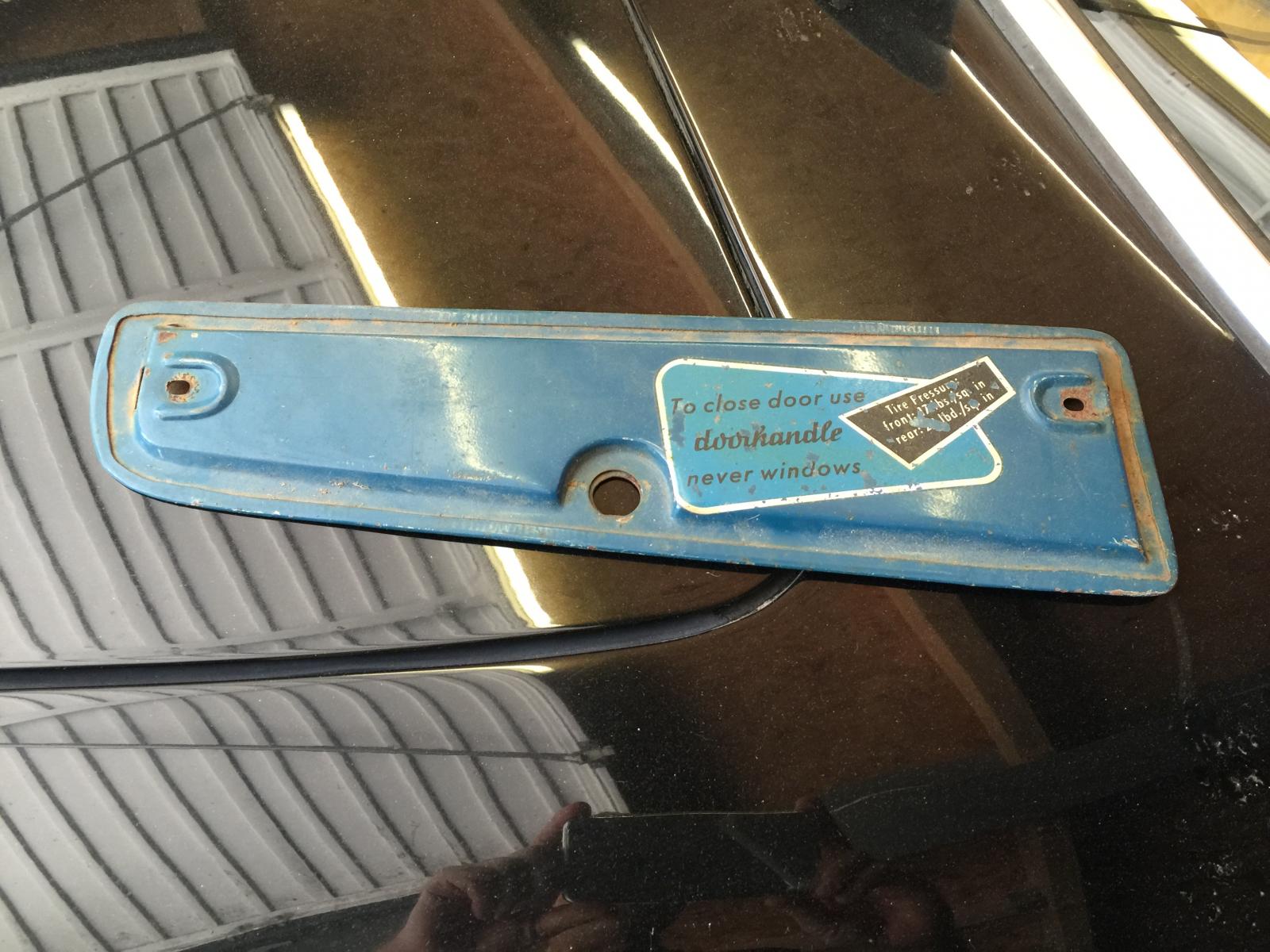

You ask why we do these things. The answer is in the script on the back of your '58 Lowlight.
Haakdoorn
Two words. Haak, meaning to hook, and doorn, meaning thorn.
We are hooked. That's why we do this.
Haakdoorn is also a place. Afrikaans people have a penchant for the ironic, laconic and teasing in their naming of places. Like Onderbroekspruit =Underpantstream. Or Tweebuffelsmeteenskootdoodgeskietfontein = The spring where I killed two buffalo with one shot.
I hope you are going to keep that Haakdoorn script on the back of your car. It is somehow fitting to describe your motivation for going to all those lengths to get the car to the UKl.

Very informative. Thank you.
I'm not sure the sticker will survive the stripping disk on my grinder. Maybe I could get another one for after the paint job, or rename the car Haakdoorn?

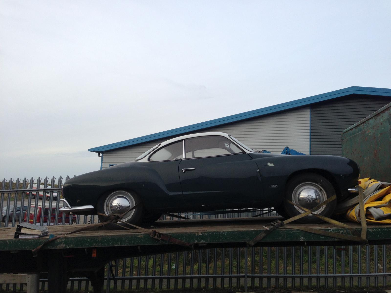

December 2012. The car cleared customs in Felixstowe which is a very long way from where I live in Cornwall so I managed to get a friend who works for a haulage company down here to get it loaded on a returning empty artic lorry trailer in exchange for a "drink".

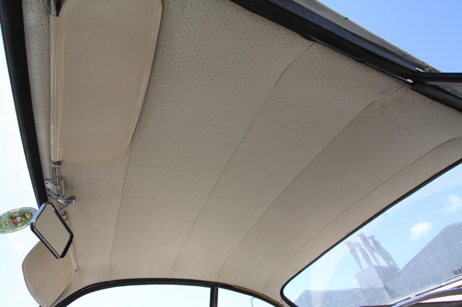

This is the first view I had of a he car, and the first time I got to see all the stuff that was either missing or wrong.
Nice dash and steering wheel. Not so nice upholstery and door cards.

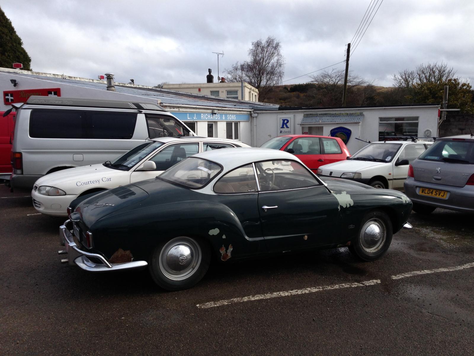

And here she is at my local village garage for an mot before I could register it. And a little more green paint picked off.

The MOT test is a big deal. It is a yearly test of roadworthyness we drivers of old cars in the UK often dread. You also need this MOT certificate, along with import papers and previous country registration document to register a car in the UK and be given a UK number plate. (Plus valid insurance)
I failed this mot due to poor rear brake readings on the rolling road. This prompted me to fit new flexi hoses, brake shoes, slave cylinders, dropped spindles and new wheel bearings all round.
While I was doing this I then discovered that pre 1960 cars are now exempt an MOT test! Unbelievable. So I didn't even return to the garage for a retest I just sent in my import papers and SA reg document to the DVLA (driver and vehicle licensing authority) and sure enough, a couple of weeks later I was issued with my new number plate and UK log book. I am now road legal! Annoyingly, I could have done this the moment it arrived. And would you believe there were no fees to pay at any point in the registration process. What a bargain. And free road tax too as a classic car being pre 1974(I think).

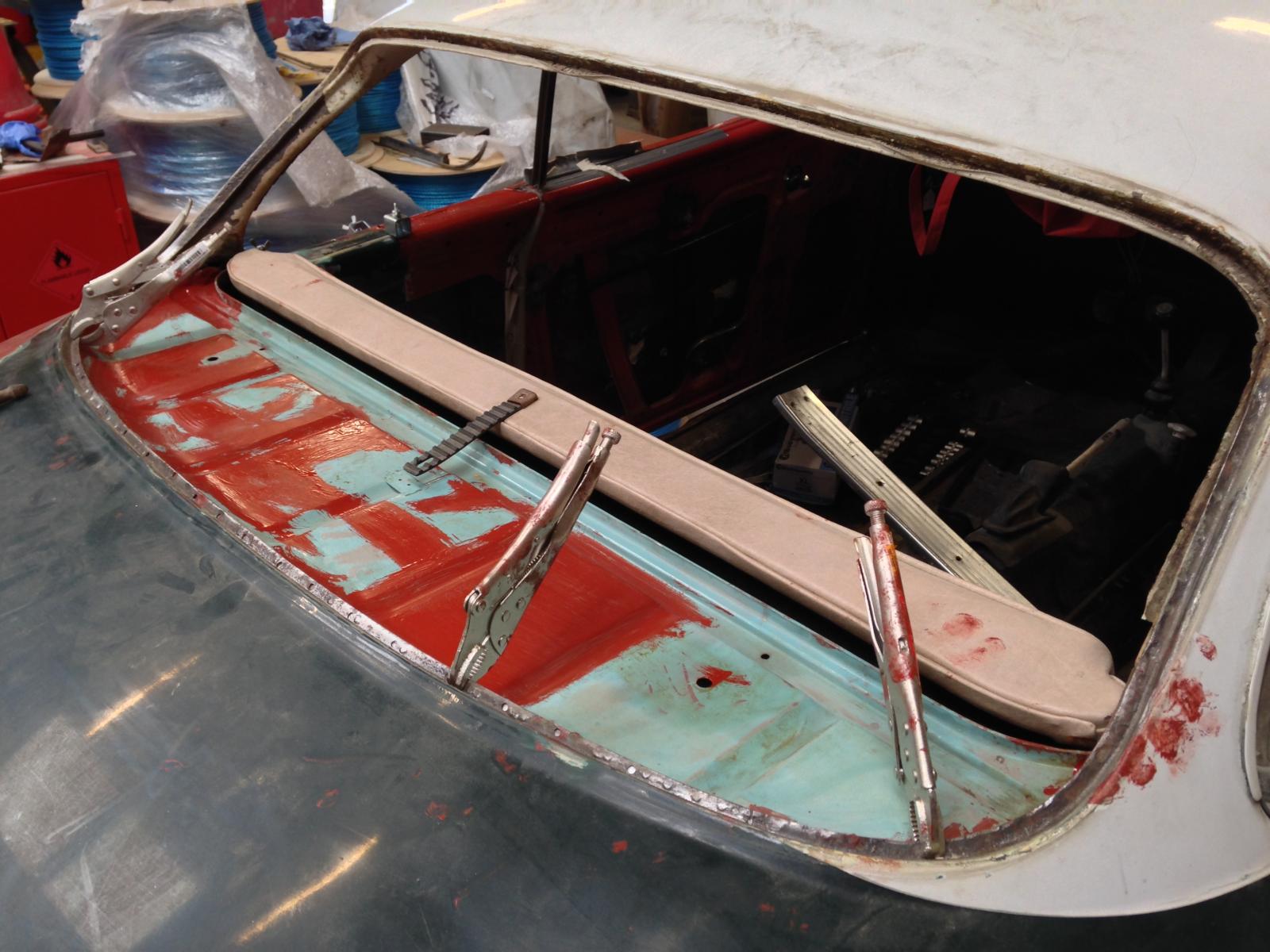

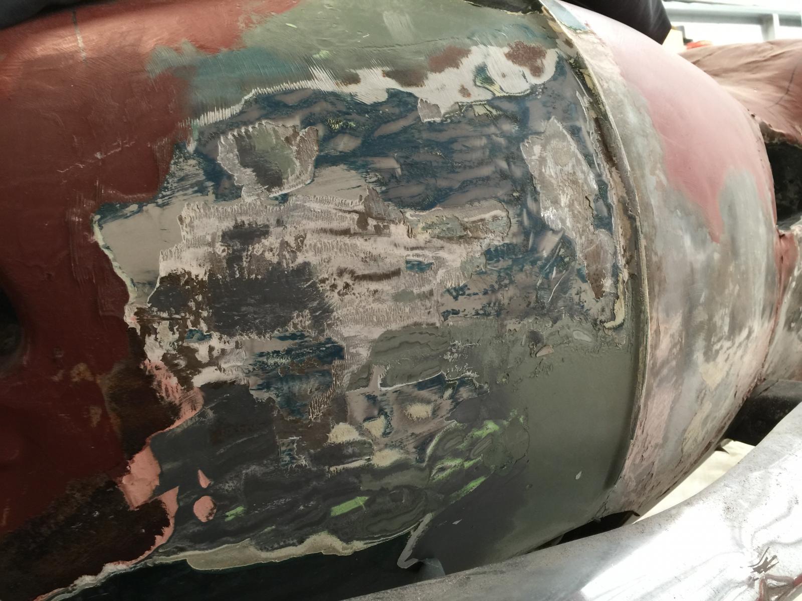

Back in the 90's I had a '64 coupe that I "cal looked". Lowered, de chromed etc. But now I cannot live without the chrome. I took the car off the road Christmas Day 2013 and started stripping away the layers and generally getting to know CJ. One of the first jobs was to clean up and reinstall the windshield chrome just to make sure everything fitted right. A bit of a job but ok with the right technique.
Did the same in the rear screen but encountered the worst rust on the car when the rear parcel shelf mostly crumbled away. Leaky rear screen, water trapped on the parcel shelf material and left to dissolve. A chap in Wales supplied me a replacement I welded in.
And now just look at the door to rear fender alignment. There was no way the chrome side trims were going to fit on here without looking rubbish. The car has been hit on the left rear fender and "repaired" to this standard.
Unpicking this took me 6 months of karmann ghia play time.

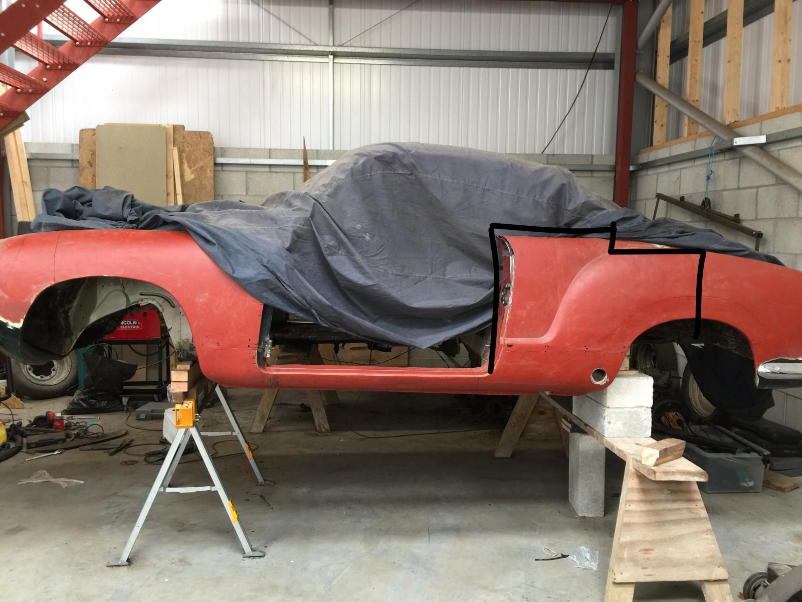

This is the car as she is today.

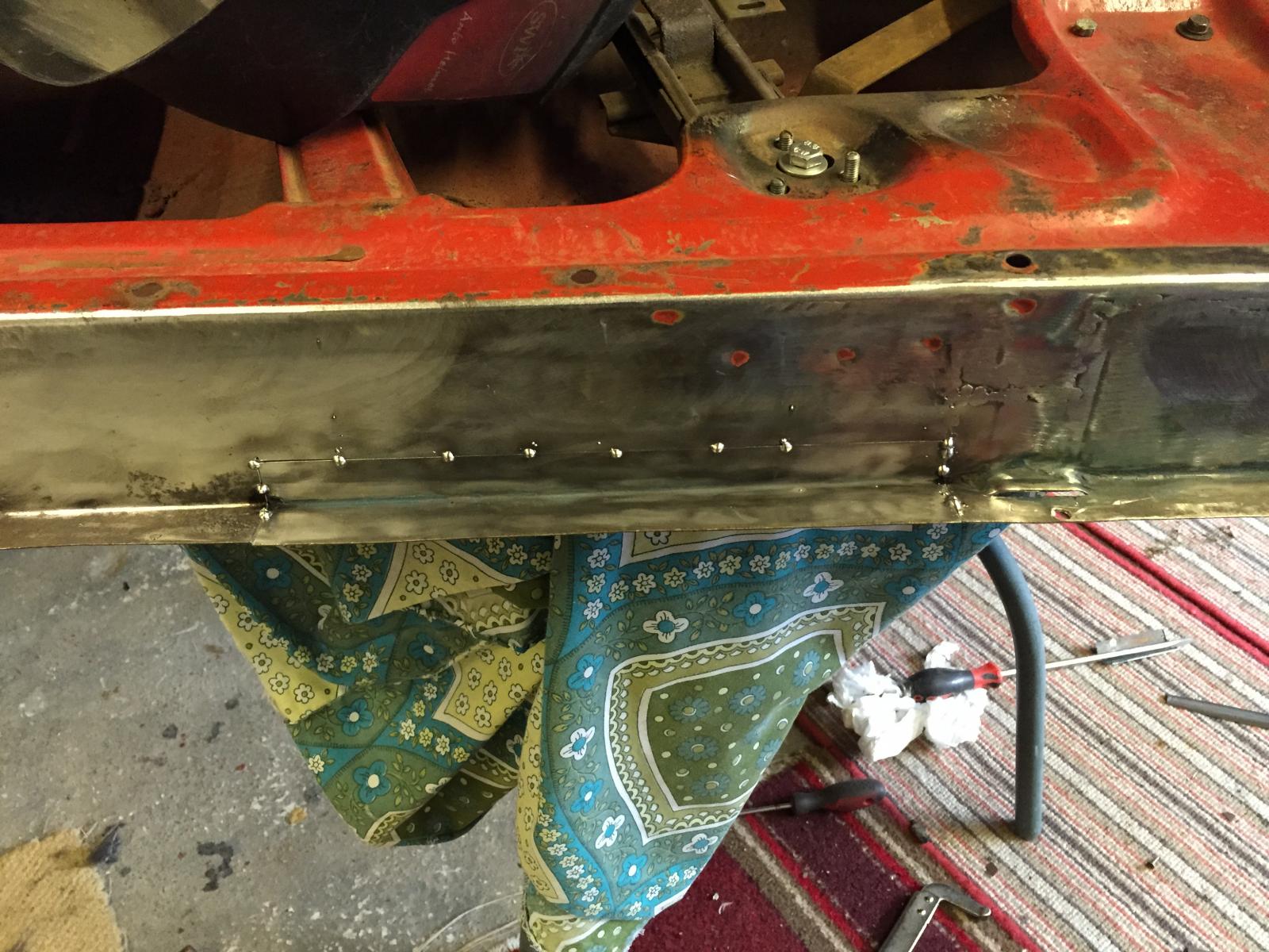

The issue with rear fender to door alignment was due to the rear fender clip being welded in place about 15mm inboard of where it should have been and then loads of filler (bondo) used to roughly make it look ok. From 50 yards maybe.
I cut away the outer rocker, unpicked the fender repair welds and reset in place so that the front fender, door and rear fender all lined up ok.
This is where the repair clip was cut in.
Next problem, the shut pillar is different on a 1960 car to a lowlight so I sourced a pillar clip from a Samba ad in the US and had it sent over.
The outer skin of the car is now made up of the following sections.
A 1960 repair clip.
B 1958 repair clip.
C,D and E rust repair panels.
F home made repair panel.
And here is a picture of my attempt to line everything up before I commit to anything permanent.

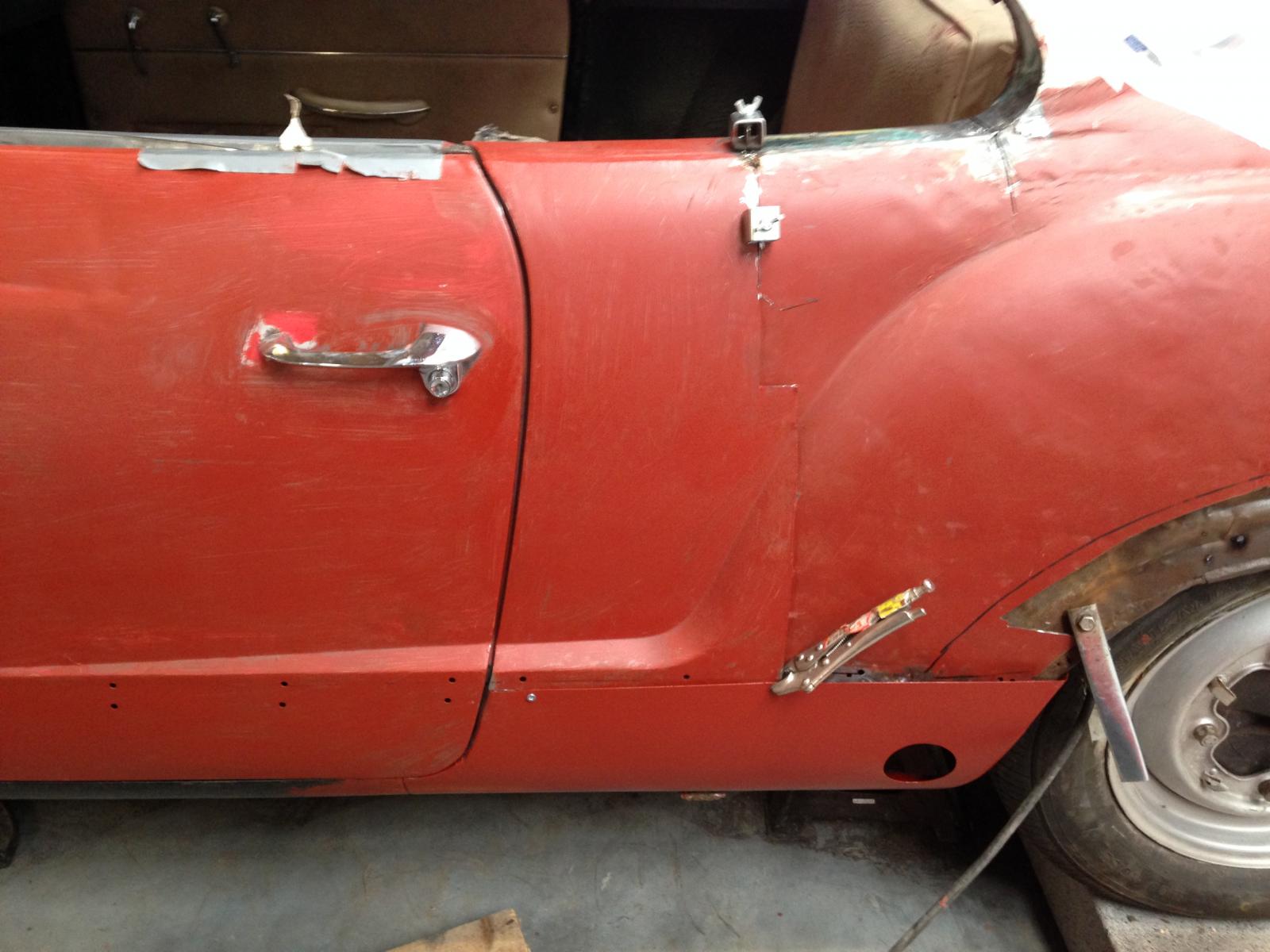

PostPosted: Mon Jun 06, 2016 3:07 am    Post subject: Re: CJ from South Africa. Reply with quote

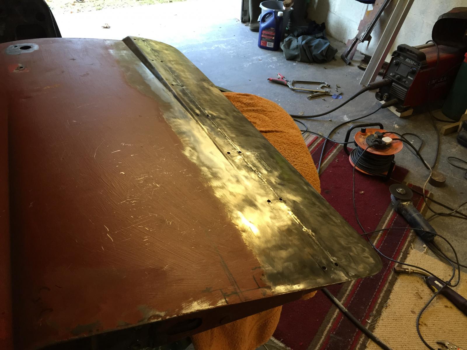

Found out about these clever welding clamps on a thread here on the Samba so bought myself a few.
Some welding and grinding later. By now I had also sourced a 1958 door from KGPR.
Trial fit of a new set of chrome trims.
Thanks for looking.

Everything I've learned about this type of repair has been through studying Samba and ABCGT (vintage Porsche stuff) threads for the last few years

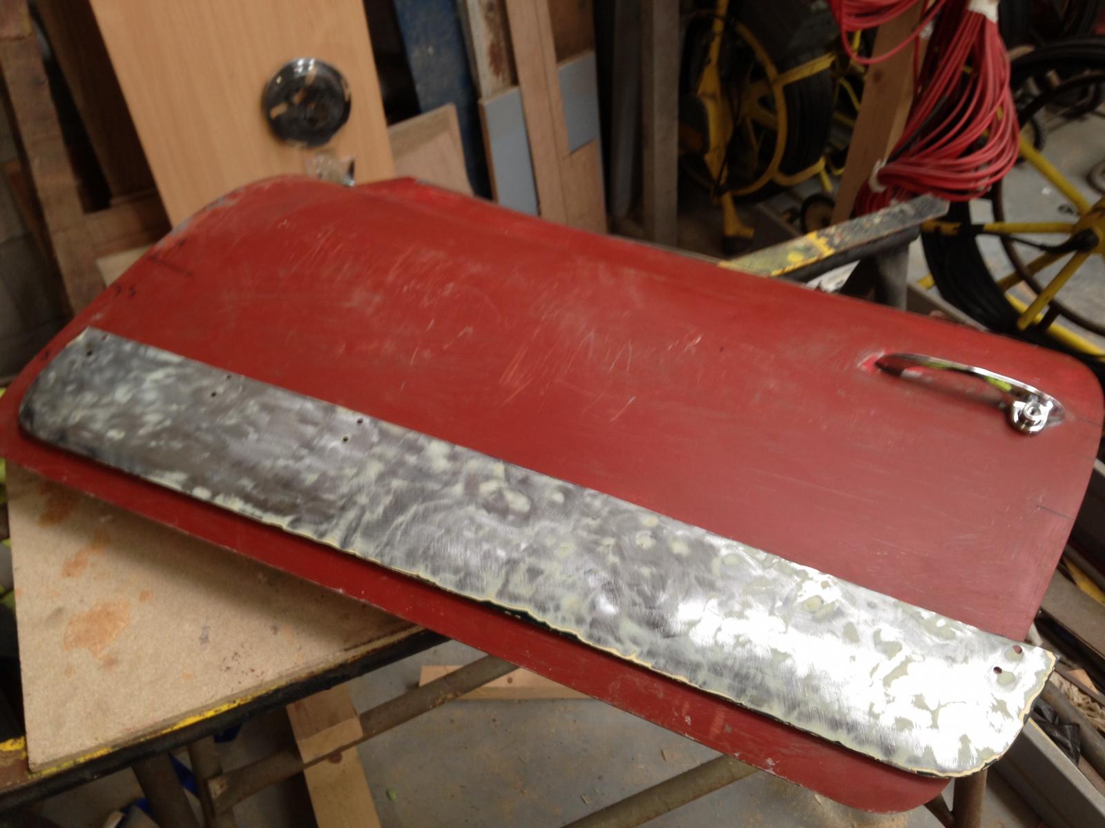

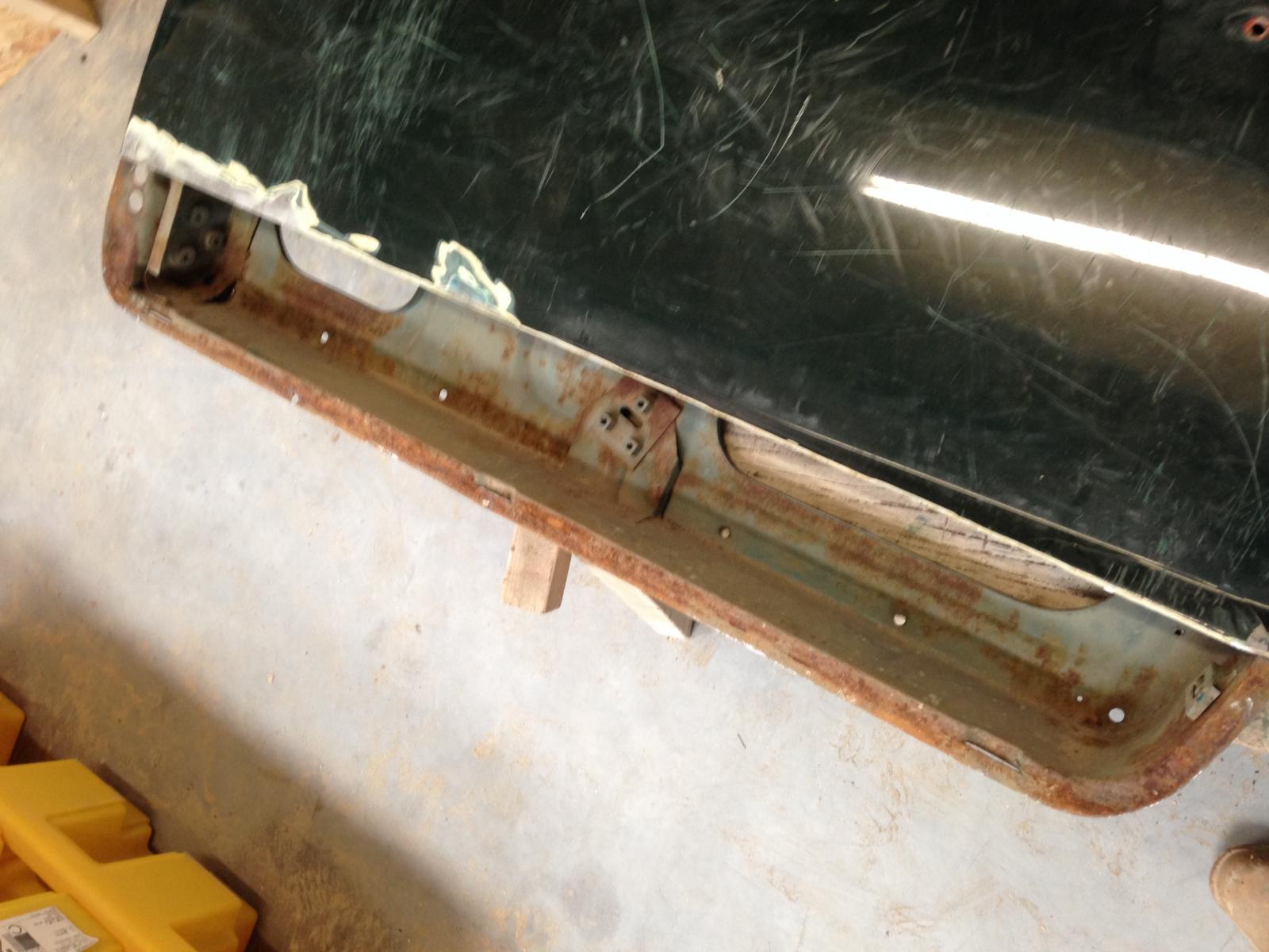

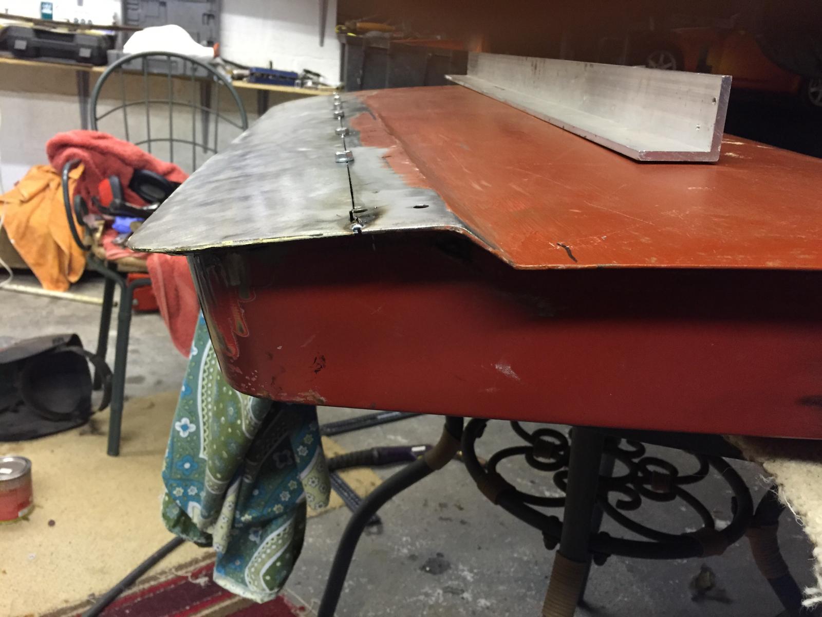

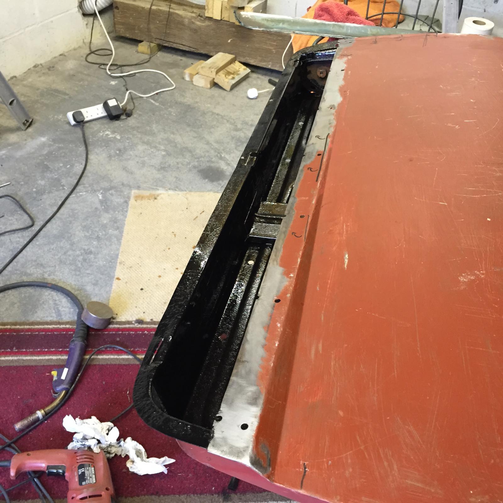

It look ages to find a half decent 1958 door and even then there were places where bits of it had rusted through a little at the lower edge. So either try to find and pay again for another one, or repair this one. I thought I'd try a repair first. You need a lowlight door on a lowlight because the door glass, check strap and other details are different.
Cut myself a lower repair panel from the 1960 door.
Here is the door needing improvement.
The inner shell also needed some rot cutting out.
I cut a couple of clips from the 1960 shell too.
To make this repair.
Then took he opportunity to POR 15 the inner door area before rebuilding.

PostPosted: Mon Jun 06, 2016 9:54 am    Post subject: Re: CJ from South Africa. Reply with quote
Held the repair panel in place with some 6mm bolts through the trim holes.
A few hours of weld, hammer welds flat before grinding, grind, repeat etc until it looked like this. I have read a bit about attempting a repair like this and you have to do it really slowly as the welding heat is likely to cause distortions you can't recover. I think it came out ok

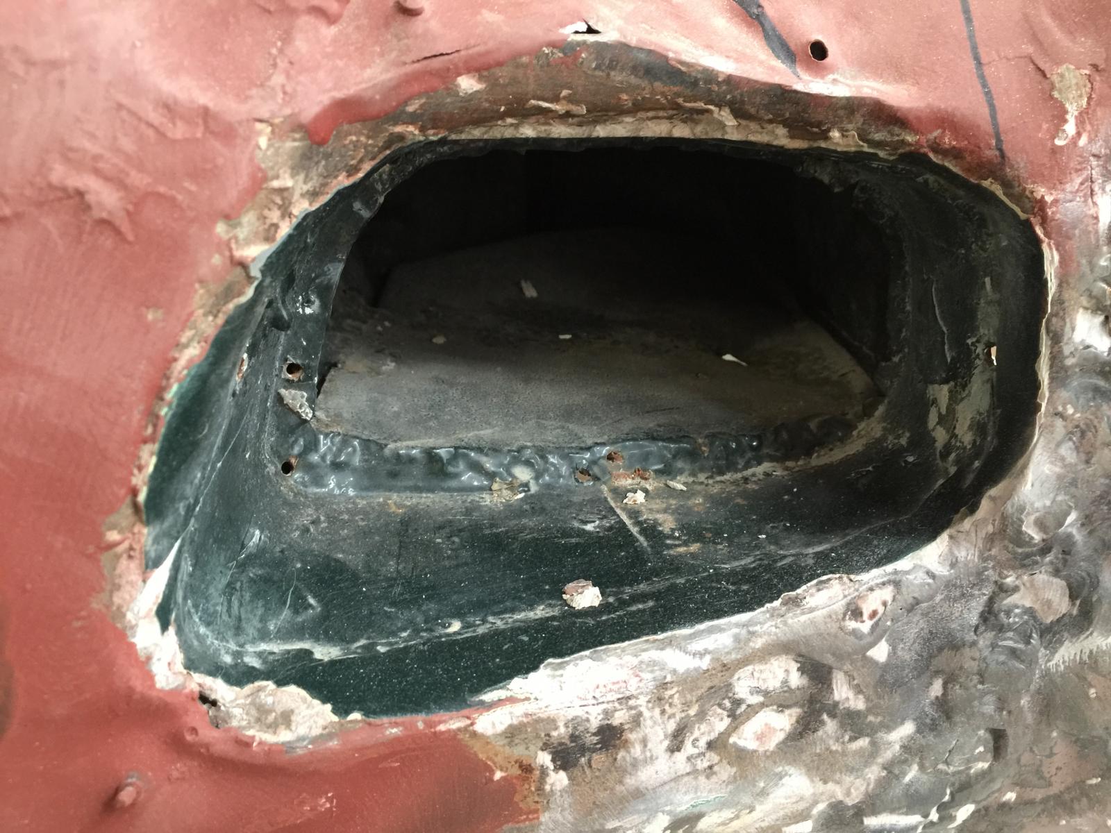

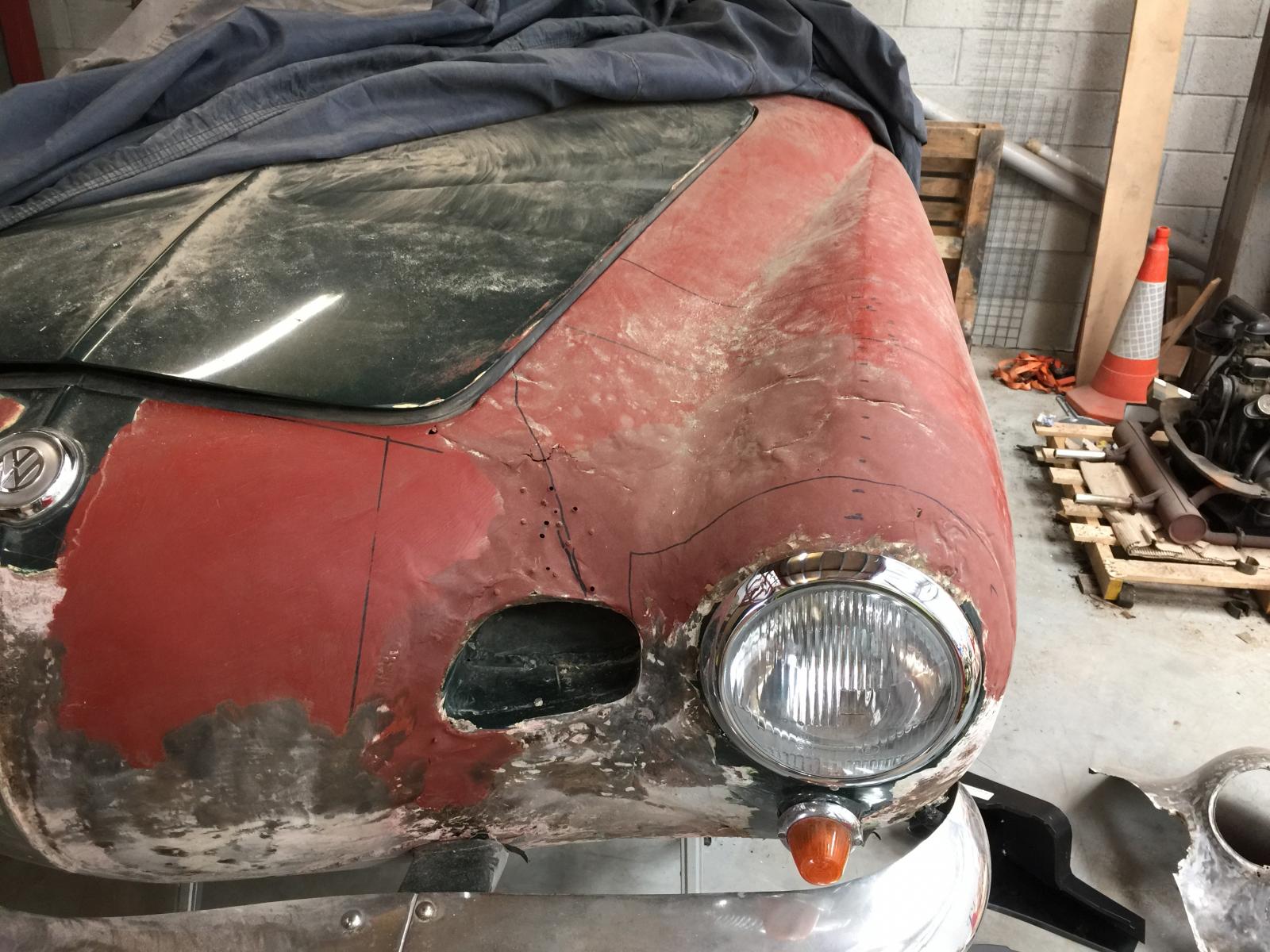

And now for another challenge. The front left fender looks like someone has been beating it with a lump hammer and no attemp was made to straighten it out before the last load of bondo and paint.
Unfortunately whatever happened here also bent the first bit of fresh air duct and even the inner fender a little. Here is the view inside.
And the nostril.
I have since purchase been collecting spare parts and these are the bits I will hopefully be using to do a better job of this repair.

kiwighia68 wrote:
kgj wrote:
Yes, it's more like bitumin. It really does take real effort to get it off. I used a hot air gun and scraper being careful not to scratch the paint below. Then white spirit on a cloth for the residue.
I sealed the undercarriages of all my cars in SA with that stuff. So many unsealed roads - with the risk of stone chip damage. Paraffin (kerosene) cleans it up nicely and doesn't damage the paint.
Great info here, as usual. Samba is awesome.
Question about kerosene.... I am trying to remove spray on contact cement for carpet without damaging good paint. Will kerosene work for this?
Thanks.
