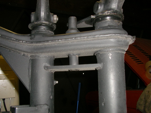

PostPosted: Mon May 09, 2022 10:58 am    Post subject: Re: Front end lift on Baja bug advice needed… Reply with quote
The previous owner probably did a "Cut and Turn" on the front beam, look at the middle of the beam where the grub screws are and see if there is a weld on both sides of the grub screws. the rear was probably re-indexed to lift it some, does it clunk when you drive over bumps check and see if it has hook stops installed on the front trailing arms.
I only have the hook for down travel so it does not "Top Out" the shock,

PostPosted: Tue May 10, 2022 6:37 am    Post subject: Re: Front end lift on Baja bug advice needed… Reply with quote
eQ
You are correct! There are welds on either side of the grub screws. So what I’d like to do is to reduce the spring rate on the torsion straps. What’s the best procedure to do this? Can I get away with cutting one of the straps on either the top or bottom torsion springs? And then if the spring rate is still too high cut the other one? Do I leave the cut strap in the torsion stack? I’m looking for a more comfortable ride, my girlfriend will be driving and riding in this car and she has back and neck issues . And again there won’t be any high-speed off-road driving.

PostPosted: Tue May 10, 2022 2:40 pm    Post subject: Re: Front end lift on Baja bug advice needed… Reply with quote
Your best bet would be to try to find a beam that has not been modified and replace the one you have, I don't remember who make lift spindles but there available and they won't affect ride quality. you can re-index the rear torsion a degree or two and it shouldn't lower it to much but with lift spindles in the front it ride nose high.

PostPosted: Tue May 17, 2022 6:05 pm    Post subject: Re: Front end lift on Baja bug advice needed… Reply with quote
Akimbeau wrote:
eQ
I’d rather not go to the trouble of replacing the front beams. On further research on this site, I saw where through rods were used on the front trailing arms and then adjustable coil over shocks added. Then I could choose the spring rate that works and still put a lift on it. Has anyone had experience with this? Is this a good quality ride option? Do adjustable coil overs come in the stud type top mount my car will need? I know the front ball joints on my car will not be ideal for hard Offroad but that’s not what I’ll be doing with it.
If you'd rather not replace the beam, but would rather replace your shocks with coilovers, then you haven' looked at the cost of coilover shocks. IF you find some Fox or similar coilover to fit (Fox, King and Bilstein ALL make shocks to bolt on to he front of your Bug, but not coilovers for that application), They will cost in the neighborhood of a couple of thousand US dollars. And I'm NOT talking about poor quality EMPI coilover shocks. Those a very poor shocks with a spring that only make a stock suspension ride way too stiff but are not enough to hold the car up.
If the car is too stiff now, And there is nothing wrong with it like seized arms, then the cut and turn may have been turned too far.
If you turn the torsion leaves enough for Class 11 off road racing, then it will ride terrible at low speed. If the beam is turned just enough to provide a taller ride height, that would give you stock ride quality with more clearance.
With a ball joint beam, the maximum wheel travel is around 6.5". A car with longer wheel travel can ride much softer and be no more likely to bottom out. My Baja Bug has 10.25" of wheel travel with its original arms and beam and custom fabricated shock mounts. That extra travel is one reason why link pin VW beams are so much more popular with offroaders than ball joint.
