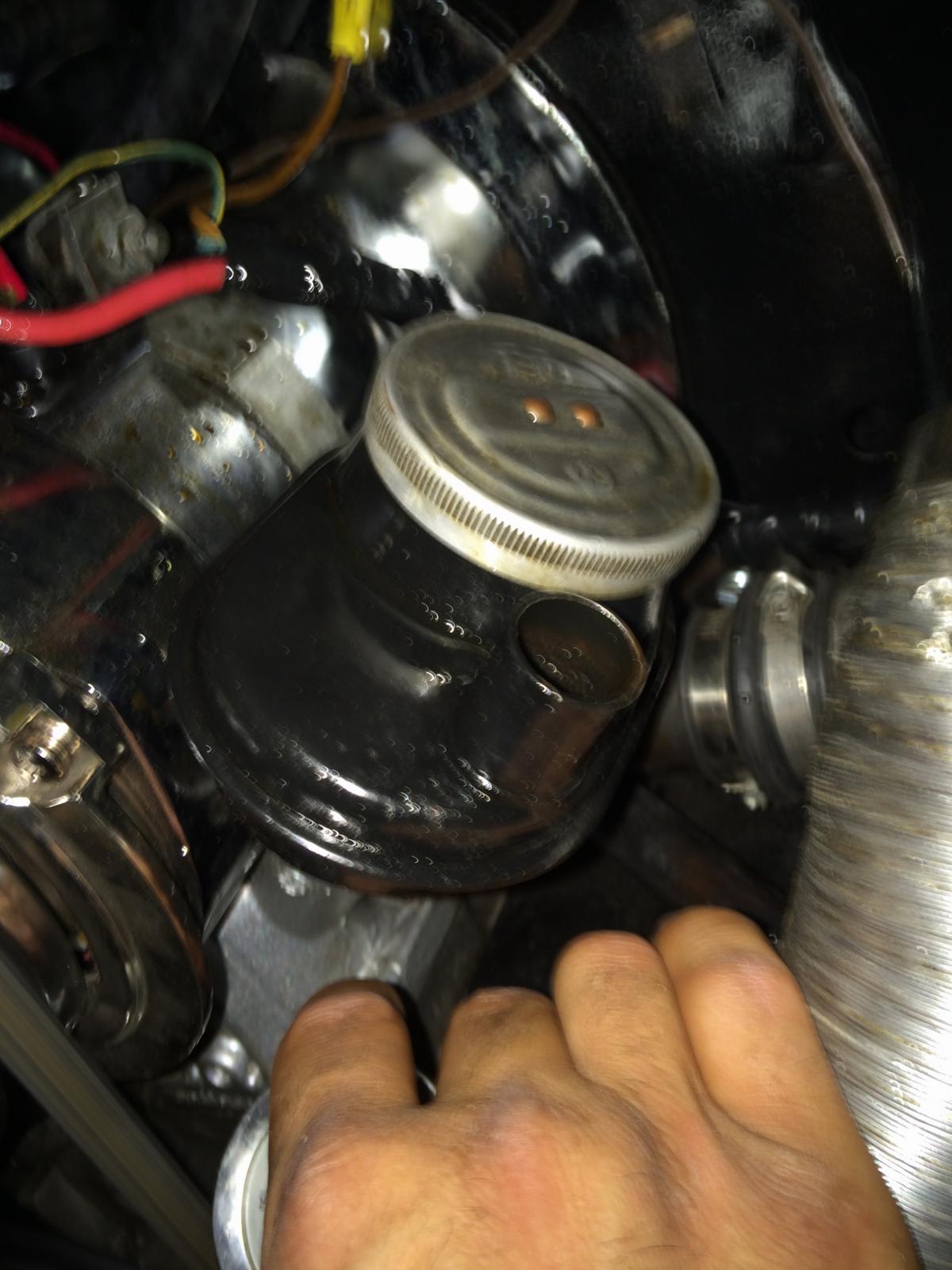

The main reason because I want to put the oil bath air cleaner, is this nipple on this picture, splash oil all over the engine compartment, any other way to address this problem! It would be helpful.
Thanks
Balt
If you want to get into this hobby better you have a very strong strong wallet.
SGKent Premium Member
Joined: October 30, 2007
Posts: 42955
SGKent is offline
PostPosted: Mon Jun 06, 2016 9:48 am    Post subject: Re: Oil bath air cleaner question? Reply with quote
Excessive blowby is caused by worn rings, worn guides, or excessive timing advance - or any combination thereof. You can add the hose to the oil bath and it will direct it into the oilbath.
