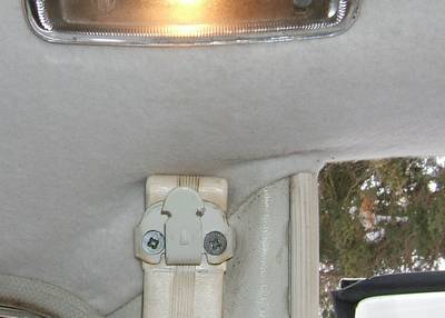

Hi there,
I was wondering if anyone has or can take a pic of where the assist strap attaches, with no headliner in.
I know the general area but with the headliner in place and trying to feel where I need to poke through scares me a bit.
if I can see a pic I will have a better idea of where I'm feeling
thanks Russ

Here's my 62 in relation to the dome light:

My headliner's in place but I can give you a few measurements that might help.
The two screws that fasten the assist strap are located side by side, .85" apart. Measuring down from the edge of the interior light, I get 1.70". Measuring back from the seam between the headliner material and the plastic edging to the nearest screw, I get 1.10".

you guys are awesome
lol I was totally looking far too high
the pics and measurements help immensely
I some how remember it being under the dome light and for the life of me couldn't find the tab
yes for the record it's for my 65:) last thing to do on it, then I'm calling it done

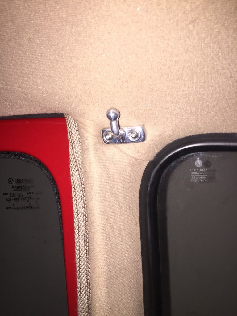

got the hooks in place (yes i know they are wrong for my car but they were left over from my oval build)
just got to make the straps and pop them in place

I like the hook, can't wait to see it with the strap. I may do this if I can find the hooks looks awesome !

Once you have the general location, using a sewing needle to poke around looking for the mounting hole is pretty easy on the fabric.

for sure, once I touched the piece I was able to poke a tiny hole in it to find the spot.
worked like a champ
