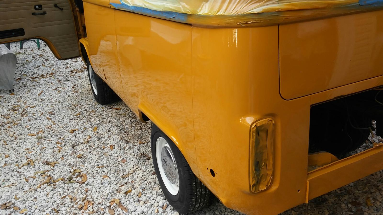

PostPosted: Wed Oct 26, 2016 5:58 am    Post subject: Re: 72 Westy - first bus Reply with quote
Wow guys thanks! I won't lie there are a lot of nights I don't want to work on it due to general malaise after tucking in kids and working a full day but I find once I just get out there and start working things start to happen.
Plus I promised my family and myself we'd go camping!

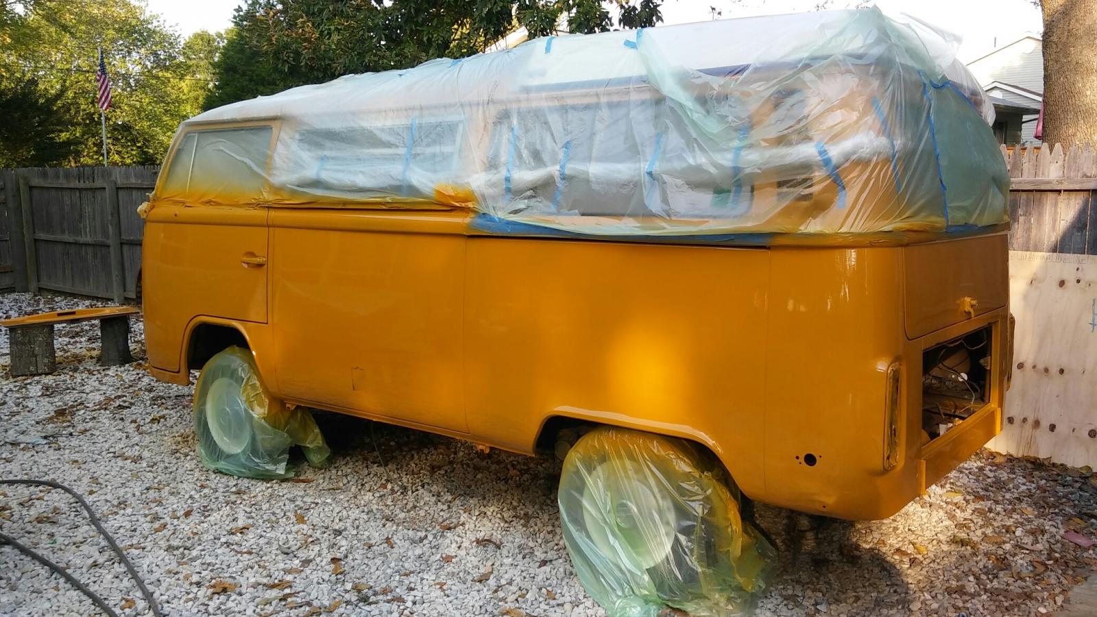

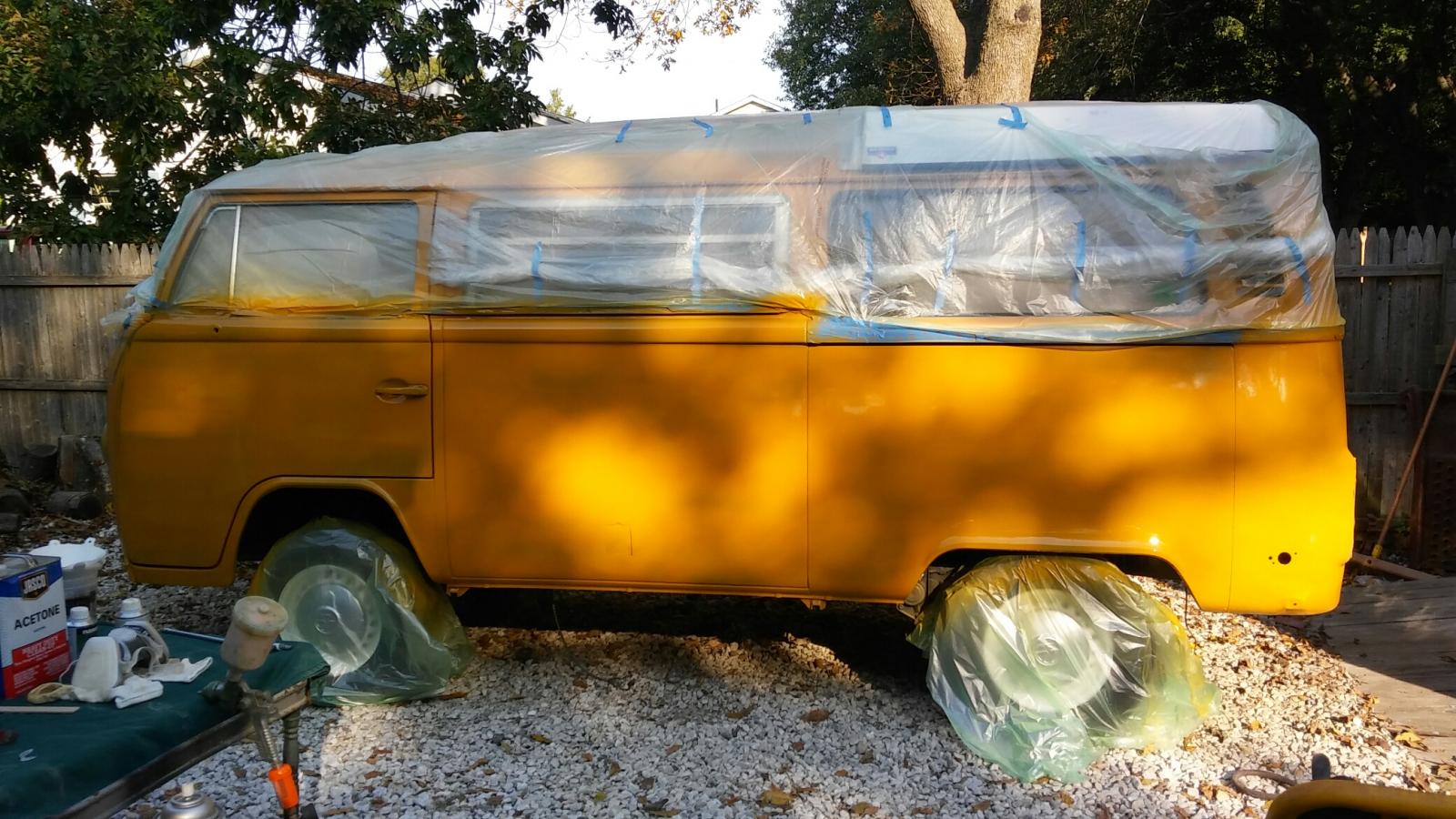

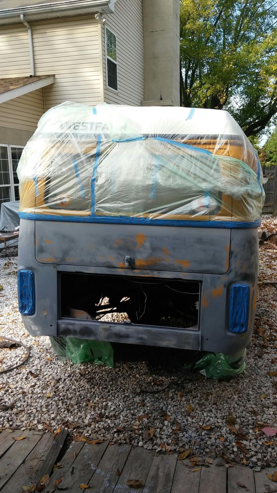

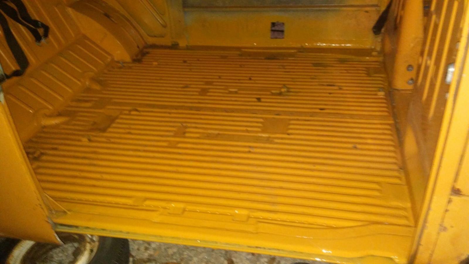

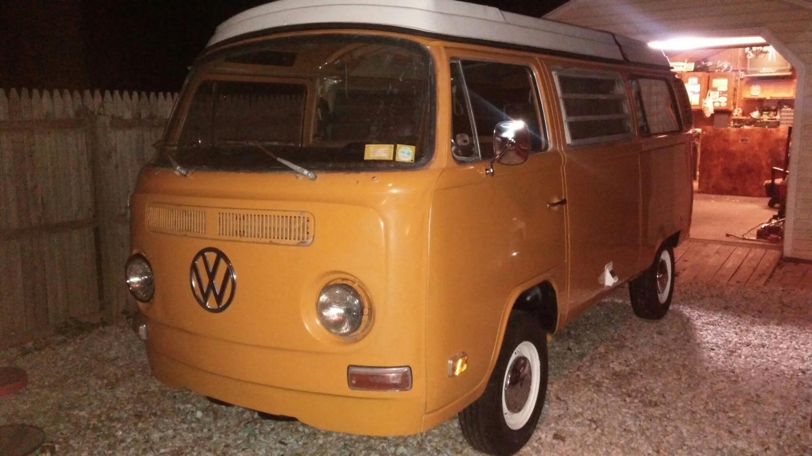

Weather cooperated for my outdoor painting. Its not perfect but perfect for camping.
My buddy has a wicked cool stud welder. Yes no shortage of filler, gotta do what you gotta do.

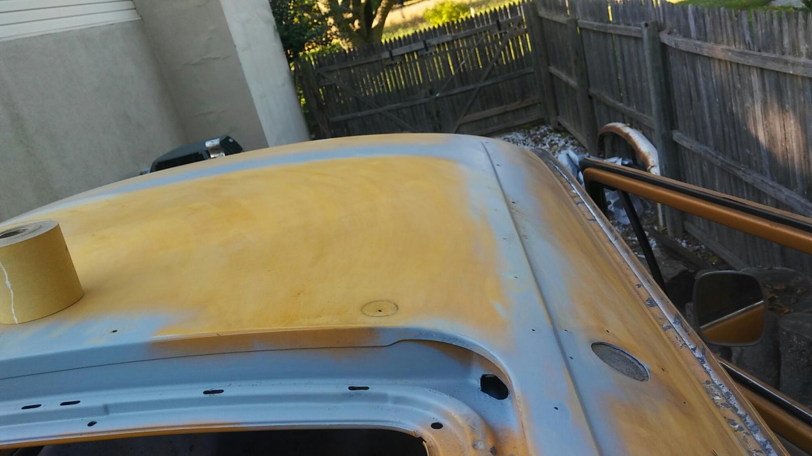

Classic project scope creep. Realized there was rust on the roof that needed love before I reinstalled my fiberglass top with new canvas.
This last shows how all of this work has been outside since my garage is full of Westy Miscellania (new word) Wink
Tons of blocking. I could have blocked even more but overall I am happy with it.
Dupont Nason Single Stage. This is very forgiving paint.
Inside. I didn't use any filler in this opening since its such high traffic, so imperfections and all here it is:
Painted lower nose too

Looks great and awesome documentation to show others just what and how much work it takes.. many nights and weekends..
make sure you treat and seal the underside/backside of your welds (where you can) so that the rust bubbles don't come back in ~3yrs..

Danfromsyr I ended up going through 2 tubes of Dynatron auto seam sealer on the underside and backsides of my welds. Hoping it helps!

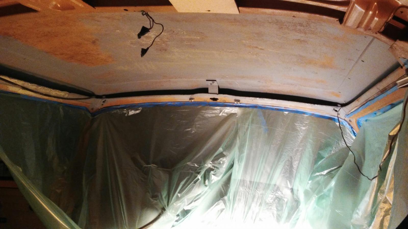

Next on the list was to prep the inner roof for paint (area above the driver/passenger seat). Lots of rust thanks to the mice. So bad that the poptop brackets self destructed, and yet the gutter was still in good shape.

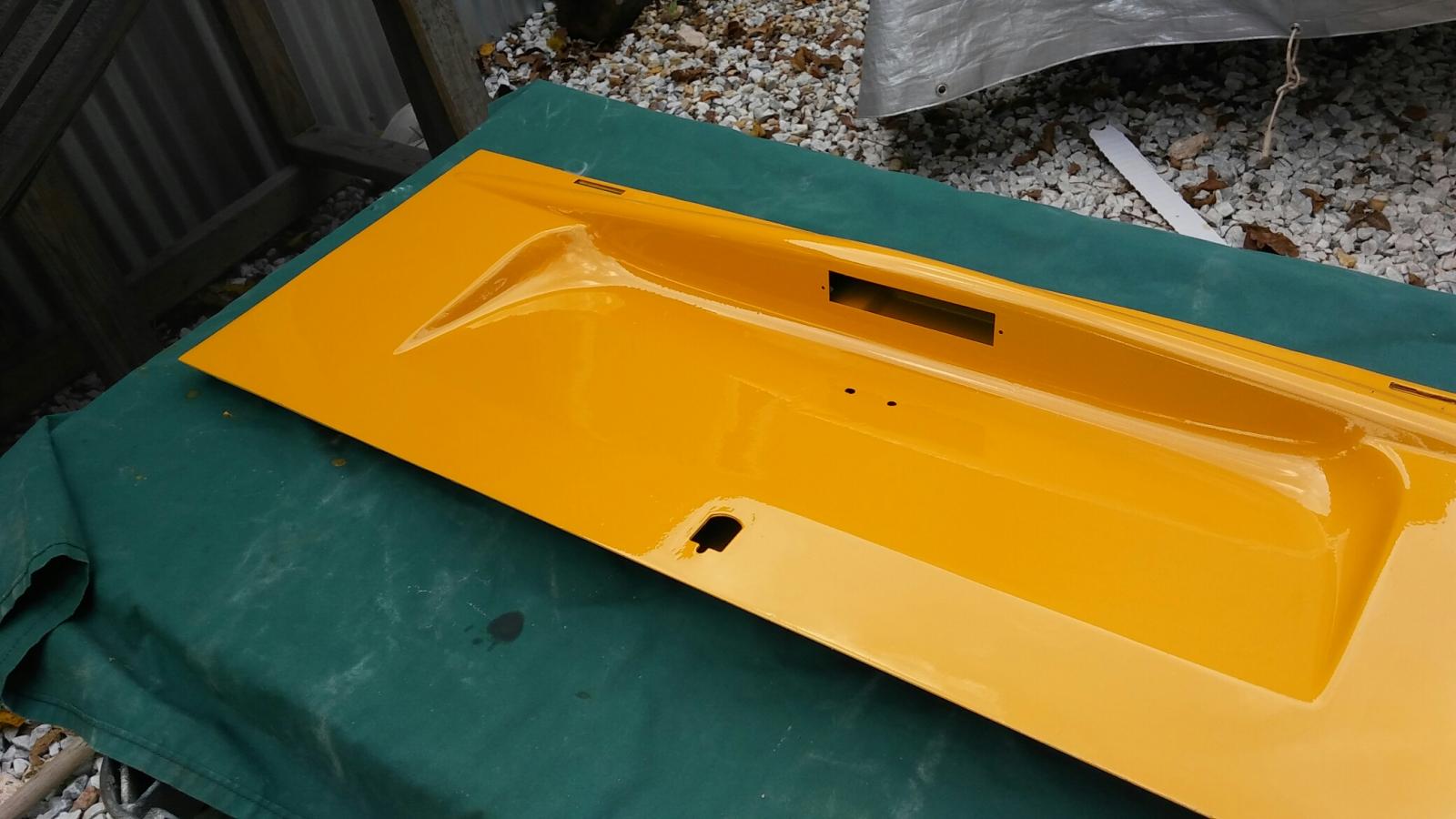

Since I knew I could have extra paint mixed, I prepped the backside of the engine lid since it was kinda crunchy. I can appreciate a patina bus but not sure thats my thing so shiny it is! haha

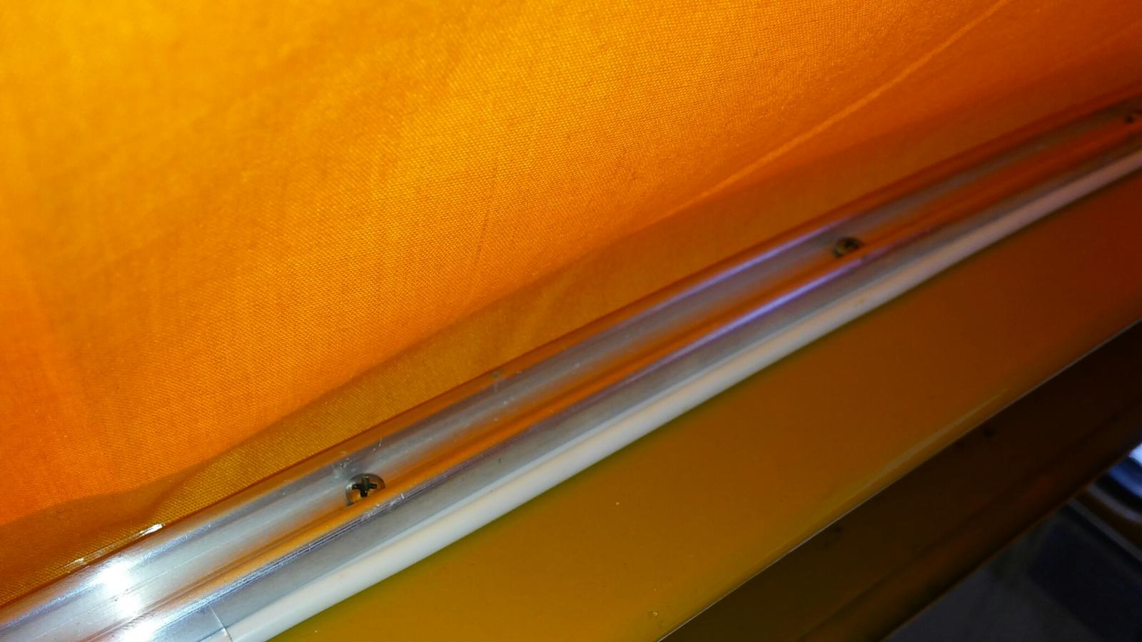

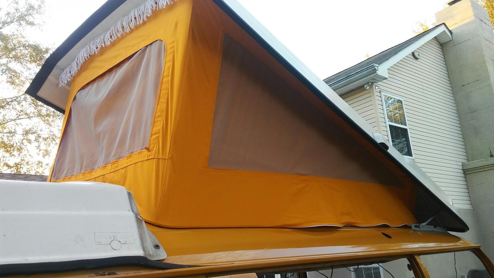

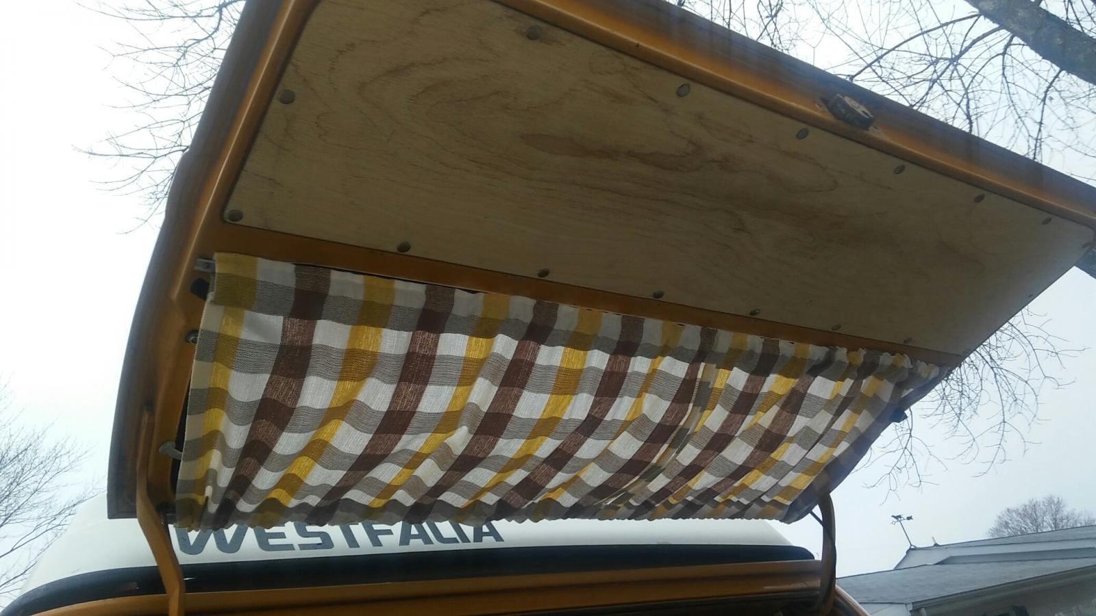

Now comes the tedious job....attaching the canvas to the metal roof by way of all the original screws.
First I had to clean the aluminum strips, and a brillow pad and a hose did an amazing job. Nice and bright.
I started with the front and back middle strips to hold it in place, paying attention to wrinkles. Next up was to install the corners. I used a very sharp dental like poker to push holes through the vinyl welt. I had a few of these so I would line up 3 holes at a time and install the screw in the middle, this made it much easier.
I'm not done, I ran out of time after doing this for about 2 hours. I would say to anyone doing this job do not set a deadline and you will do a great job.
My helper
Gettin there, ran out of time.
I'm going away for a couple of days but hopefully this weekend I can finish this up. I plan on buying a brand new screwdriver to get the corners tighter since I was worried about stripped screws.

So I managed to finish up the canvas install. I have to say, the most tedious job is getting all those screws back into place and aligning the vinyl welt. I think it took me about 4-5 hours.
But it looks great! If I must say so myself. Laughing Toit like a tiger!

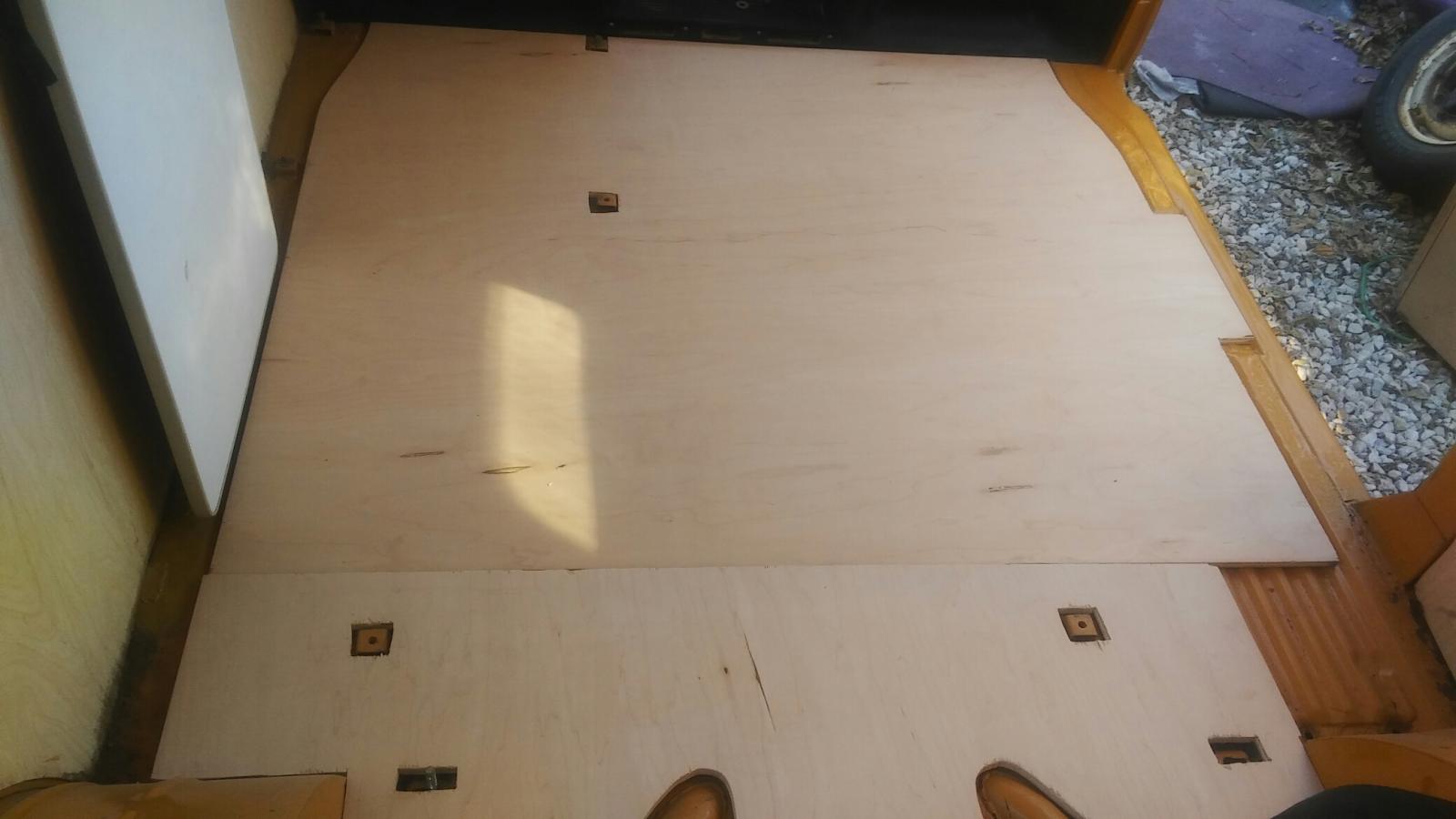

Built a new subfloor using 1/2" birch. Probably overkill to use birch looking back at it, but I figure thats probably what they used at the Westfalia factory.
Next was the fun part, laying down the vinyl floor. I decided to go with Stainmaster "Handscraped Retreat", who knows how the hell they come up with these names, but its a pretty good match to the westfalia laminate on the cabinets, etc.

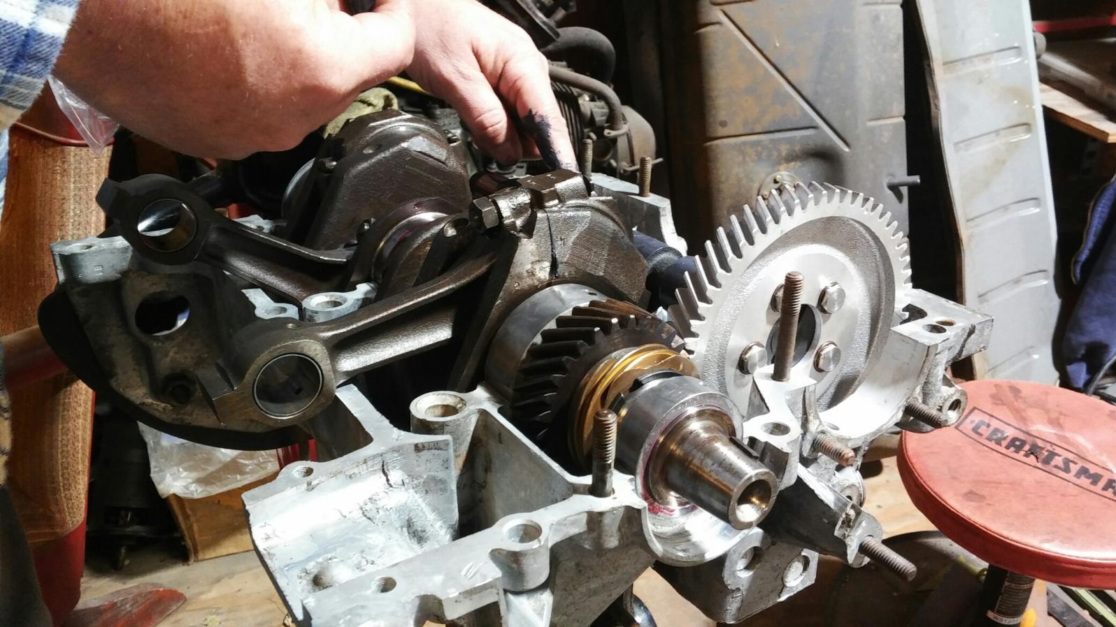

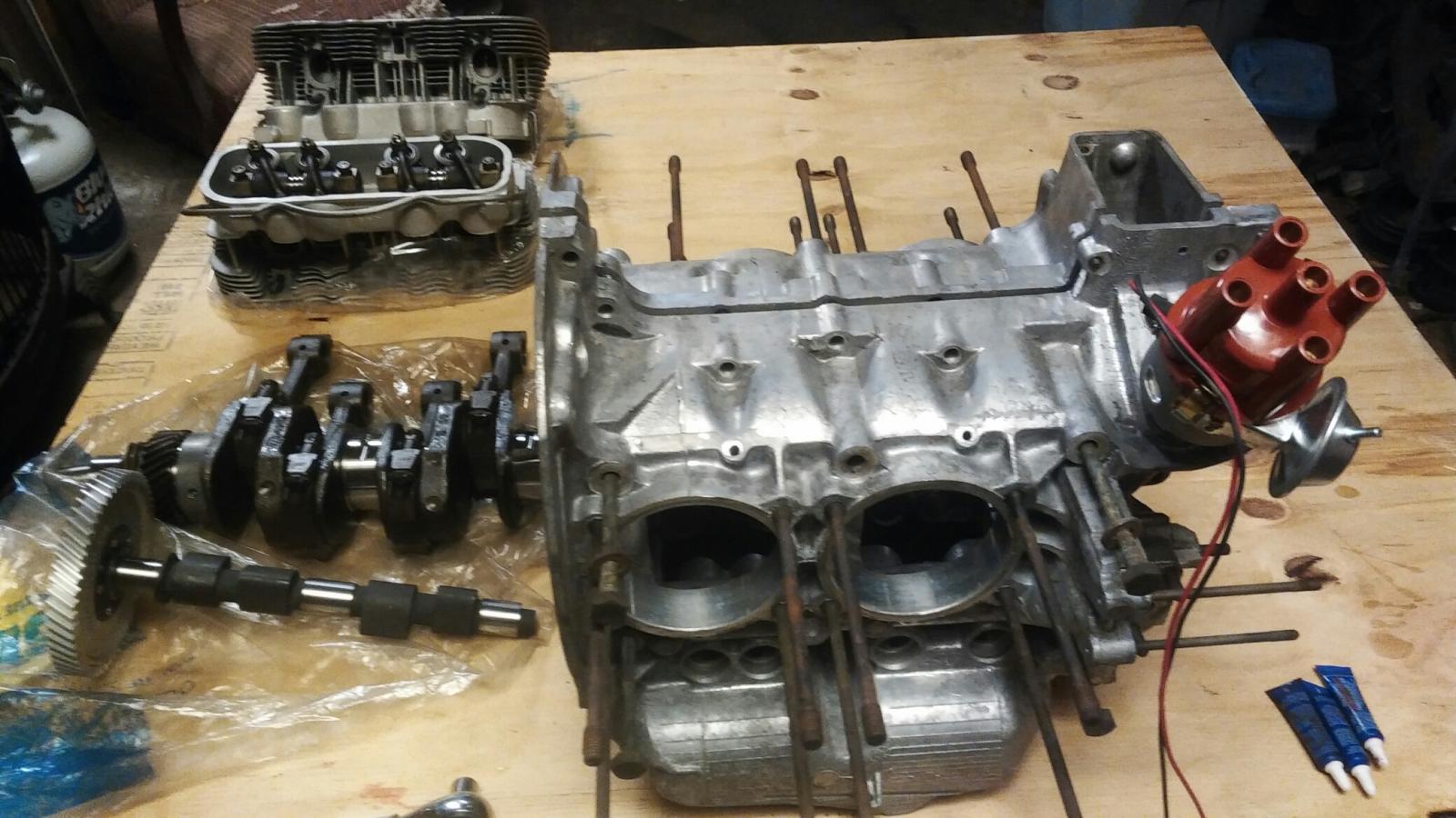

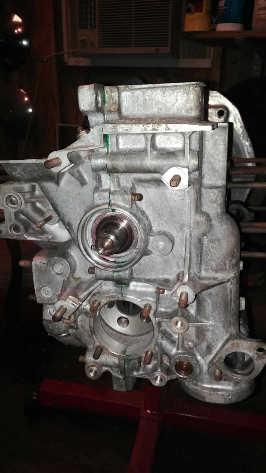

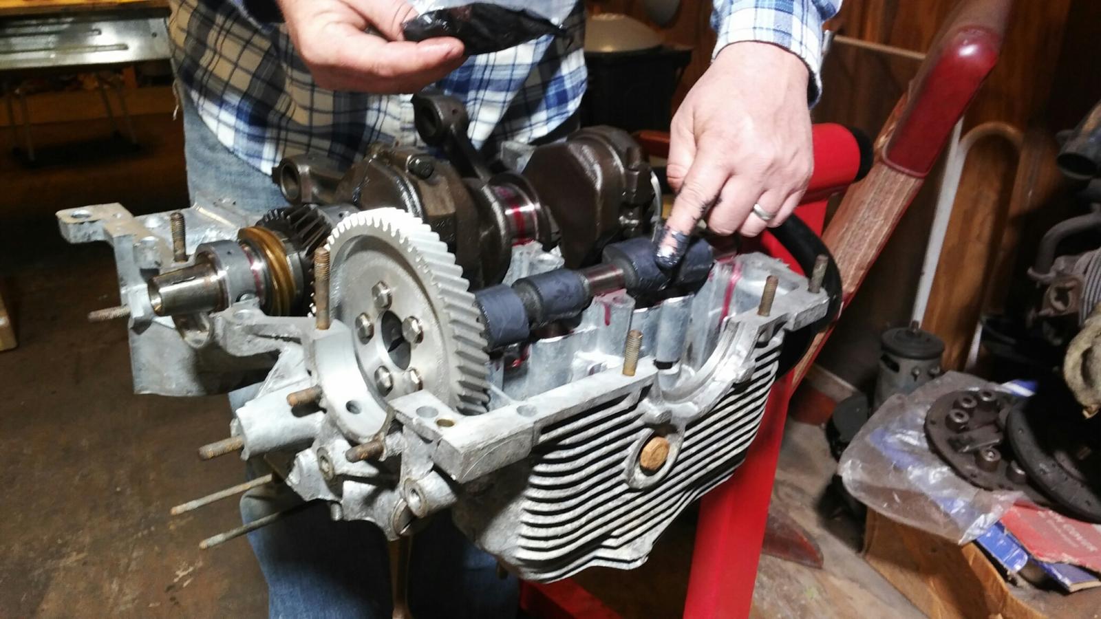

Last but definitely not least! The engine build has begun. My son took most of these pics. The crankshaft is assembled and dropped into the case along with my Fat Performance Cam and new Cam gear, and of course new bearings. I used K2 Kuryl to seal the case halves, that's the green stuff.
Shadetree Westy
http://www.thesamba.com/vw/forum/viewtopic.php?t=657279&highlight=
Single Cab - BBXXVII Long Distance Winner
Schwing
Joined: May 10, 2009
Posts: 2508
Location: Centreville, MD
Schwing is offline
PostPosted: Wed Dec 14, 2016 12:02 pm    Post subject: Re: 72 Westy - first bus Reply with quote
Forgot to mention, the machine shop rebushed the connecting rods, and assembled the crank for me. I used a high zinc lube for my camshaft, old guy said he has had it since the 80s so he gave me a dab in a ziplock bag.
I am missing the bolt that holds the oil pickup in place. Can anyone share the correct bolt size so I can get one? Or maybe someone can sell me one?
