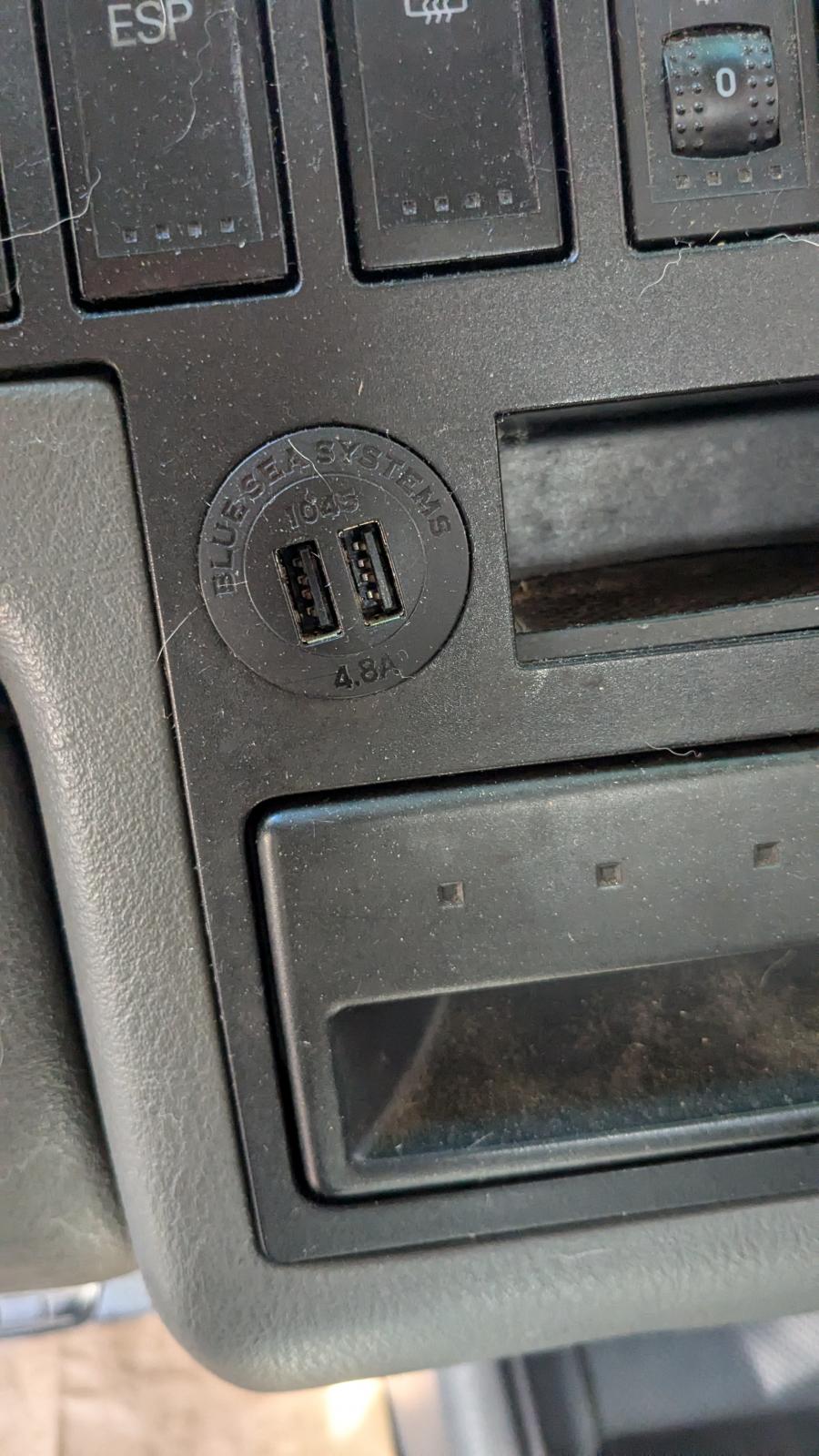

I did this with my 2001 weekender with a
Blue Sea dual USB
2001 eurovn weekender 207k fresh batteries
[email protected]
Joined: January 03, 2010
Posts: 322
Location: Amesbury, MA
samscholz96@gmail.com is offline
PostPosted: Wed Jul 10, 2024 4:04 pm    Post subject: Re: Replace cigarette lighter with USB port- ‘02 EVC Reply with quote
Sorry about the dog hairs but it is a dog car

How did you get cigarette lighter out of dash?
Looks like if it rotates 90* CW it would pull out, but I can’t figure out what keeps it from rotating.
hmbrgrs
Joined: September 03, 2021
Posts: 50
Location: Seattle
hmbrgrs is offline
PostPosted: Thu Jul 11, 2024 6:44 pm    Post subject: Re: Replace cigarette lighter with USB port- ‘02 EVC Reply with quote
unplug the connector, then the metal tube and bezel pull straight out if you pry up on the little tabs that clip it in. it was a long time ago, so i don’t recall the exact step by step, but seem to recall it pops straight out without twisting. i remember thinking it was a lot simpler than i expected.

PostPosted: Sun Jul 14, 2024 12:26 pm    Post subject: Re: Replace cigarette lighter with USB port- ‘02 EVC Reply with quote
No one ever accused me of being fast…
Got lighter out undamaged and installed usb port
The usb port to right is for apple car play
