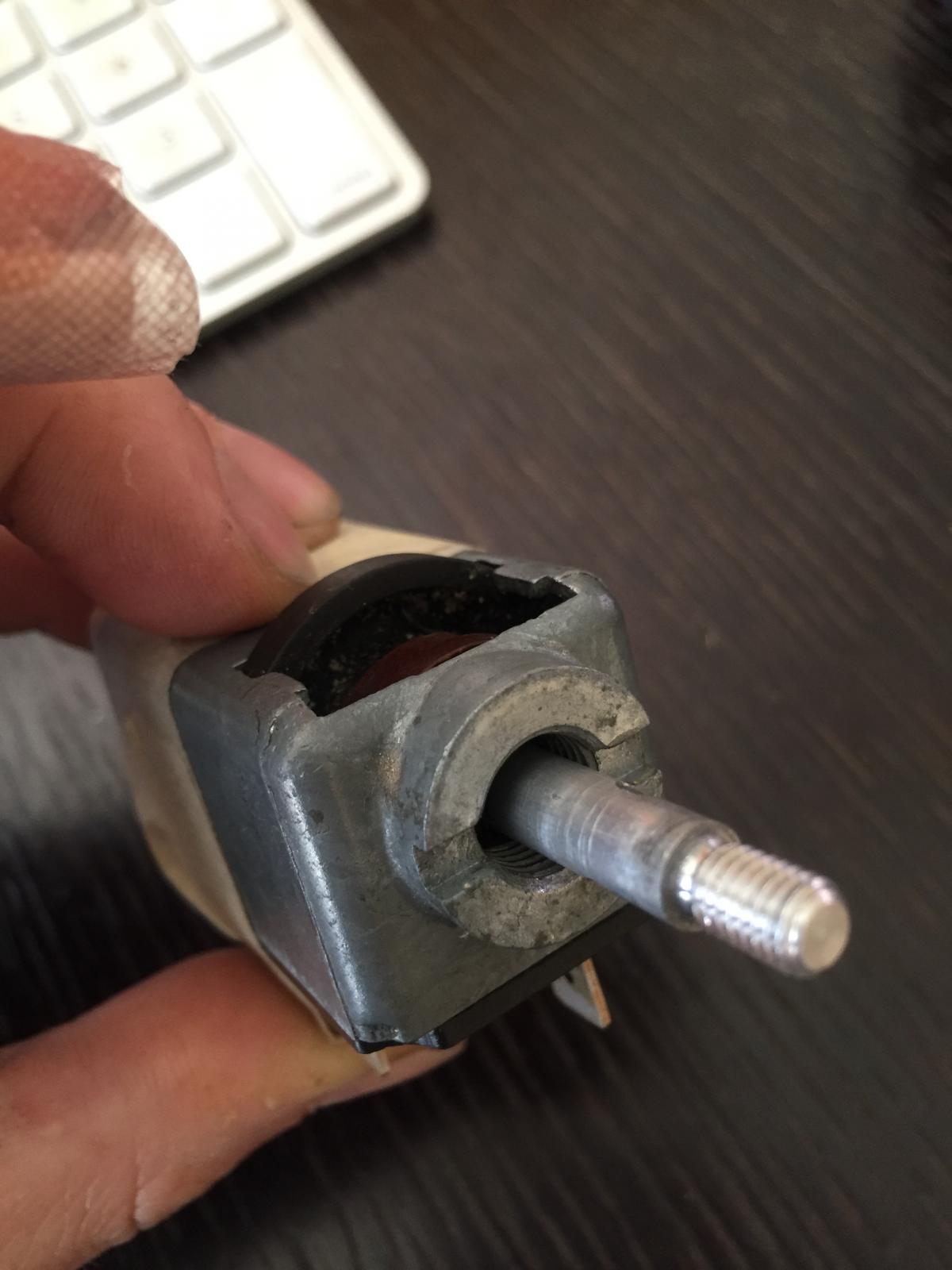

This can cause the back plate to crack and/or chip away at the corners of the plate where it is crimped/fastened to the metal body. It will eventually cause the two parts to separate.

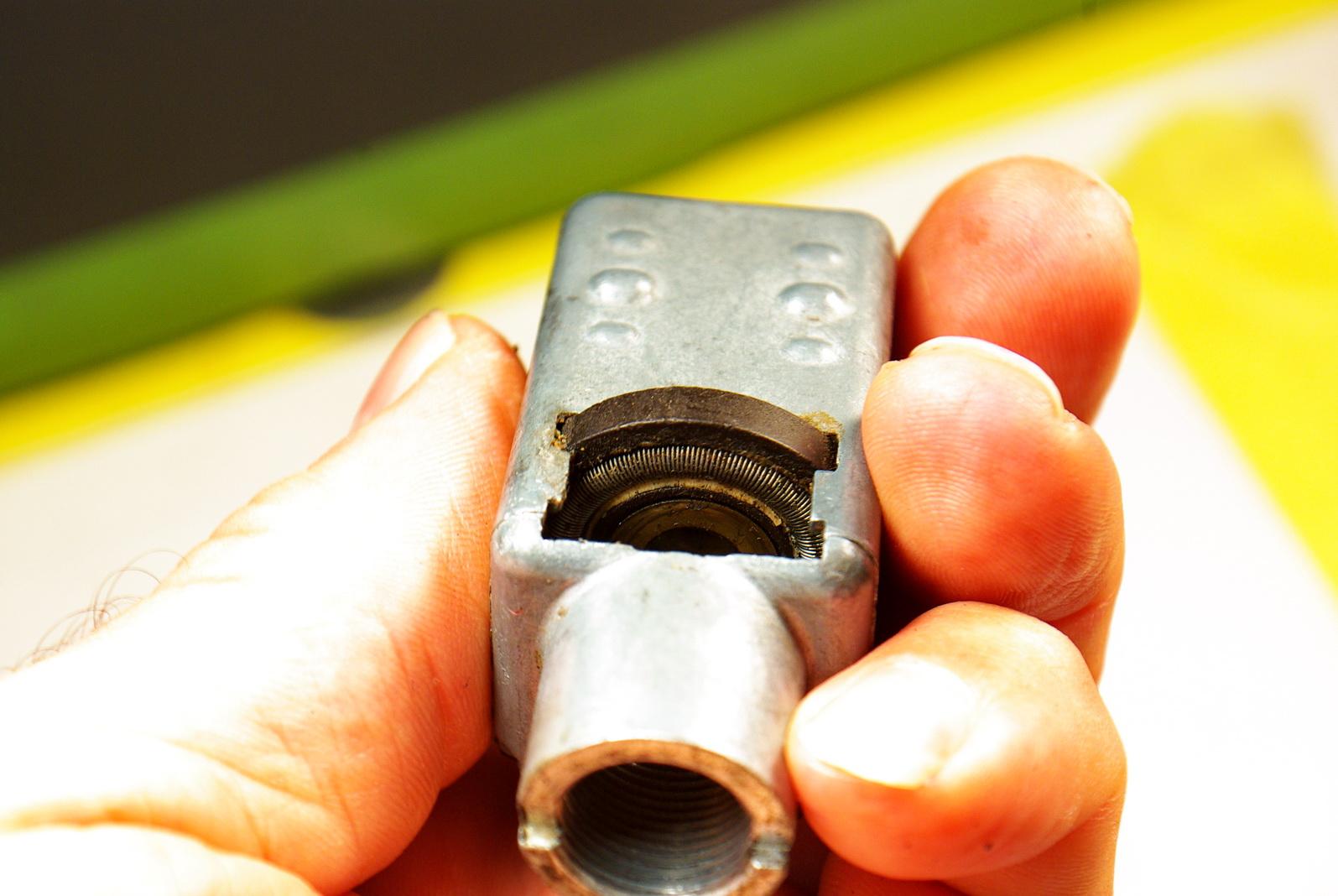

2. Because the switch has an opening in the bottom where the rheostat protrudes through that lets moisture/condensation in. If you do not have perfect seals in your car…meaning any leaks at all or live in a very humid area it causes the rheostat to corrode.
3. When the back plate eventually separates…and almost all of them will….at best, you lose headlight, parking light and dash light function. At worst it can create a short that causes a fire.

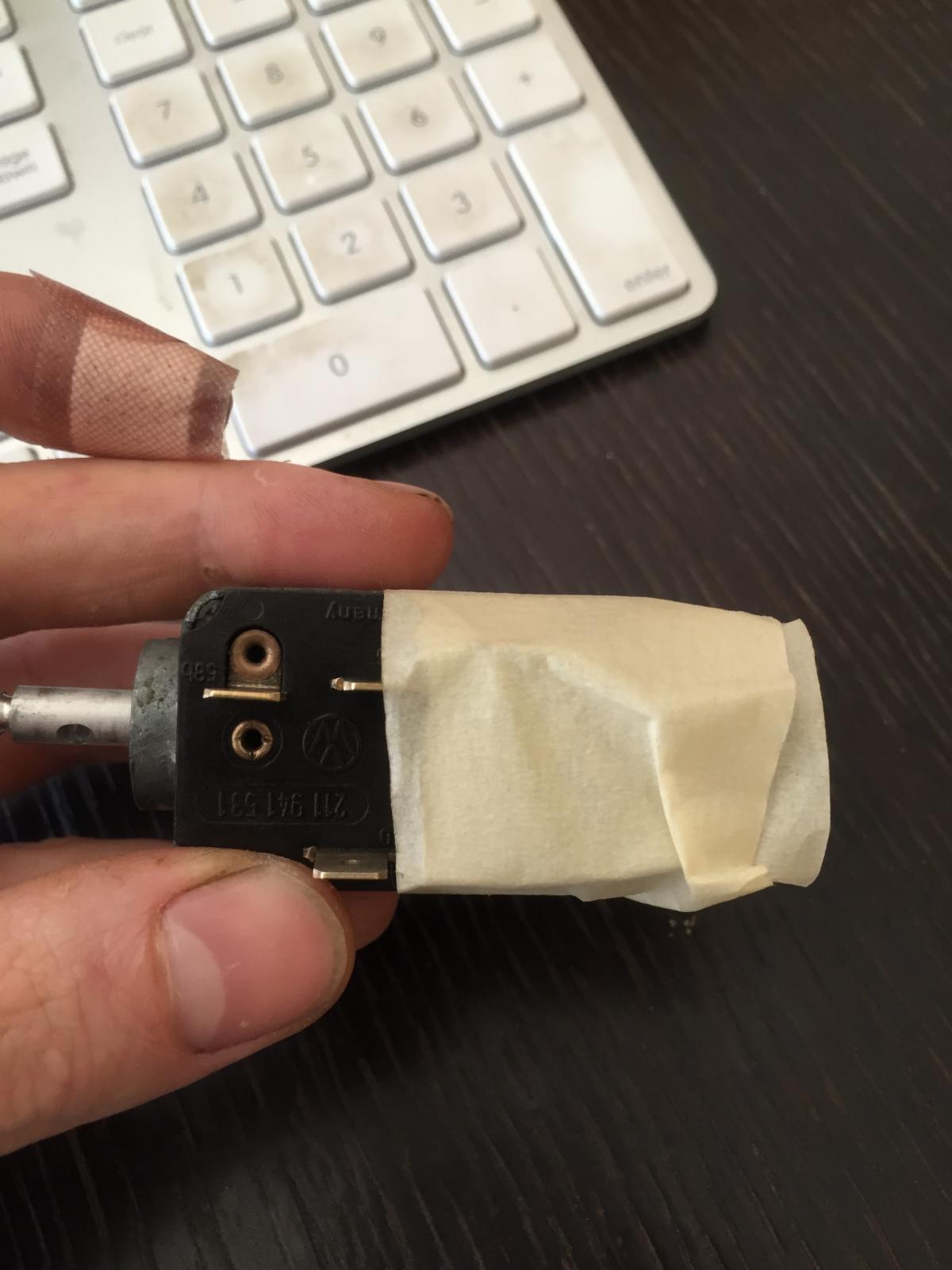

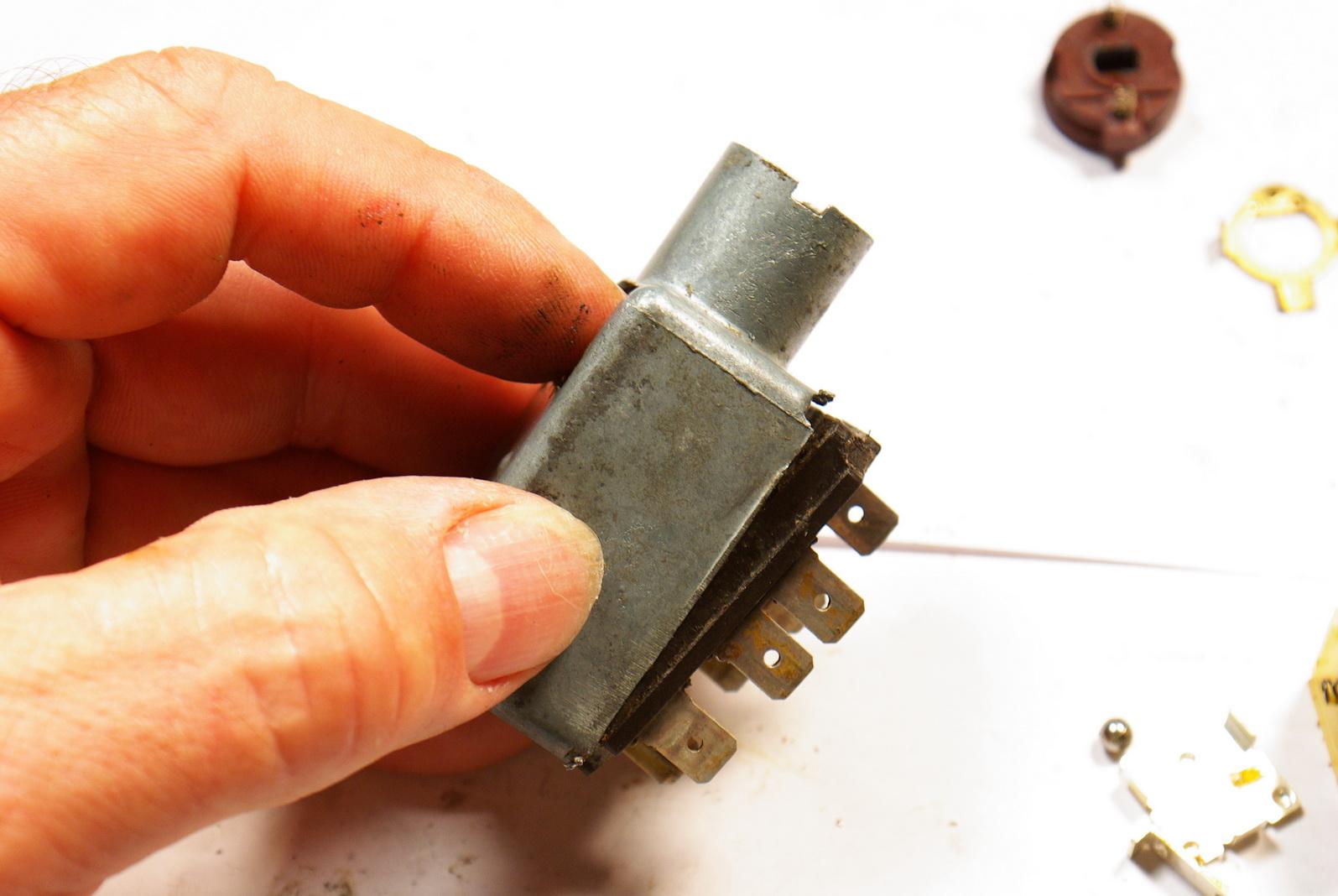

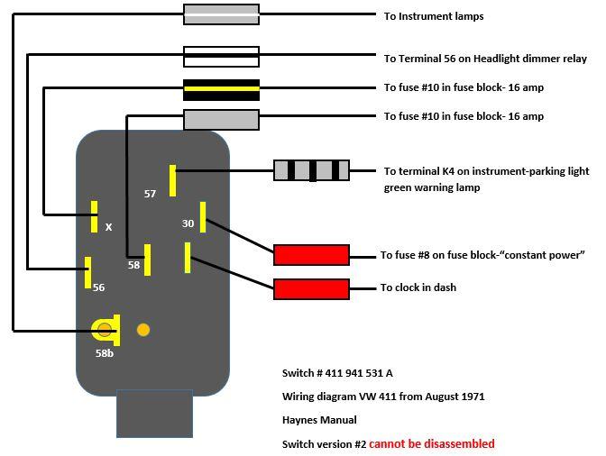

The most common switches in the US are the 411 941 531 A found on most of the 411 from 71 through 72 and the early 412 in 1973. The 411 941 531 D was essentially the same as the “A” version with the difference being that pin 57 was omitted and the 58b pin is 2.8mm.
I have rarely seen a 411 941 531..as it would have been 1968-70 and have no idea if there is a “B” or “C” model …but I would bet assembly and cleaning are similar.

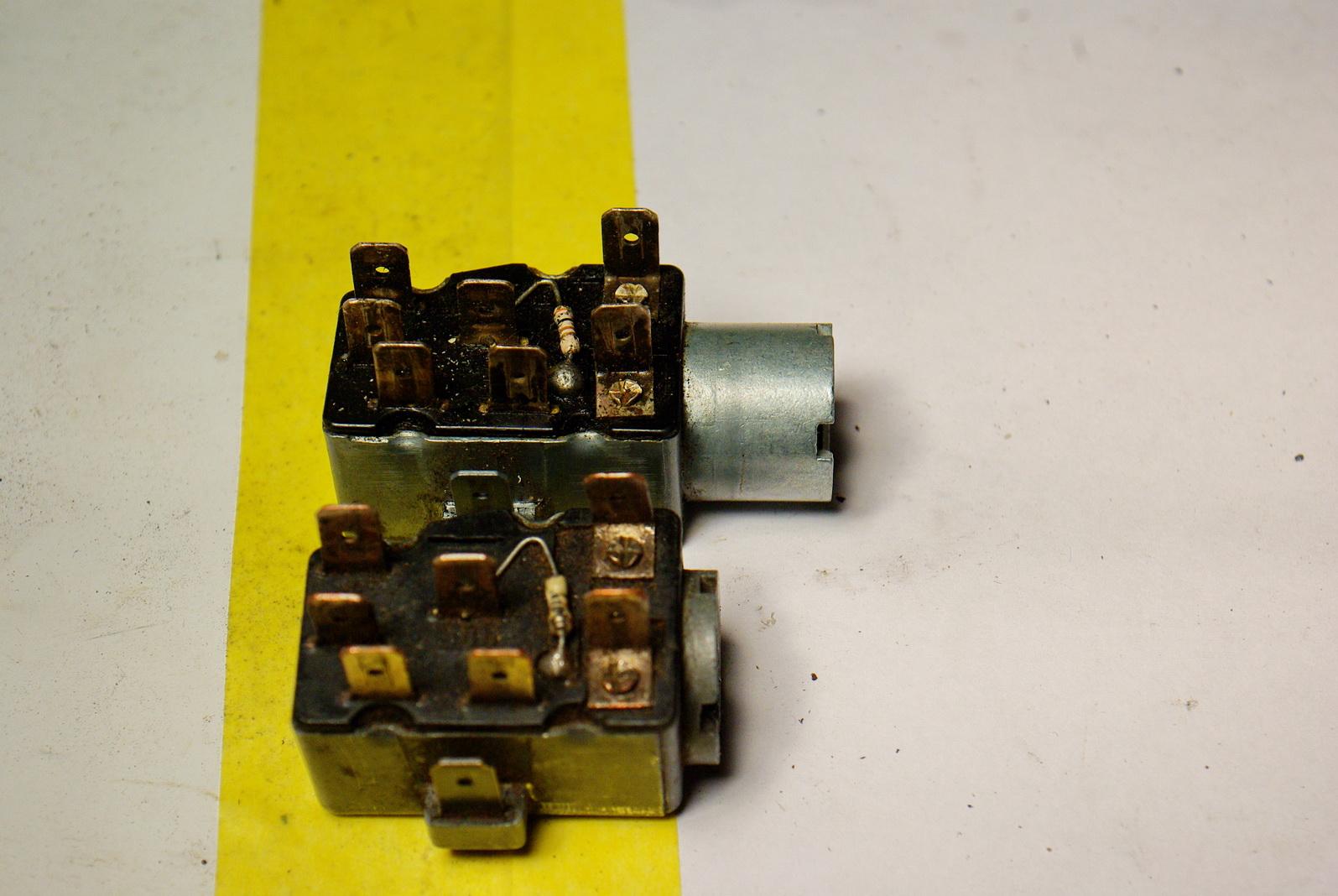

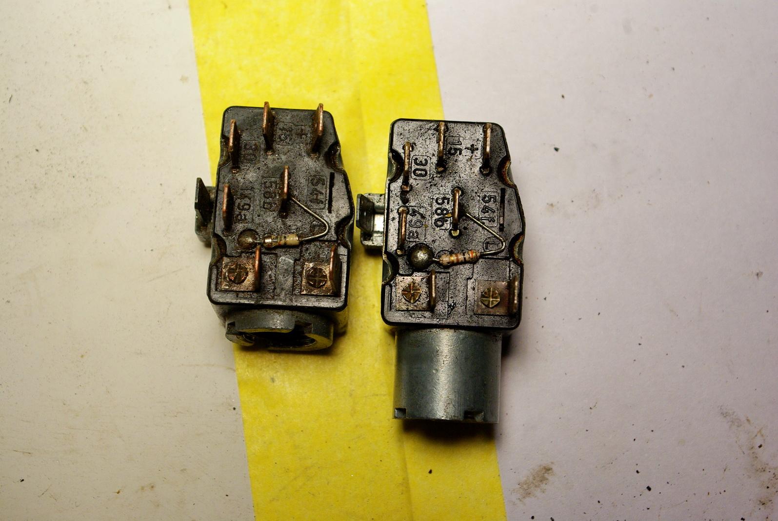

There are two versions of the 411 941 531 A. The most common one is easy to disassemble. The other less common build has a riveted shaft and cannot readily be disassembled. I will talk about how to clean and lube that one.
I disassembled two of the same switch type. One had a very common problem of the rheostat being totally disintegrated. In that case….you have the option if you are industrious of rewinding your own rheostat coil from resistance wire and soldering the live end and then applying ceramic mastic to keep it in place.
While I hate not having anything not working in my cars….this one I am willing to live with. Without the rheostat the dash lights will still work…just at 100% instead of being variable. They were not super bright in the first place so most use them at 100% and rarely notice that the rheostat is gone.
I will show parts of both so you can see what we are looking at.

NOTE: If your connector plate has popped loose, carefully shake out any loose parts and keep them and snap it back together and hold it with a zip tie. You will be decrimping the corners either way.

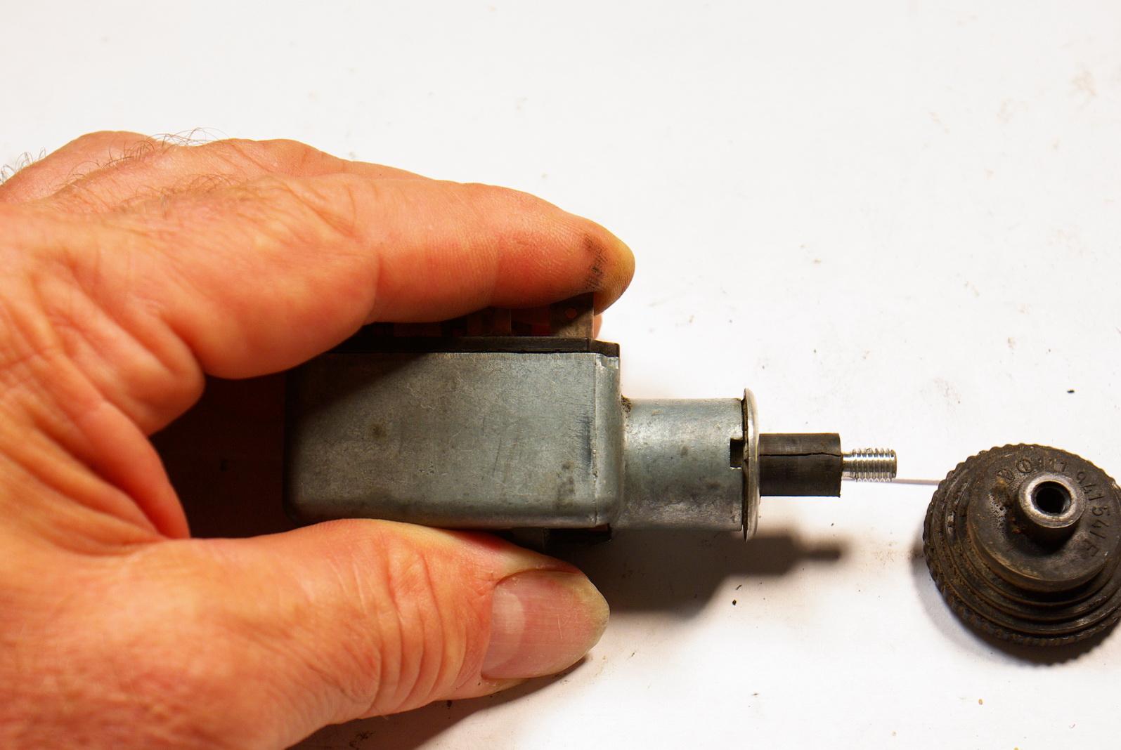

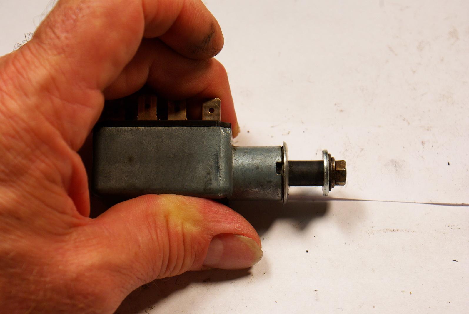

Here is the switch with bezel screw and knob
Pull the knob all the way outward
Unscrew the knob

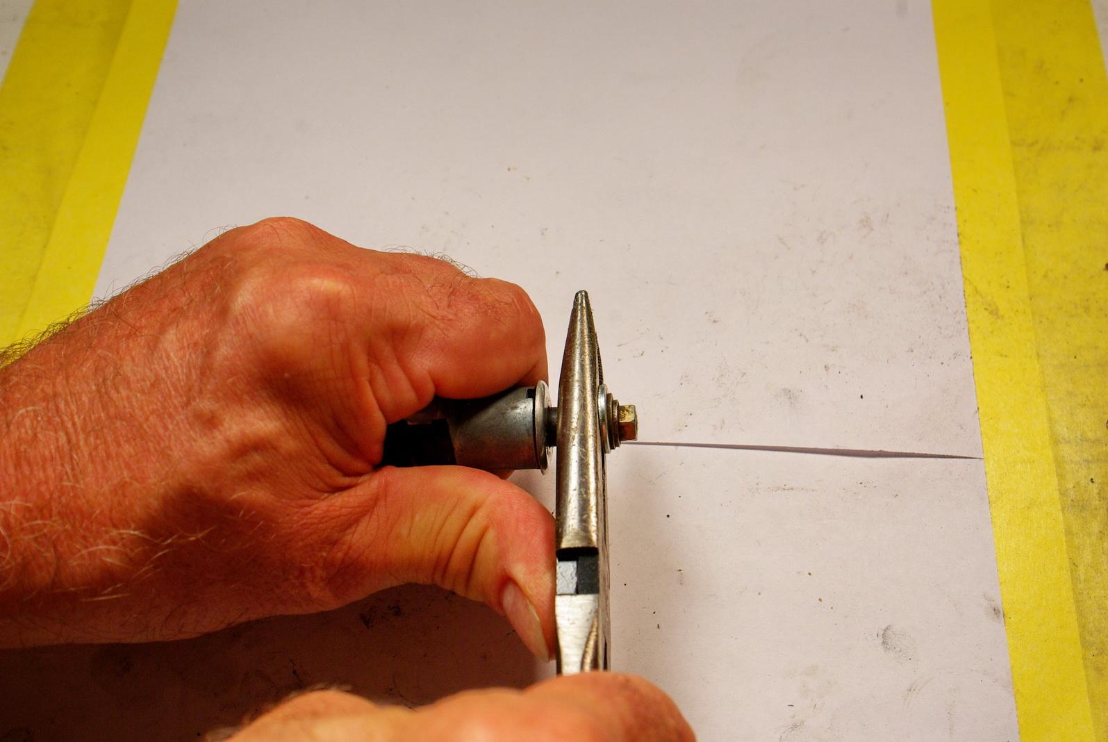

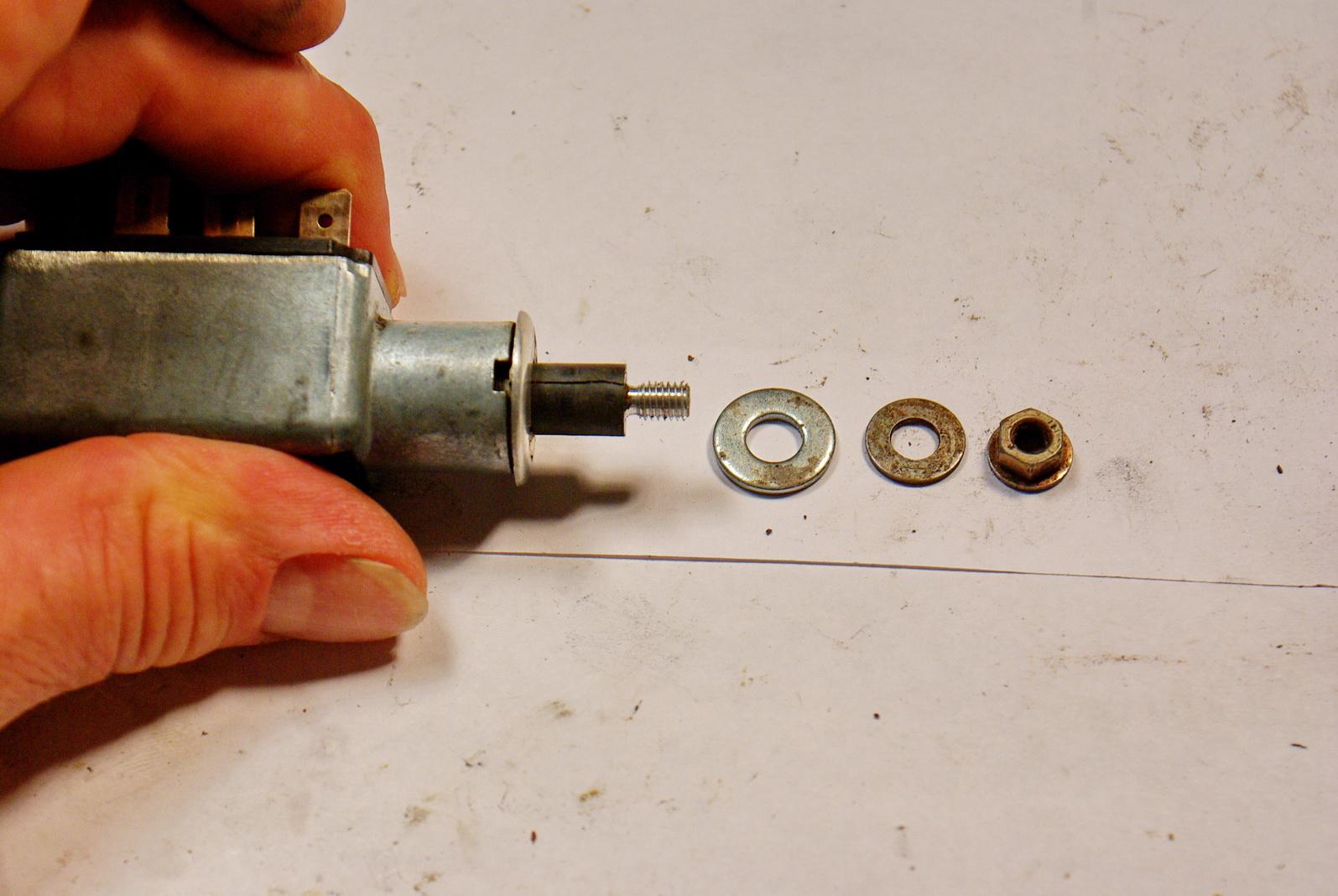

Find a 5mm nut and a couple of washers
Thread the nut and washers on down to the plastic ferrule
You can use a pair of diagonal cutter pliers or a pair of Vise Grip pliers set to just larger than the ferrule. I am not biting down on the plastic here. I am just using the pliers for leverage. Grip the switch firmly and pull the shaft out with a pop.

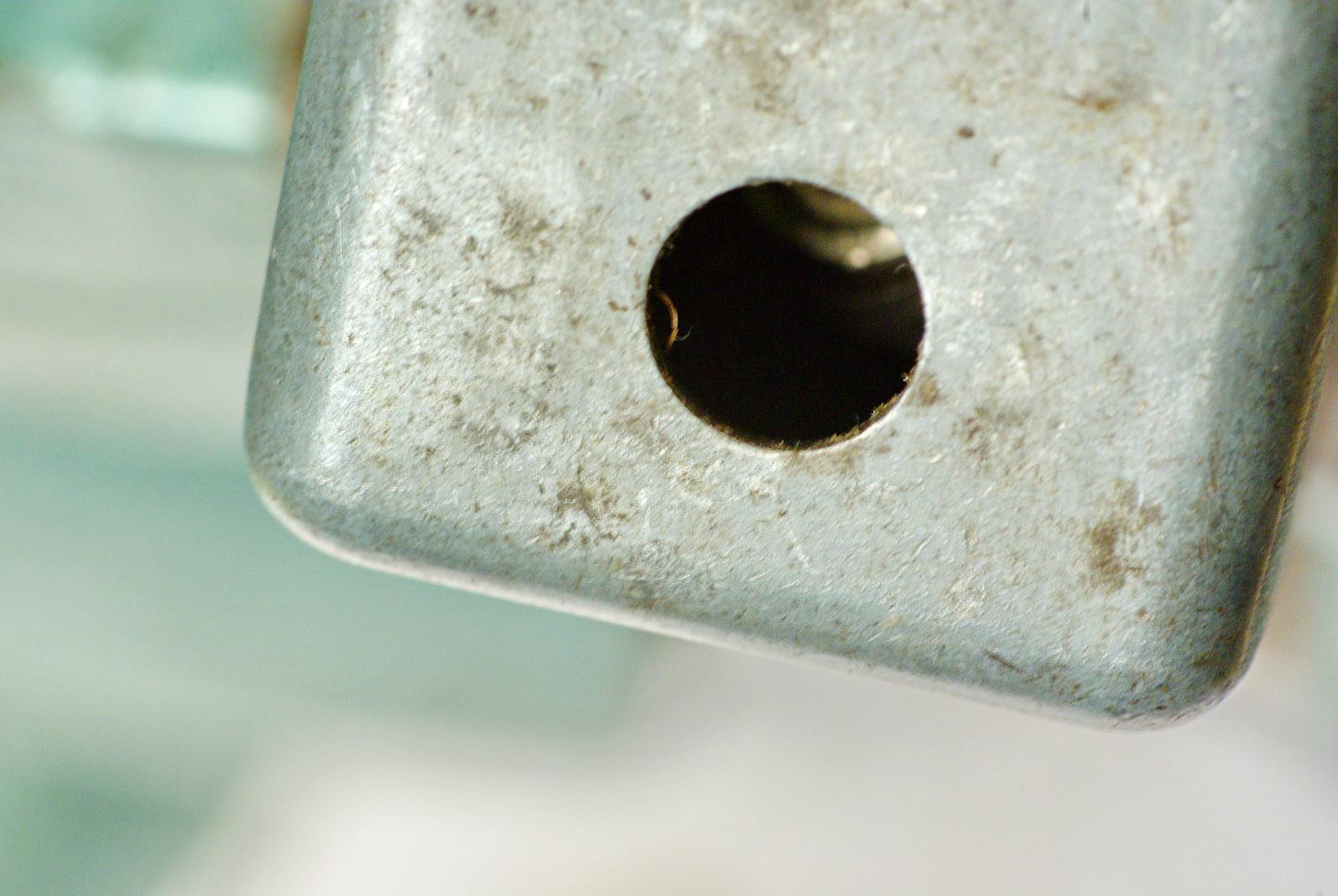

[color=orange]Important note:[/color]

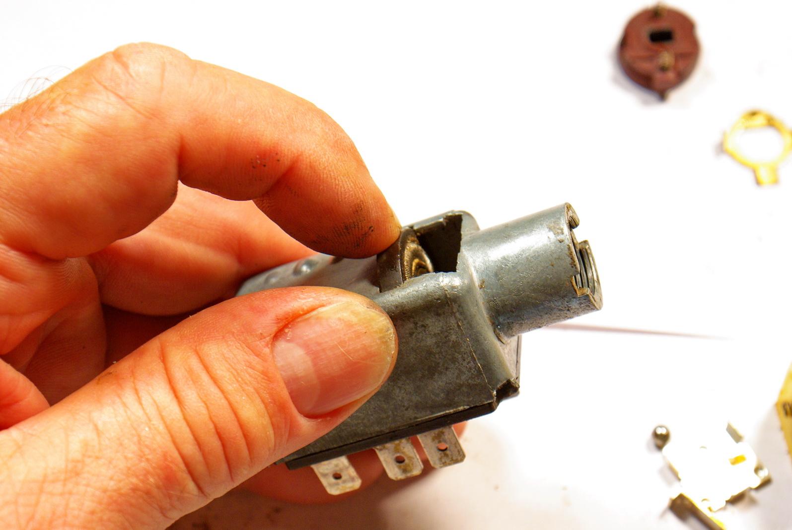

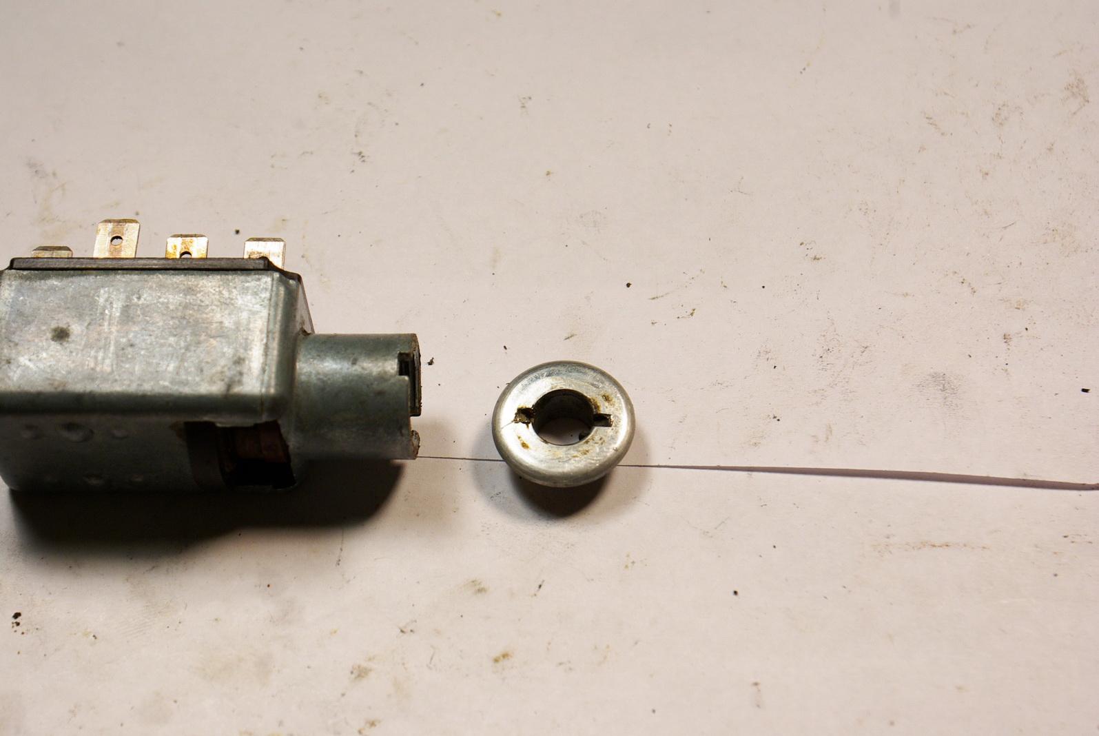

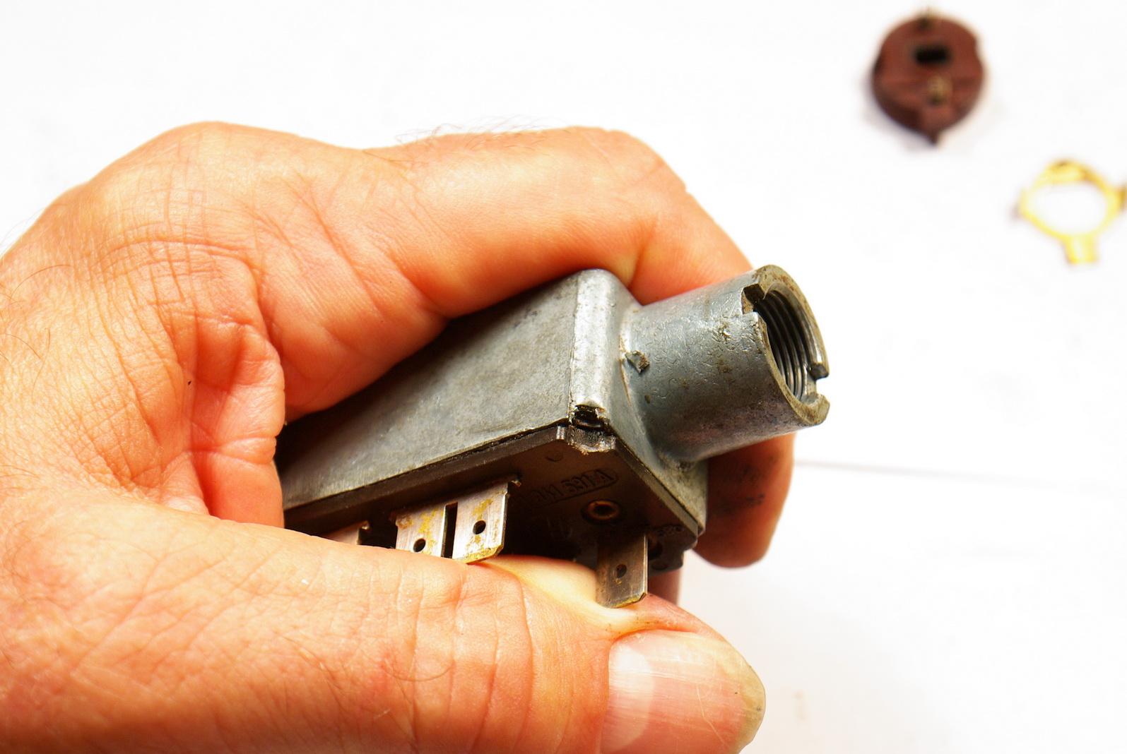

If your switch has this opening opposite the knob….you cannot remove the knob and you cannot do this disassembly. Skip to the last chapter.
Shaft pulled out.
Unscrew the bezel

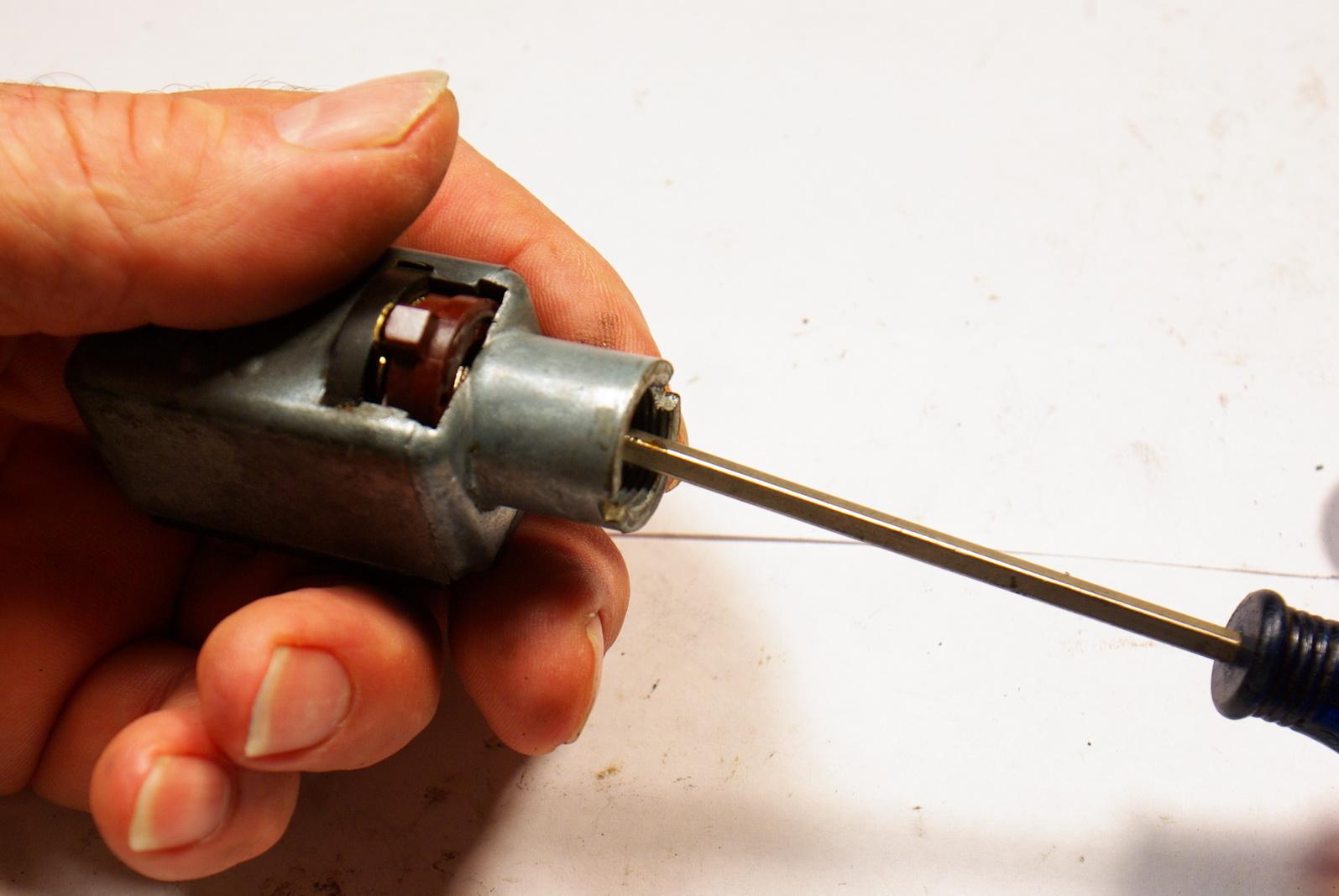

Flip the switch over so you are looking at the rheostat. Insert a small screwdriver and slowly lever the rheostat armature out….SLOWLY AND ONLY ABOUT HALFWAY. IT IS SPRING LOADED!
Grip it tightly…the springs are surprisingly strong….and pull it all the way out.
Once it’s out, set it aside and release the tension slowly. The springs will rise about 3/16” and then you can lay it down flat.
NOTE: it pays to be working over a little magnetic parts dish (about $3 at Harbor Freight)

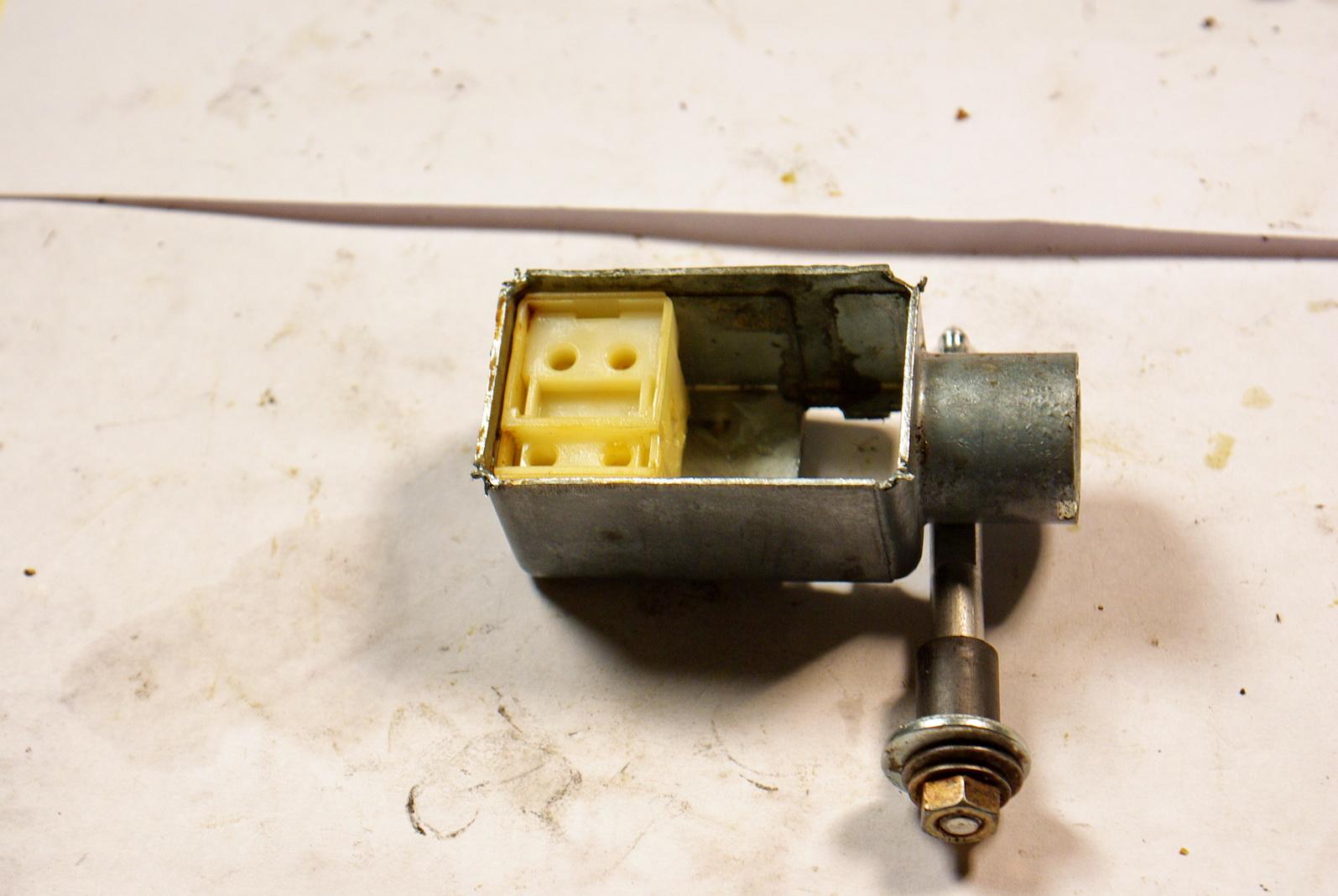

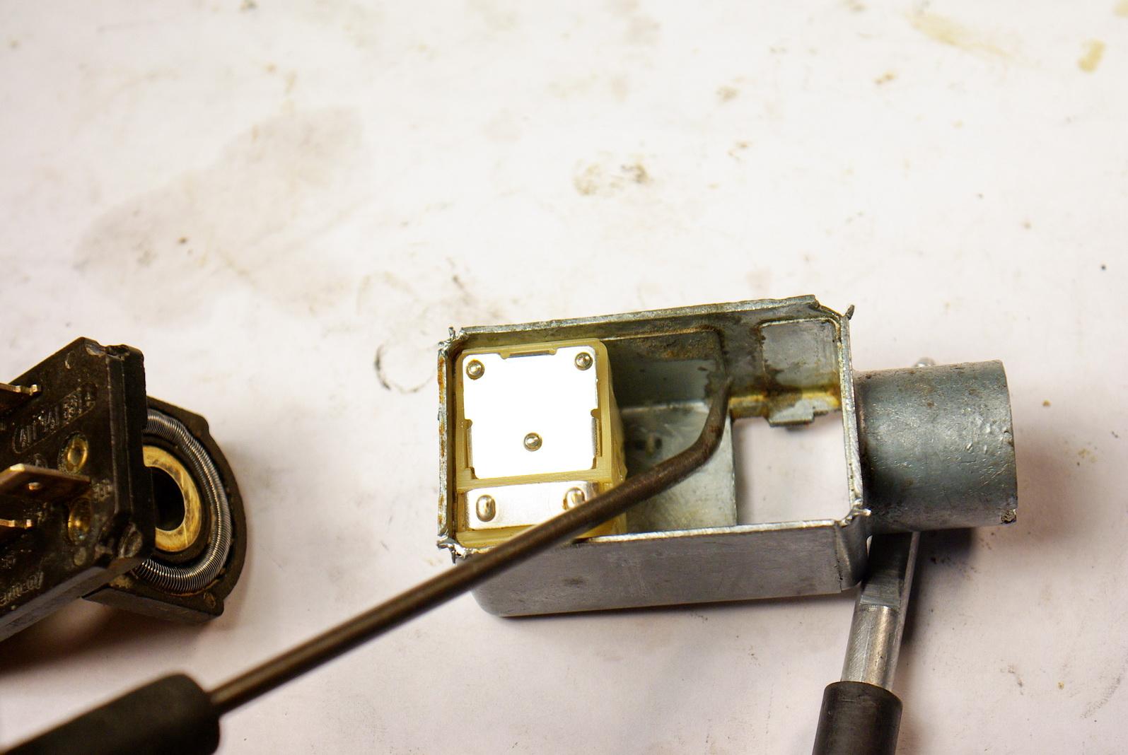

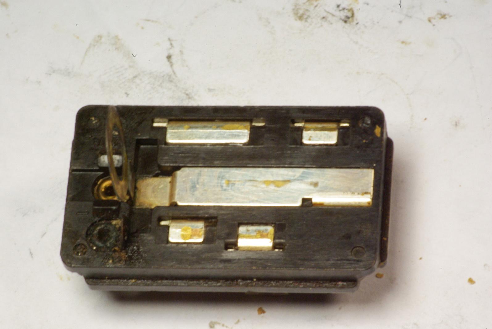

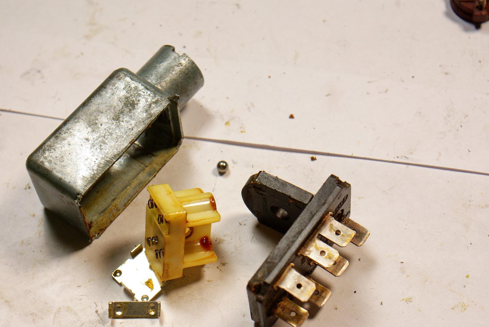

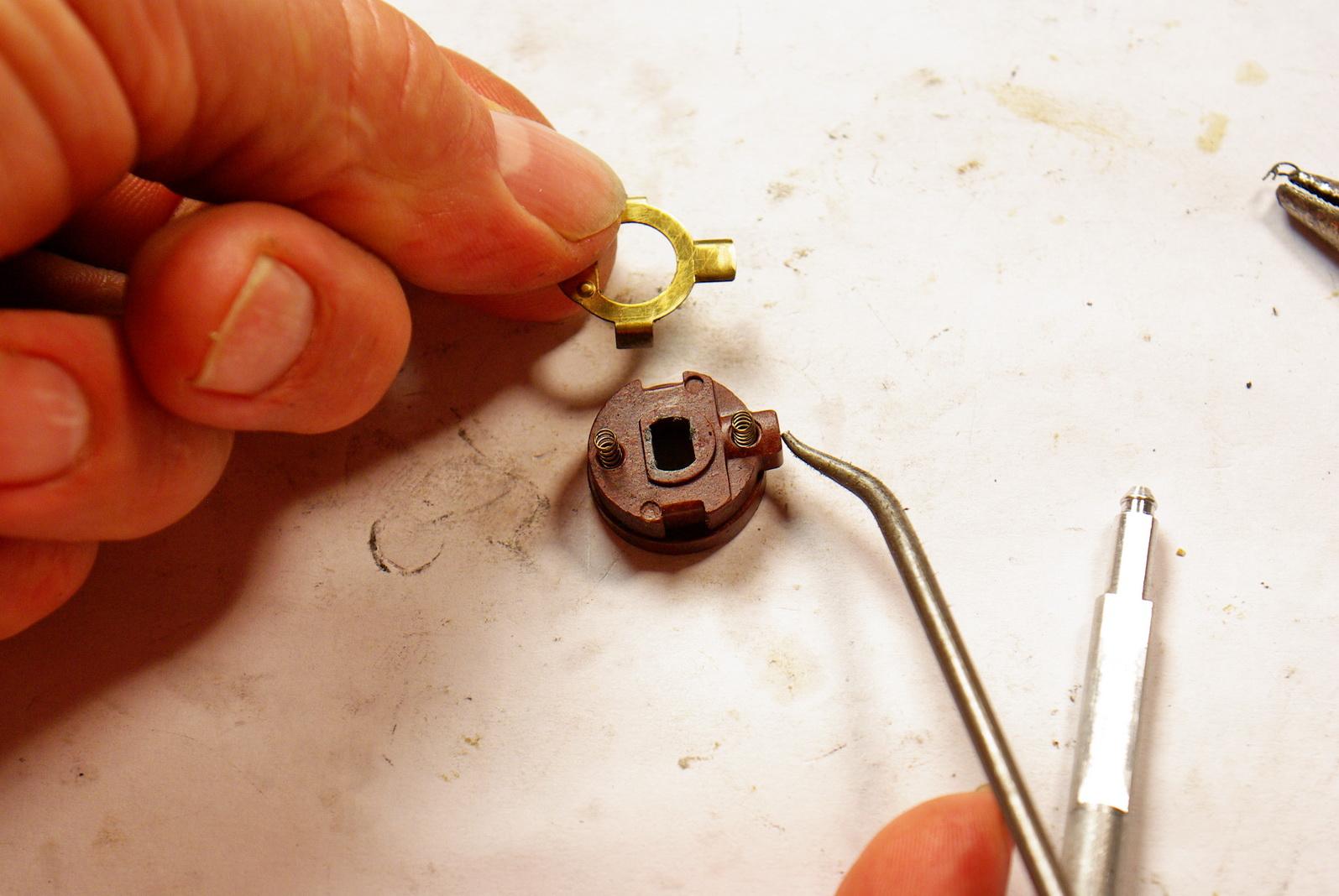

Here is what is inside. Two springs, the Bakelite hub and the contact plate.
You can see the rheostat plate here. It is a separate part from the back contact plate…but is connected to it via the rheostat wire being crimped to it. So if your rheostat is intact the back plate and the rheostat plate will come out together.
If the rheostat wire is broken the rheostat plate may separate from the back contact plate. It’s not a worry.

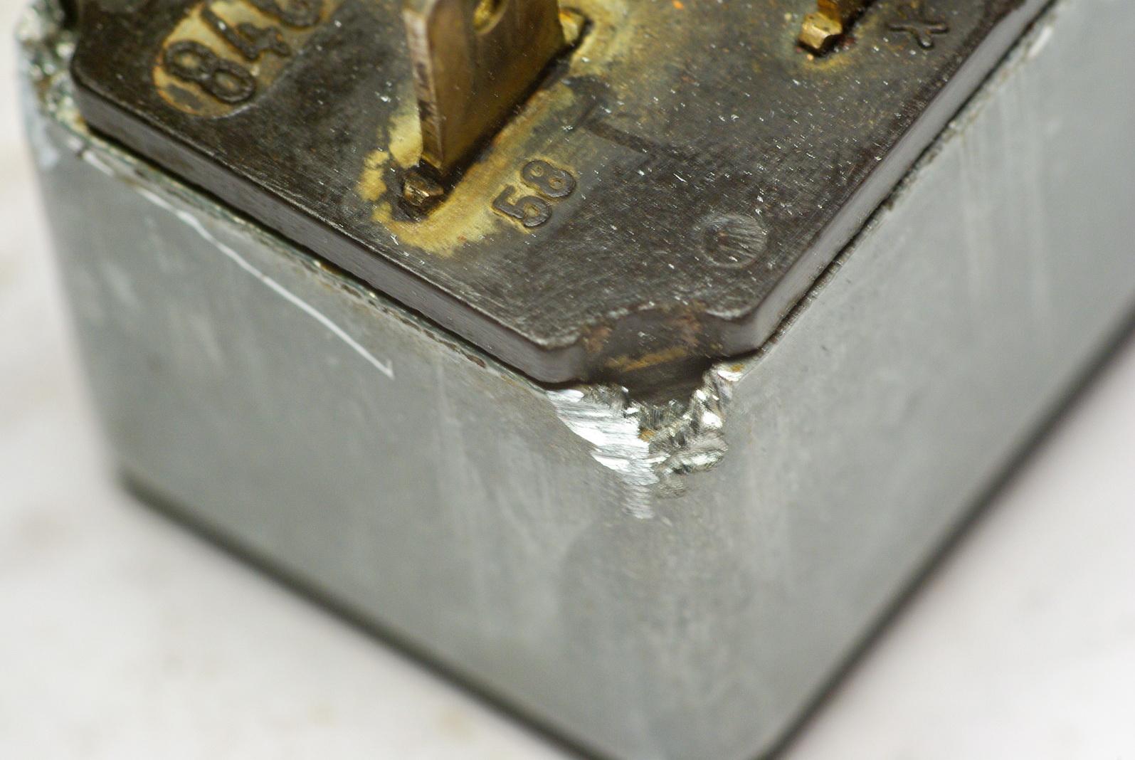

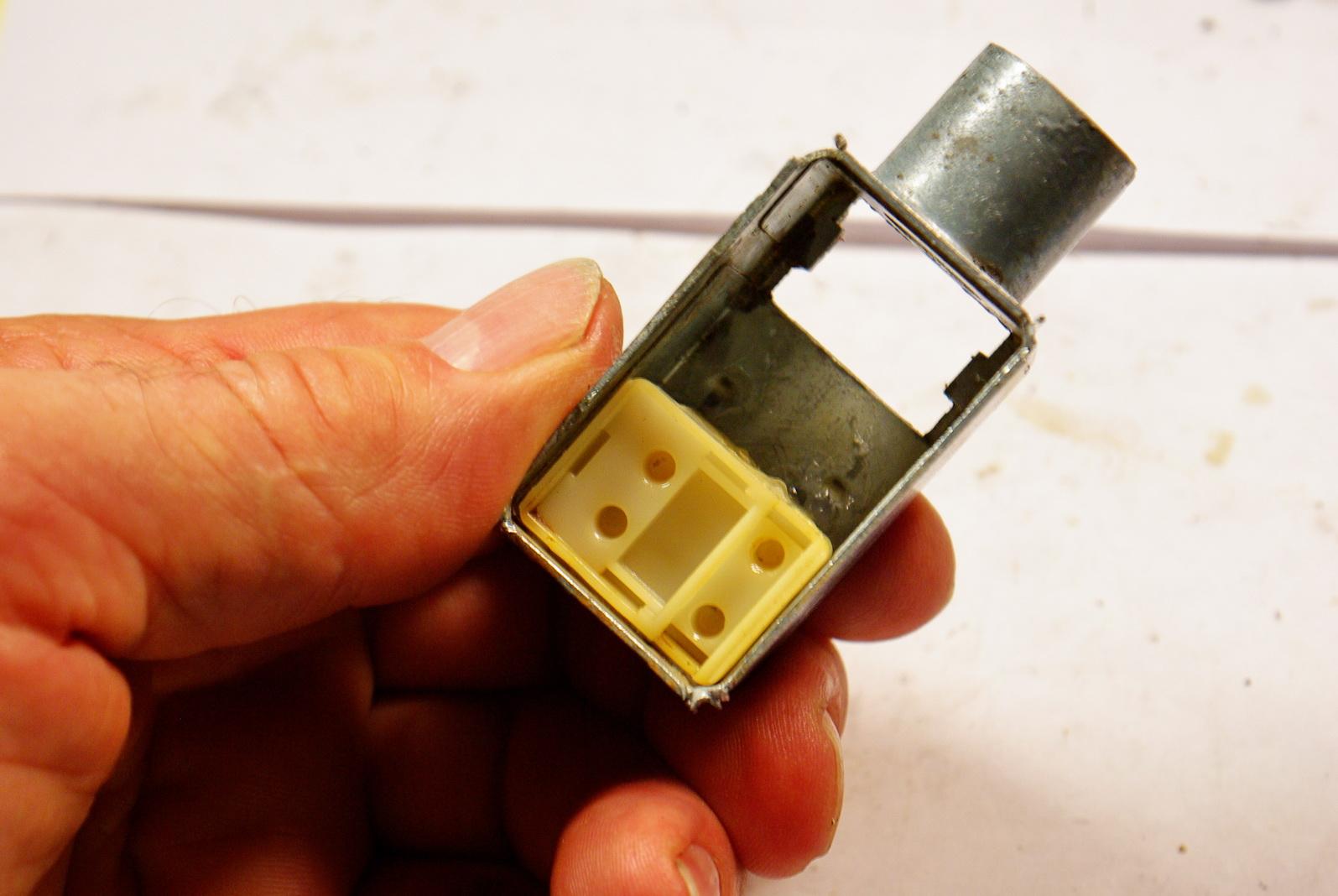

The metal of the enclosure is very brittle. There is no great way to uncramp this. The corners of the metal are going to crack no matter what you use…thin needle nose pliers or simply insert a thine flat blade screwdriver and twist lightly.
You can see how the metal has cracked away.
If the back contact plate has not popped out yet but can be wiggled and shows to be loose, remove the zip tie if you had one on it and holding the back plate from flying away….push on the rheostat plate with your thumb and fingers. The back plate should pop loose.
This is what you get.
This is looking at the rheostat plate still keyed into the back board. The brass center ring is power feed to the little plate that rides on the coil. The brass tab on the right that the rheostat coil is crimped to is where the rheostat stator contact resides when the dash light power is full on.
So you can see that even if you ripped out the rheostat coil or it was rusted away. Just turning the knob full clockwise will give full on dash lights operation.
If you need to remove the rheostat plate or to apply new ceramic heat sink mastic behind the rheostat coil…you carefully lift and pull from this end.
We will not be doing that.
It’s not worth it unless you are rewinding and replacing the coil. It is too easy to damage. That will be a later addition.

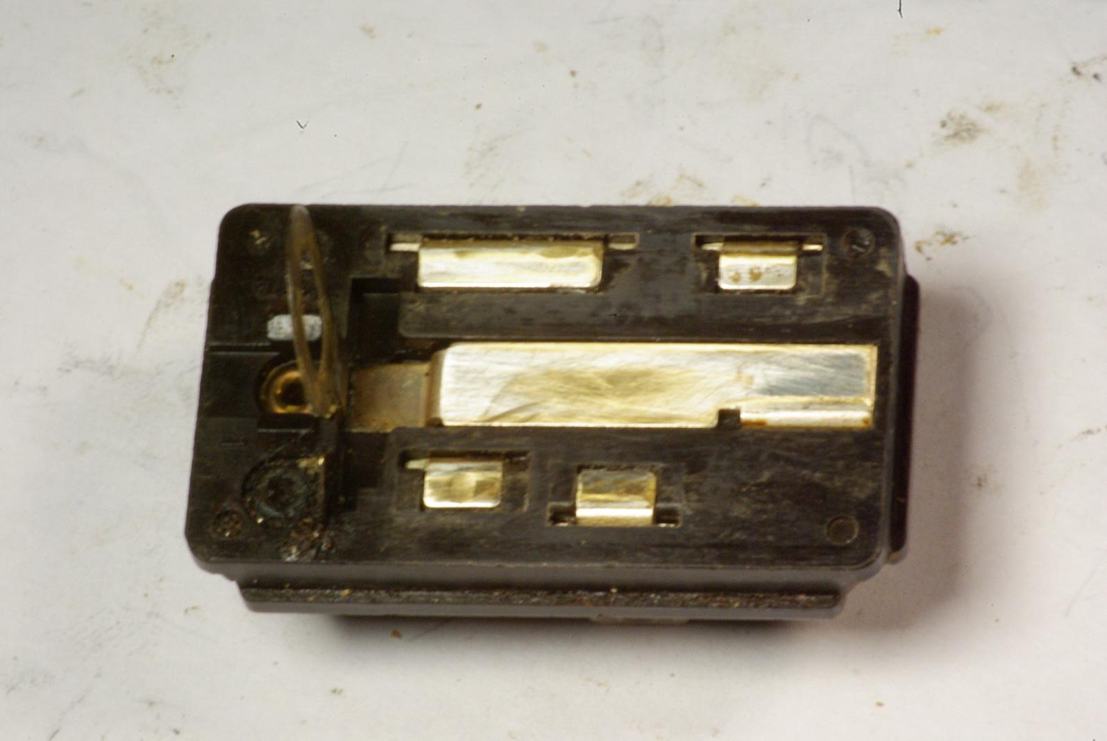

This is the switch board/back plate and rheostat feeder ring after circuit cleaner but before polish. This particular switch had the rheostat coil missing so the rheostat plate is removed for this picture
After cleaning with circuit cleaner and a polish with 2000 grit paper and another rinse.

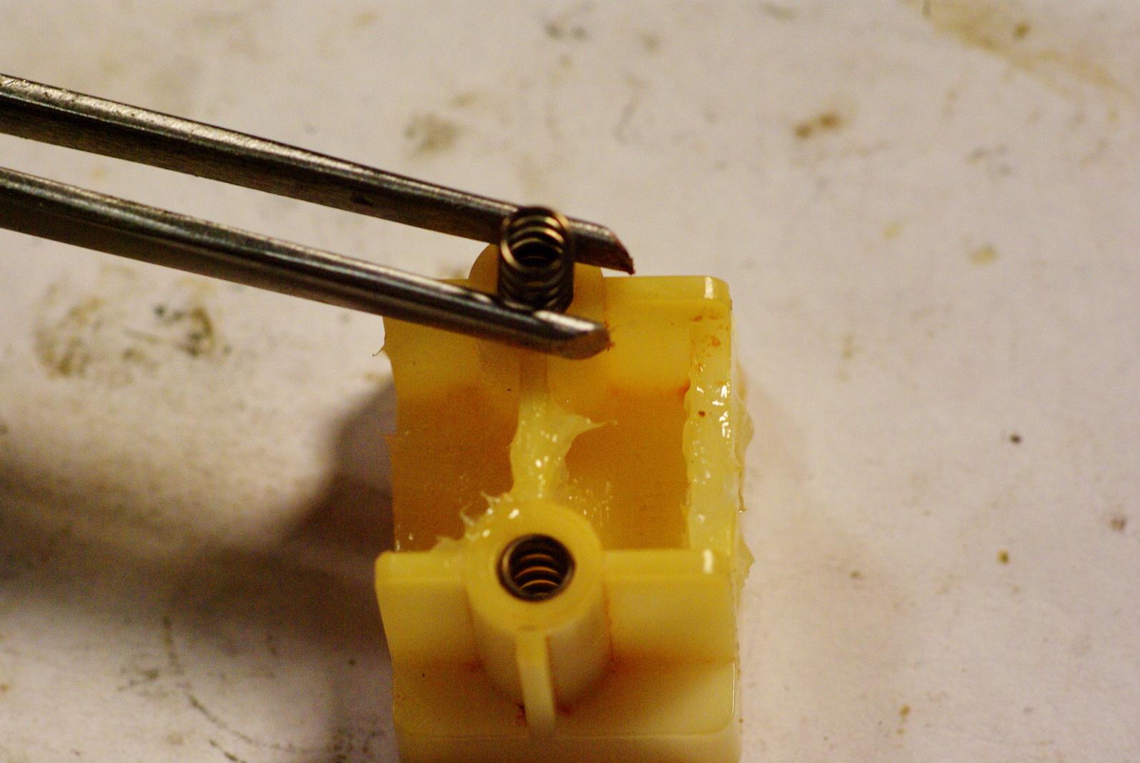

This is the nylon detent ball carrier slide after cleaning all the old grease off. The left hand side view goes on the back wall of the switch farthest from the pull knob.
It has the smaller hole for the barb of the knob shaft to pop into. The view of the same part on the left is the side that faces the knob. It has the larger hole that the shaft stem and barb pass through.
This is a view of the orientation so you can see how it goes. The holes are underneath. The barb pops through the smaller holes to rest on the back side of that bulkhead it is above. The two holes in the picture have springs inside (removed for cleaning) and the detent balls sit on top of those springs.

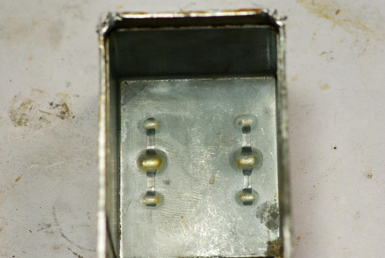

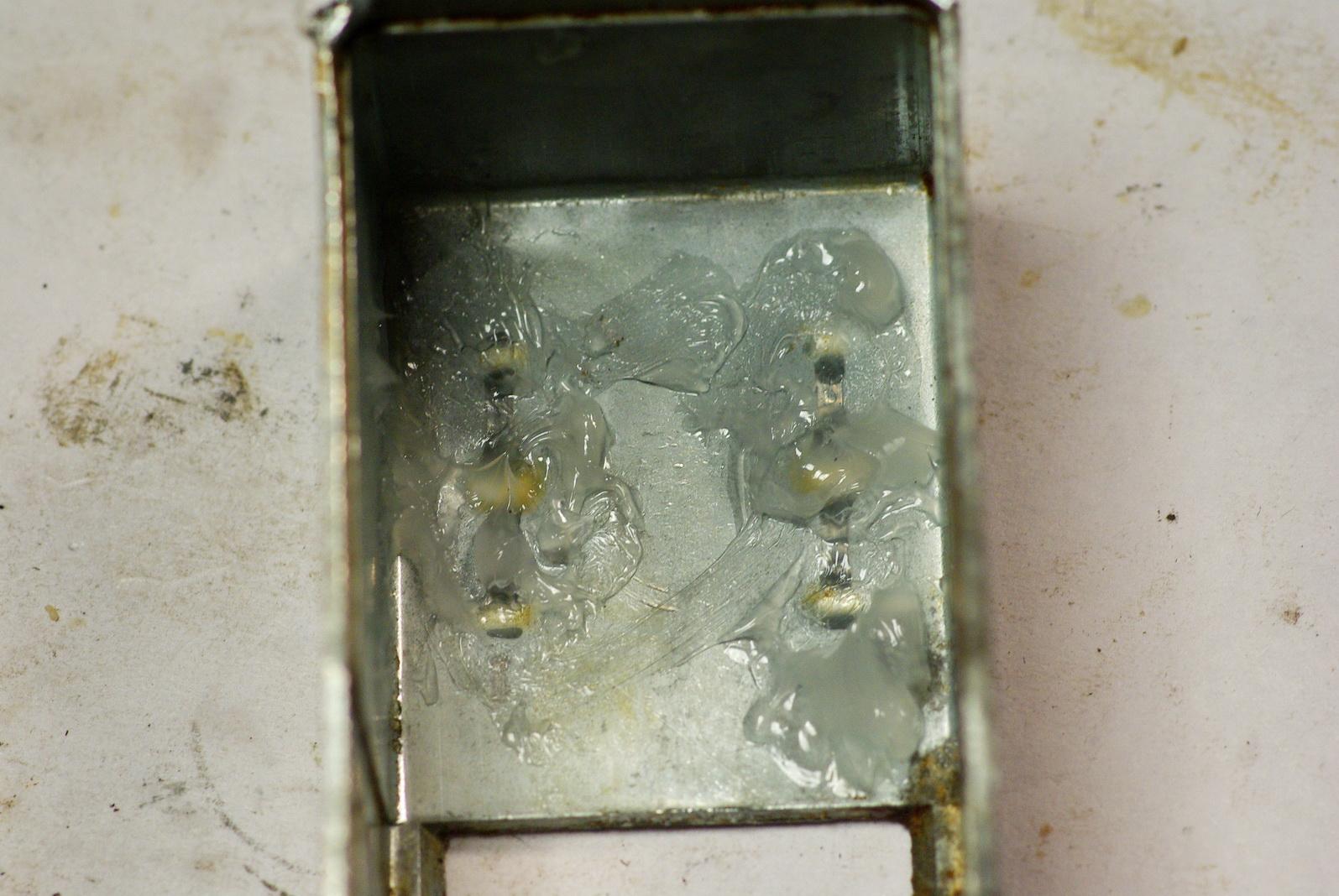

Here is the enclosure looking toward the back wall with the three detents visible after cleaning away all of the old crusty grease.
Same part with SuperLube applied and ready to assemble.
Apply lube at the three red arrows where the shaft pops in.
Install the detent ball springs.
Install the detent balls. Stick them in place with liberal amounts of superlube

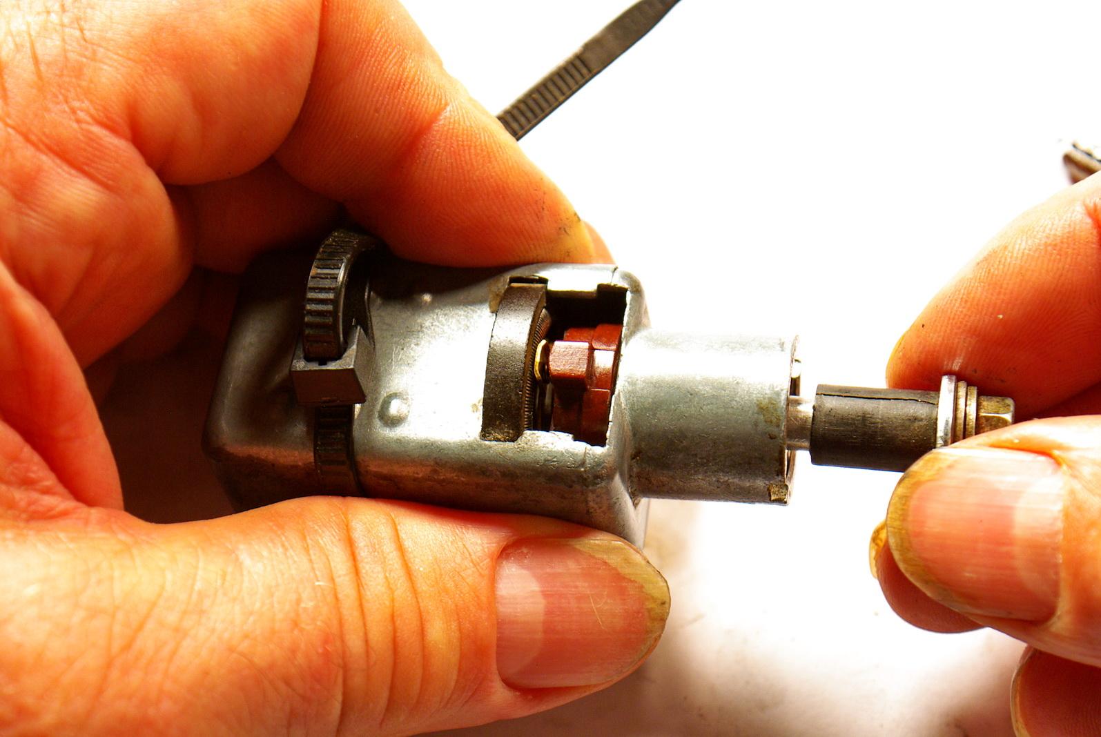

Holding the switch body at a tilt with the knob end upward so that the nylon detent sliding block does not tilt and dump the springs and plates out….slide the rheostat plate into the groove/channel in the body until the entire back plate seats.
Holding the back plate on tight…wrap it with a zip tie in the gap between terminals 57 and 58 and terminals X and 30 on the end away from the rheostat plate.

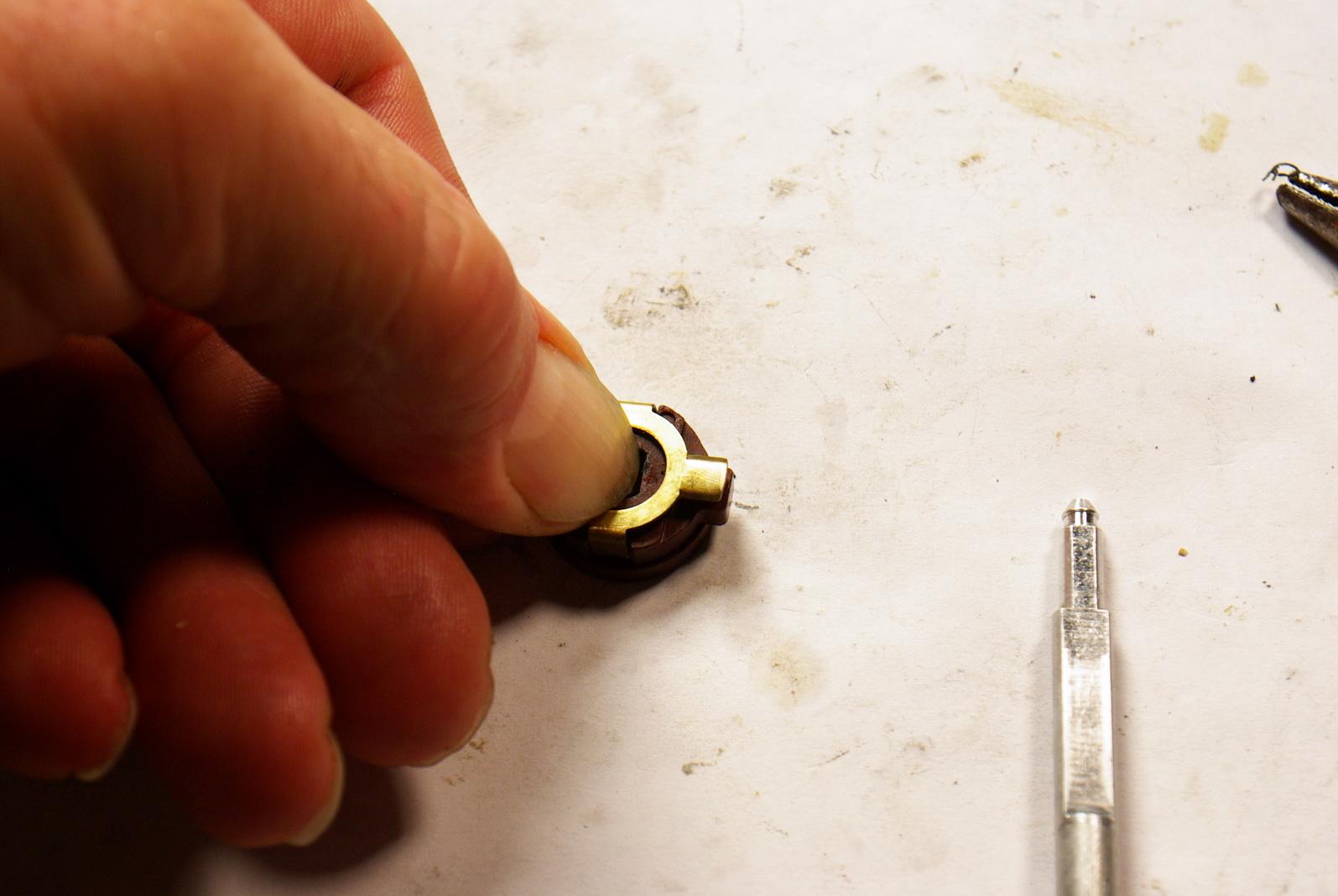

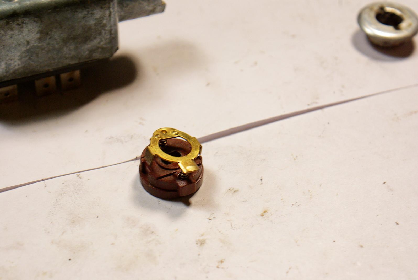

VERY IMPORTANT: Note the arrow in the picture. The bump or “nub” on the brass rheostat pickup plate MUST be dead centered in the spring or it WILL destroy the spring when you squeeze the parts together.
So from the last picture….flip the plate over like this….and align the nub in spring…and make sure the tab or flag on the brass contact plate matches up to the flag or tab on the Bakelite hub.
Keeping the brass contact plate flat and level as you press it down so that the springs do not pop sideways…press the assembly together. You will not that it has considerable spring pressure for such a small assembly.

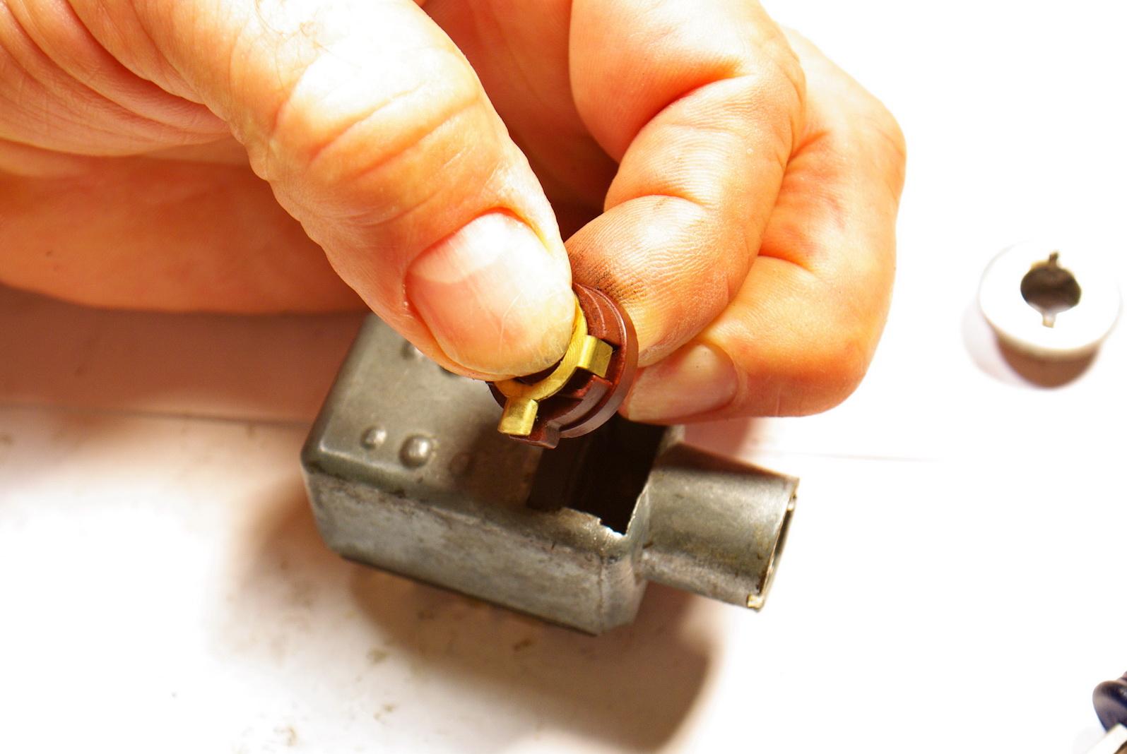

Holding the rheostat hub assembly together with the tab side out.
With the tab side outward on the rheostat hub…slide it into the opening in the switch body.
NOTE: My jury is still out on whether to put lubricant on the rheostat hub face. It works fine but usually you have to work it a bit to get full connectivity and get the lube where it needs to be and not block current. It definitely extends the life and cuts down wear.
Slide the rheostat hub in so its roughly centered.
Insert the shaft and align the notched section so it slips through the rheostat hub and goes all the way to the rear.
Push down hard and the barb on the inner shaft end will pop into the nylon detent slider.

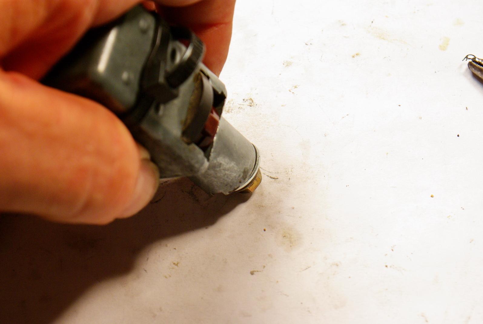

Re-crimping (if zip ties don’t work for you):
As you no doubt noted, when you de-crimped the corners, the metal cracked away. This is because it’s a casting.
So here is what you can do:
This is one corner of the switch back plate. Note the recesses where the original crimping was folded into.
In this picture you can see what we do. With a steady hand and a small diameter (1/2” or smaller) cut-off wheel on a Dremel tool, you want to reduce the thickness of the plate on these corners so the corner areas are down below the cracked area of the original crimps and into new metal area.
Then you can re-crimp with a flat faced punch. This is difficult to do. The switch should be held together while you do this with a zip tie and you need to devise a way to hold the switch that does not crush or damage it.
Once you crimp the corners in…remove the zip tie and make sure there is no play between the back plate and switch body. If there is, re-apply the zip tie and crimp some more. Then clean up the crimp with a file.
Personally I do not trust the crimp on a cast switch body so if I must crimp I add a dab of JB weld….which I also do not fully trust because Bakelite is hard to attach anything to permanently.
If you clean the Bakelite very well with acetone or MEK….and rough up the points to adhere (which you are) one of the thicker super glues (cyanoacrylate) can work very well.
IMPORTANT NOTE: I am fine with the zip-tie because it’s out of sight, fully functional and makes the switch easy to re-service later. BUT….use the black or colored polypropylene zip-ties…not the clear/yellow-beige nylon zip-ties.

If your switch version has an opening in the end opposite the knob like this, it means that the shaft is riveted in and cannot be as easily disassembled. I am working on this one.
What you want to do is pull the knob out to the “on” position and using a spray can of fast drying circuit board cleaner, spray liberally through this hole with the extension straw/tube.
Work the switch in and out and then also spray through and around the rheostat assembly. Work the switch in and out numerous times. The object is to flood the inside with circuit cleaner to dissolve all of the grease.
You can also use fast drying carburetor cleaner like Berryman’s B-12 Chemtool, but finish up with fast drying circuit cleaner and then blow dry. With compressed air while working the switch.
Then with the knob again in the on position, use a grease gun and needle, through the hole in the switch body to apply SuperLube directly into and across the area where the detent ball depressions are on the metal shell of the switch and also to the Bakelite backing board side.
Apply liberally. Work the switch back and forth a few times to spread the grease and get it on the detent balls.

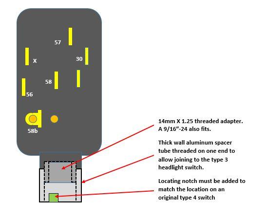

UPDATE:
Here is a little update so that you know the differences.
411 941 531 is the baseline part number for 411/412 headlight switches.
You can use the 311 941 531 type 3, beetle, ghia version of the switch..... as long as
1. It has the correct pin outs (not a problem. They exist)
2. It MUST have an adapter made...or there is a 100% risk of a short...that kills all systems including lights and emergency flashers and/or a high risk of a wiring fire.
This is the difference. Even though these switches are actually emergency flasher switches....the differences between type 1,2, 3 based switches and type 4 switches are the same for headlight switches.
The switch with the short snout is type 1 and 3. THE switch with the longer snout is type 4 SPECIFIC.
The problem is that the type 4 headlight switch fits into an asymmetrically shaped conical hole or "well" on the backside of the dash. Without the extended snout the wires WILL come come into contact with the dash metal almost instantly if a type 1 or 3 based switch is used.
It will short out typically almost as soon as you connect the battery.
The type 4 switch already has slight issues....because the hole or "well" behind the dash is asymmetrical in shape. Its closer on one side...and that side just happens to be on the side facing the fuse block where the wires are coming from.
So...if the bezel nut is not kept tight which is required to keep the switch snout in the proper position on the locating nub stamped into the dash...the switch can rotate...and even the type 4 specific switch can short out.
This has happened to me several times before I learned what the issue was. The last time it happened...I almost got killed. It wiped out all power while I was in a dark tunnel underpass.
Knowing what fuse blew (but not why yet) I was able to get a 25 amp fuse into the fuse holder and get the car started and pulled out of the underpass....just in time to get passed by a 10 wheel dumptruck ripping through the underpass at about 50 mph.
With no headlights or emergency flashers I would have been nailed and dead.
So do not experiment.
This is what you need to do to make an adapter for a type 1/type 3 switch to fit in a type 4. I will have this mod outlined soon.
Ray

PostPosted: Thu May 25, 2017 10:50 am    Post subject: Re: 411-412 headlight switch service and repair Reply with quote
Hi Ray,
I've got the bus version of this switch. 211941531. Unfortunately, my rheostat is long gone, but wanted to get in and clean this up. I don't have the nut on the shaft like the Porsche ones do.
I've given it some good pressure, but I don't want to break it. Any tips? I'm guessing it needs a decent amount of force, but I don't want to go breaking anything that isn't broken to prevent it from breaking in the future.
Thanks!

Post a couple of pictures please. Ray
surfbus23
Joined: July 21, 2016
Posts: 392
surfbus23 is offline
PostPosted: Thu May 25, 2017 3:03 pm    Post subject: Re: 411-412 headlight switch service and repair Reply with quote
It's taped up but looks exactly the same except it doesn't have the nut. Instead it has that little hole. The parts of the insides I've seen are identical as well to what you've shown.
raygreenwood
Joined: November 24, 2008
Posts: 23095
Location: Oklahoma City
raygreenwood is offline
PostPosted: Thu May 25, 2017 3:08 pm    Post subject: Re: 411-412 headlight switch service and repair Reply with quote
I need to see the ned opposite the knob. If it has a hole with a rivet.....it likely pops out. If there is no hole.....its likely threaded i . Ray
surfbus23

PostPosted: Fri Jun 02, 2017 4:21 pm    Post subject: Re: 411-412 headlight switch service and repair Reply with quote
Somehow I keep missing my email notifications about a response. There is no hole with rivet. A bit confused because earlier you said if it has a rivet then you probably can't service it, but now you are saying if it has the rivet it can. Which one can be serviced? With or without rivet?
How much force is required to "pop" out the shaft. I stuck a tiny screwdriver through the hole and gave it a pretty good forceful pulling, but no pop.
Thanks,
K
raygreenwood
Posts: 23095
PostPosted: Fri Jun 02, 2017 4:56 pm    Post subject: Re: 411-412 headlight switch service and repair Reply with quote
Thanks,
K
Ok...if it has no rivet.....the shaft pops out. It takes a LOT of force. Probably 15lbs.
If youook closely....you will see that ai installed a nut and washers on the shaft so I can mount the shaft...say between the loose jaws of a bolted down vise.....so ai can pull on the whole switch body. That will pop it out.
If you work with a lot of plastic items.....and you know anything about nylon and how tough it is.....thats what the slider is made of.
The barb on the end of the shaft is large and square edged. It takes a good amount kf force to pop it out and in. Ray
surfbus23
Posts: 392
PostPosted: Fri Jun 02, 2017 7:27 pm    Post subject: Re: 411-412 headlight switch service and repair Reply with quote
Got it. I didn't realize that you were adding the nut and washer. I saw that and thought it was the difference between the Porsche model and the bus model. It's not. They are identical, since I can see inside mine as it had already popped open in the rear.
Thanks for the great help!
