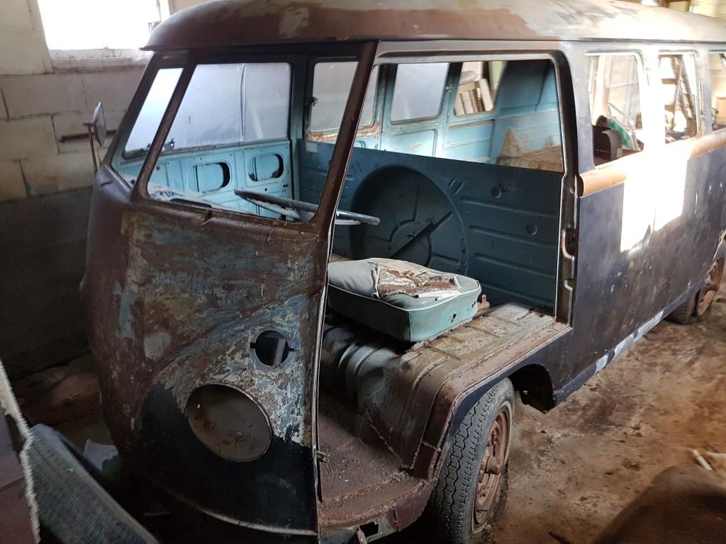

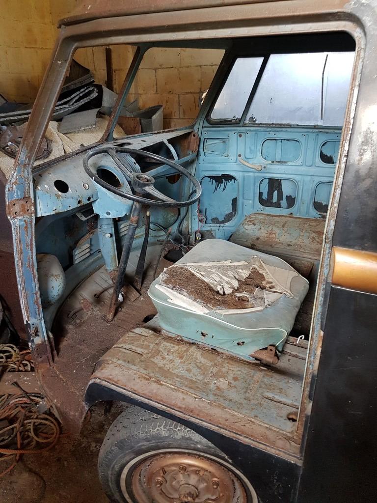

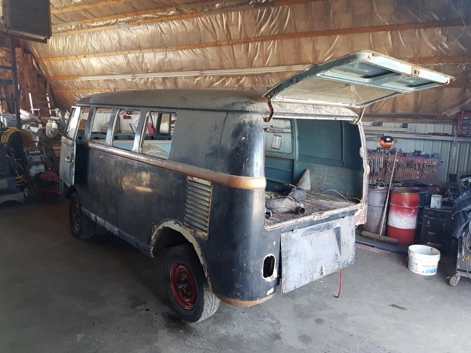

Found a 64 kombi 20 or maybe 25 years ago. Started to restore it and then priorities got in the way. A few times every year I look at it and wish I had the time... No sure I have the time now but I am doing it anyway Smile
Originally the goal was a full restoration but over the years I have realized all I want to do is drive it... and also preserve it. I want to drive it to work on nice days and weekends, take it to small shows/meets and do a little traveling and camping.
So the plan is to remove the rust and rebuild/replace the steel back to near factory condition. Rebuild drivetrain and suspension for the purpose of driving. Try to keep the bolt on parts original but not going to put much effort or money in things that can be changed latter.
Going to be a winter project so progress will be slow until October. Hope is to be driving it by June.

First thing is get it movable under its own power. I drove it there so...
Put some old car tires on the 14" rims. Turns out it came new with 14" rims and my rims are in excellent condition. Thought it took 15" rims. All the tires spin and the park brake actually works on both sides.

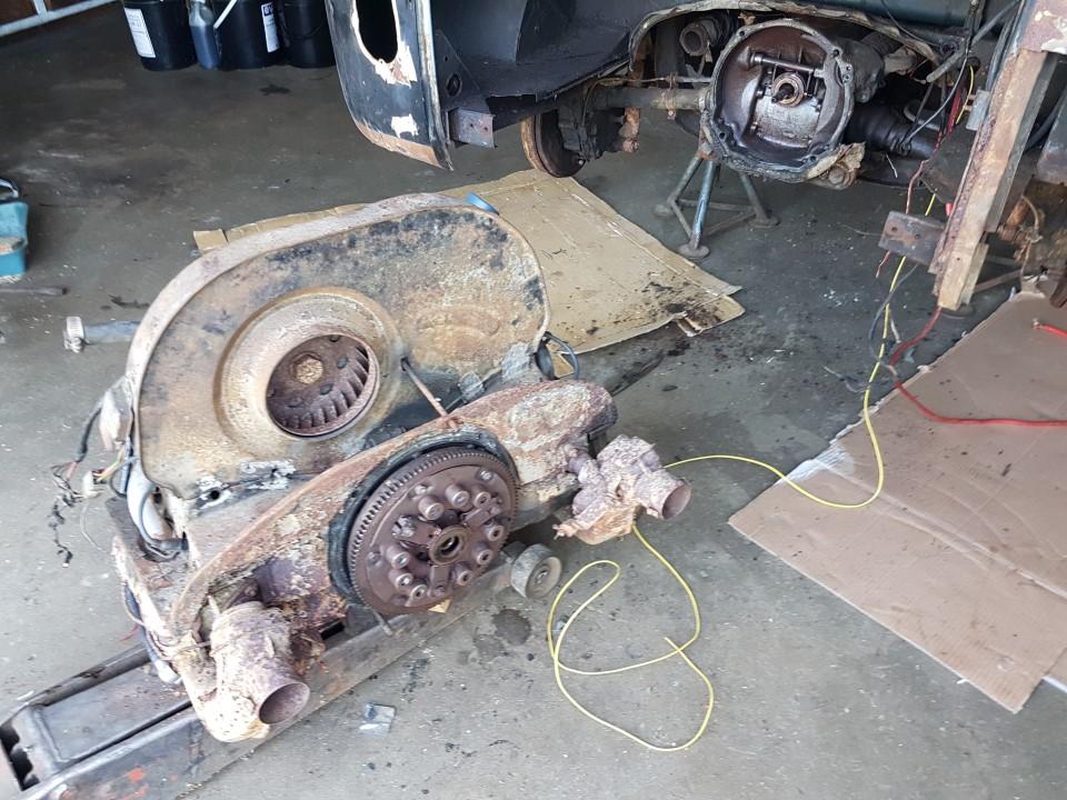

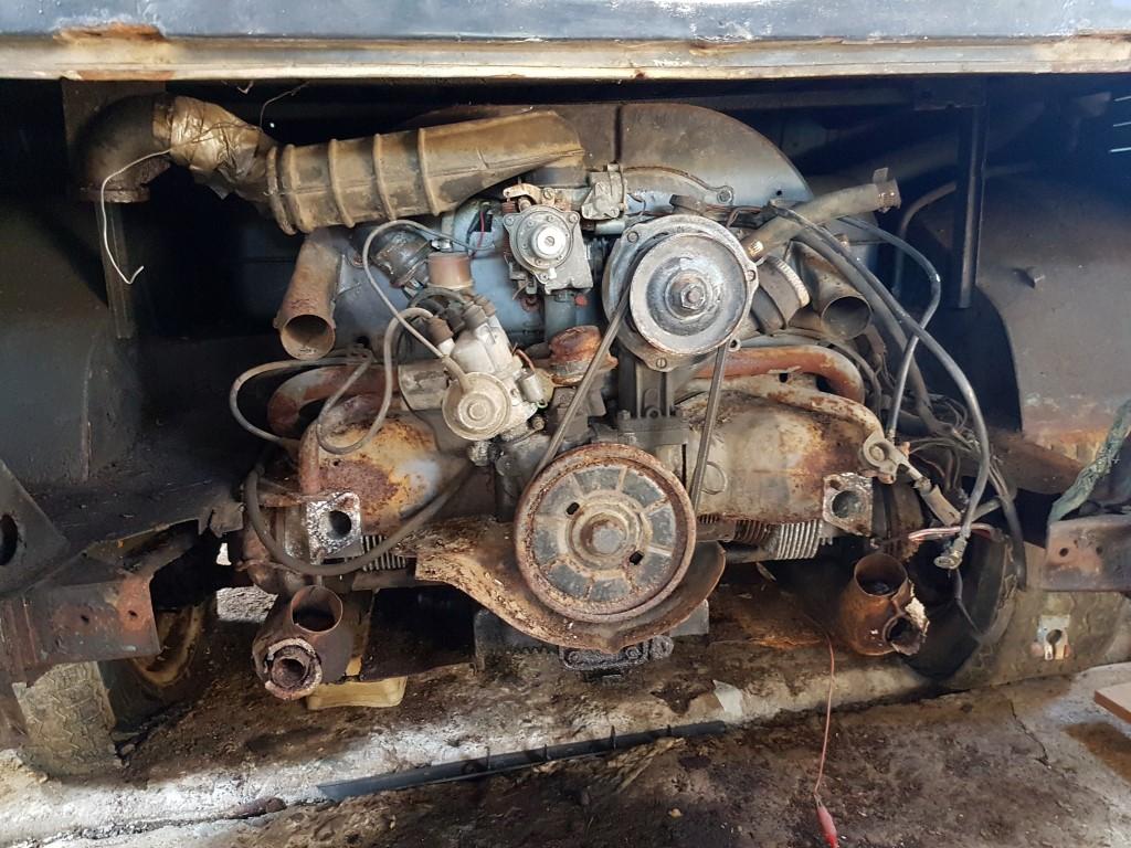

Engine... have no idea what shape it is in except it ran. It is a H5 and if it works I will use it. Will keep an eye out for an original though.
First I removed the carburetor and dumped out some rodents food store. Opened it and cleaned. Replaced the fuel lines and vacuum lines.
Pulled the sparkplugs, surprisingly came out easy. Will need to pick up new plugs and wires tomorrow.
Starter is a problem. Battery cable bolt is rotted and loose in the solenoid. I connected a cable directly to the starter motor. Connect the solenoid trigger and then the starter cable to battery and it turns over. Inconvenient but will allow it to be started anyway.
Pulled the drain plug and nothing came out. Oil level was good. Pulled the plate off and it had a little crud. Thinking that is bad. Haha

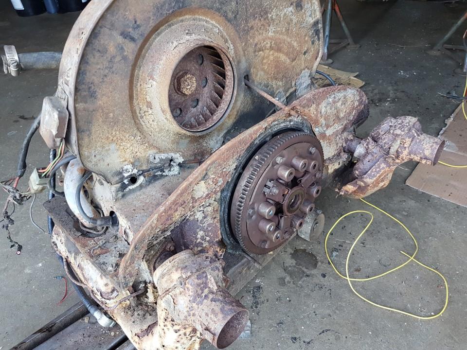

If you know that motor runs, I would remove it and take all the tins off and make sure there are no rat nests and crap covering the top of the heads and cylinders. Replace the oil cooler seals as well.

Agreed, and while your that deep into the engine re-torque the heads. I've squeezed lots of life from old single ports ( I actually prefer them for their cool operational temps). Nice project

Just trying to get it running good enough to move the it in and out off the shop. Over the winter I will remove the engine and pull the heads off to see what it needs for a rebuild. That is if the crank and block seem good.

I don't believe that sludge is a concern, I have had cars like that before and driven the engines with no issues after doing a few extra oil changes.

New coil, plugs and a borrowed distributor. Fuel line clogged at tank so did the hose in the gas can thing.
Runs. Actually quite well. Couldn't run it long as the gas was running out of the fuel pump and with all the sparks coming out the exhaust and such...
Going to see if I can find a fuel pump tomorrow. Would like to move it Saturday so no time to order one in.

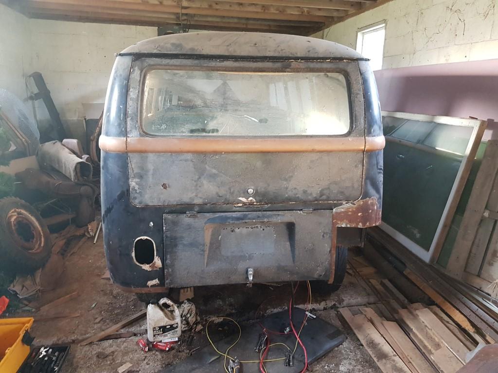

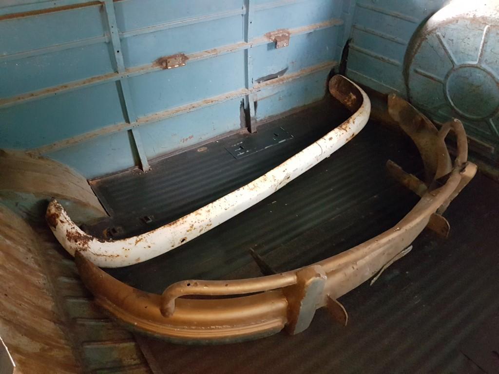

Bolted on some parts before I move it. Things are in better shape than I remembered. My bumpers are actually in decent shape. Was thinking they were junk.

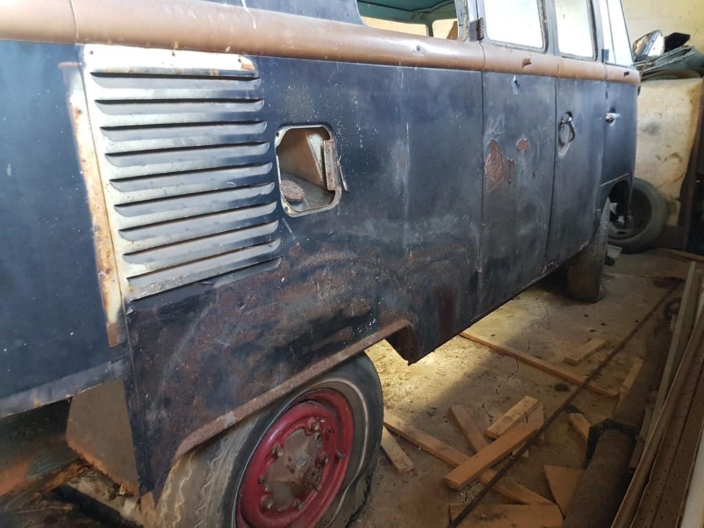

Last week I decided to restore this thing over the winter and needed it movable. Our local car show was a week away and though it would be fun to put it in. Everything came together. Hubs were all free, park break worked well, got a fuel pump and carburetor kit shipped in...
Loaded it on a dolly and yesterday morning towed it 20km into town. Unloaded it on a back street. Drove it down to show and up main street and parked. That was so much fun. Lots of odd looks and lots of smiles as I went by. Think the car I was fallowing was a bit worried though. Smile
Great show, over 500 nice cars. Loads of people. Was the only split there. Two bay window campers and maybe 6 bugs all in great shape.
The old bus got a lot of attention. Everyone seemed glad it was there. And I got the Mayors choice award! Haha. Yarmouth has a great Mayor and she loved the bus.
Best comment of the day... guy after touching the bus "Hey that's real dirt!"
After the awards I started it up and drove it back to the truck. Hit second gear on a side street. Smile What a fun day.

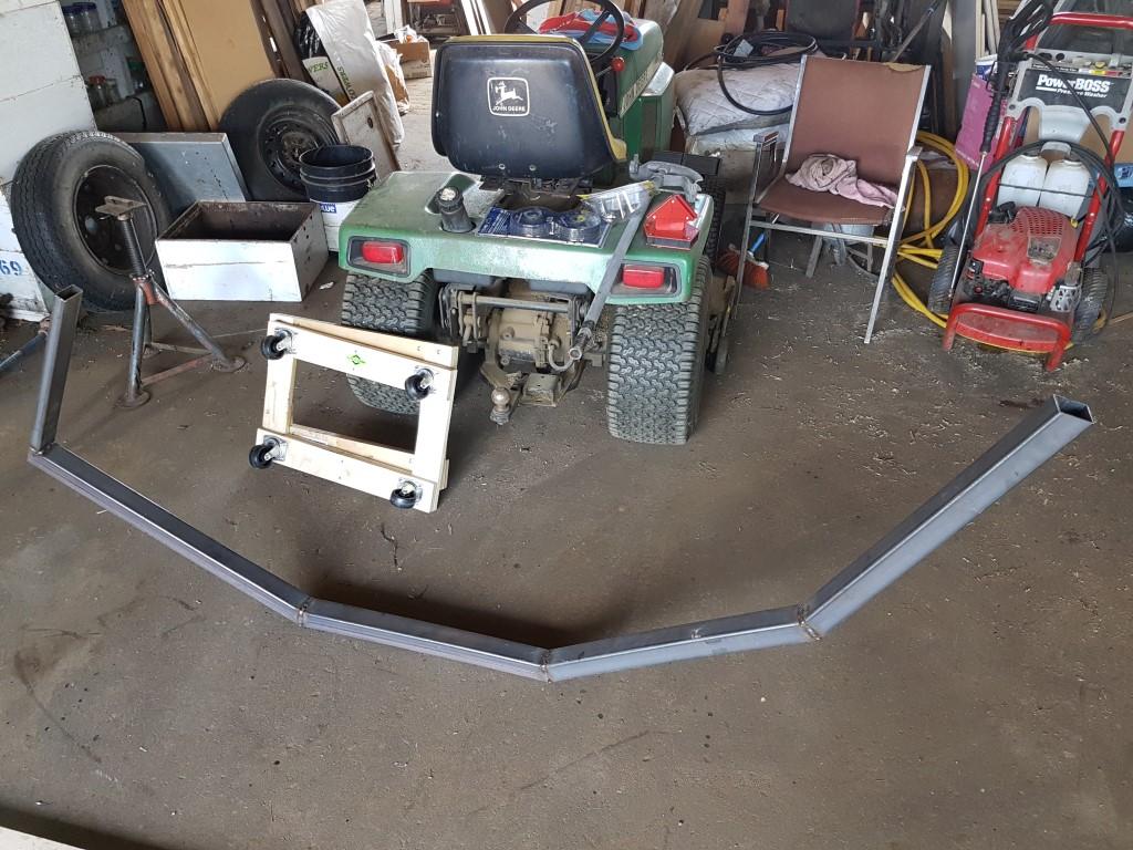

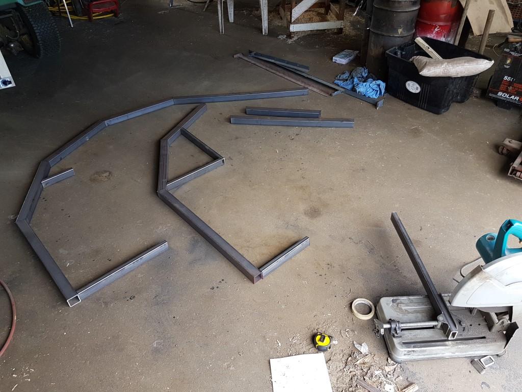

Some parts on the way. Will make a metal order soon. Getting any needed tool and supplies. Decided to media blast everything... except maybe large flat areas. Not sure how prone these are to warping.
Today I assembled some of the rotisserie. It is 1/3 of a 12 sided design that I can switch side to side. Will fit it to bus before I finish it.

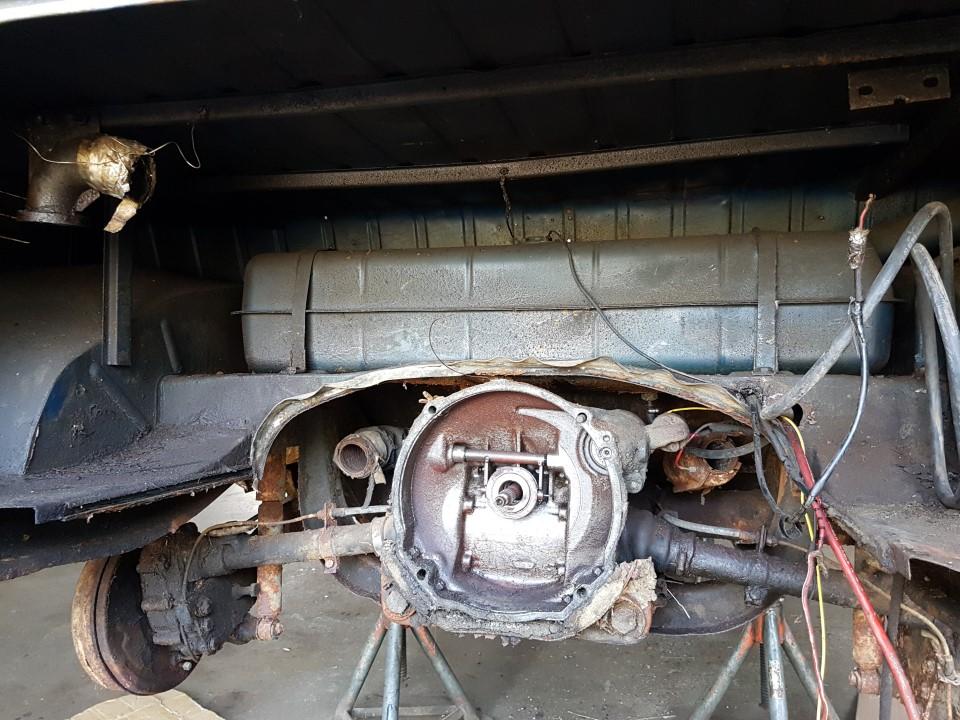

PostPosted: Sat Sep 17, 2016 1:15 pm    Post subject: Re: 64 Kombi partial restore Reply with quote

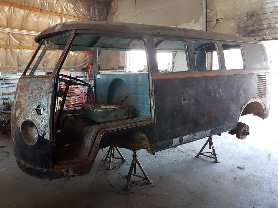

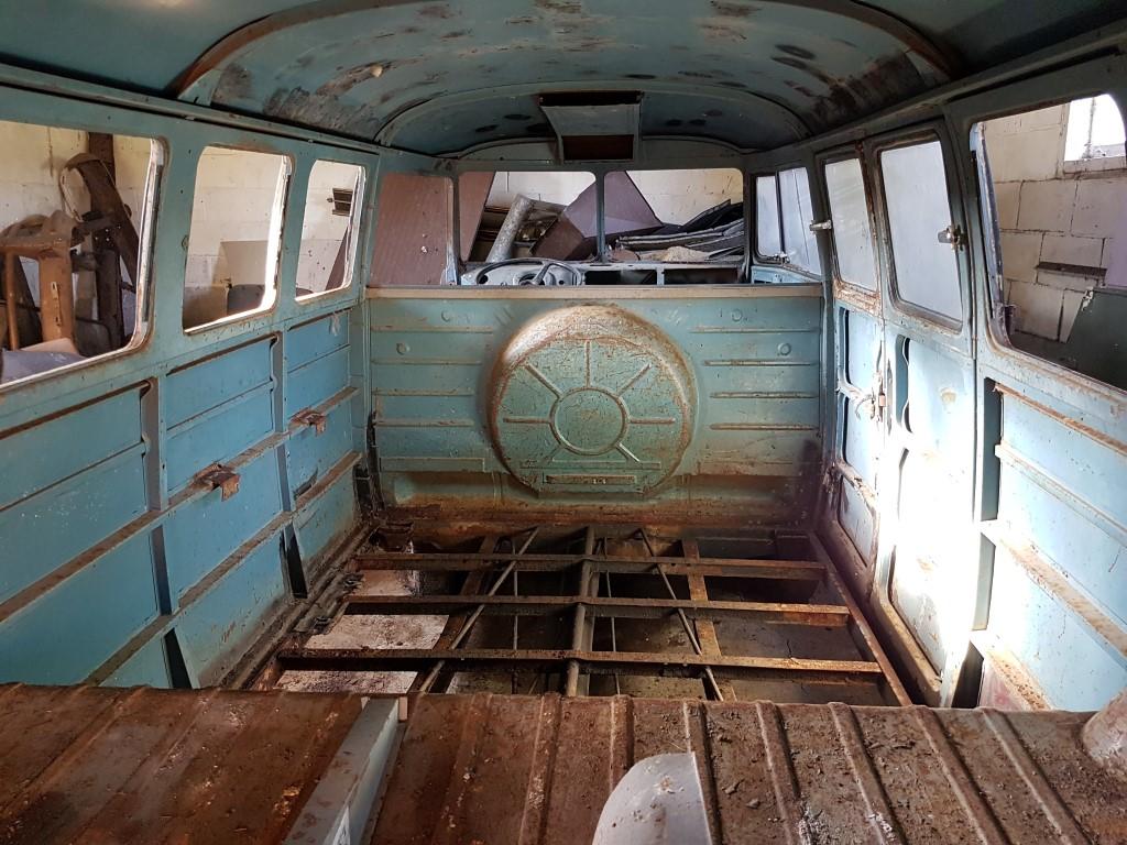

And since it is in the shop I might as well put it on jack stands... and if it's on jack stands I might as well pull the motor. Engine bay and gas tank look great.
Tins will need replacing and the thermostat has been removed. Will pull the heads and see what it needs. That's a project for when I get tired of body work

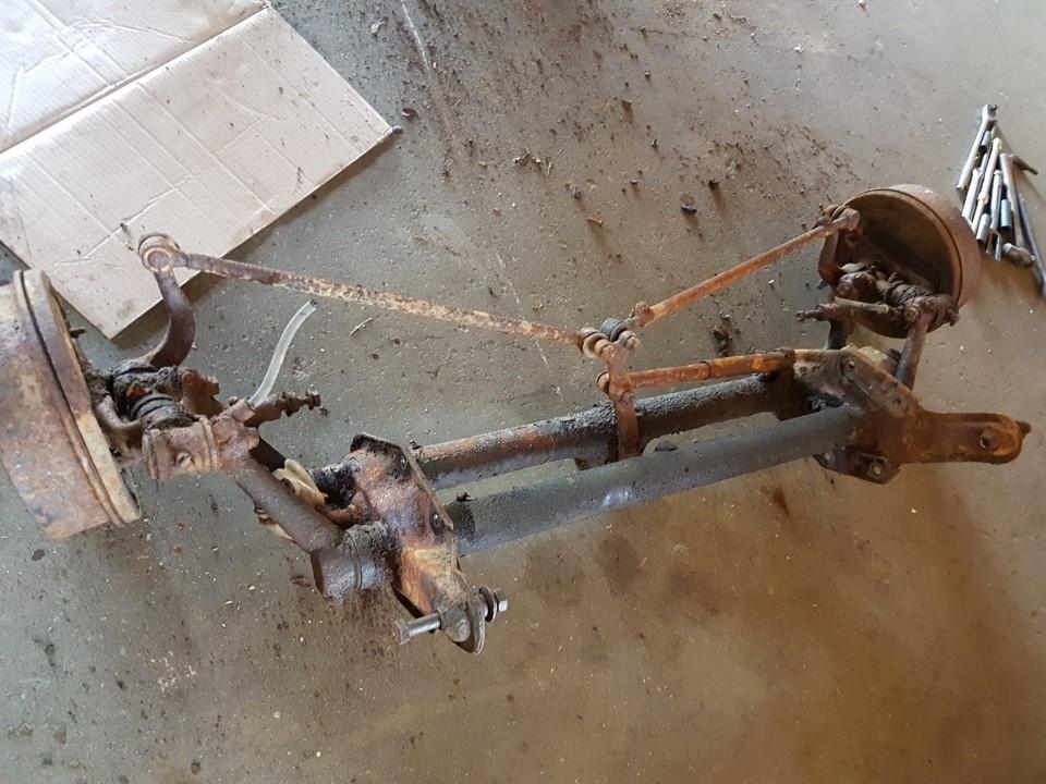

PostPosted: Sat Sep 17, 2016 1:22 pm    Post subject: Re: 64 Kombi partial restore Reply with quote

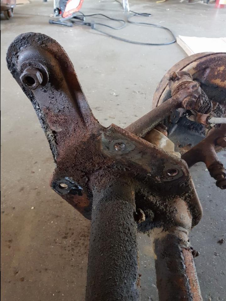

Dropping the front beam seamed like an easy job so that's out also. Can't believe how easy it comes apart. Even the shifting linkage slid out with a few taps.
Front beam looks good. everything is quite greasy so little rust. Seems tight except the center pin. will do a full rebuild on it through the winter.

PostPosted: Sat Sep 17, 2016 4:28 pm    Post subject: Re: 64 Kombi partial restore Reply with quote
Some spare time after supper so out with the transmission. Had to use the 3' bar to get the big bolts out. Will rebuild the reductions and trans over winter.
