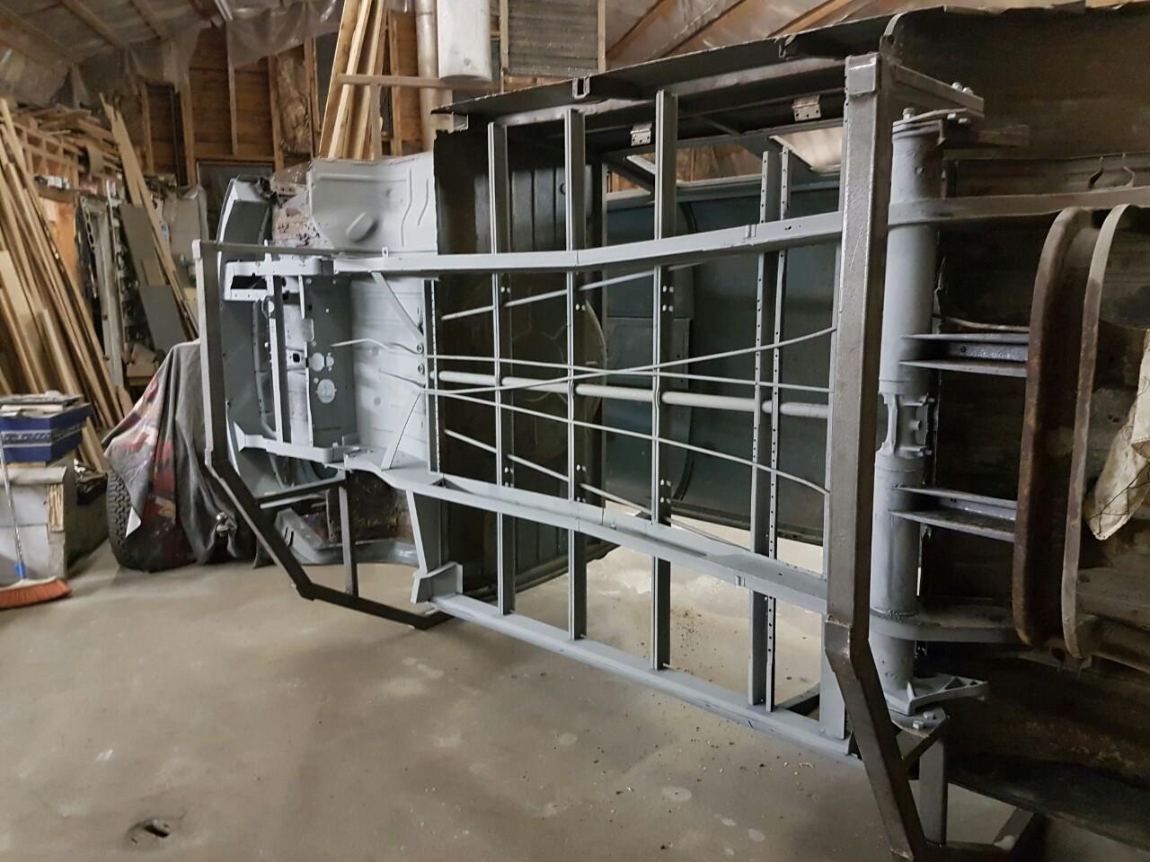

PostPosted: Wed Nov 30, 2016 8:19 pm    Post subject: Re: 64 Kombi partial restore Reply with quote
Picked up some parts for the blaster. The tips and block wear out. Got a spare valve also. They are cheep.

PostPosted: Wed Nov 30, 2016 8:30 pm    Post subject: Re: 64 Kombi partial restore Reply with quote
The glass grit works very good the second time around. Still not much dust in the air.
Rolled it on its feet to get some sand out of it. Probably 50 lb ran out.

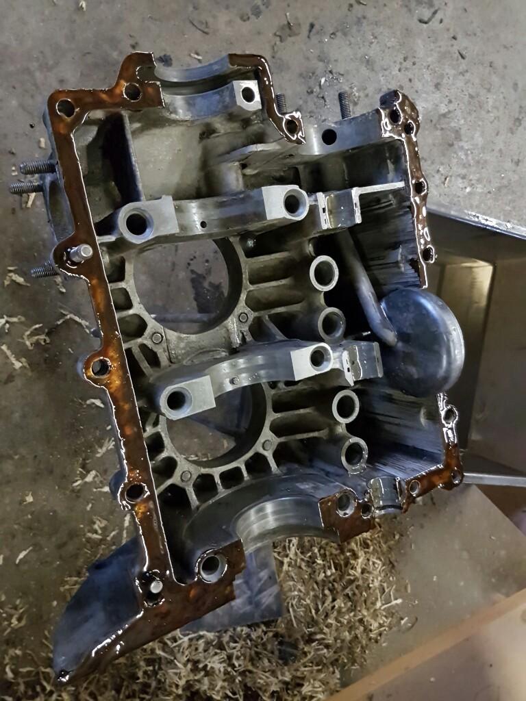

PostPosted: Sun Dec 04, 2016 2:55 pm    Post subject: Re: 64 Kombi partial restore Reply with quote

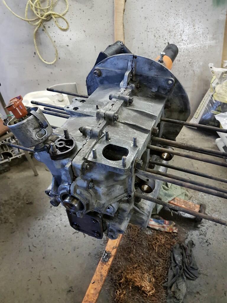

Decided to split the block. Glad I did. It was a mess inside. Everything seams in great shape though. Quite happy with it and now I don't have to worry about its condition.
My 64 Kombi restoration

Joey
Joined: August 12, 2005
Posts: 5375
Location: Nova Scotia - Canada
Joey is offline
PostPosted: Sun Dec 04, 2016 4:39 pm    Post subject: Re: 64 Kombi partial restore Reply with quote
If I split the case I replace the main, cam rod bearings unless they are in perfect condition... and I've never ran into that scenario yet. Nice clean engine rebuilding environment you have there... Razz
Nice work so far. You may want to consider removing the word "partial" from your thread title though with all the work you're doing.

PostPosted: Sun Dec 04, 2016 5:35 pm    Post subject: Re: 64 Kombi partial restore Reply with quote
They seem very good. I think this is a low mileage engine. I only plan to run it one summer like that to get a feel for the bus and what I want. Thinking of building something like 76mm stroke x 88 pistons, single port and keep the original look. Then getting a taller 4th for highway driving. Its getting a camper conversion and we want to do some long distance trips so more torque and lower RPMs would be good.
That crap on the floor is wood shavings for soaking up all the sludge that ran out Smile
And yea, I think this is developing into a full restore...

PostPosted: Tue Dec 27, 2016 3:33 pm    Post subject: Re: 64 Kombi partial restore Reply with quote
Had a few hours today so did some blasting that needed done so I can start the metal work. Lower B pillar, clutch tube and bottom of side ribs. Since I had a mess anyway I blasted a rear wheel well also.

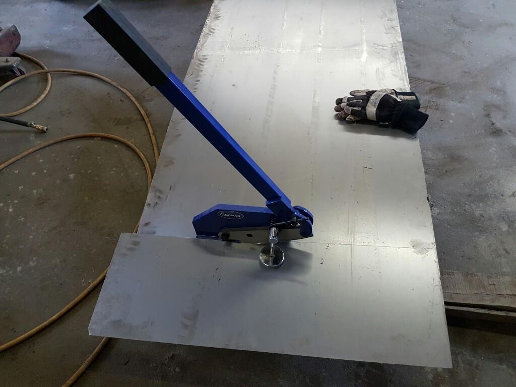

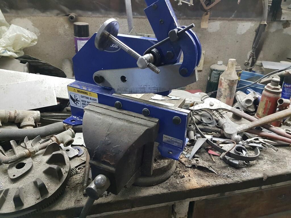

PostPosted: Wed Dec 28, 2016 2:53 pm    Post subject: Re: 64 Kombi partial restore Reply with quote
Picked up a small shear. Screwed it to a 2x6 so I could cut some pieces off the large sheet. It is a little difficult to cut a large piece without deforming the edge. Shear works well clamped in the vice for small parts.

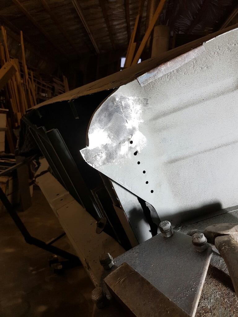

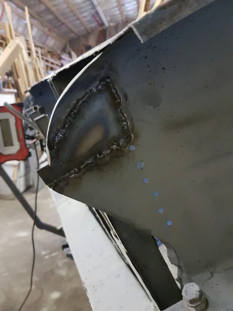

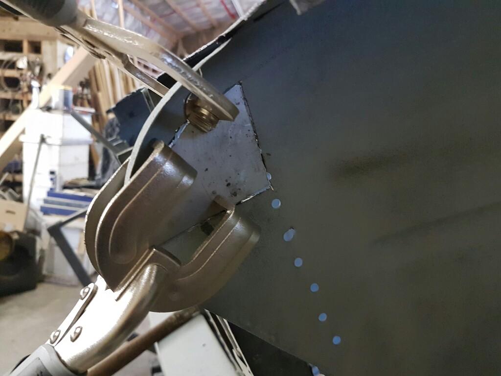

Had some time today so patched a hole. Didn't come out as well as I hoped. Next one will be better. Tomorrow I hope to start adding some parts.
My camper interior build
My 54 standard restoration
The Nova Scotian Barndoor (YouTube)
The Nova Scotian Barndoor (CAD drawings)

PostPosted: Wed Dec 28, 2016 4:11 pm    Post subject: Re: 64 Kombi partial restore Reply with quote
Looks pretty good to me.

PostPosted: Thu Dec 29, 2016 8:58 am    Post subject: Re: 64 Kombi partial restore Reply with quote
Agree... looks good.
What I recently started to do is not wait till it's all welded before grinding it all down. I tack the piece in place with several tack just the way you did then grind those tack welds down flat. Weld more tack welds then grind them down. Repeat till there's no more holes. It takes a little longer but the process creates less heat (less warping) and it's easier to grind down several small welds rather than one large weld. I use those flap discs so it makes them last longer as well.
