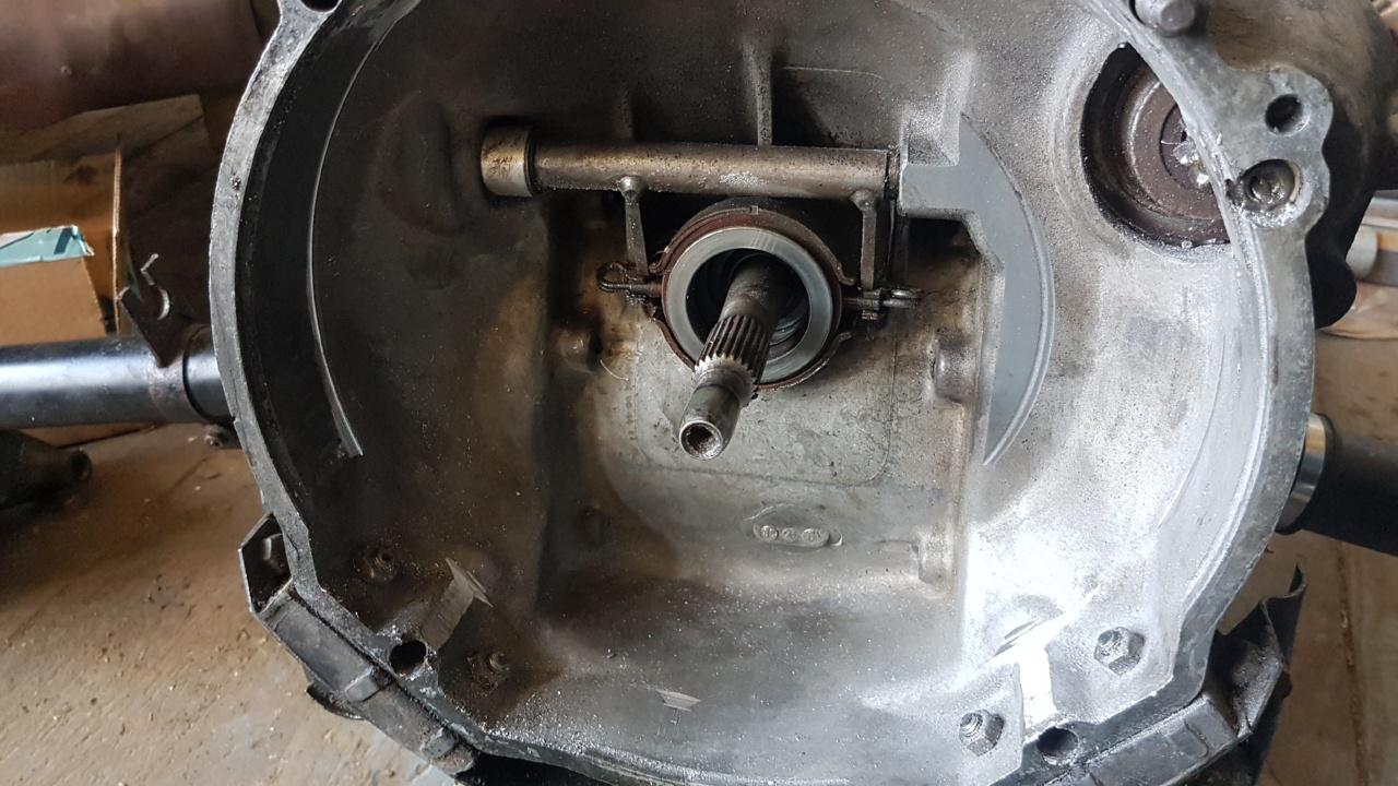

Transmission together and ready to go in. Took a bit to get the forks just right.
I had the trans on an engine stand and was thinking it would be a lot easier to install the stack if it was on its end. Was about to remove the trans from stand when it occurred to me that I could just tip it back. Smile Worked perfect.
Tomorrow I will get everything in and try it out. I'm quite confident that it will be good this time.

Transmission back in and it works perfectly. Very happy. Smile

On the pinion side what attaches yours. The ring and pinion backlash remained set from before?

BarryL wrote:
Wow.
4 bolt pinion. I didn't change 1-2 gears or pinion bearing as they were good. So no change to the pinion. If I needed to change the pinion bearing I think it would need adjustment.

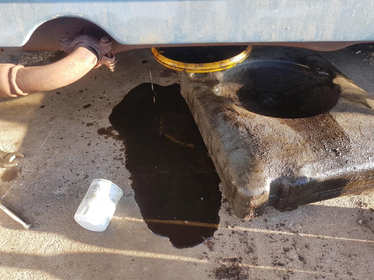

Changed oil. Discovered I need to remove the filter and let that drain first. Haha. Cut the filter open and no shiny bits. Smile

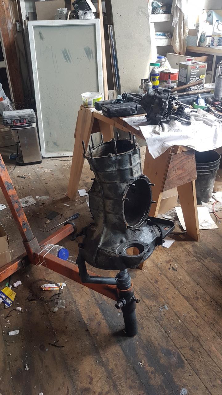

Dug into the old engine today. Going to rebuild for a spare.
Block and crank haven't been cut and look good. Just need to find someone to line bore, thrust cut and grind the crank.
Lifters are warn out but cam looks usable. Rods usable alao. Rings had a surprising amount of ware for 7000 miles and one was broken. The pistons were not great when rings were put on so maybe that had something to do with it. Will get a new cylinder set anyway.
Number 2 head doesn't look well. Haha. 1000 miles without an exhaust valve didn't help. I will clean it and see if the nick in the seat can be ground out. It was very small so maybe. I might get setup to replace guides and grind seats. Expensive to do correctly but would be nice to have the ability.
The plan is to build as a 1600 sp and have it fully assembled for quick swap if needed.

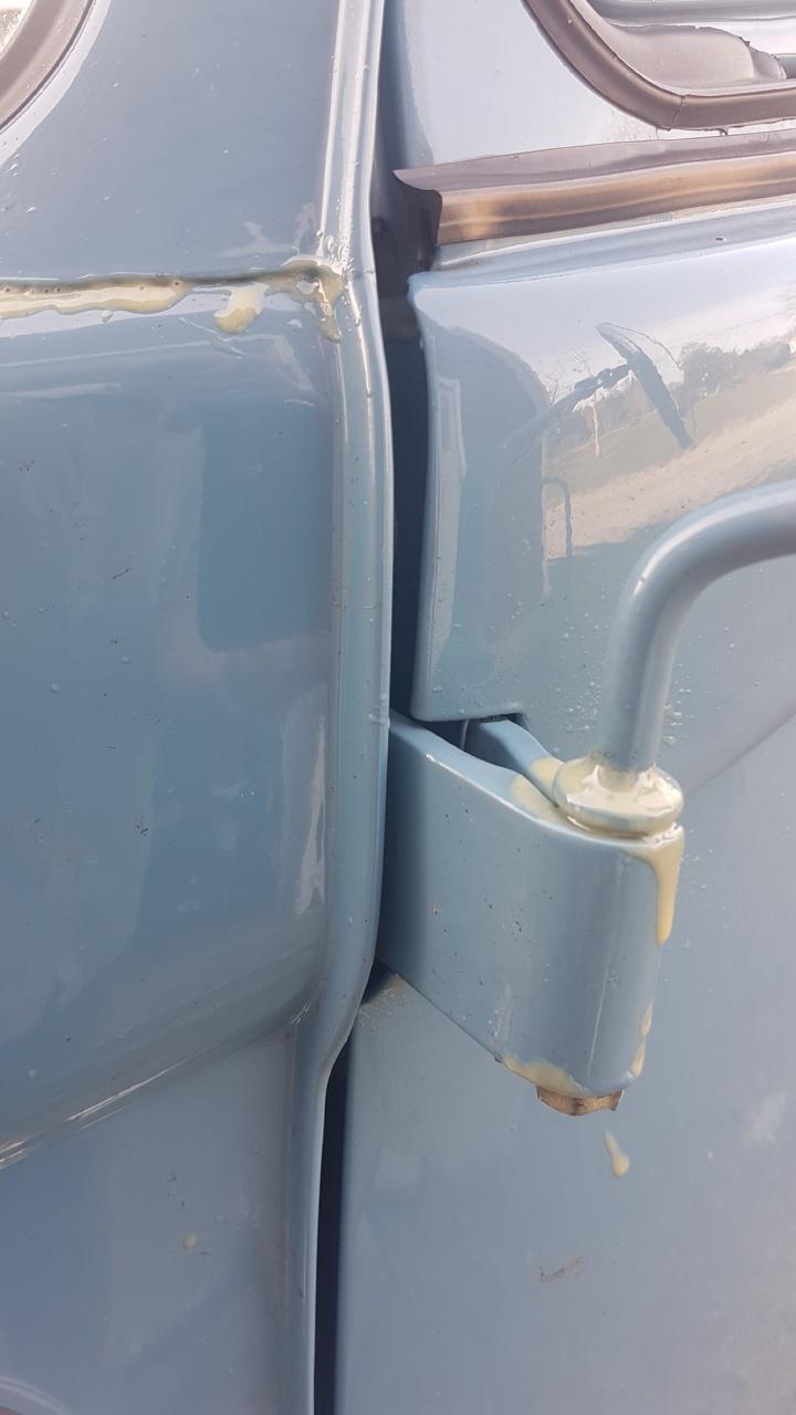

Another season gone. The roads got salted this week.
Normally I would spray Rust Check around the potential rust areas but I had a can of Fluid Film within reach. Around the bottom is still seeping rust check so no need for more.
Parked for most of the winter. I will bring it up to the shop to do some work on it in early spring. We want a very early start next year.
