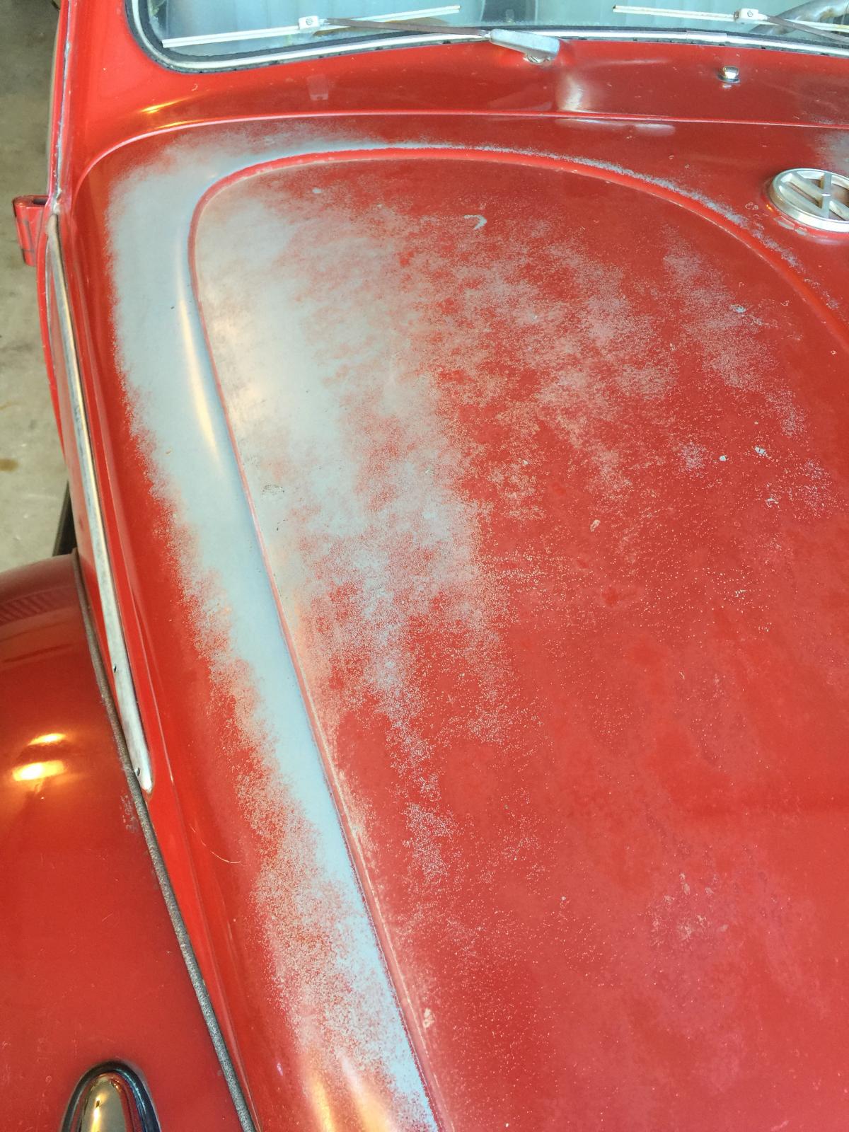

The day after I got it home, I rolled it outside for a bath and some shots.
Dig that fade
The seat covers had been replaced with TMI covers and the padding under them was dead. The carpet was TMI also. Headliner was original.
Dash is uncut and original with a VDM steering wheel added.
The OG paint has a great shine to it still!

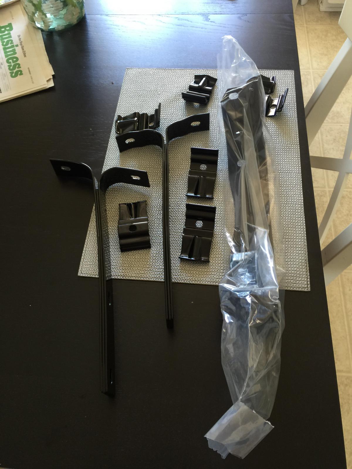

So the plan was made and the day finally came to build Ruby.
My buddy had just purchased this 58 and it was staying with me for a few months so Ruby left storage and came to my house while the 58 took her spot in storage.
The last shot before she went into the garage.
Seats came out, Carpet came out, floor mats out. Also the restored OG steering wheel went in after the VDM wheel was sold. Much better.
So far no surprises, just rock solid metal all over.
I was really surprised to see that under the rear seat was not thin or rusty at all. The factory tar board had kept all the metal nice and the undercoating under the pan had done its job to keep the metal solid. Easily the nicest pan I have had, but then again, this car is much newer than most of the VWs I have had in the past.
I decided to try chipping off the tar board but that was nothing but a giant mess.
The drivers side took me almost an hour so I decided to stop on that project until the body was off. Oh yeh, the body is coming off this one Smile

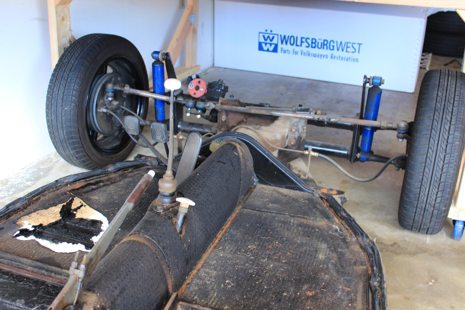

All the pan bolts came out with no drama. No broken bolts and no rust to deal with. A few friends later and the body was on the dolly.
The pan is super nice and straight. Not a spot of rust and no damage. This is going to be an easy straight forward clean up.
With the dolly I am able to get the pan under the car and store it all in one parking spot and still access the body or pan easily. Pretty happy with how that came out.

Pedal cluster came out next. Pretty nasty under there with grease and old horse hair, but no rust or rot. No damage either.

Since that was out of the way, I got the suspension off the car. Beam off and motor and trans out. No issues here either, everything came right off. Beauty of working on a totally rust free car!
Someone did some grinding to fit that 12 volt flywheel and did a pretty amateur job. Thats going to be fixed though
And now we have a pan
