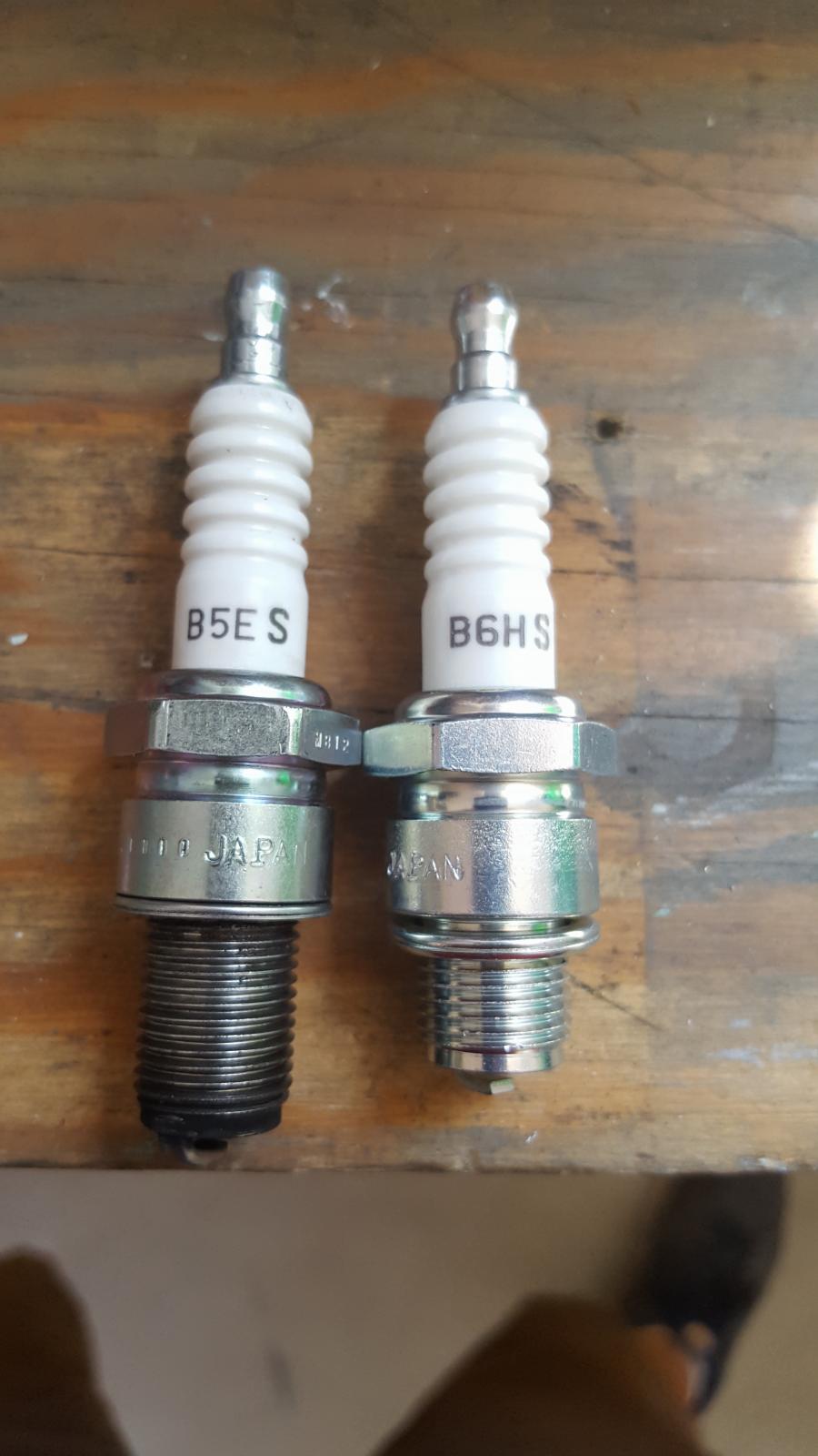

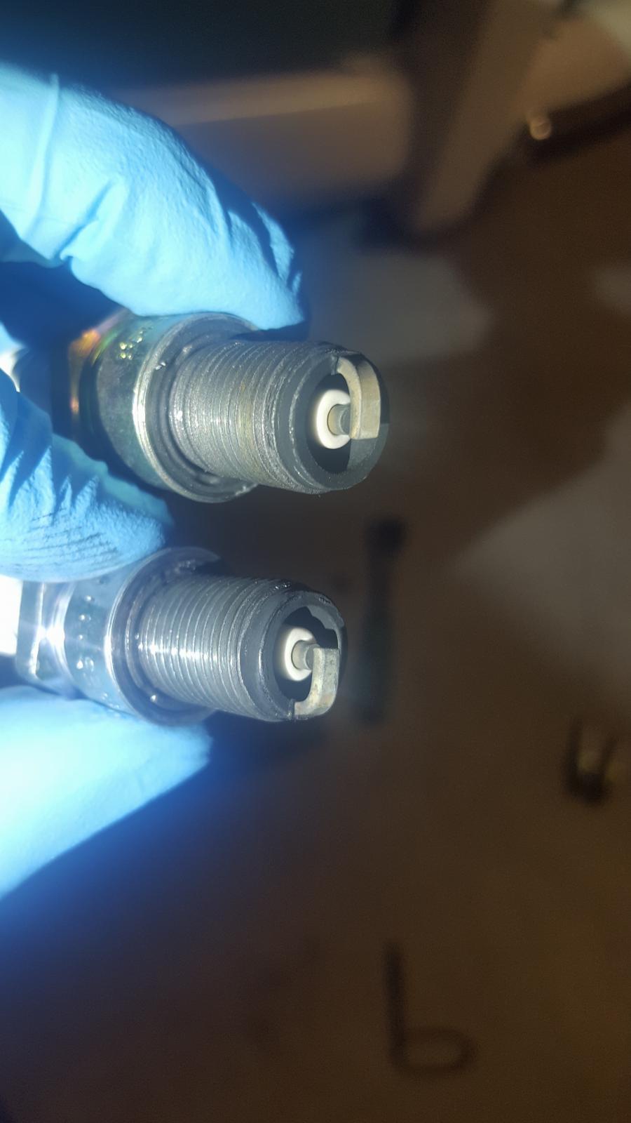

What do you guys think of this burn on the plugs? 2017 on dual webers.
Two richer ones are from right side, two leaner ones are on left side. Thinking right side should be leaned out a bit.
Getting pops under acceleration after about 20 min of continuous drive.

Posted: Sun Jul 17, 2016 10:10 pm Post subject: Re: Spark Plugs burning ok? |
Slightly warm. Id try a Colder plug. _________________ 2276 IDA's 86C 11-1 DD

Jfats why do you think a colder plug? NGK B5ES are in there now.
Black carbon around base of plug look good? |

Posted: Mon Jul 18, 2016 9:53 am Post subject: Re: Spark Plugs burning ok? |
I agree, try a NGK "6". _________________ It's just advice, do whatever you want with it!

Posted: Mon Jul 18, 2016 9:55 am Post subject: Re: Spark Plugs burning ok? |
The prong strap itself shows how hot (or cold) your plug is by the heat transfer mark on the strap. From the firing end to abouts halfway is considered with in heat range. Too close to the tip is cold, too warm is close to the strap base.
I used to have a saved page on my phone with sites on reading plugs and t -mobile did some upgrade and I can't find it now. _________________ 2276 IDA's 86C 11-1 DD

Posted: Mon Jul 18, 2016 11:50 am Post subject: Re: Spark Plugs burning ok? |
do plugs first.
Trying to read plugs with unleaded fuel is mostly a waste of time. Plugs don't color well with unleaded. _________________ It's just advice, do whatever you want with it!

The owner of my local Napa suggested the B6HS as the old plug seem to be sticking several threads into the cylinder. Thoughts?
| Back to top |

The old plugs is what came in the motor from Chico Performance. They seem to clear the piston, but you can see several of the threads appearing to be sticking out into the head with the darker build up.
I can either go back to the same long ones one step colder or use these shorter ones. |

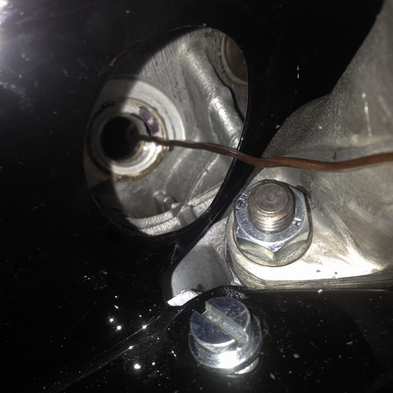

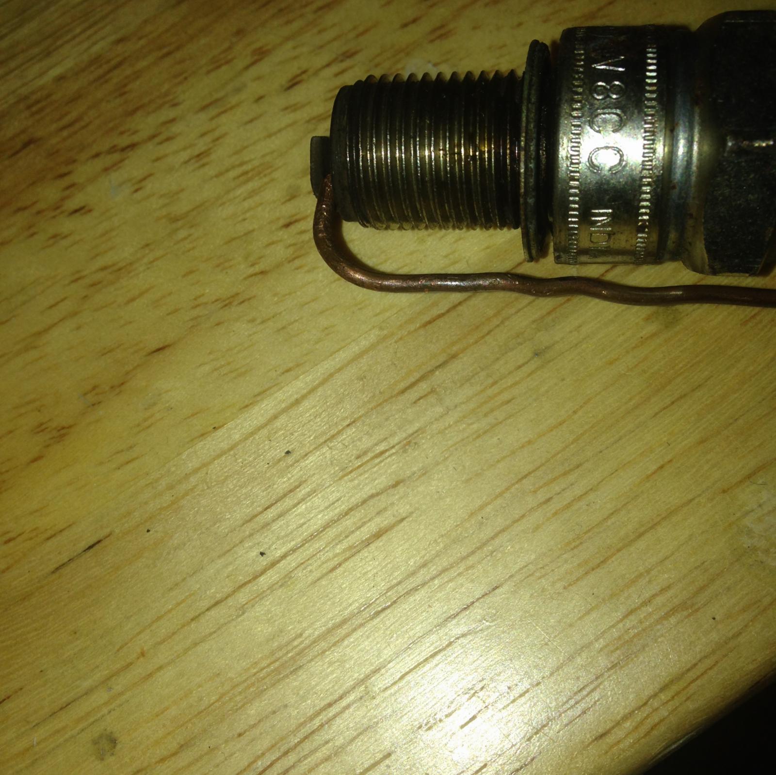

teamasr Samba Member
Joined: August 04, 2009 Posts: 159 Location: SF Bay Area
Posted: Mon Jul 18, 2016 6:21 pm Post subject: Re: Spark Plugs burning ok? |
| [email protected] wrote: |
make sure the plugs match the heads.
Also, do not under ANY circumstances, use never-seize. I see some on your plug threads, that is not good in my experience. |
How can I check if they match the head? I am looking at the old plug and see that at least 3 of the threads have black carbon on them, so assuming they are protruding out. If installed put those plugs in, should I assume they are right, or go shorter? |

fes Samba Member
Joined: January 26, 2011 Posts: 999 Location: Prince Edward Island
Posted: Mon Jul 18, 2016 6:57 pm Post subject: Re: Spark Plugs burning ok? |
I think the easiest way to see if your heads are for long reach plugs is to take a piece of wire and bend it like a hook, mark with a marker at the top of the plug hole and compare it with the plug itself.
