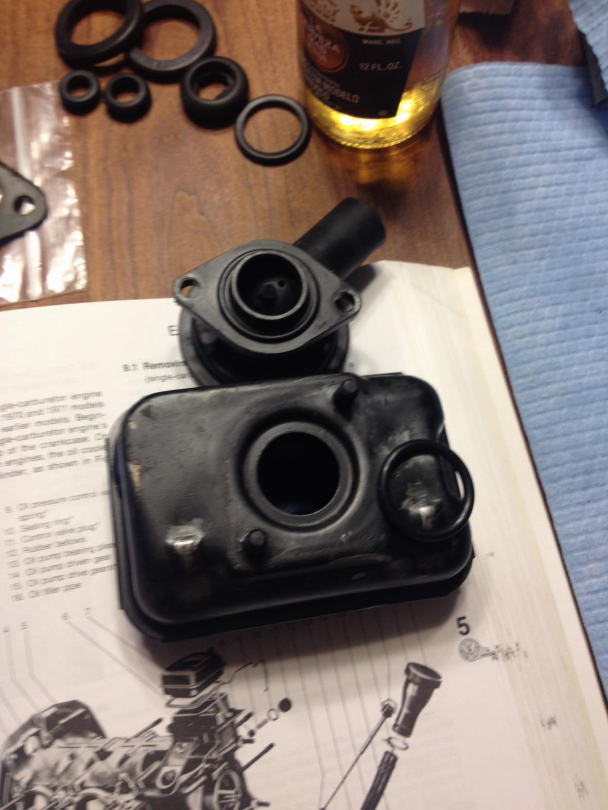

VIQ is a '78. I have the new o-ring and the large square cork gasket, but should there also be a football shaped gasket that surrounds the hole and threaded studs, sandwiched between the two parts shown? Thanks all!!!

Nope, just the O ring is sufficient.
