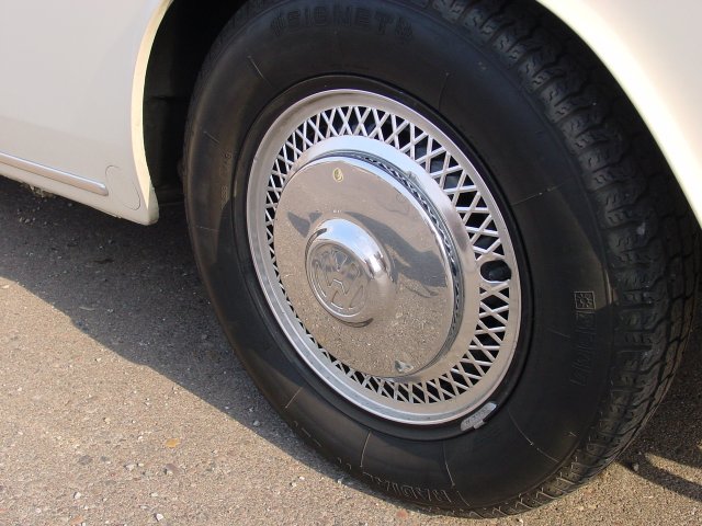

66-67 are 66-67 only so if you want the "correct" ones, look for these caps with the larger raised center section:

Is the diameter of the raised section what is bigger or is it the height of the raised section? What about the back of the cap, is there anything that tells me they are for a type 3 vs. type 1?

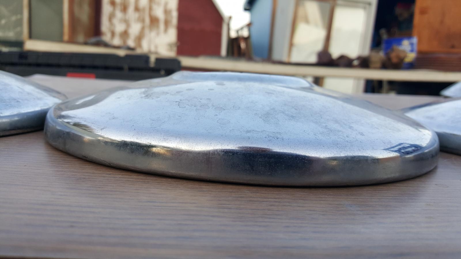

The height of the raised section is the main indicator.
These caps are Type 3 only.
I dug up some photos from some I sold years ago to show the profile better.
Here they are:

The earlier Type 3 and 66-67 Beetle hubcaps have an edge that looks like this as they clip into the INSIDE of the wheel center:
66-67 Type 3s clip to the OUTSIDE of the wheel center so they don't have a double lip like that.
