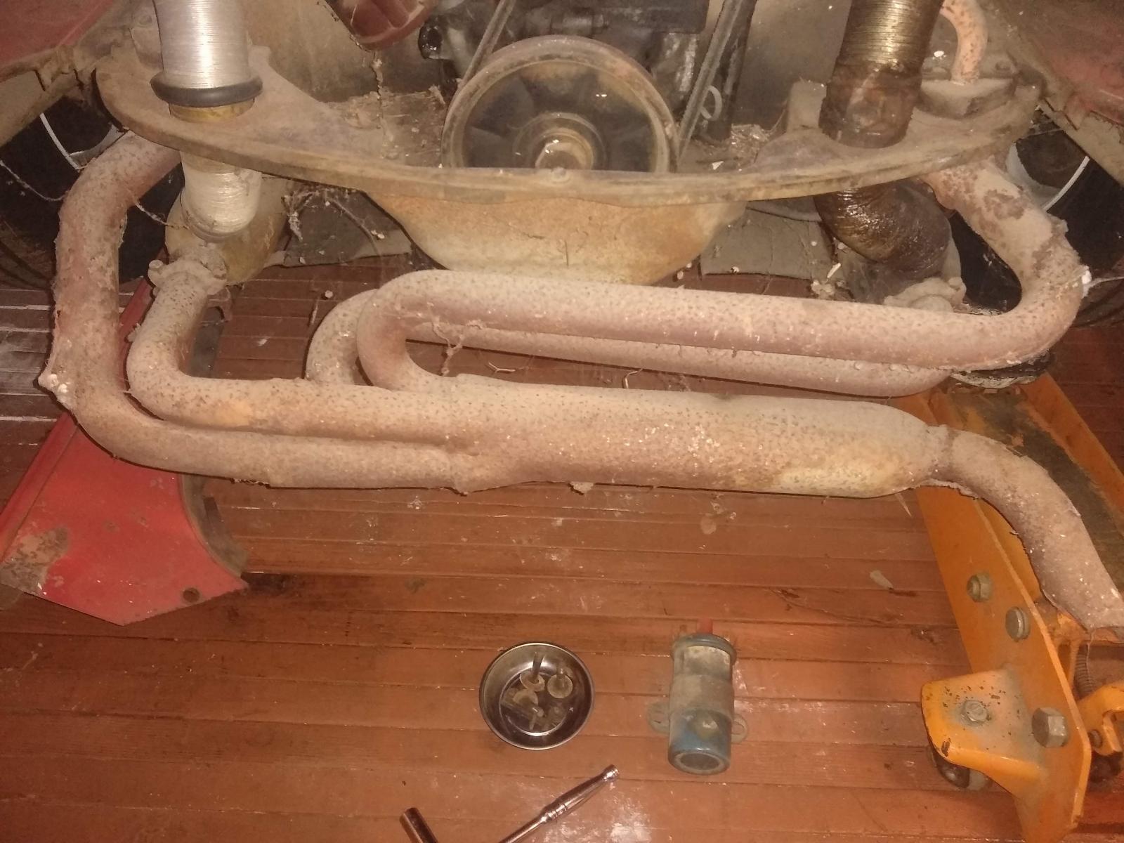

Here it is!
I try not to proliferate new topics, but I've found that asking questions on my build thread seem to get much less responses. Not sure what the etiquette is.

pics from your other thread, sweet bus!
'67 rear tin? does the engine have the 67 heater box pre heat spout?
Pre-heat is important in the PNW
I'd swap to doghouse if it isn't already.

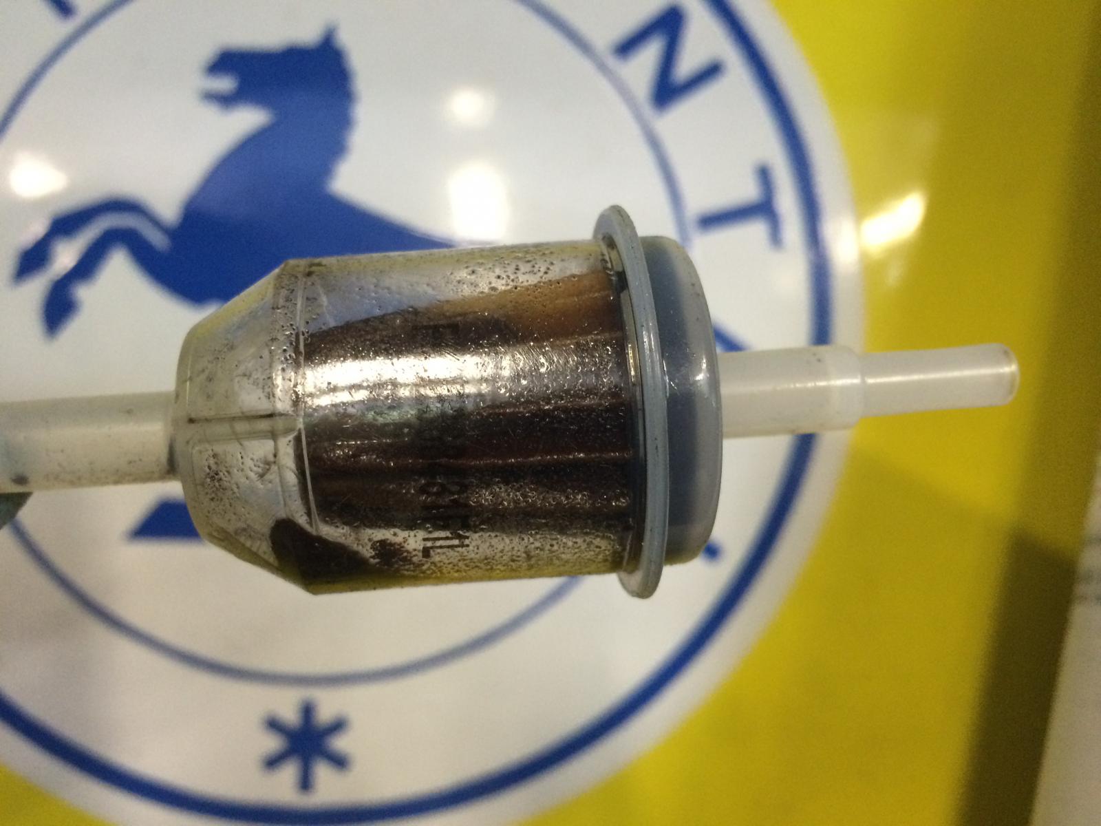

With a long sitting bus, unless you install a new tank, any rust in the tank ends up in the filter. This can clog the filter, so check it frequently. (Every day you drive) (I've had to change it after 10 miles) I often run a couple filters in line in the engine compartment, where they can be checked easily. I dislike changing a fuel filter above my head, gas dripping on me.
People with filters under the engine get to climb underneath to check the filter, and also have gas drip on them when they change it. When you should do this every day you drive it, it gets old, and encourages lack of maintenance.
I add a new filter closer to the carb, so the old filter gets the gas first. Until it stays clean, then just go to one fuel filter.
