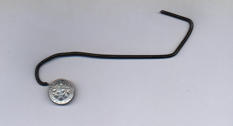

I looked in Bentley and it wasn't there so this from a 40 year memory. I seem to recall that the lock tumbler mechanism is a pop in that is held in by a spring band. The lock tumbler has to come out to have room to pull anythnig else. And that to pull the tumbler out you have to find a small hole on the topside of the lock cylinder which you can get to only by bending a coat hanger and fishing for the hole. Once the lock tumbler us released, then if you have the 1971 style you can replace the lock body and ignition switch with a couple of small screws. On the 1970 and earlier I think the lock body is a part of the housing. I still have the tool I made because it was such a PITA and although I maybe wrong, I think you will need something like this to get around the lock housing on the inside of the steering lock housing so you can press that black spring and release the tumbler. At least on a 1971. On our 1977 we had to drill a small hole to reach that black clip as VW no longer provided one in the lock housing. The 1971 thing was kind of a only a lock smith or dealer would know thing.
You can see the black spring clip that you have to press in this photo.
this is what the tool looks like that presses (actually pulls it) in. The curve which is about the size of dime wraps around the cylinder, through the hole and then you can pull on the other end and the black spring will depress, Then the lock tumbler will come out and then everything else can be taken apart as needed. If all you need is to replace the lock tumbler then this tool will pop it out once you have access to the bottom of the lock housing so you can reach around and find that small tiny hole that if I remember is hardly even visible with the lock housing in. SOME ONE ELSE VERIFY THIS PLEASE cause I've worked on lots of cars and this could be from a Rabbit I worked on a long time ago too.

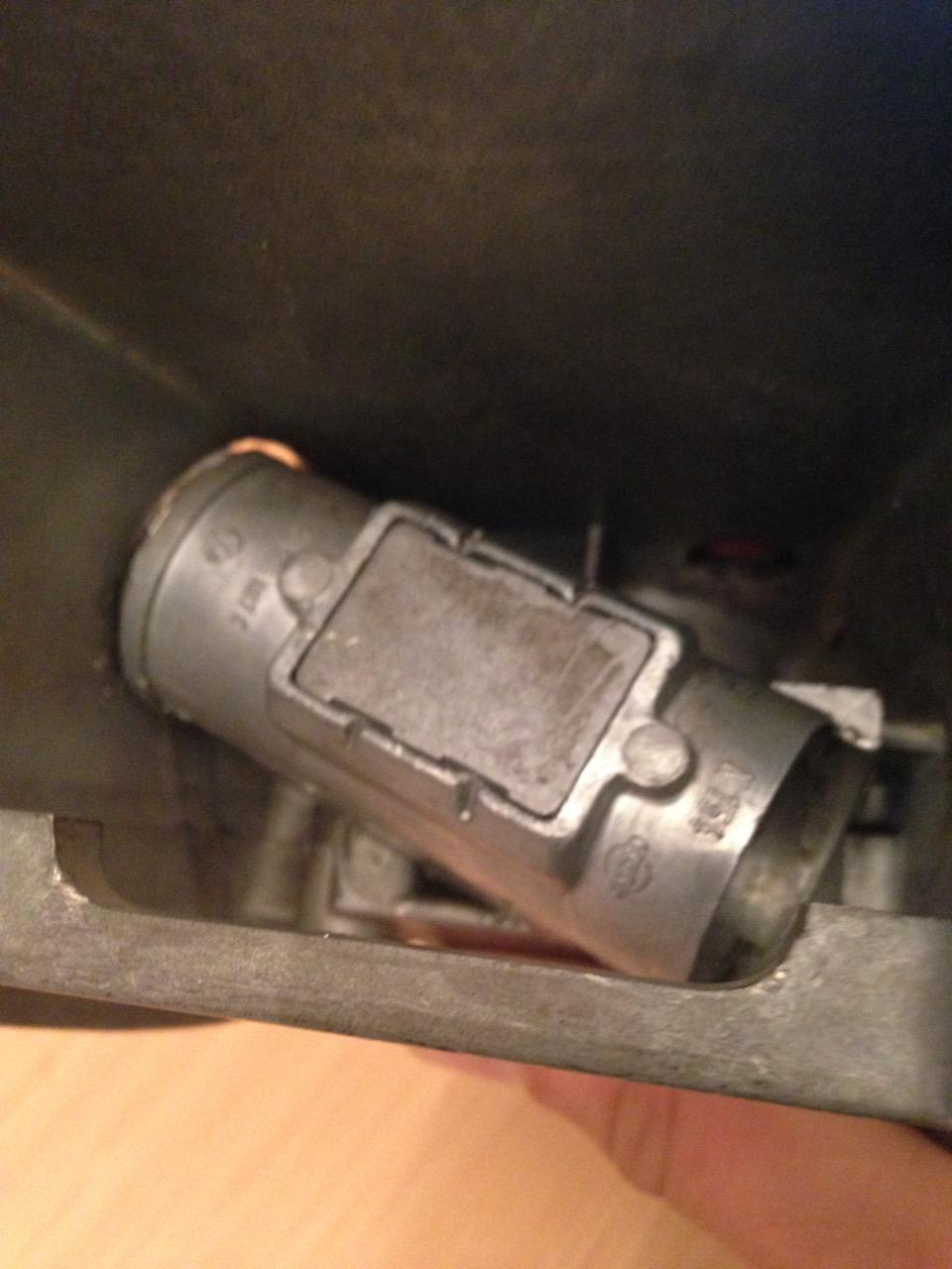

Hello - I am hoping that someone will still be able to help me out here. I have been trying to remove the ignition key lock tumbler from my ignition housing for two days, but I can't seem to get it. This is from a 1971 bus with no key.
From all the posts I have read, there is supposed to be a small spring in the back of the housing that releases the lock tumbler... but I can't seem to get to it. I have tried using a wire hanger.... But to no avail...

you need to find the hole. the wire goes in and releases the spring. you need something to put into the key slot (even a incorrect key will work) and pull it out when you release the spring.

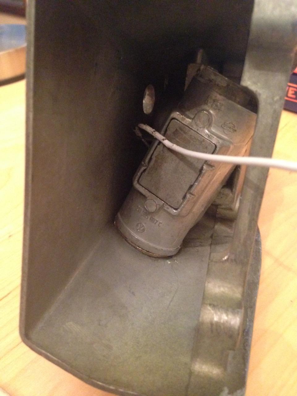

for anyone still wondering - you can see the little hole on the housing that you need to really push hard on.

you can see the housing has a ramp cast into it so you can get it in the hole. I guess putting hair around it would not have worked near as well. also, as you found out, you need a good stiff rod with a bit of girth to get it done. otherwise, if your rod isn't stiff enough it's like playing pool with a rope

Finally got it! It seems like the spring was depressed on the upper part and not the lower part. A good night's sleep helped me calm down and route it out more. Thanks for the help!
And here is a photo for future reference. The hole is where the spring was before I yanked it enough to pull it out, about 11:00. I was doubtful that I'd be able to see the spring easily but it was obvious when I was right on top of it because it's in its own little channel (the hole shown in the photo).

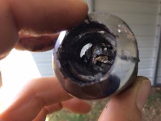

PostPosted: Fri Mar 13, 2015 7:24 pm    Post subject: ignition cylinder Reply with quote
Hey, need help. I got the lock cylinder out of the housing....took an extra set of hands. When the lock popped out of the housing we think something went flying to the back of the bus!! Now the key doesn't spring back to the run position. Is there a spring just under the cylinder? Also the little door was off the housing....could something have come from there??
