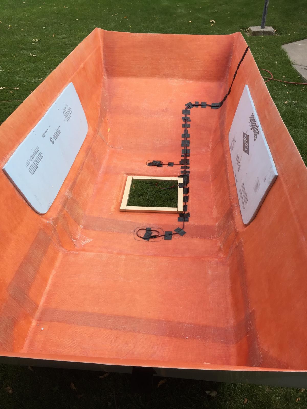

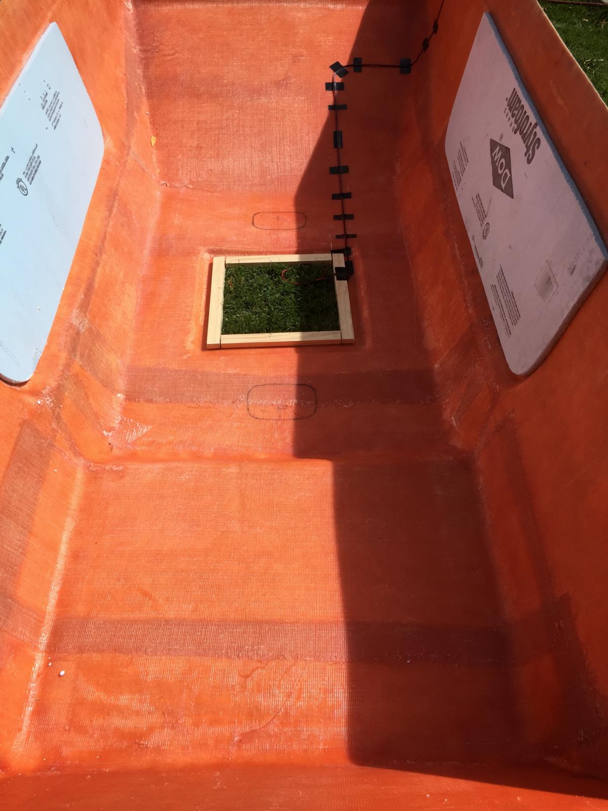

Wrong glue for foam. whoops
Right glue
Spacers attached
Wiring for the lights and fan. Changed my mind and just used tape.
88 Vanaru, ej22, naht

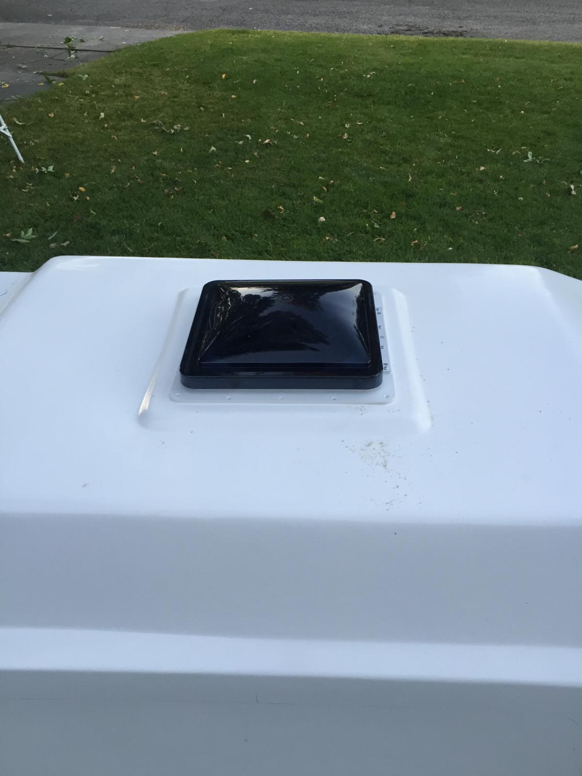

I'll be interested to see your wiring for future solar. Do you think you'll mount it in the front (I inferred that from your post but may be wrong).
Is that a Fantastic vent, and if so, which model? If not, what vent did you choose?

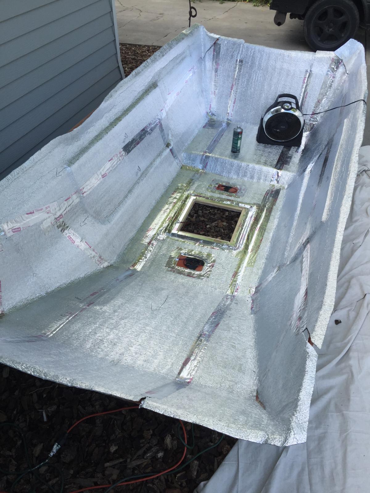

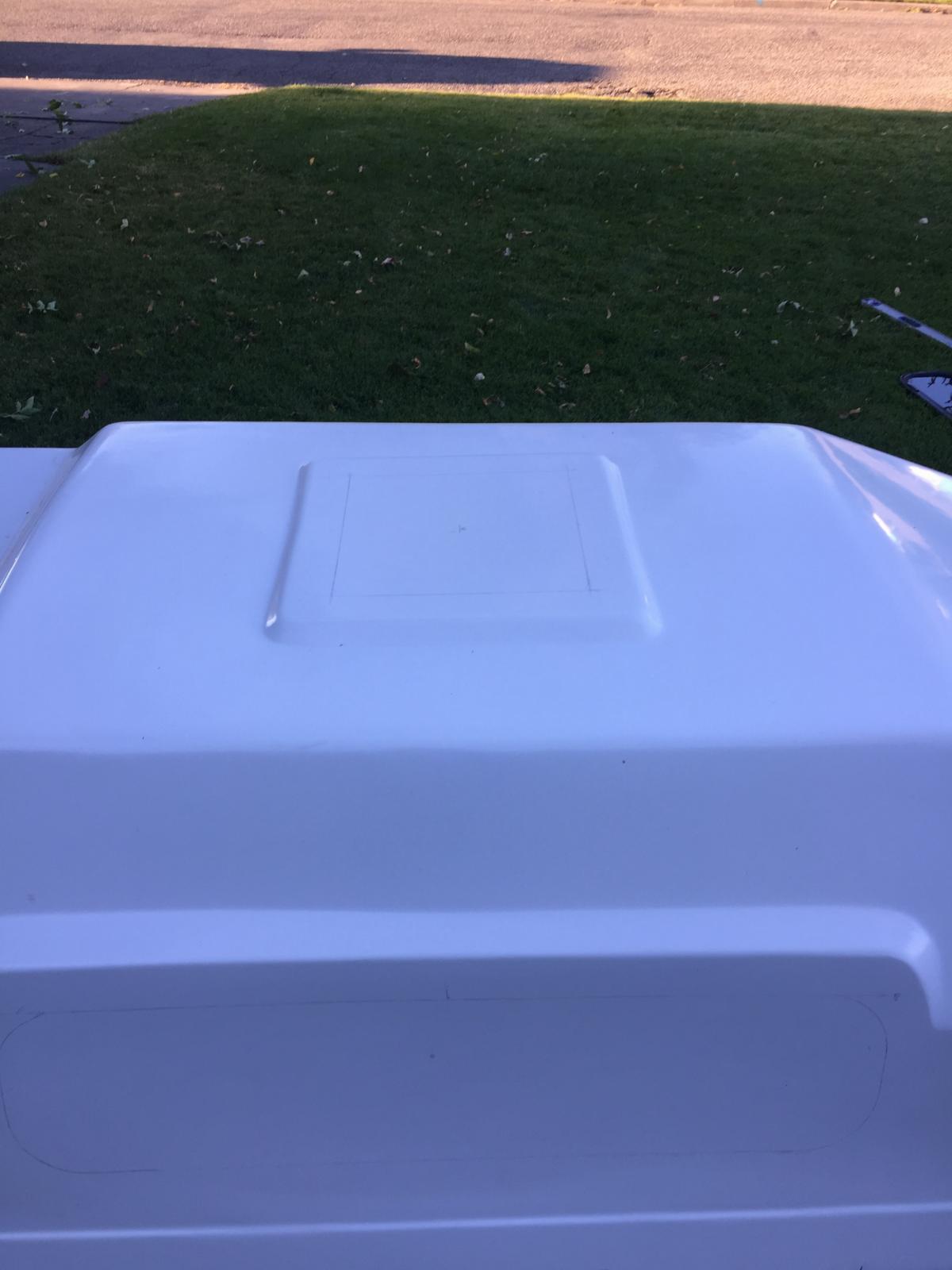

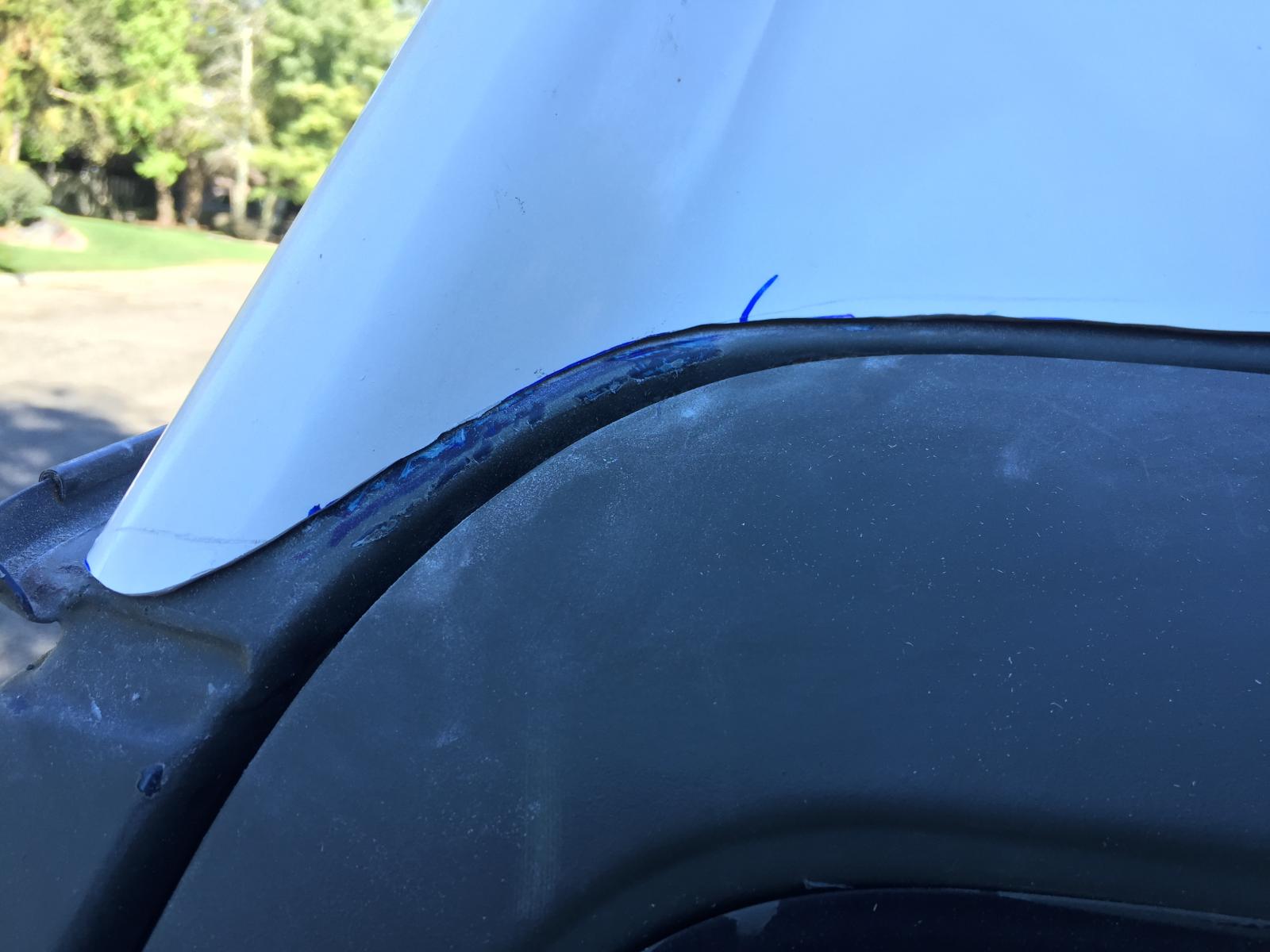

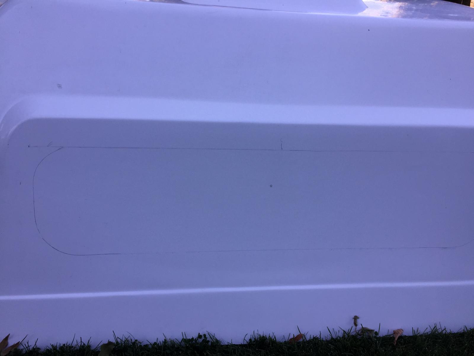

A little more progress
solar wires
solar
fitted prodded ready for glue
traced the prodded layout
3/5ths of the way done
all done, will tape seams and trim the insulation down in the morning before the headliner goes in

No rear. Theres a small flat spot behind the fan.
Yes fantastic fan 2250. We really wanted the rain sensor and t-stat option but didn't want to spend 300$, picked this one up for 180. The lights were 10$ each.
Thx

Already for the flex form.
First area of flex form and lights. Woot woot
