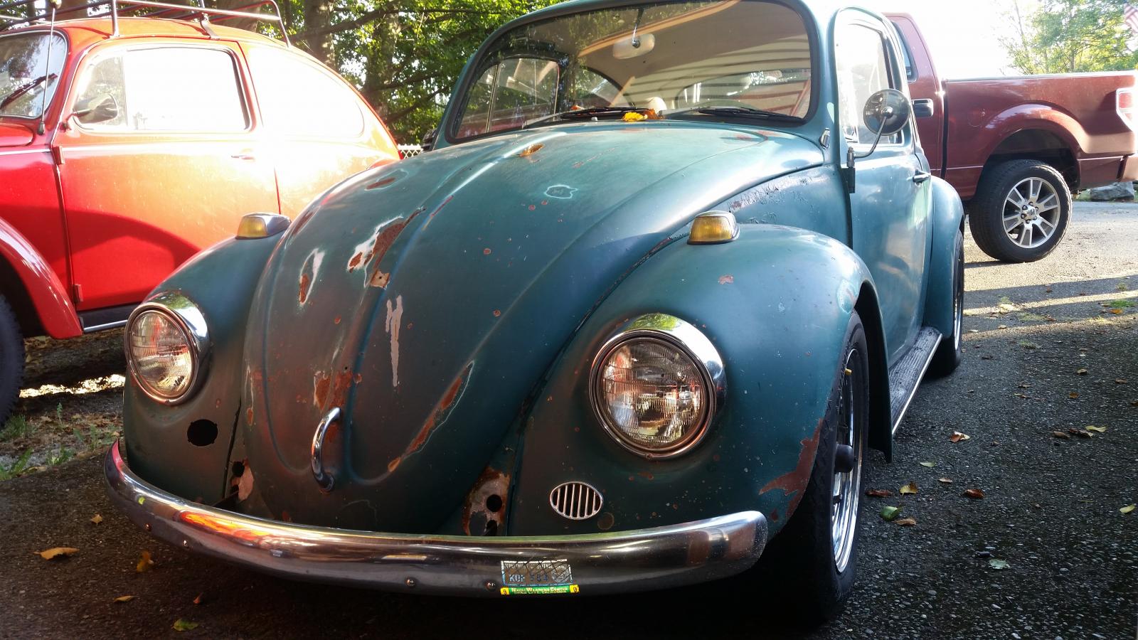

Saw this on the local Craigslist and couldn't pass it up. A military member was needing to unload it so I took it for a scary test drive and struck a deal.
It has a simple cut and turn in the front, 1600dp and the body looks very dry. I'm going to fix some basic things to be more road worthy and then just drive while I fix. I prefer that over something that will be immobile for a year or more. It's got great patina and I will post progress as I go.
Got it home next to her taller fatter sister.
I wish someone hadn't sanded the decklid. Sad I'll be on the lookout for another og paint one or perhaps a holy grail vert one.

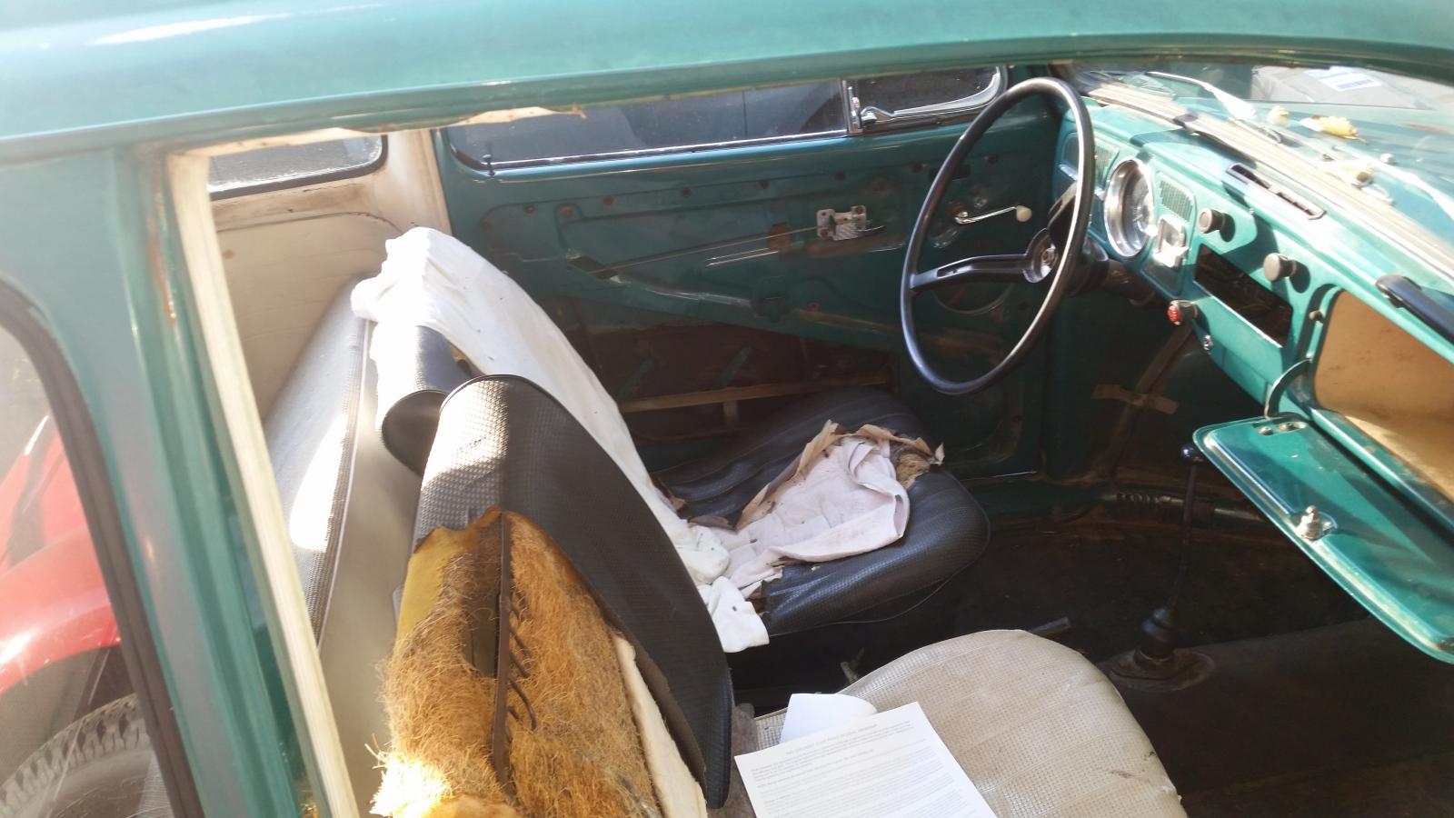

Needs interior very badly, But the dash is nice and uncut.

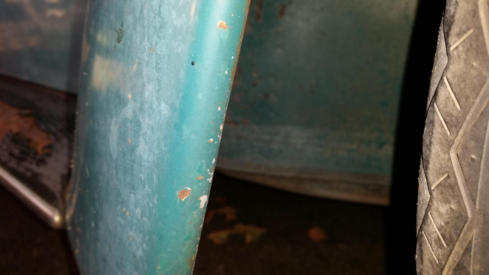

All four corners are nice and dry.
So during the scary test drive I noticed the brakes were way out of adjustment and so was the clutch. I got it home and put a jack under it, The fronts were so far out of adjustment it was on stopping on the rears. This was the guys daily driver! The front shoes were really thin so I ordered new ones. Next was the clutch issue, It is really hard to depress and the cable had two washers on it and all the adjustment was taken used up so I ordered a new cable and a spare as well. You can also see a spacer on the top engine bolt.

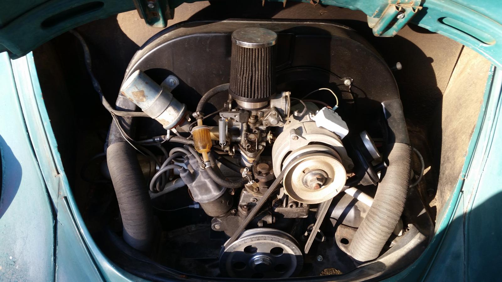

The infamous 34pict with a 009 and a fuel filter in the engine compartment to boot. Mad I'll fix all of that.

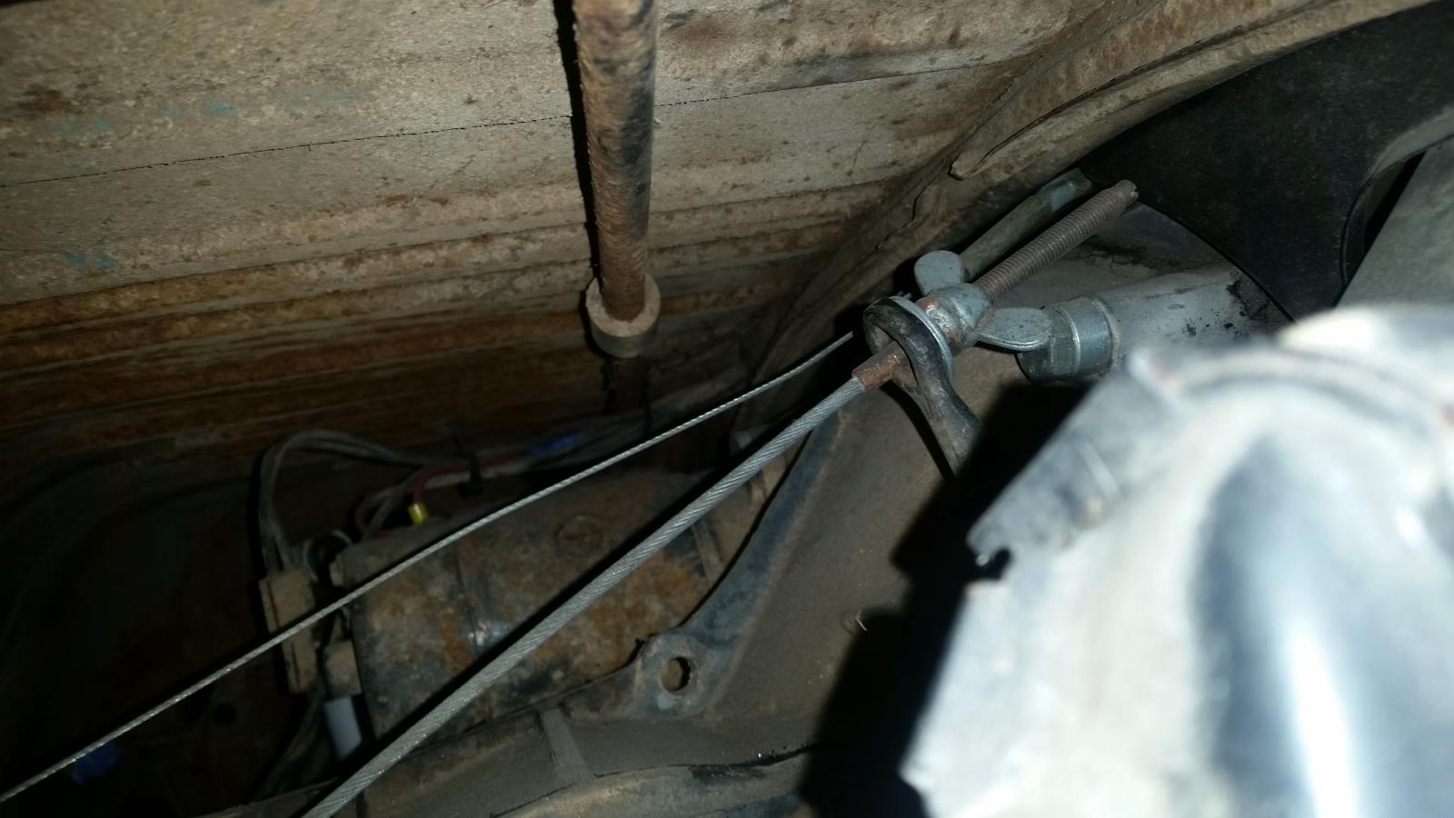

During the test drive I noticed the shifter was a little sloppy. I popped the shift coupler inspection cover off and found this, Someone had stuffed the rear section with foam and the forward bushing had traveled all the way to the back. Shocked

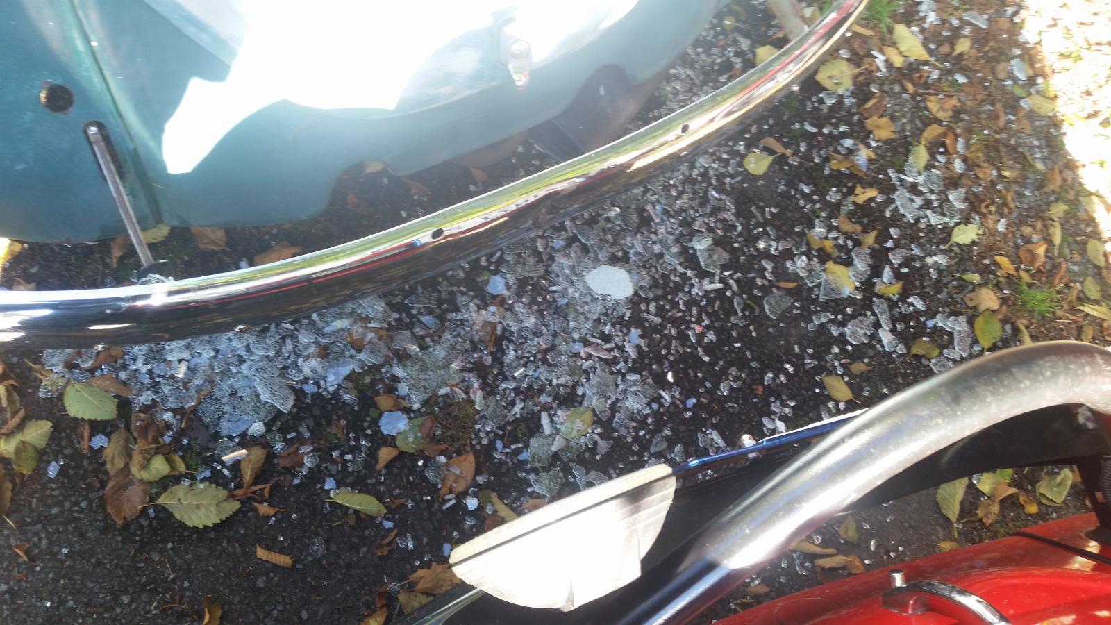

Last night I started with the rear window gasket because it's leaking into the car. I crawled in the back and pushed with my shoulder and got it to move, But I thought I would push a little more before going to the outside to finish and it popped out onto the ground KABLOOIE! Mad
I already located a window for free about an hour away that I'm getting this afternoon. I eventually want to find the right one without the defrost grid but this will work for now.

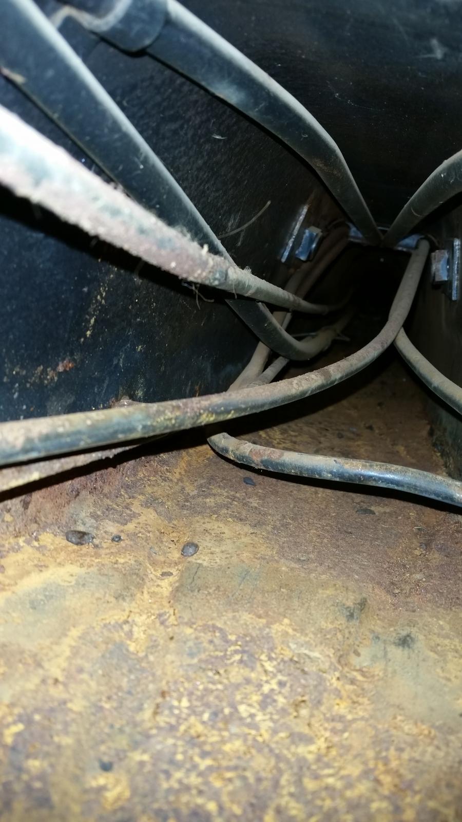

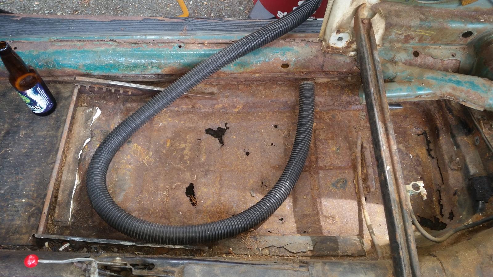

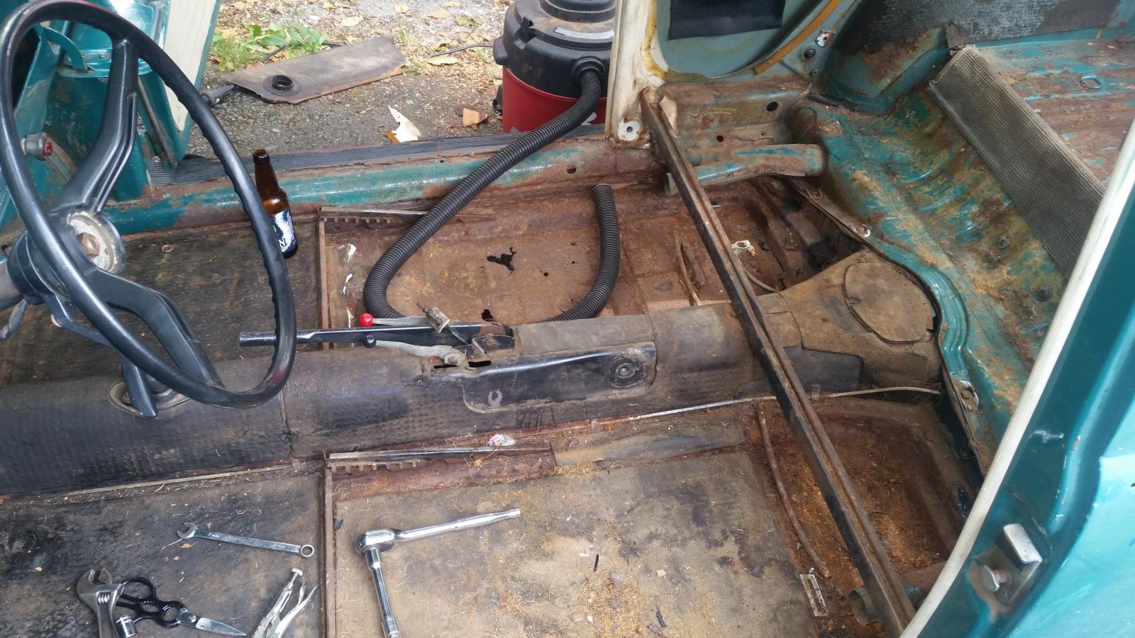

Picked up the new window yesterday and popped it in. I cleaned the frame and waxed the paint around it before installing. Just making it easier on myself later.
Next I pulled the shift rod out to change the fwd bushing. I'm also going to replace the hanger bracket for it too. Note all the sunflower seed shells.

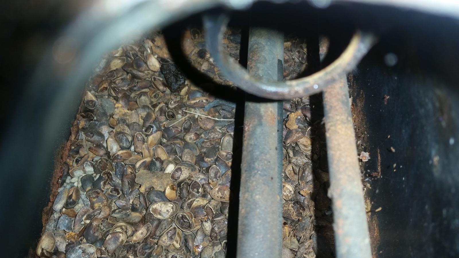

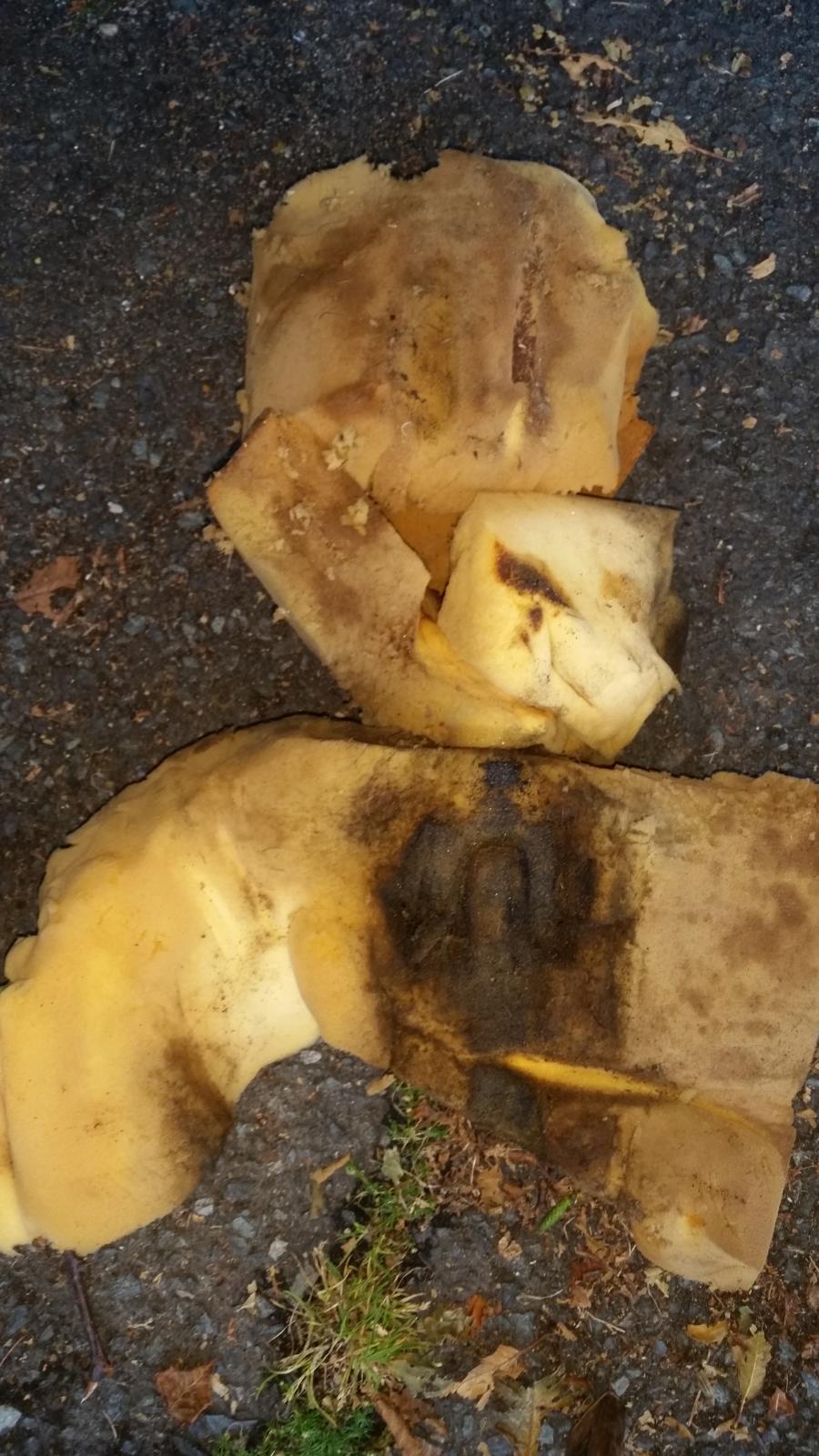

I pulled all the dreaded foam out of the rear section of the pan. I'm guessing the shifter rattled a speed and that was someone's fix. The second pic shows the bottom of the foam and the moisture it held working on returning the steel back to mother natures original version.
Another shot of the tunnel, I'm going to clean it out and use this paint product to coat it.

I bought 5 or six cans of that stuff for my single cab. I'm using in all the pillars and frame members I can access. The spray tube is only 24" long. Sprays on nice.

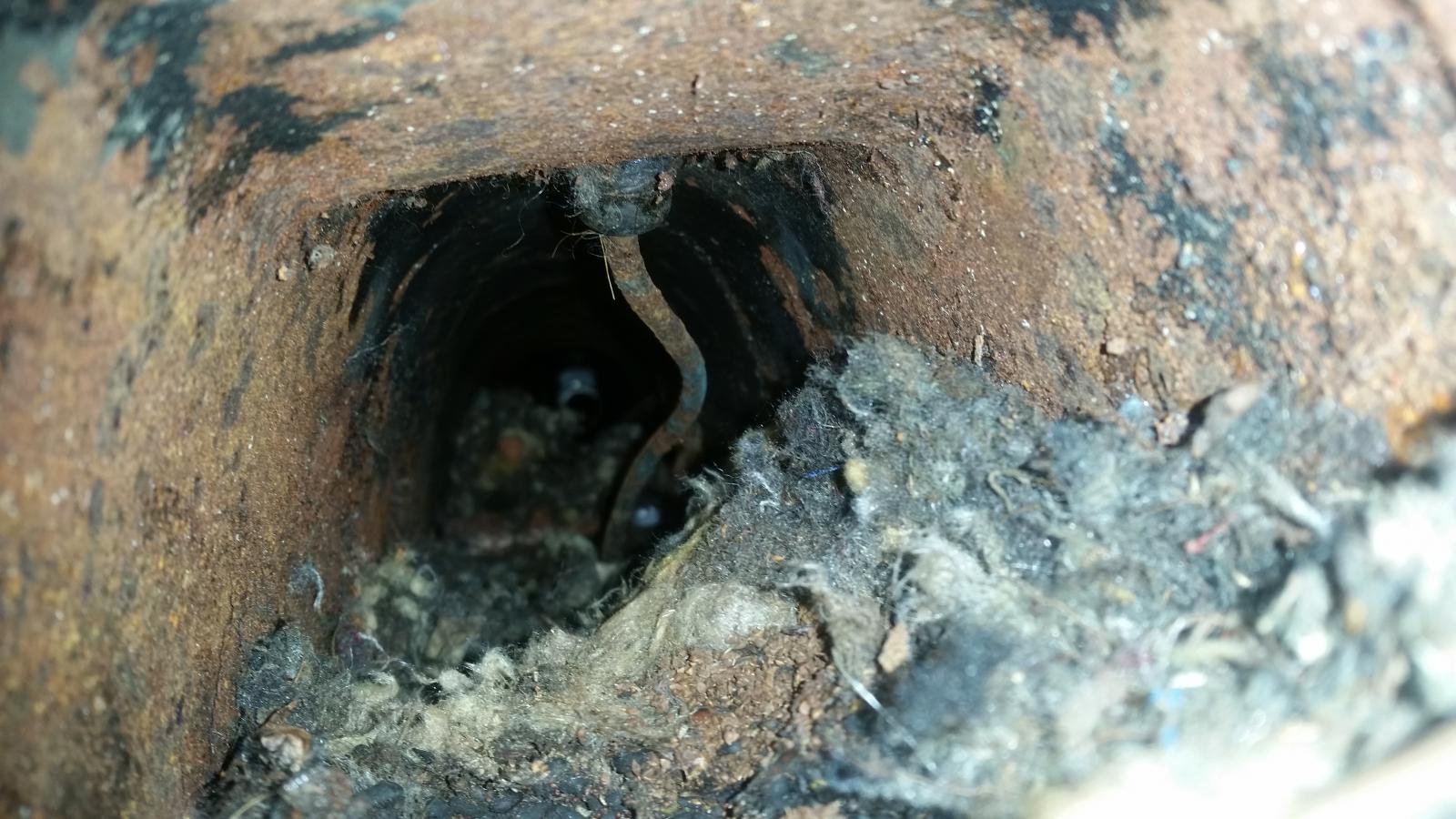

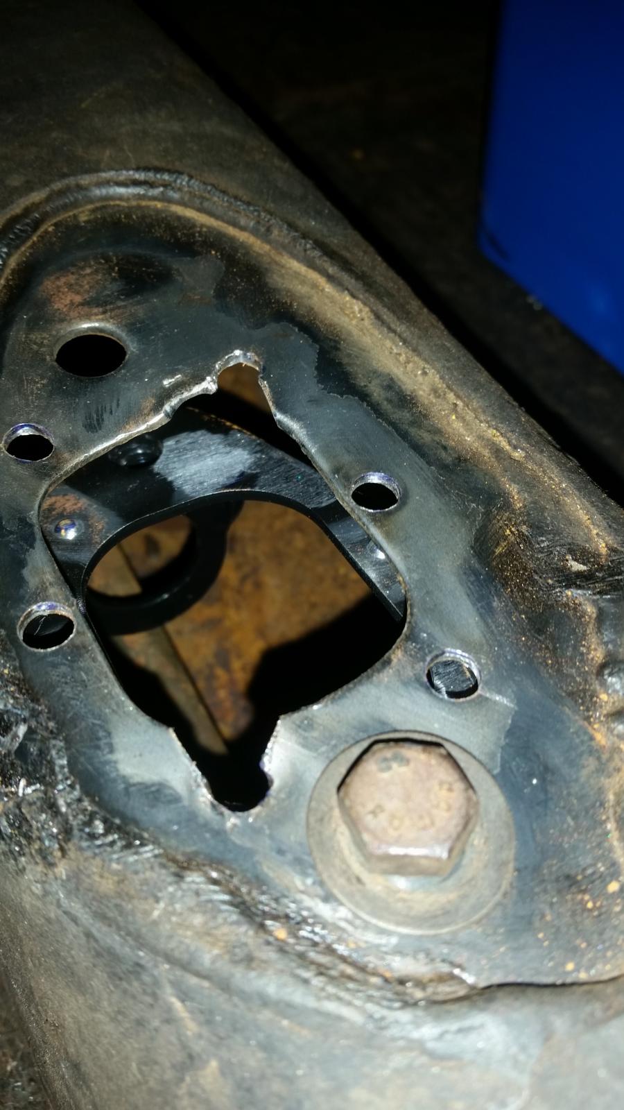

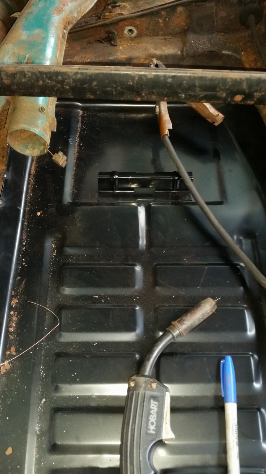

Still cleaning the tunnel out with a combination of air and a shop vac.
Had a few beers when I got home and then went out in the Laboratory and had a few more and almost made a HUGE mistake installing the shifter bracket, The camera is pointing forward. Shocked
I flipped it around and welded it in.
I actually get a 2 day weekend so I am going to work on the pan half replacement in the morning.

Pan replacement is in and about 65% welded out which I'll finish up today.

Finished welding the pan up and rust treated the tunnel with the first coat.

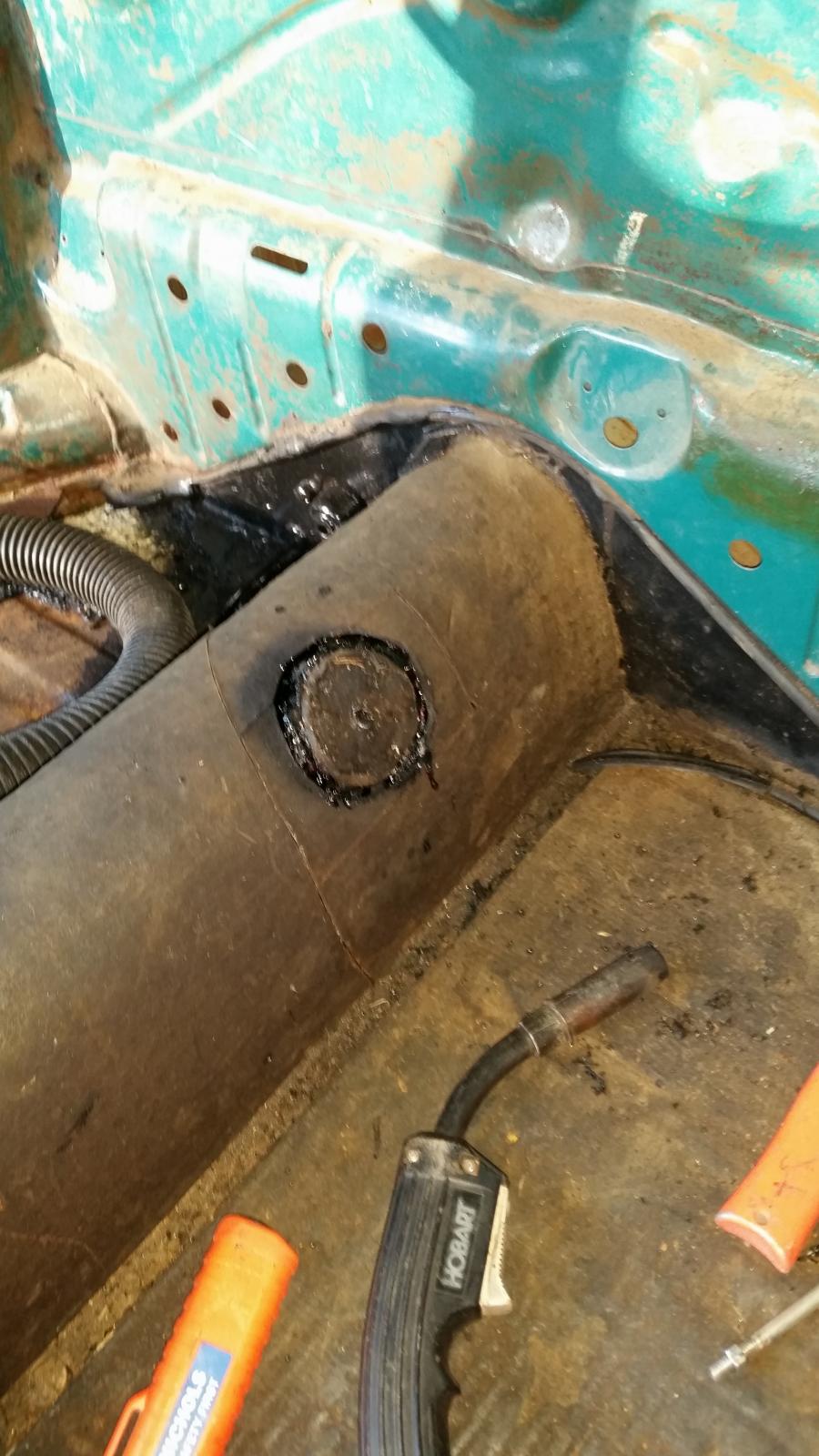

I went to install the clutch cable and noticed the weld broke at the forward ned of the tube. I cut an access hole to fix it I also noticed a small area where my shop vac did not get all the crud in the tunnel so I got it from the new hole.
I welded up the hole and stuck the tar board patch back on.
I had used up all of the green tunnel paint so I shot some black spray paint over the patch.

Adjusting my clutch I noticed this brake line, Looks like only one wrench was used.

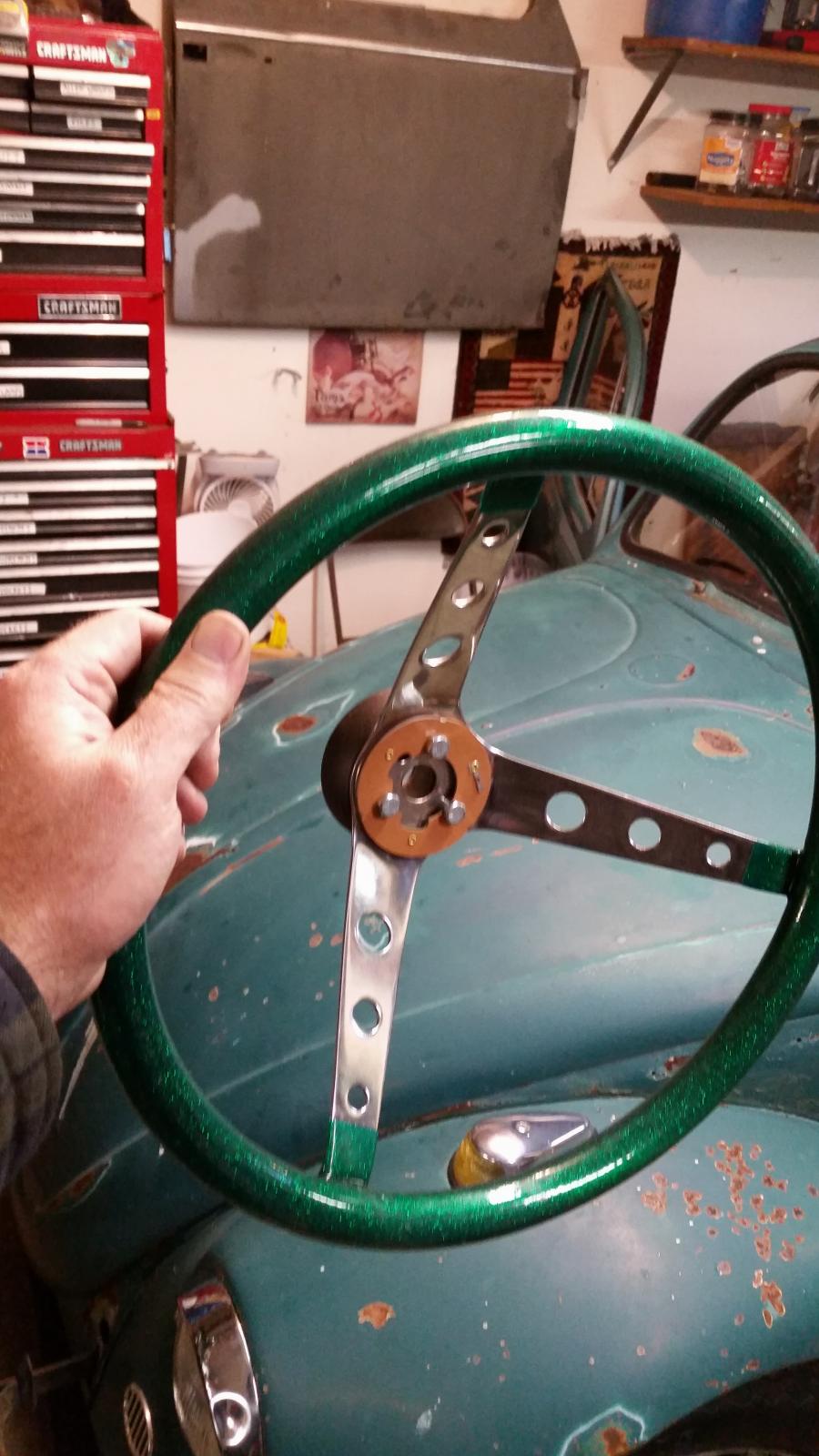

The bug had no wiper motor when I bought it but the linkage was installed wipers and all. I thought that was weird but whatever. I pulled the linkage and it was frozen solid so I broke it down and got the shafts sitting in oil. I'm in the process of cleaning and painting all of the linkage pieces. I bought a used motor and ordered new bushings, clips, and grommets. While doing all this I saw lumps under a fairly new windshield rubber.
Sorry about the shitty cell phone pic, It's pieces of the old rubber gasket. I'm half tempted to just buy a new gasket and razor the other one out vs. trying to save it and end up braking the windshield which looks to be fairly new also. I'm all too familiar with Murphy's Law seeing as how I have already broken the rear window dropping it and my Girlfriend's last name is Murphy lol.
On a side note, I also may use this funky steering wheel I've been sitting on.

Enjoying your project. That looks like a Mooneyes steering wheel. I used a slotted spoke one in in my ghia til I found a used EMPI GTV.
http://www.mooneyesusa.com/15-inch-Metal-Flake-4-Hole-3-Spoke-Steering-Wheel-p/gs280cm.htm
