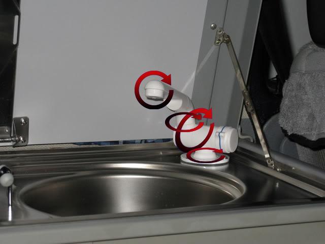

The post that the knob screws to breaks off?
Found some good suggestions for replacements here, but would like to do a quick fix for this coming weekend.
But I'm not sure how it works. Electrically, I can figure it out. Simple. But the post the knob screws to has a cam on it, as does the knob. The post doesn't rotate, unless mine is stuck. How the hell did this knob rotate to allow the electrical connection to be made?

"Fixed" it by putting in a longer screw through the knob. No need to spend $70 on a replacement....

Put a switch on it if you are looking for a quick fix to get you by tI'll the new one shows up.

Ok. One long screw, and we're back in service. Laughing
