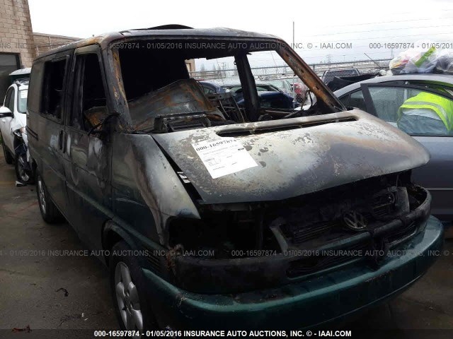

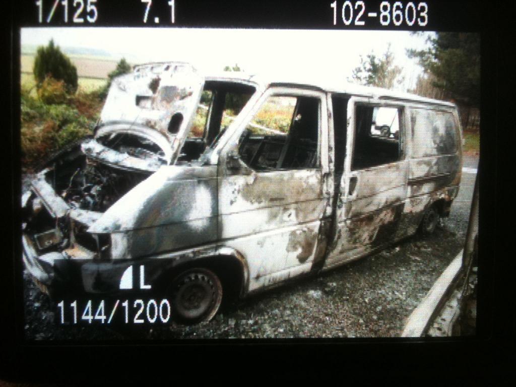

For all vehicles on the road, fires are a possibility, be it fuel or electrical. I carry a fire extinguisher in all my VW's, including my new GTI.
As for the T4's specifically... photos for thought:
Better to be safe than sorry... Wink
And a belated congrats on your newest toy! Cool

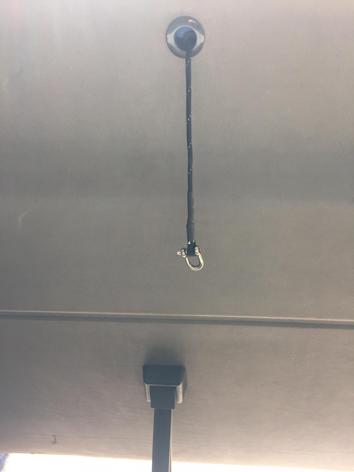

I almost forgot my favorite mod:
Now we can release the hatch from the inside...like VW should've included on all years and models.

That interior hatch release is genius. Would you happen to have a DIY guide, or a parts list? Smile

I certainly can't take credit for the idea, but this particular execution of the idea is crudely simple. I believe the early models ('92-'93) actually had a plastic release built into the door panels. You can still see the cutout for the release on the hatch itself. For reasons known only to VAG management they discontinued with this release on later models. Anyhoo, I can't seem to find the pics I took of the latch mechanism, but once you have the panel off the little bracket that I hooked the cord onto becomes pretty self-evident. I believe it has a hole that the rod connecting with the release handle attaches to up top. I just put some anti-abrasion padding on the hatch were the cord rests, drilled the hole and slipped a little plastic escutcheon in there for good measure. It takes very little effort to release the hatch from the inside.

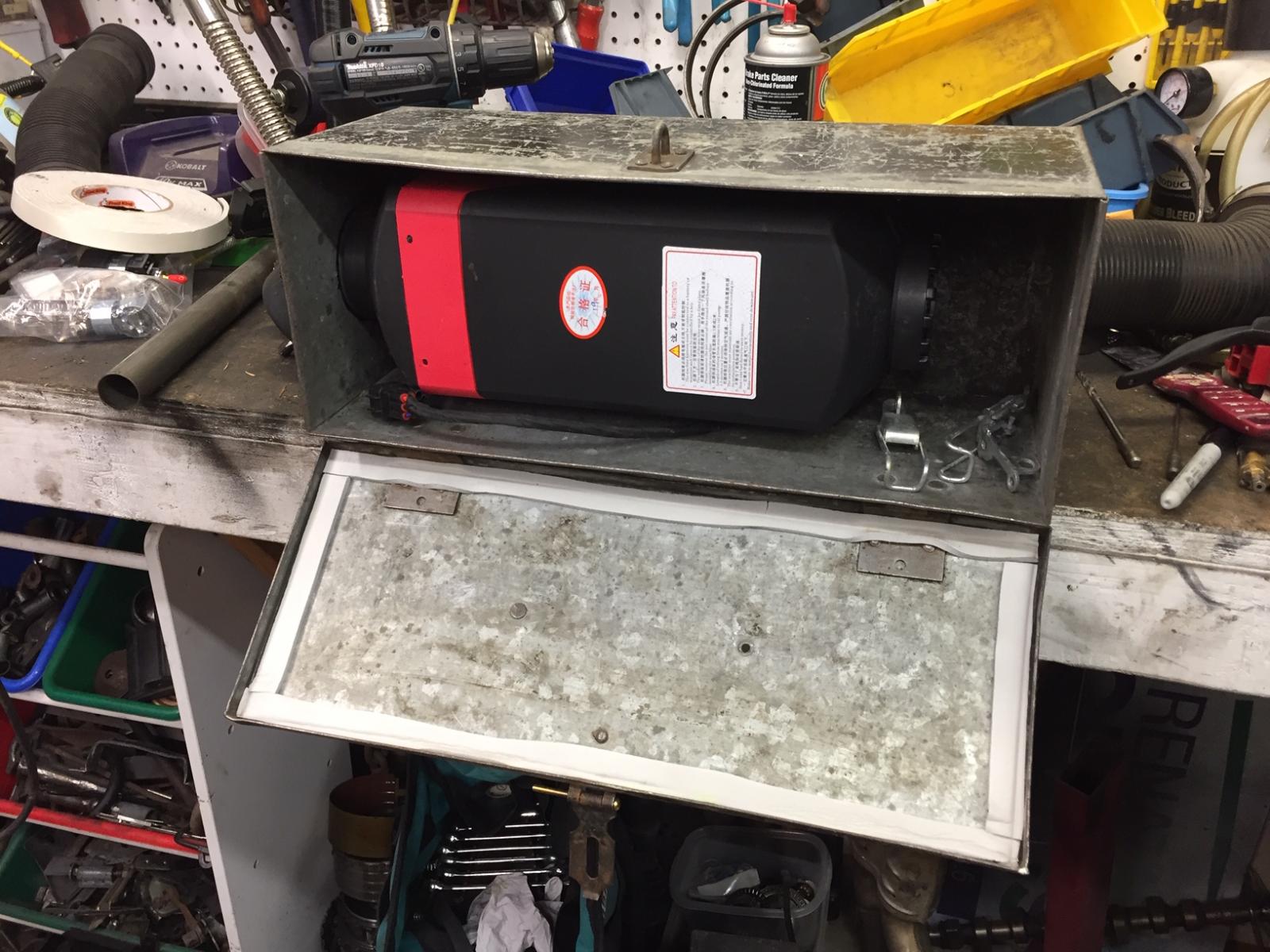

It's been a while since I updated this thread. I recently installed Bilstein shocks all around and did a complete rotor/pad change at all four ends. Prior to that I finally got around to installing the auto-dimming rearview mirror with temp and compass features. I'm currently prepping the van for a Chinese knock-off diesel heater, along with swapping out the rear carpet for PVC flooring. During that project, I'll be cutting out the floor mounts for the passenger rear-facing seat, and welding them in on the driver side. I like the quick change seat option.

Yay for Bilsteins, and yay for an aux heater. I like the homemade window screen, perfect method to solve a problem without tossing a bunch of $$$ around.
