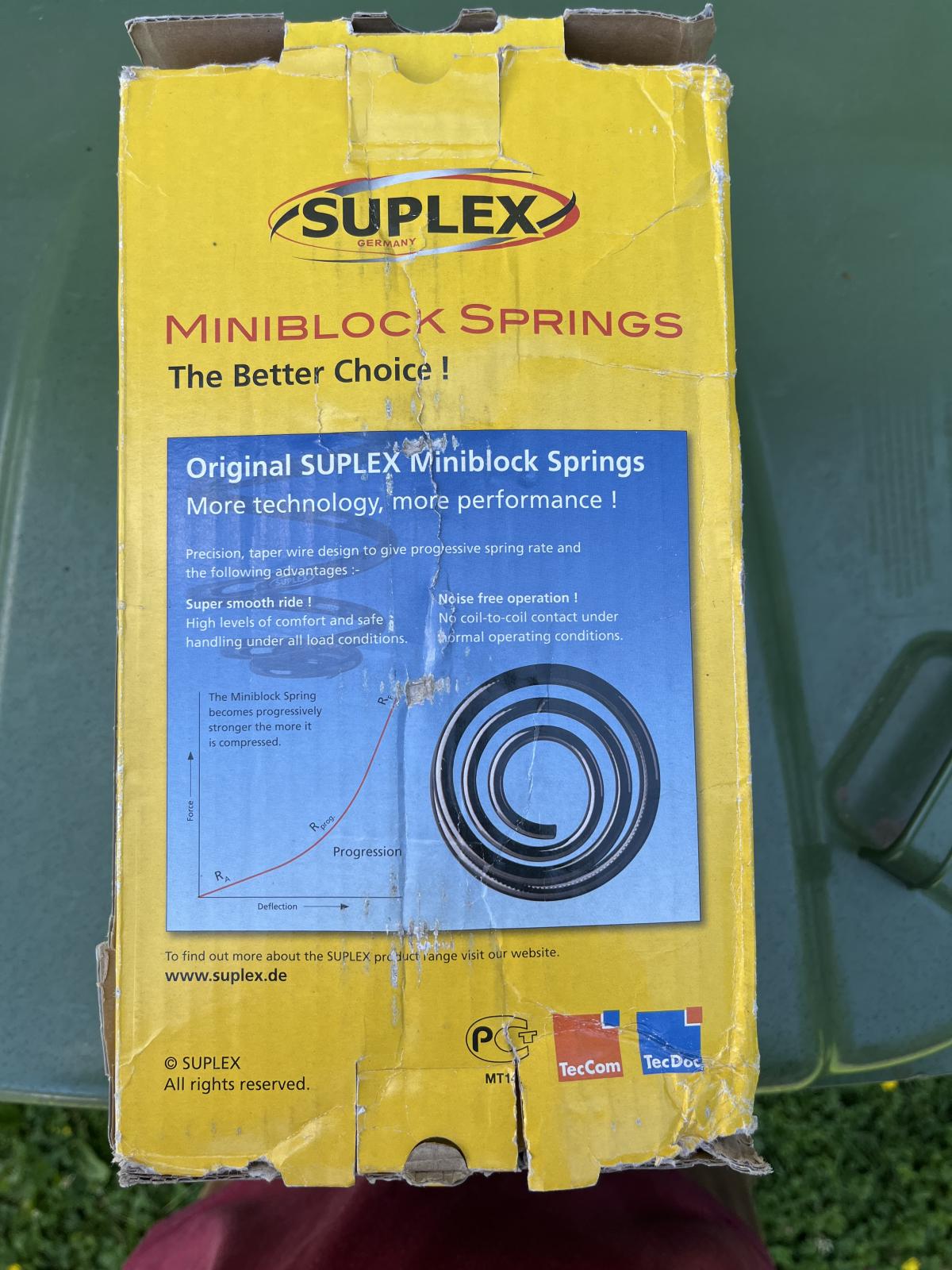

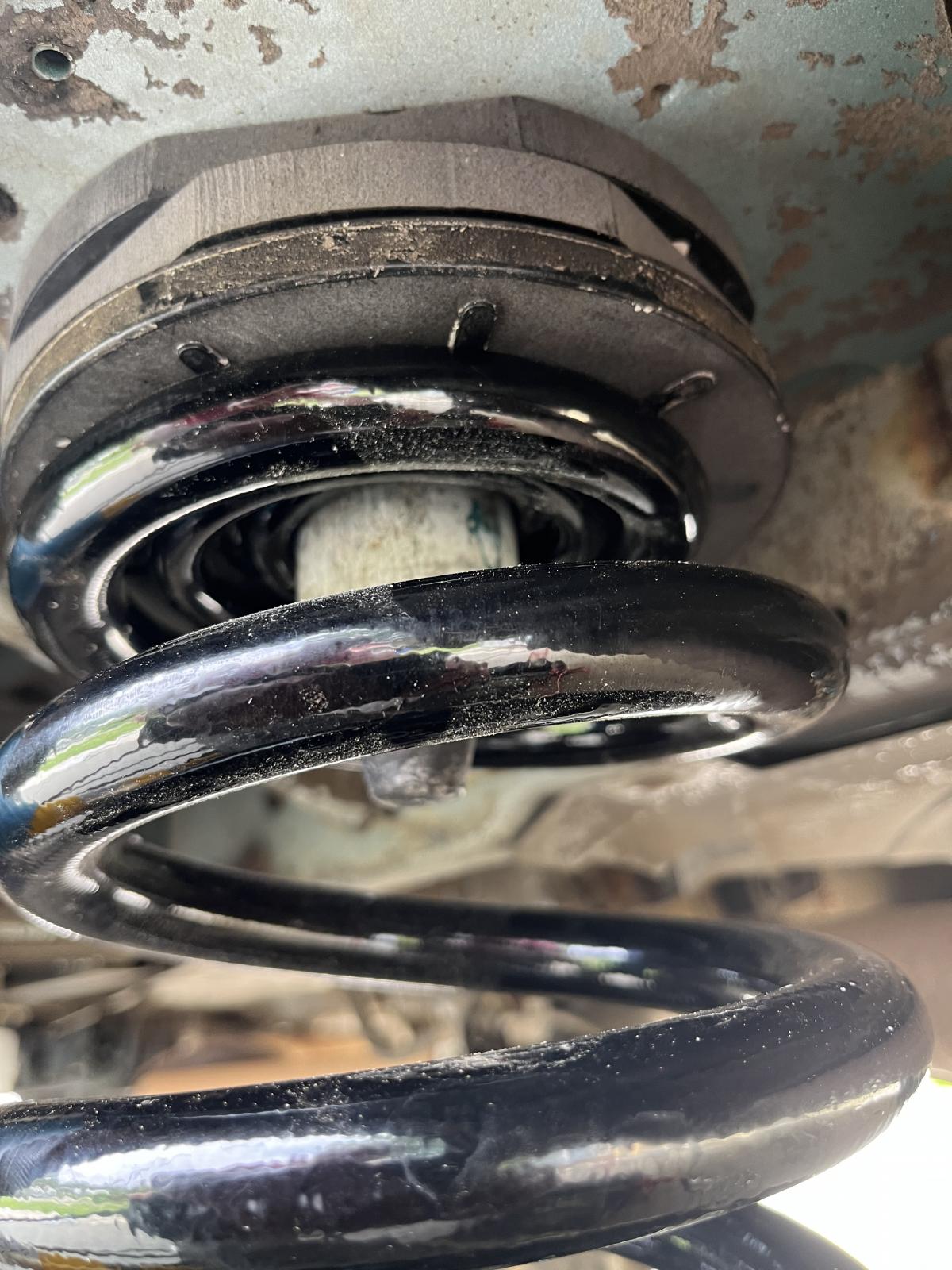

Here are some photos of the Heavy Duty version of the T4 springs that I installed last year ... The Supplex catalog link is down below. Info on VW T4s is on page 641 of the PDF.
they've worked out great btw
Catalog link
https://www.mladov.ru/katalog/suplex/SUPLEX_2008-2009.pdf
