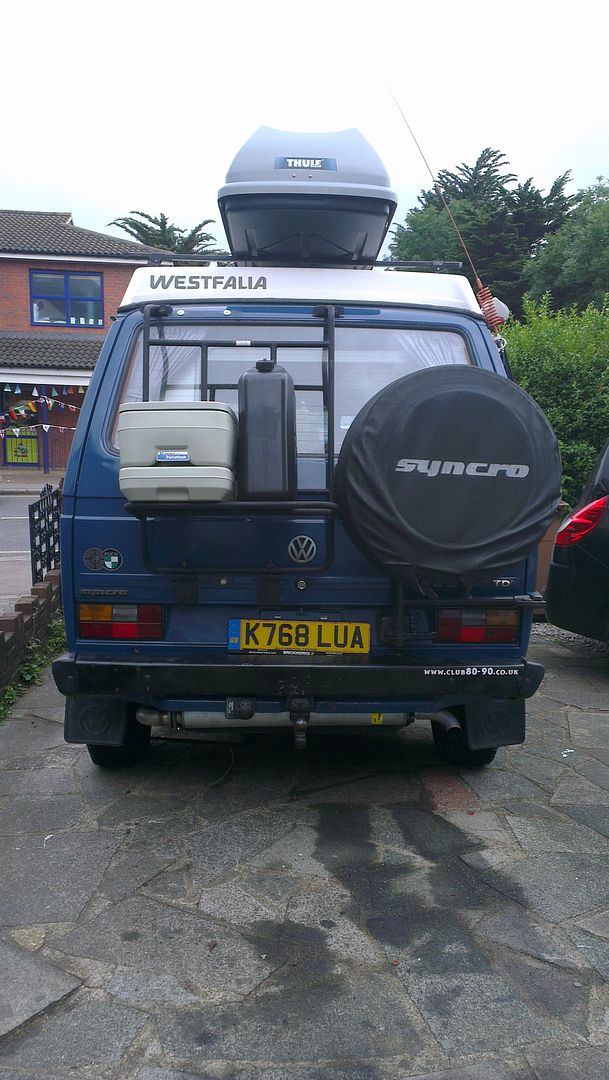

Hi all, planning to document on here some of what is going on with my van..
Primarily because its now left my hands to have some pretty extensive bodywork done, and at the same time its having a TDI engine built up for me. I've tried a few times to start a thread going, but it's always derailed due to things going wrong.. This time it will be better..promise..
Firstly a bit of history upto this point.

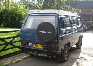

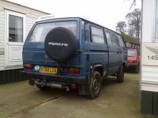

It's a factory 16" multivan with M code options of poptop and wardrobe and overhead locker, basically the package you call a weekender. I bought the van in Dec '09 as a unfinished project, looking like this
and coming off the low loader outside my house

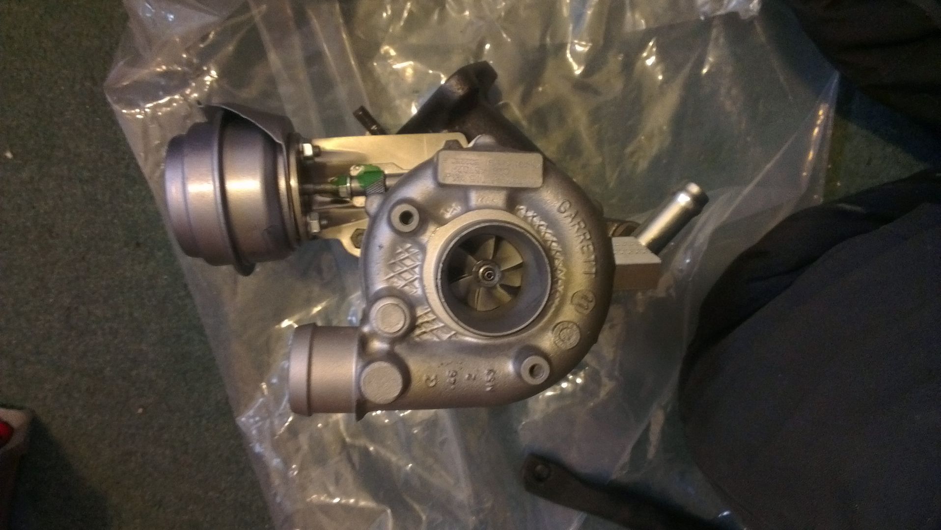

First thing to do was fit a new turbo to the 1.6td engine, as it left a pretty good smoke screen..
with this done it passed the MOT!
16" syncro multivan pop top AHU TDI

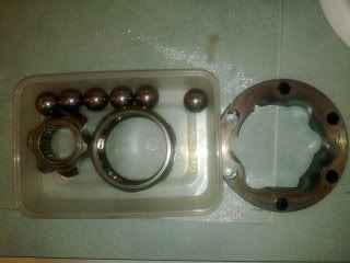

The MOT flagged up a split CV boot, so this was stripped cleaned and refitted. Me and jed the spread did this and also took up the opportunity to free of the rear diff lock
It was also picked up at this time that the vc had failed, so a new one was purchased and fitted

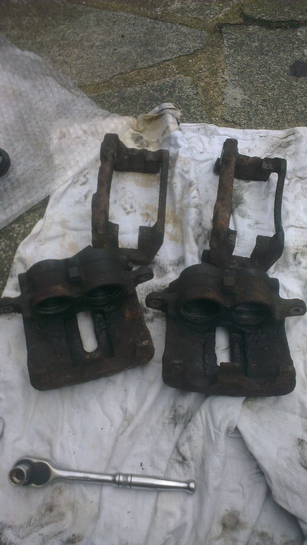

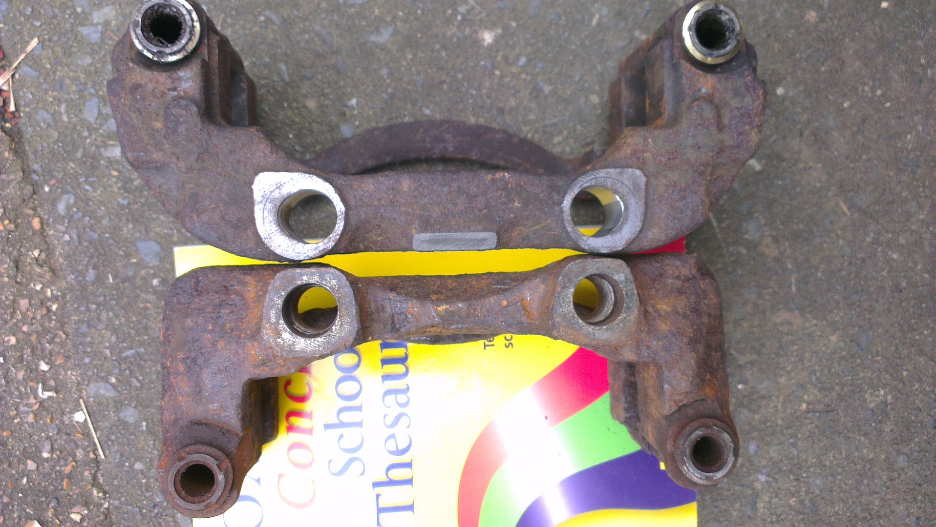

A cheap spray job was next on the cards, just to cover over the some of the bare panels. Proper bodywork was on the cards..
the old power steering pipes were removed due to a few leaks
and replaced with new hoses
first bit of wild camping for me and the boy

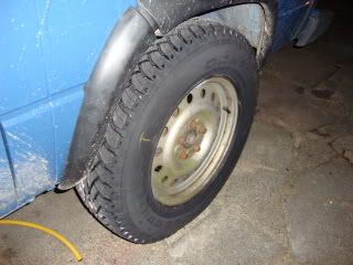

Picked up some new rubber, as the van was still on its original tyres..

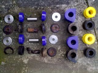

Antiroll bar rubbers needed some love

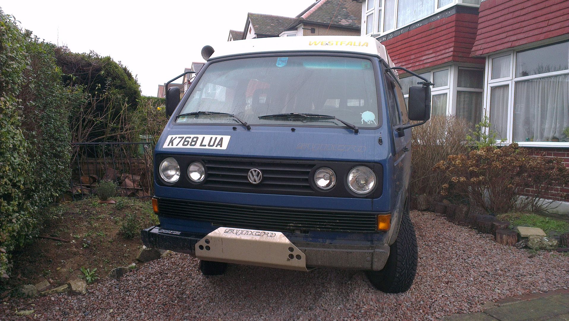

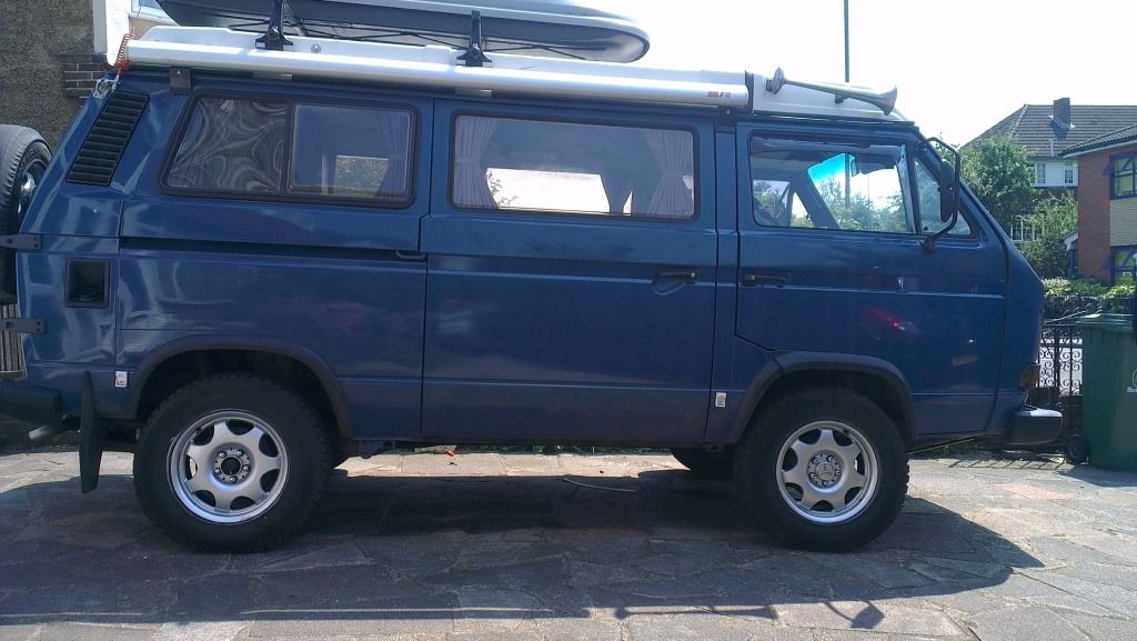

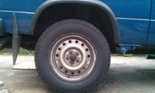

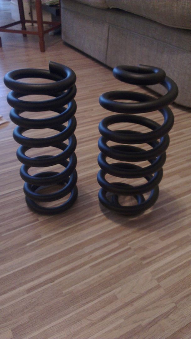

After seeing those pics i decided a lift was in order, so some 30mm spacers were fitted all round

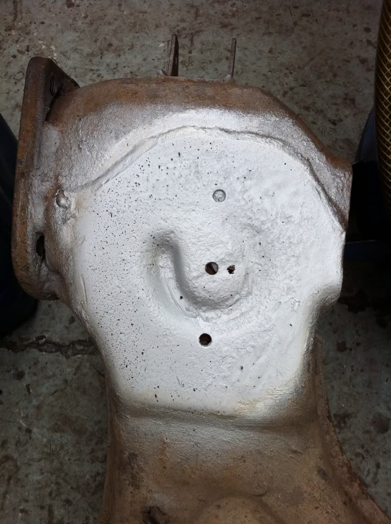

Things were going pretty well.. Driving down to stonehenge one evening a coolant hose decides to split, dumping all the coolant on the motorway. Sad But with me being a positive thinker, i thought hey, lets go TDI and get the box rebuilt. It'll be super reliable then...... The gearbox was rebuilt by Aidan talbott and has been perfect ever since. The TDI not so, it was entrusted to a garage, who ended up having the van for nearly 3 months and totally screwed it up as well as ruining carpets and leaving bare live wires everywhere. A few random pics will follow of the 'quality'
this picture i should have acted on sooner..

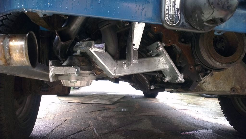

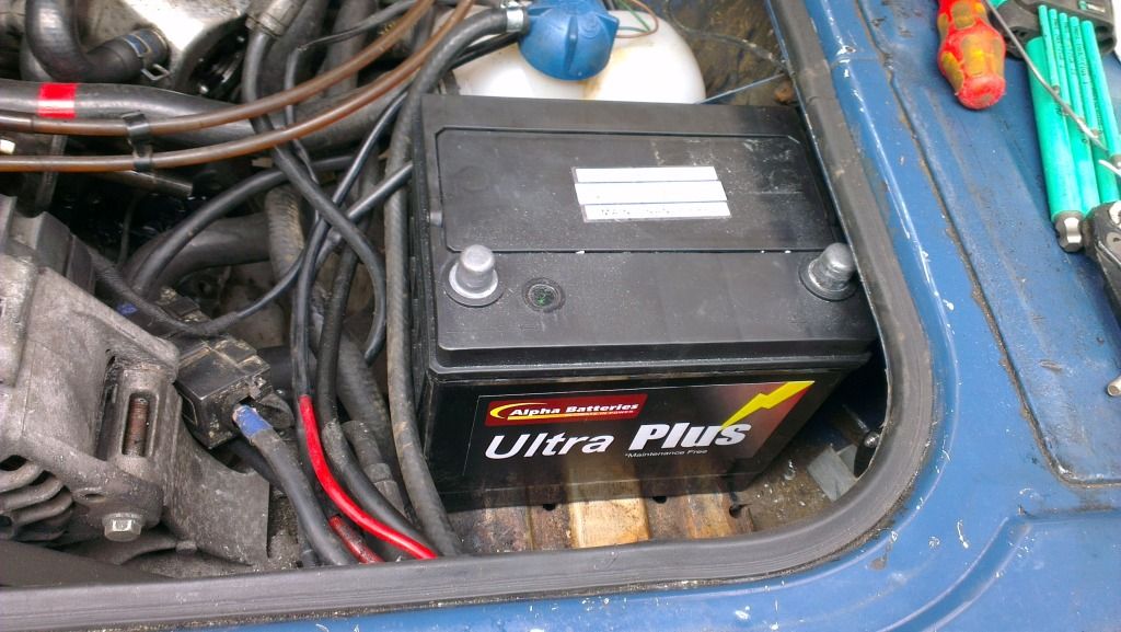

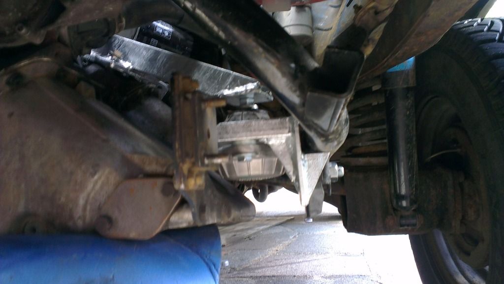

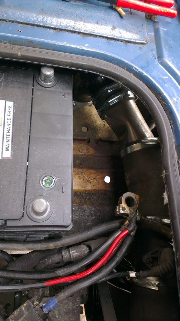

To ad to this the engine mounts that were made up, then broke. I took on fixing it up myself, with some help..
new battery turned round
left more space for the air inlet
bernd jeager engine mounts were fitted
bashplate back on and all running nice

Orange roof rack swaped for a more streamlined version
and some CLK alloys fitted

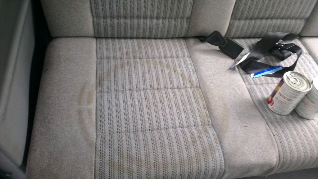

lloydy wrote:
Uploaded with ImageShack.us
Did he BURN the seat or is that just dirt you were able to scrub off? I'd be Pi$$ed!!! The poorly connected wires are easily fixed, but damage to upholstery...If it's just grease, I've used both regular dish soap and Orange (a hand degreaser) to get grease out of fabric, with great results...
Did you move the battery into the back, or was it always there? I've always wondered why mine was under the passenger seat, which would make a great space for other things! LOL
Keep up the hard work and enjoy!

Battery wise, it's a factory diesel so the battery is in the back from the factory

ah, yes.. staines, all of it was oil. It has all come off the seats fine. Carpets are ok-ish.

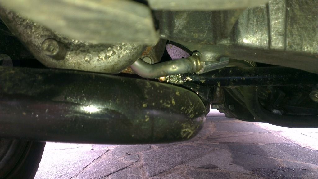

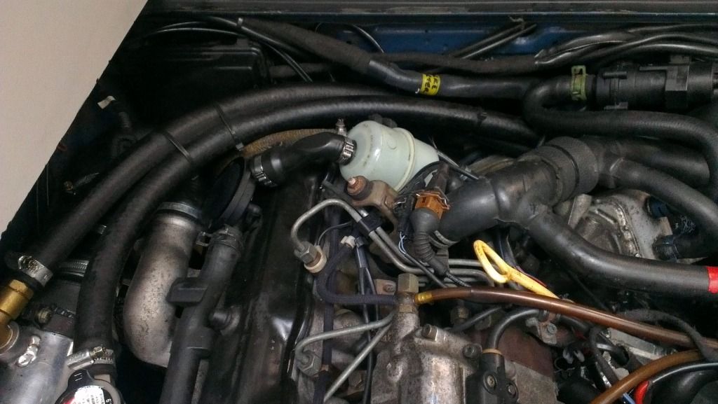

So, when i say the van made it back.. It did, but was giving out a lot of white smoke especially when cold. This and other little hiccups would keep me busy for nearly a year.
First up was a power steering hose in the engine bay splitting
replaced with a genuine VW hose, which has the baffle fitted that aftermarket jobs seem to miss out
My up to that point perfectly operating difflocks started to play up, traced to the little red boot Twisted Evil new ones bought and fitted
Got the immob ring fitted on the ignition barrel

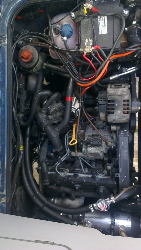

view of the engine

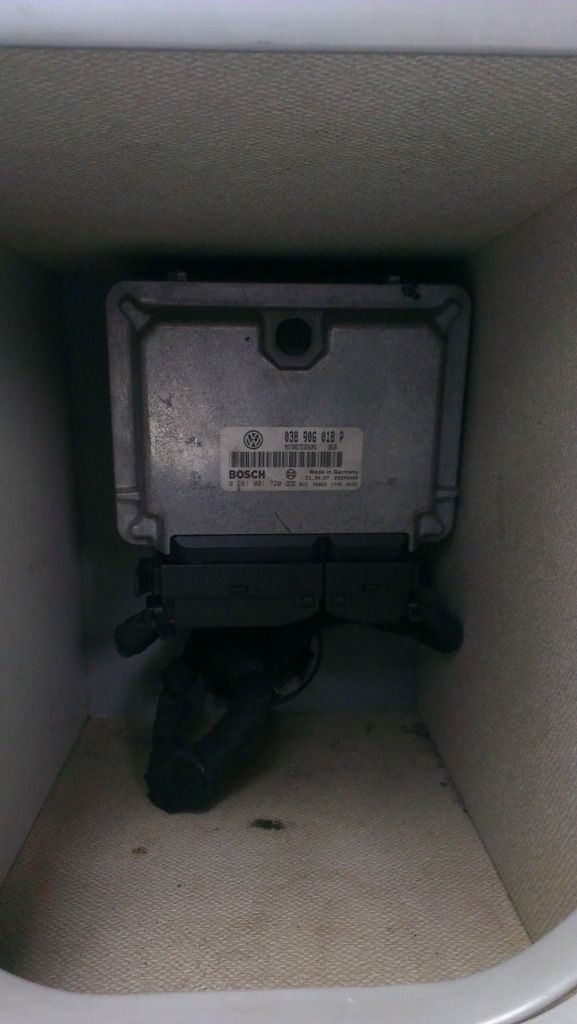

missed this earlier, the ECU and all the relays fitted in the lower part of rear wardrobe

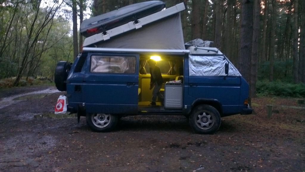

spot of wild camping again

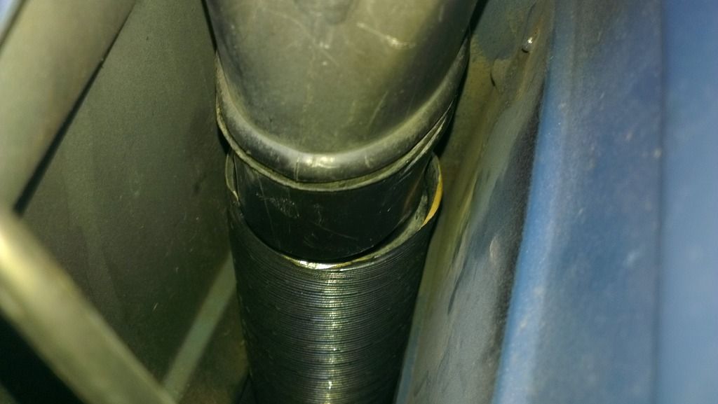

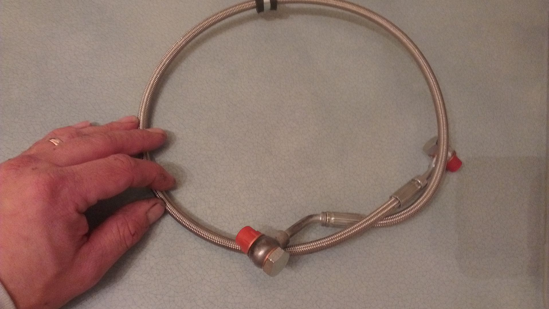

started to look at reasons for the white smoke.. fitted the vw oil seperator the breather set up
more camping!

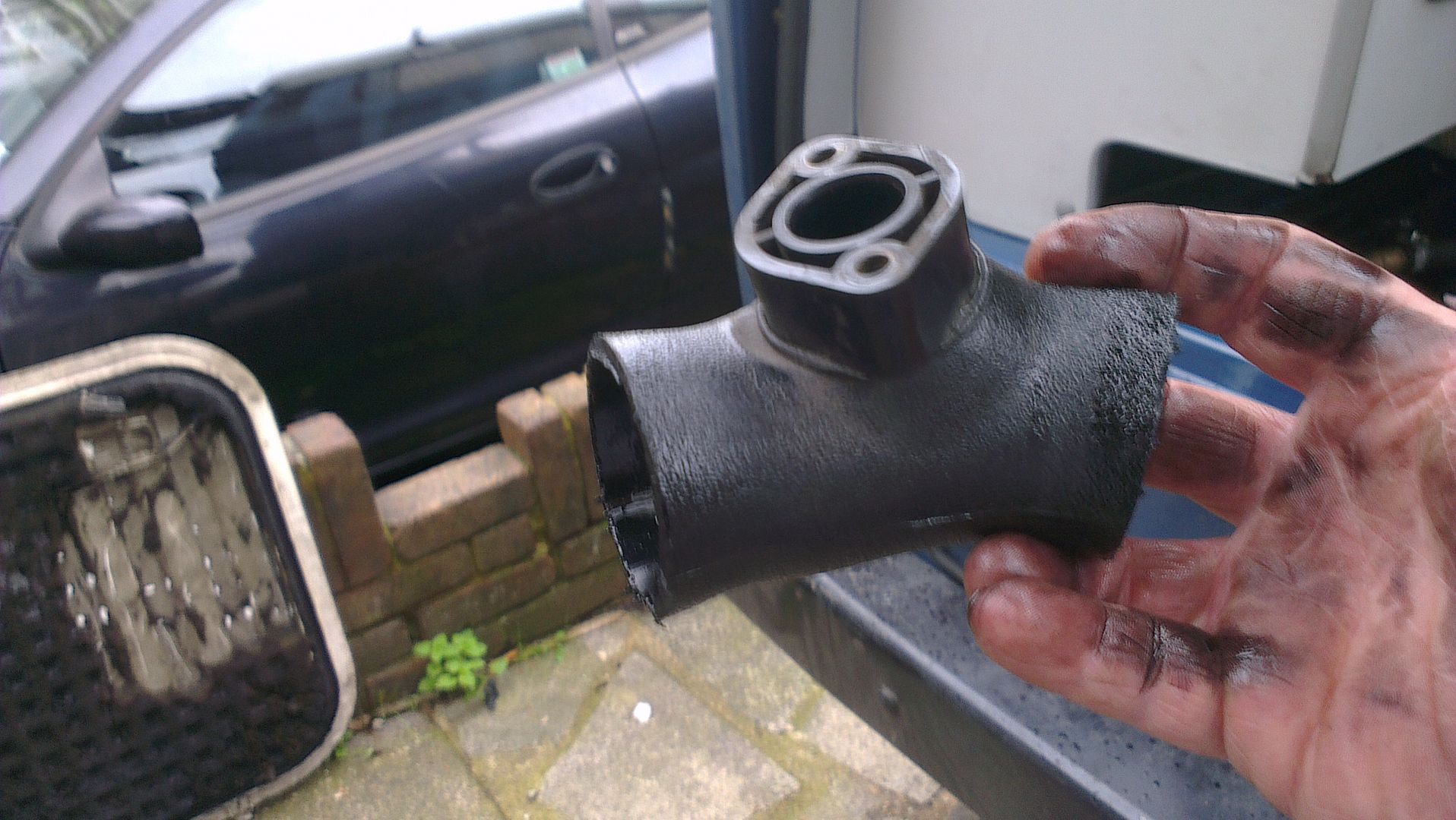

I was wanting to freshen up the inlet pipework as the stuff that was done for me i wasnt really happy with. PD inlet manifold was first
followed by a custom MAP sensor boss
which replaced this thing

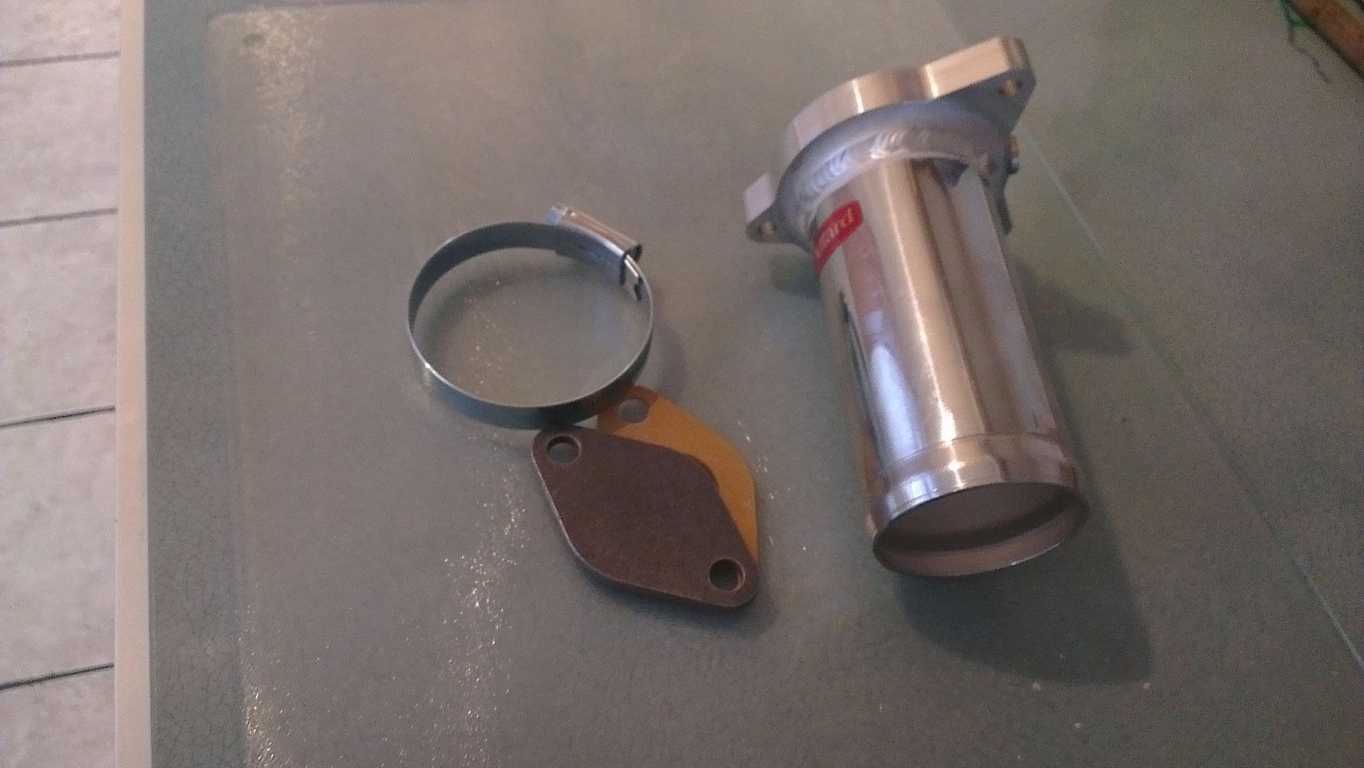

EGR delete pipe next

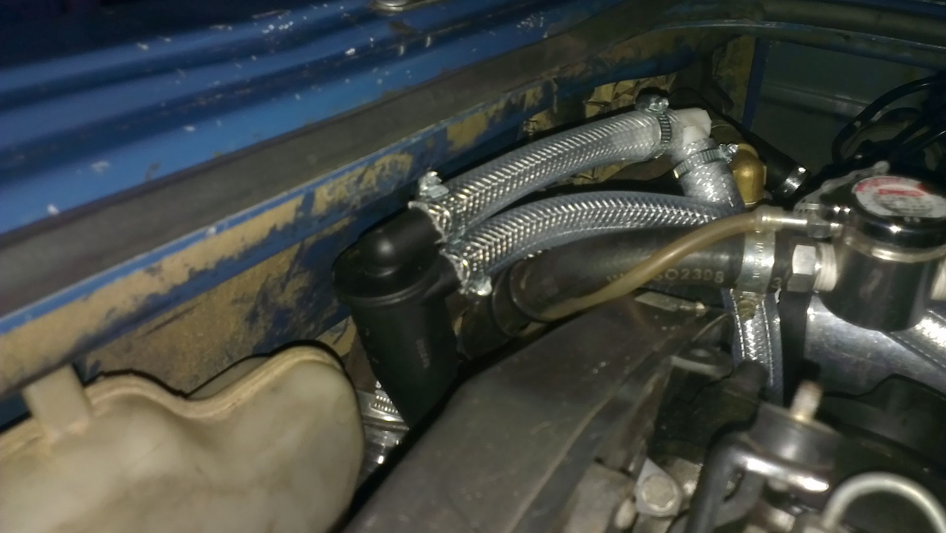

along with the start of making my own oil return pipe
also plumbing in a bmw oil seperator which seperated the oil back to the crankcase. Fitting for oil seperator return to block
mann one way valve for oil sep return
New turbo Very Happy
bmw oil sep
flexi oil feed line to turbo

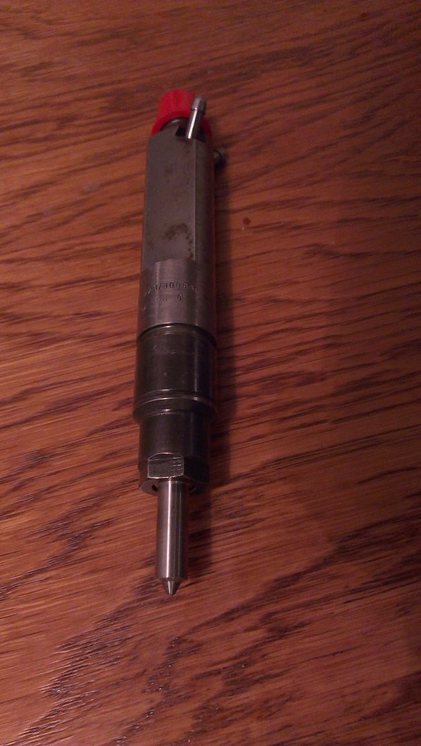

new 0.216 injectors
still getting white smoke....

Decided to make the jump to SA lights and grill
SNOW!!! Laughing
Rear ladder removed and a paulchen bike rack fitted
started to think it looked a bit low again...
Then got distracted by big brakes..
Then some BIG springs turned up Laughing
New pistons and seal kit for the new calipers
widening of the carriers. before and after
Then the new centre caps from T3 technique turned up Very Happy
Calipers and carriers zinc'd

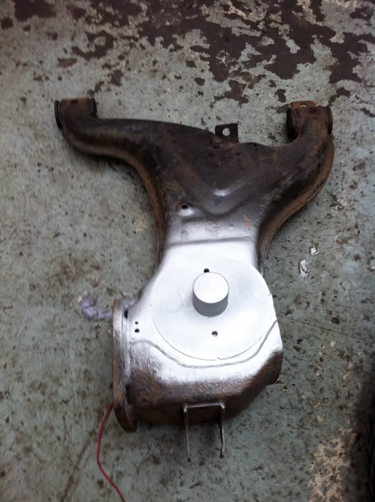

Time for a raise in suspension... Due to me trying to remove the rear trailing arm bolt and snapping it Rolling Eyes It was decided the van would be trailered to brickwerks and left in their capable hands, as surely other things would need doing too....
it snowed a bit on the way.... spent the night on a campsite..
bit of rot on rear arm mount
spring top hats seen better days
16" specific
lower arm with new bits
Andreas springs with new 16" dampers
GMB ball joint spacer
Andreas rear springs with trailmaster longer HD dampers
new ride height, about 53cm hubnut to arch
