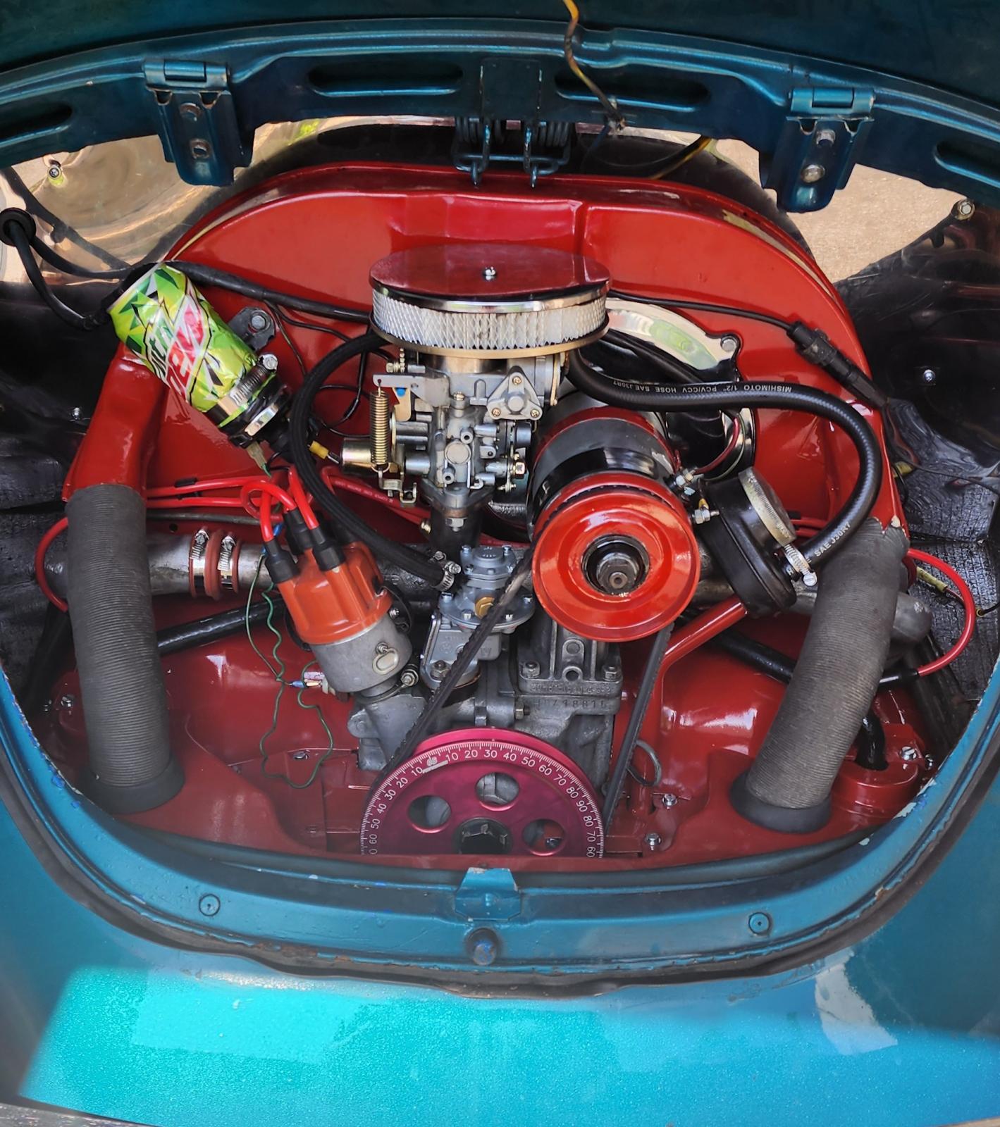

I built a 1600 engine for my 71 SB with all new parts. I rebuilt a Solex 30/31 PICT for it. Installed a new EMPI electronic ignition dizzy, new wires and coil designed for the distributor. Filled it with break in oil, stuck the fuel line in a jug and cranked. The engine turns over well and fast (new battery) but refuses to fire. The oil pressure light goes off after a bit of cranking. I've checked that I am getting spark. (new plugs and coil) and I can see a spark when I ground out the plug to the engine. I can see fuel being sucked up by the fuel pump (temporarily installed a see-through filter at the end). I have poured a little gas in the carb. Nothing. I have sprayed starting spray while cranking. Nothing. Out of a total of maybe five minutes of cranking over two days I have have gotten maybe a couple of pops. No backfires. The engine spins strong. Manually rotating it I can tell compression is good and I can feel air from the exhaust pipes while cranking. I have checked the valves twice more just in case (they were not off). I have set the #1 cylinder at TDC (verified it was at TDC with valve cover off and both valves were closed). The crank pulley lines up with mark while it's at TDC. The distributor rotor points to number 1 plug wire. Plugs are in order CW on distributor - 1,4,3,2. Wires run correctly to cylinders. I even reversed the wires in case it was 180 off and nothing.
I would think if the timing was off, even way off I'd still get a few pops or even backfires. But even when starting fluid is sprayed into the carb it never even fires once.
I've checked the continuity of the plug wires - all ok (they are new anyway).
I removed the carb. Bowl had fuel in it. (Note: I have not rebuilt a carb before but there really wasn't much to it but I suppose I could have made a mistake somewhere. One thing I noticed is that when actuating the carb lever, no fuel is squirted from the accelerator pump nozzle). The butterflies seem to open properly. No air or fuel leaks. I checked the 1 and 2 plugs several times for spark, I can always see it so I don't think it's the distributor. But again, starting fluid or a little gas poured into the carb does nothing.
I feel like I'm missing something big and/or stupid. Compression, fuel and spark. But no start.
What am I missing or what should I look for?

You might try adjusting the distributor a few degrees each direction. If you have fuel and spark and it's sparking at the right time it should fire.
Maybe while fixing the accelerator pump you'll discover something that you missed. But with gas poured down the carb it should run for a few seconds.

Thanks. I've tried timing a few degrees each way and nothing. I'd think I'd at least get a pop or backfire even if it was off a lot.

If you are sure it's not 180 degrees out, set the electronic dizzy to fire at the BTDC mark on your pulley. Whatever it is 7.5 or 10 degrees BTDC. Then repeat.
The relevant BTDC angle should be documented on the car or in the archive section.

Are your plugs dry? I would think they would be really wet if it's getting fuel. Have you tried to palm choke it?

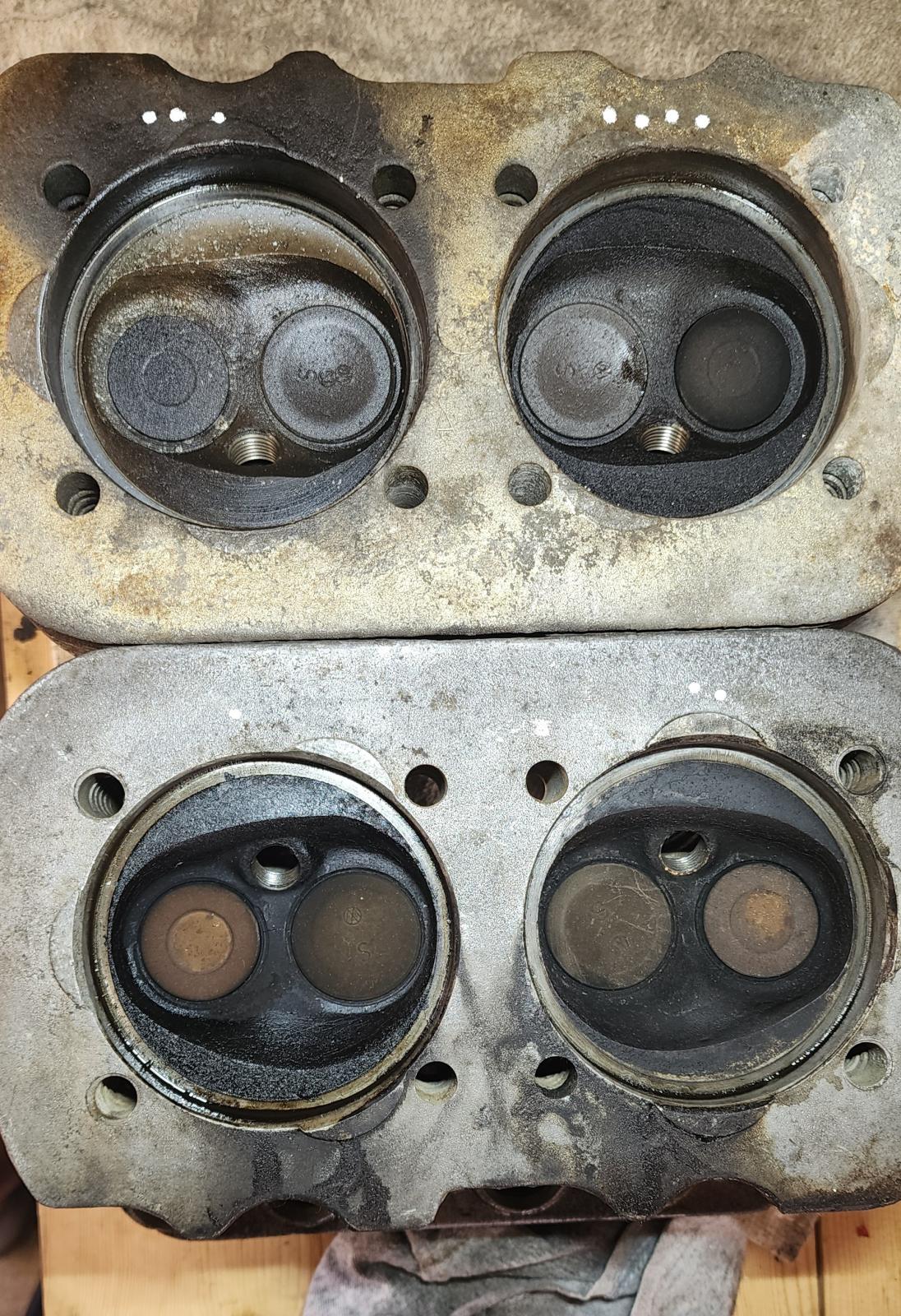

Do you remember your deck heights and cc’s of your heads?

So here's where I am. I took apart the carb and found a clogged accelerator pump - fixed that. This carb has all brand new needles, gaskets etc,
The distributor gear was likely installed wrong by the PO. When I find TDC on # 1 (verified by pulling the valve cover and making sure both valves are closed), the rotor points to about 9 o'clock. It does not line up with the tiny notch on the case, which is around 3 o'clock. But at TDC, that's where it points. Just for fun I reversed the wires 180 degrees - not even a pop with gas and starting fluid.
What I've observed:
I checked all four plugs and when grounded to the block there is spark. I'm working with the sun so I can't tell how strong the spark should be but I can definitely see spark.
After cranking, the plugs are not wet. In fact, they are a little grey as you'd expect if it was running well. They are new plugs gapped to .025. Plug wires are new too.
I verified the idle cutoff solenoid is working - it clicks on and the plunger moved when the ignition is on.
It looks like the distributor can only go in one way based on how the drive meshes (slightly off-center). Even if it was in wrong by 180 degrees, by changing the wires 180 degrees as a test that should make a difference.
When I move the crank pulley with a wrench, it's obvious there is good compression - it gets hard to turn then eases off as I think it should.
I verified the fuel pump fills the carb bowl (new pump).
I can smell the evaporated starting fluid coming from the exhaust pipes.
The engine turns over strongly. New battery, freshly charged.
So, I have compression. I have spark. I have fuel to the carb and I have squirted fuel into the carb before starting and sprayed starter fluid. For the last two days I have had zero pops. No backfires. Note: This is a dual port engine. All new seals on the manifolds.
I am missing something. Maybe something stupid. The PO built the block, but I assembled everything else and took my time over winter. I don't think I made any glaring mistakes. I mean, it cranks great. What the hell?

Ok last time I going to respond here. We need to know your compression ratio numbers. I know you feel compression even 5:1 will give you feed back. But will not be enough to start. Without this very important reading no one here can give you any usable advice. It’s the next step. You are verifying two of the three needed elements to run. You can eliminate fuel issues with the starting fluid, you are using starting fluid and not brake cleaner right? You see spark so points condenser and coil is working. You distributor is rotating. We are at the point of it being internal. So start with compression check. Next is to see if your cam is rotating. Yes they can snap clean off and the distributor will still rotate. If your sure your getting fuel to your cylinders. If you’re not 100% sure check that you don’t have tape over an intake runner or something.

viiking wrote:
Tenknots wrote:
Still, you'd think it would at least fire from starting fluid...
Yes.
Unless the spark does not coincide AFTER the inlet valve has opened to admit fuel to the cylinder.

If I understand correctly... basically what you're saying is that you too suspect the drive gear was installed incorrectly. Though instead of taking the time to fix that issue, you're going to work around it and proceed anyways?
I think I'm done here.
Best of luck.
