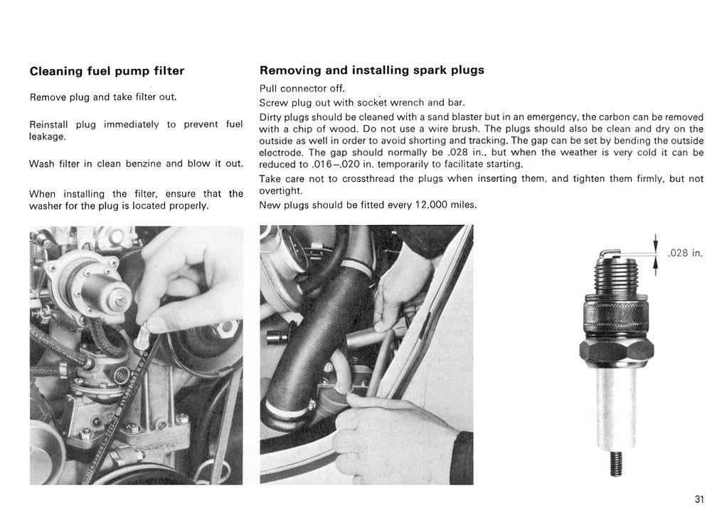

The weather reached minus 5 Celsius (below freezing), and I hadn’t reduced my spark plug distance in anticipation of really cold weather. In this sudden cold the revs would drop randomly every minute or so, and when accelerating the Beetle would bog down. It would be pedal-floored but only after a few seconds there was a slow acceleration, like driving through treacle. I was able to quickly tune it so the revs would be higher, then when gunning it along the motorway it was like it had no issues.
Next day I tried to properly tune it and this is where the bigger problems began. Initially it would struggle to maintain an idle, then would backfire a bit, and then like the day prior, it would begin bogging down and I’d have to pull the accelerate lever at the engine to keep it from stalling but again it would take a few seconds to begin to rev up.

I’ve resized the spark plugs to cold now back to regular as the weather is mild again. I’ve replaced the spark plugs, changed in and out a new bunch of spark plug cables, I’ve changed in and out two coils, and checked all the wires. I’ve also changed the distributor cap, rotor head and points (correctly distanced) and no spark or improvement. I’ve sprayed in starter fluid too into the air intake, but to no effect. Any ideas, folks??

Around here "turn over" means the starter is rotating the engine, it sounds like what you are lacking is "firing".
All of this altering spark gaps and stuff for cold weather is news to me, it should run the same at +40 as -40, you might have multiple issues and your fiddling may be contributing to them.
The first thing I would do is connect a test light between the primary terminals on the coil, does it light up when you turn on the key?, does it blink on and off when you crank (turn it over)? You may have ignition switch problems.

Because it developed the problem during a sudden cold snap, I looked into it as a possible problem and found this in the manual:
Yep, the plugs are back to normal.
