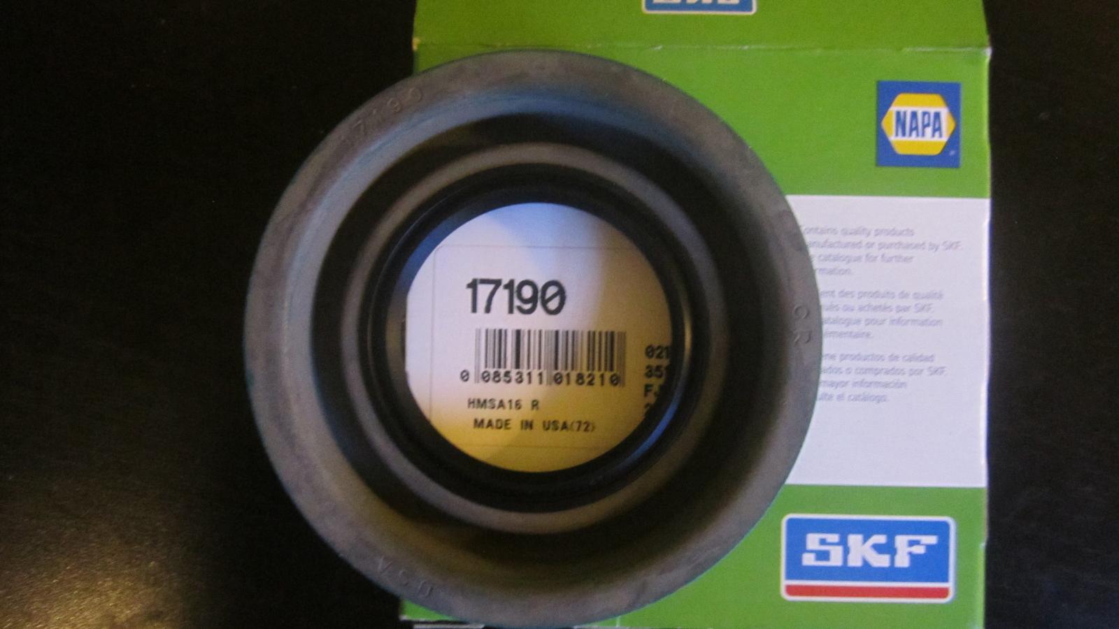

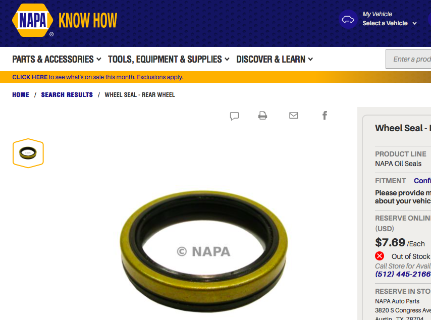

PostPosted: Wed Oct 05, 2016 3:38 pm    Post subject: Re: Rookie mistake help please- torque converter install question Reply with quote
Here's the part that comes up on the napa site.
https://www.napaonline.com/napa/en/p/ATP17190/ATP17190
Obviously, that Napa Seal looks very close if not identical to the Gowesty seal.
http://www.gowesty.com/product-details.php?v=&id=21938
But, if you pre-order it on Napaonline and go to the store to pick it up, this is what they hand you. Note that the parts # matches the first link.
Anyway, the part # given by Kourt leads to the correct part.

Wildthings
Joined: March 13, 2005

PostPosted: Thu Oct 06, 2016 7:27 am    Post subject: Re: Rookie mistake help please- torque converter install question Reply with quote
The correct Napa seal 550237 looks like this:
You can google "napa 550237" to find it.

PostPosted: Thu Oct 06, 2016 9:26 am    Post subject: Re: Rookie mistake help please- torque converter install question Reply with quote
ftp2leta wrote:
Napa picture is not the right one,,, but it's a picture.
That seal should be installed/pushed in place by hand... flush with the case
Ben
I know...I took it back and got the one that Kourt shows above. Just wish I'd opened the box at the store. I'll try to put it in tonight and hopefully it works; if not, I'll either order the one from Oreilly's or overnight from GW.
